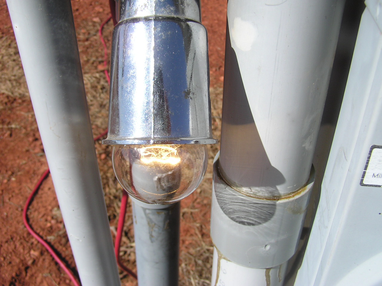

I sure am glad that I rigged up the "pump on" light, last year. I got in the habit of looking at it every time that I washed my hands in the bathroom sink. Last night I noticed a problem, the pump would run for 2 seconds, off 4 seconds, on 2 seconds, off 4 seconds, and do that until I turned off the faucet.
Without the light, I never would have known there was a problem until the pump would have died.
The guy that installed the system many years ago came out and pulled the pressure tank. It had lost pressure down to 12 pounds. Raised it back to 42 pounds and everything is working right again! When the light is on the pump is running. :thumbsup:

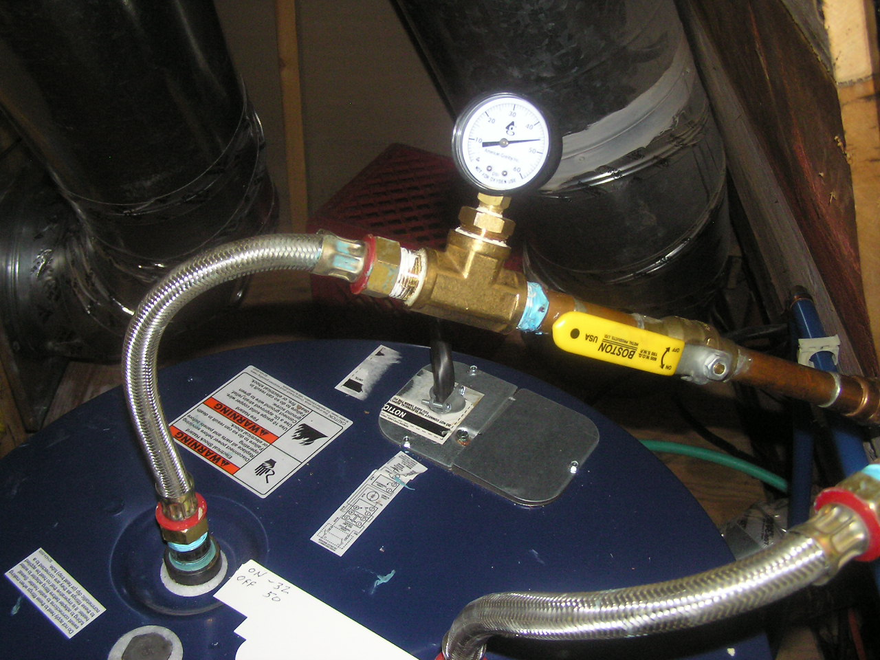

Thanks, I did think of that after I answered your post. The water heater would be the best place.

Watch a gauge while you run water slowly. That gives you pump ON/OFF pressure and an idea of makup time. Run water variously. Note if you can stall or reverse pressure rise. After that when you glance at the gauge you will see whether it is w/i pressure and whether rising/falling/static. Rising may or may not be during water usage. Static could be pump OFF no usage or pump ON at full capacity usage. Not likely to see it balance so close that you dont see a pressure creep. A bit of experimentation and you will be able to know a lot about the state of the system and know how to check it when in doubt by observing pressure while using water or not to get it to go on or to favor it going off.
I should have updated this thread a couple of months ago, I finally installed a pressure gauge at the water heater.
The gauge shows ON = 32, OFF = 50. Since it is a constant pressure system, when water is running somewhere, the pressure will slowly drop as water leaves the pressure tank, at 32 PSI the pump turns on.
The gauge rises to 40 PSI, stays there as long as water is running. When the flow stops the pressure rises as the pressure tank fills. The pump cuts off at 50 PSI, and the gauge stays there until water is used somewhere.
With 5 outdoor hydrants and a wash stall in the horse barn, it is very good to see no pressure drop when nothing is on, that means no leaks. 👍

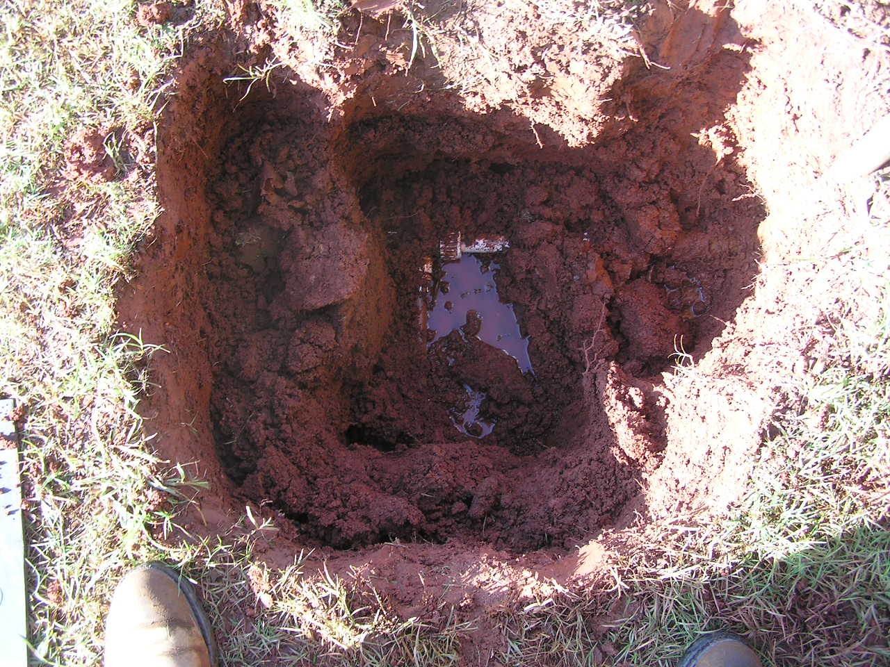

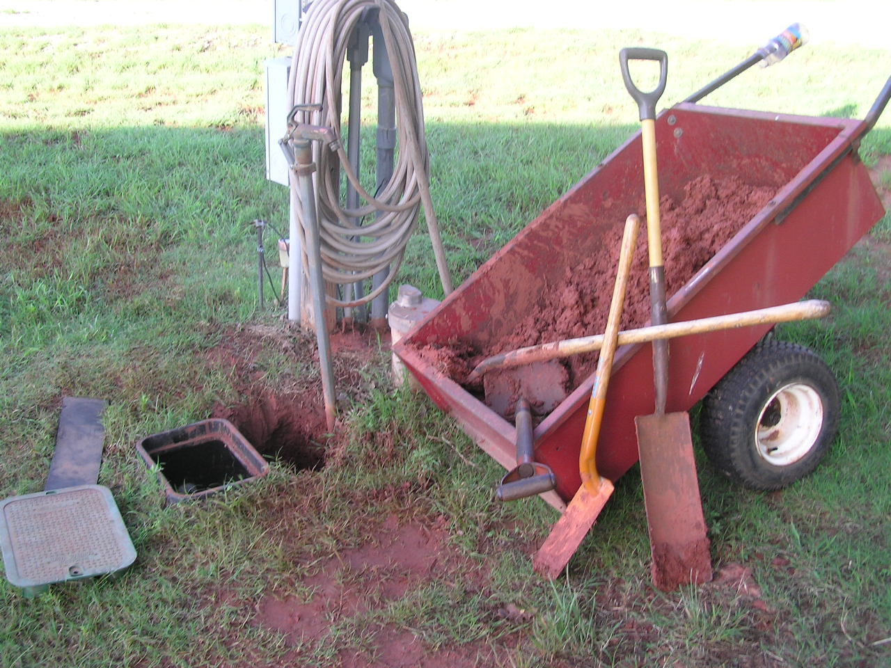

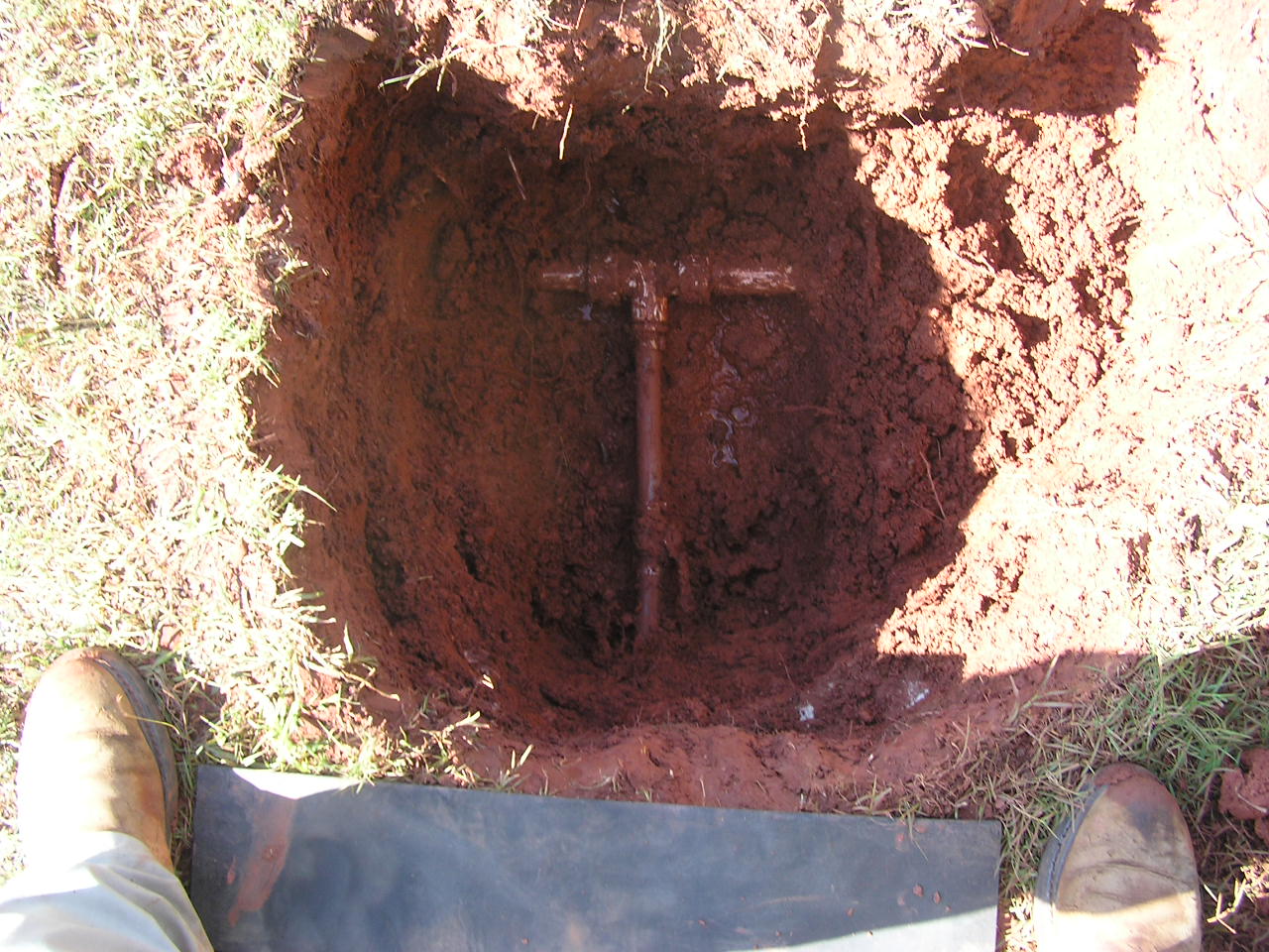

About a week ago, when I flushed the toilet, the monitor light came on normal, but went off about halfway through the cycle, then on after 10 seconds, off after 10 and repeated this pattern until the flow stopped.
I watched the gauge when water was being used anywhere in the system and could see the same pattern, the pressure was not constant, while water was flowing. I figured the In-Well pressure tank was loosing the pre-charge again.

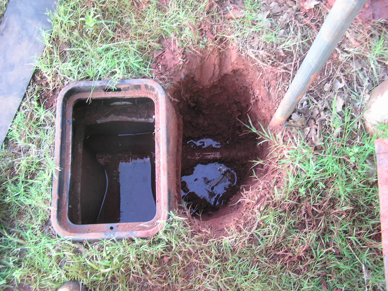

I called tech support at Cycle Stop Valves, he said I could add a pressure tank in the water line to restore normal operation. So I started digging.
430924-water-well-pump-monitor-p6200002-jpg

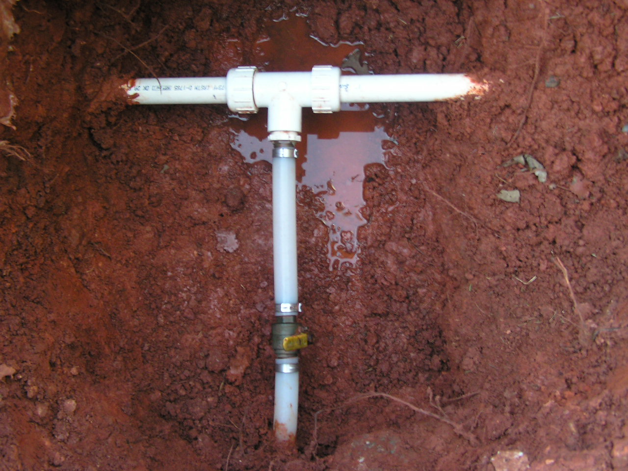

The valve box for the outbuildings cutoff valve was full of rainwater.
430925-water-well-pump-monitor-p6200004-jpg
430926-water-well-pump-monitor-p6200011-jpg
430927-water-well-pump-monitor-p6200012-jpg
430928-water-well-pump-monitor-p6200016-jpg

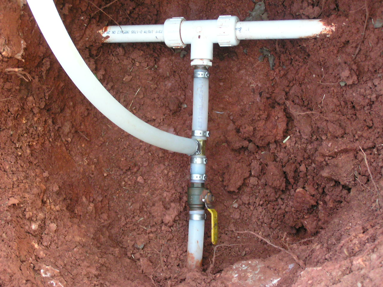

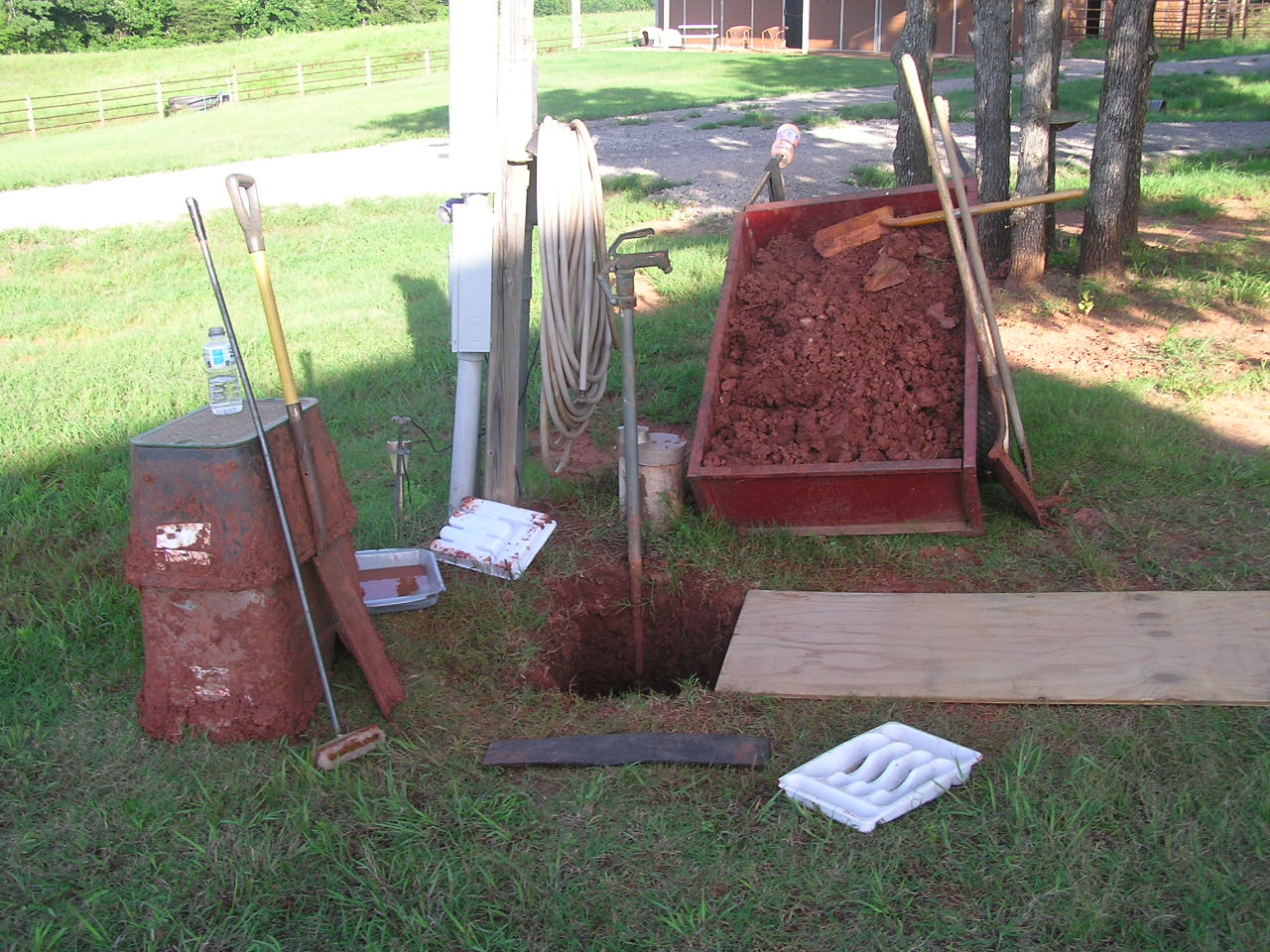

Got the PVC and PEX cleaned off ready to add a Tee.
430929-water-well-pump-monitor-p6220017-jpg

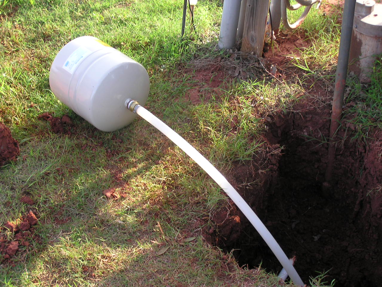

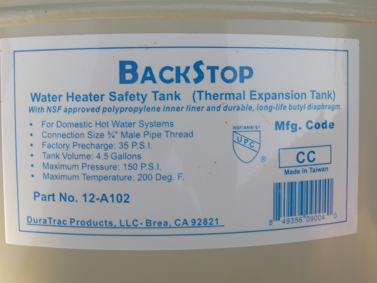

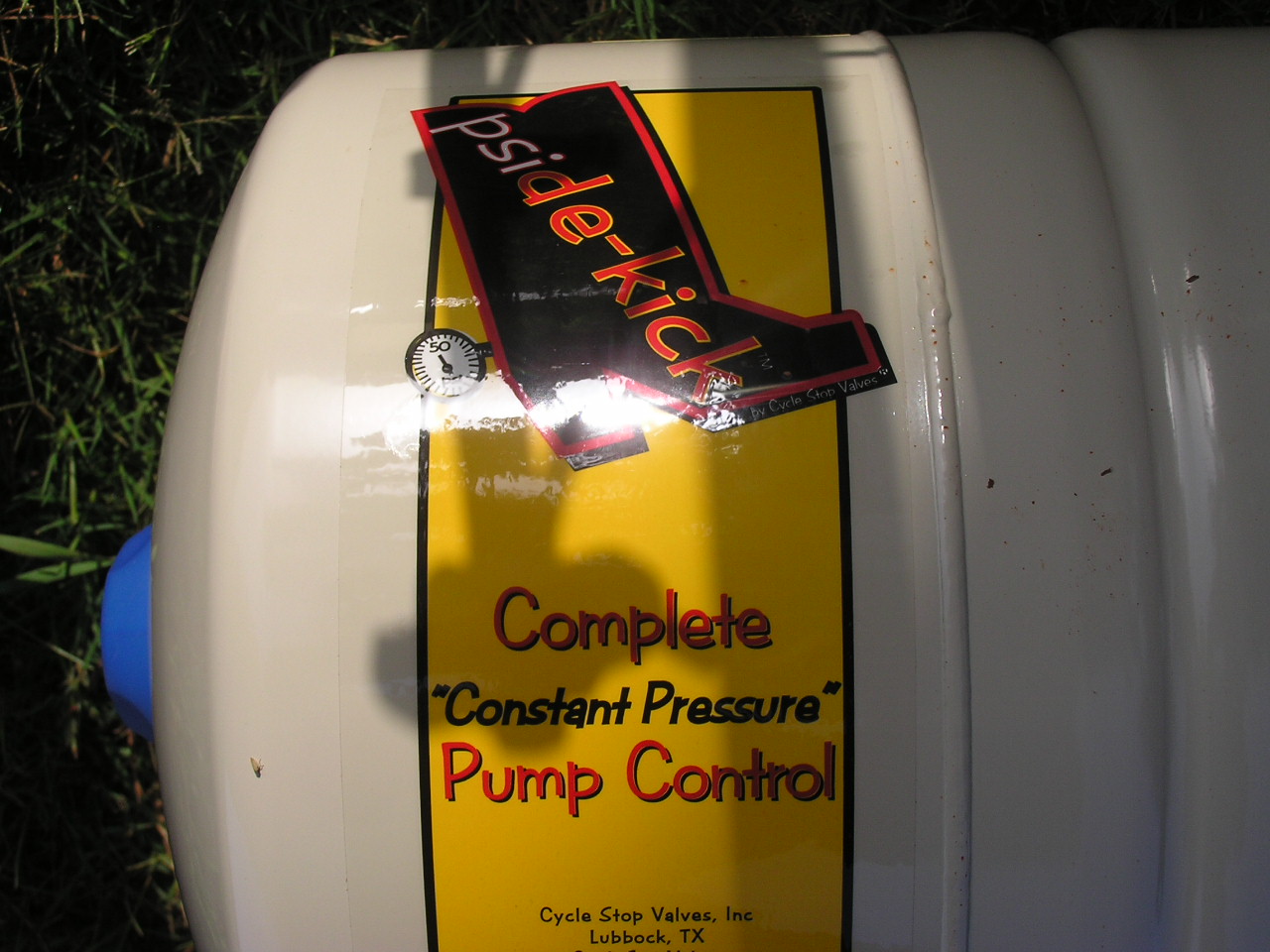

Since we don't want a heated pressure tank house, I ordered the pside Kick system and teed in that pressure tank.
It is temporarily above ground until I can find a waterproof container with an access lid, to bury it and the new cycle stop valve in. Then we will remove the old valve and pressure tank from the casing.

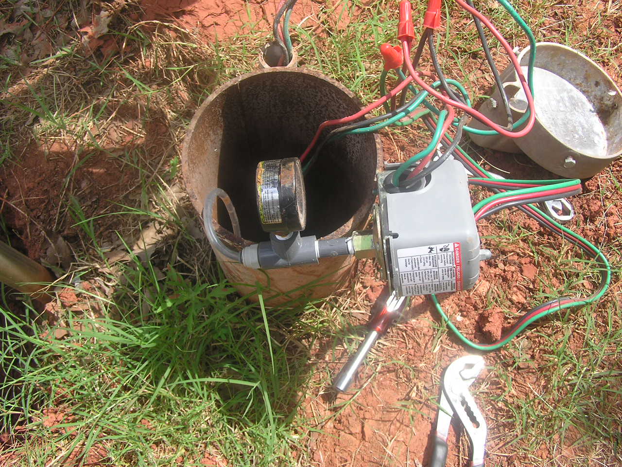

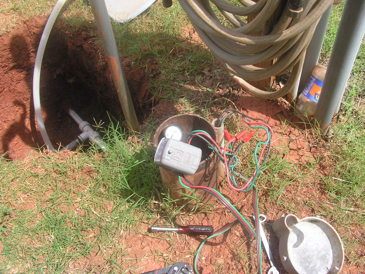

I measured the pipe today, it sure looks bigger.
It is definitely a six inch casing. 👍
The pressure switch has a vinyl tube on it, so you can pull it up easily.
