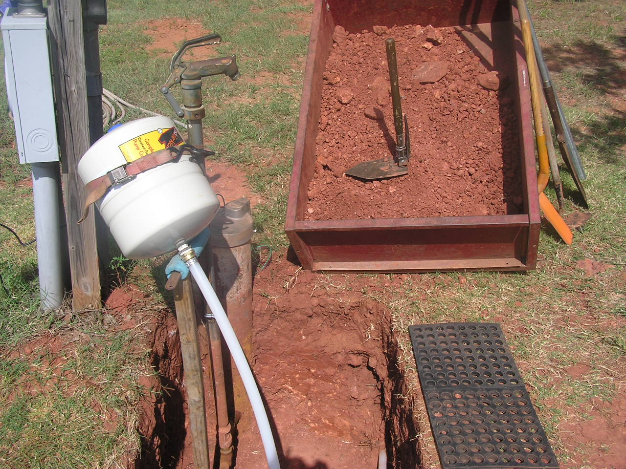

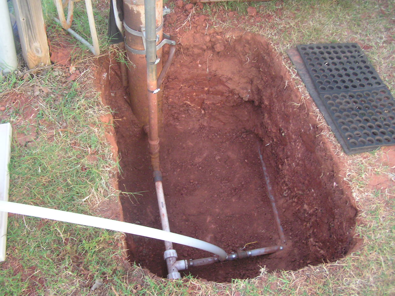

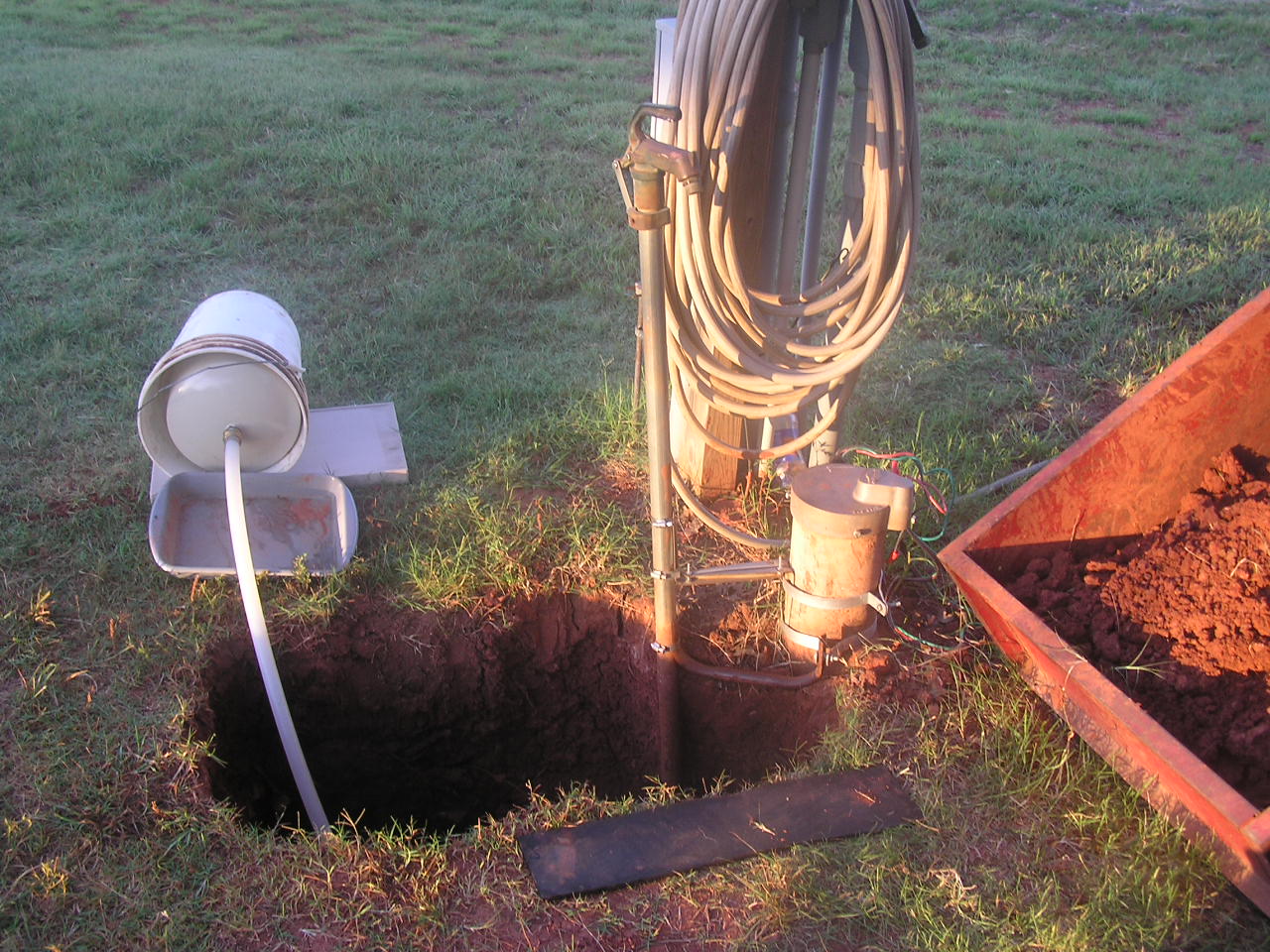

Here is an update on installing the pside-kick system.
Cobbled together a brace for the hydrant so I could dig the dirt away from it.
attachment.php
attachment.php
attachment.php
It got too hot for digging, so here is the next mornings progress. :thumbsup:
attachment.php

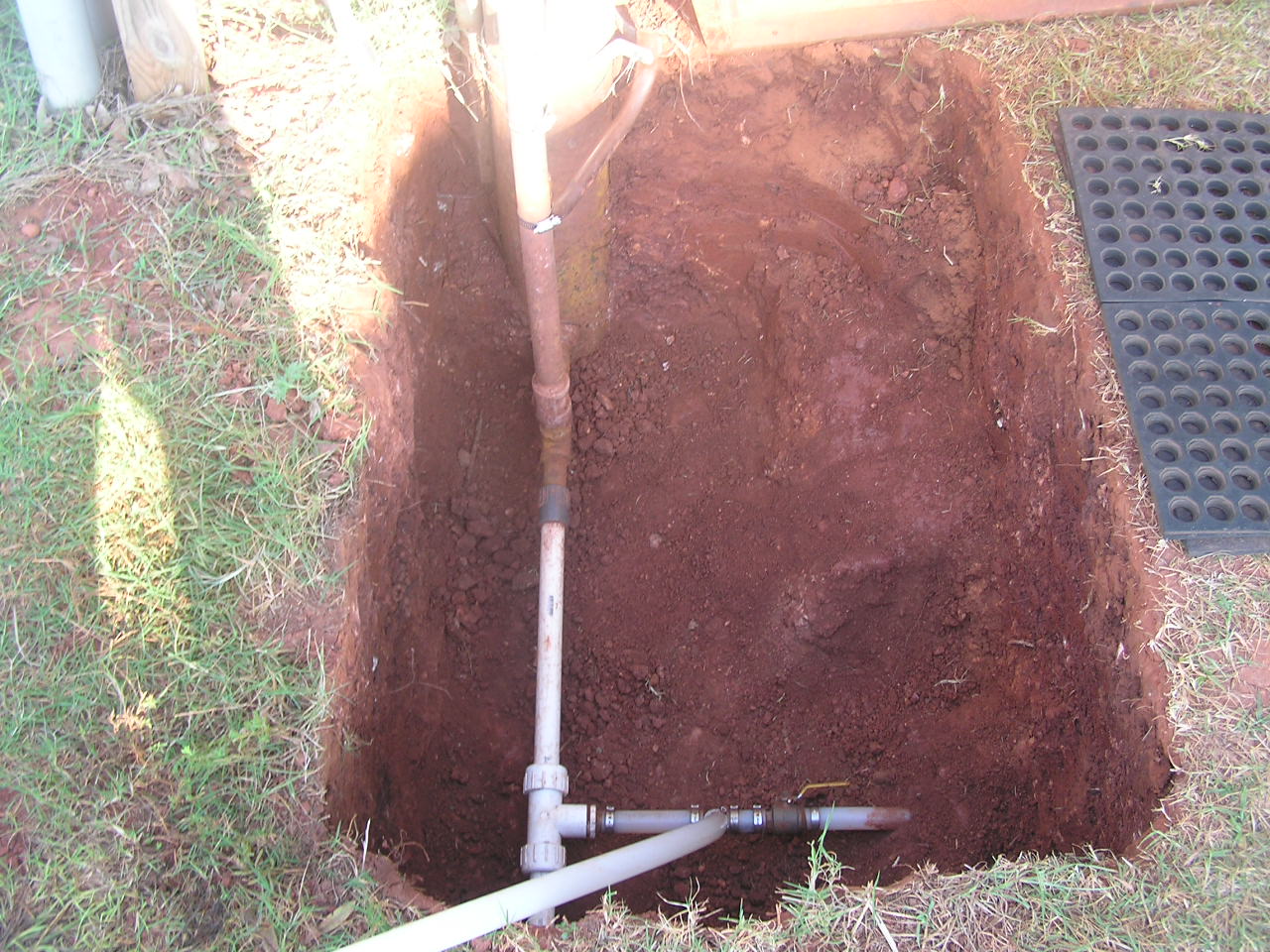

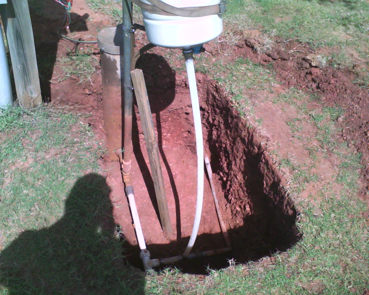

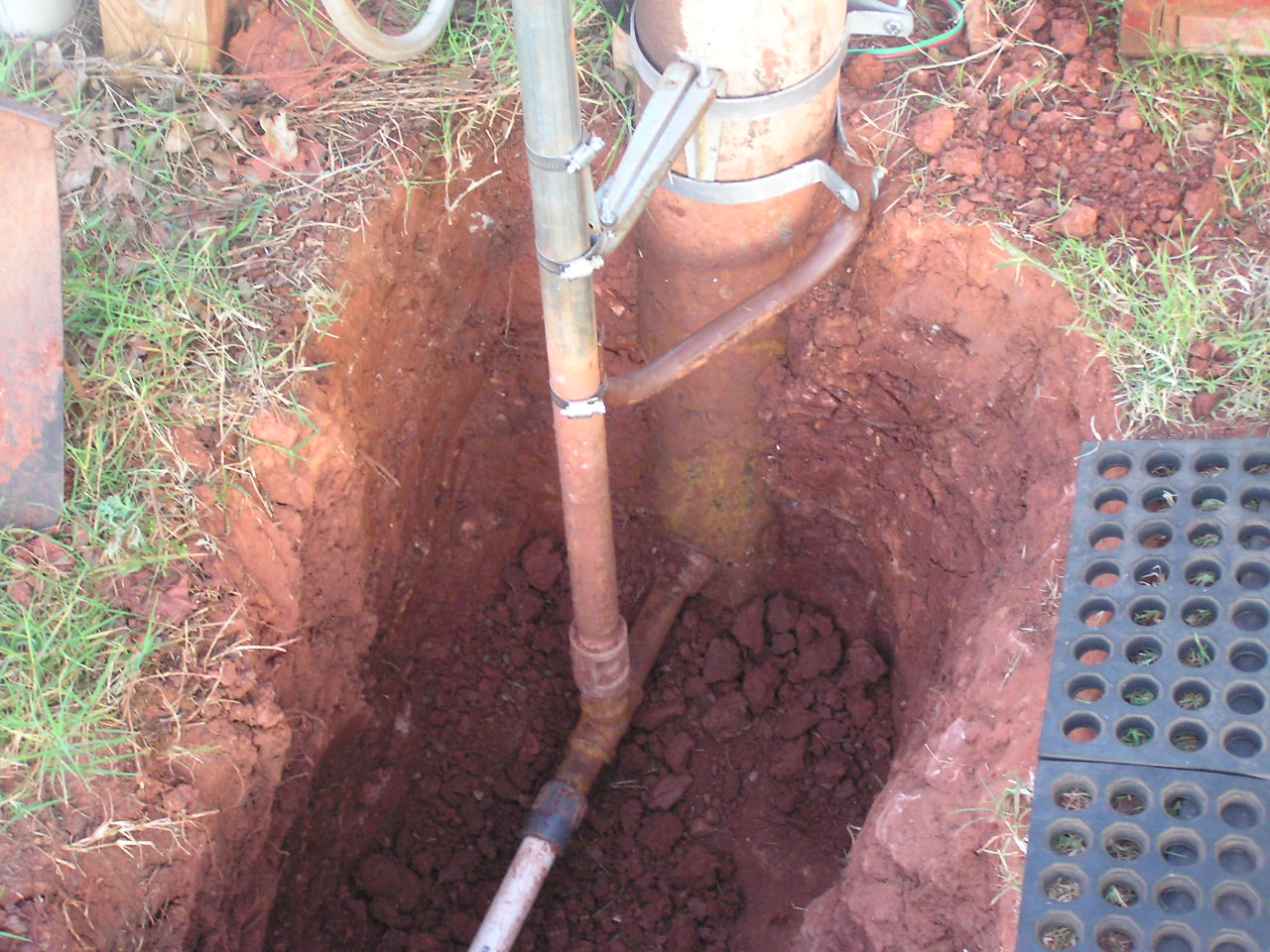

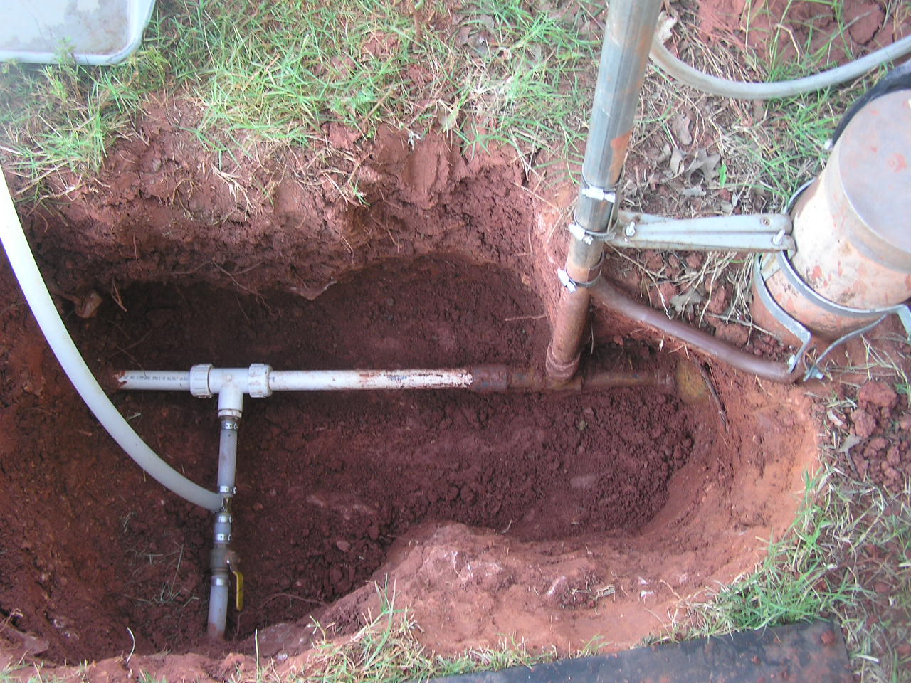

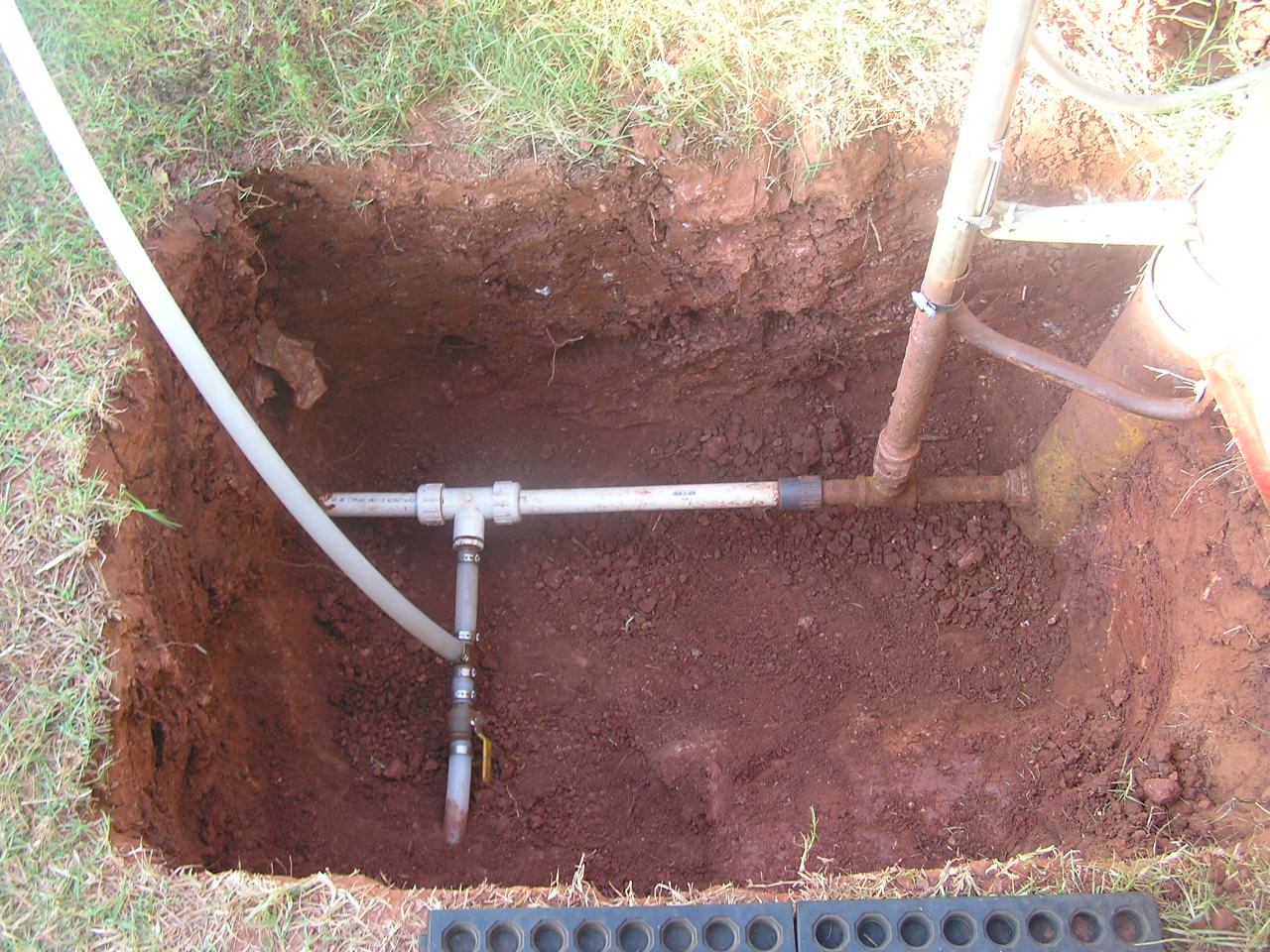

More red dirt digging results.
432132-water-well-pump-monitor-p6300025-jpg
432133-water-well-pump-monitor-p6300027-jpg
Uncovered the line to the out buildings. :)
432134-water-well-pump-monitor-p7020024-jpg
Dug around the PEX and cleaned it where it will be cut to go into the box.
432138-water-well-pump-monitor-p7050005-jpg

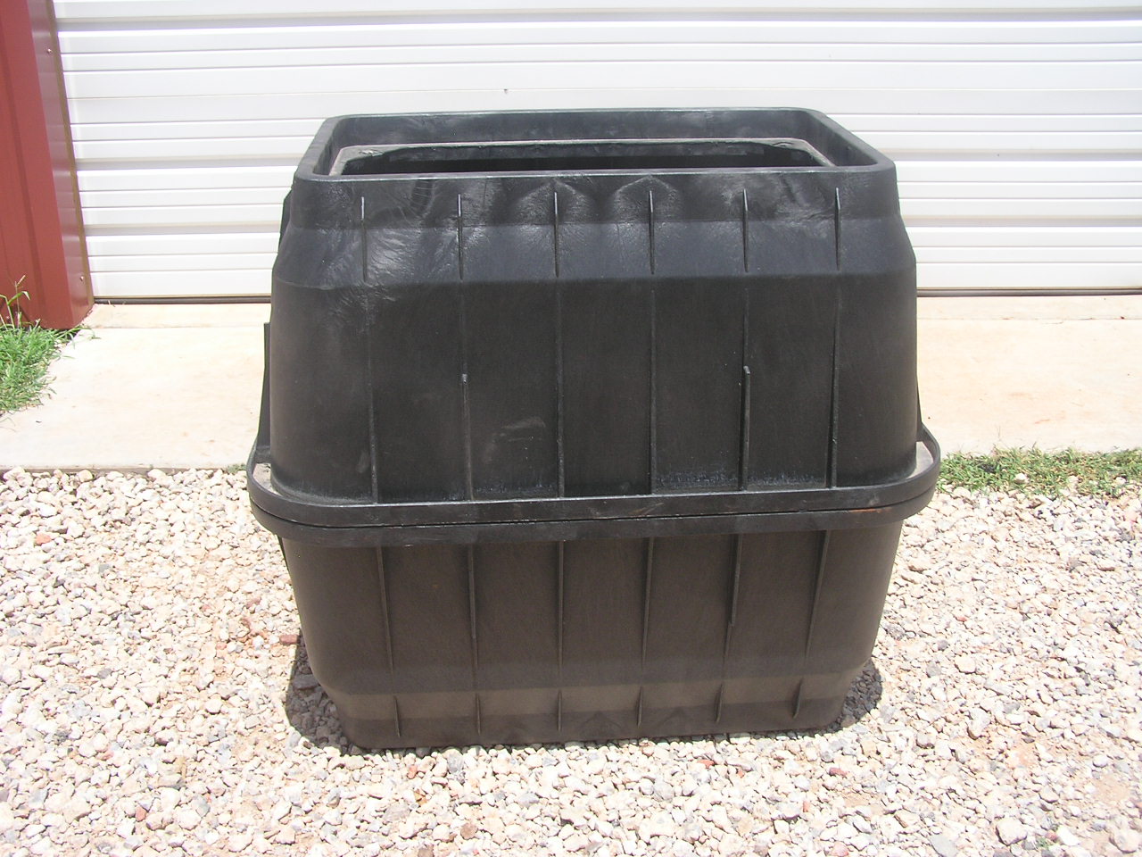

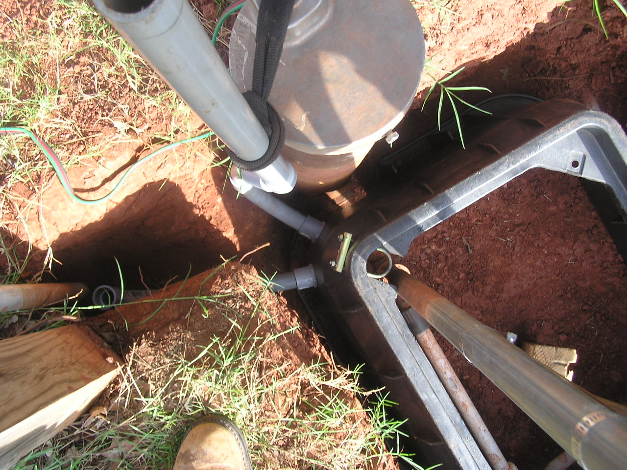

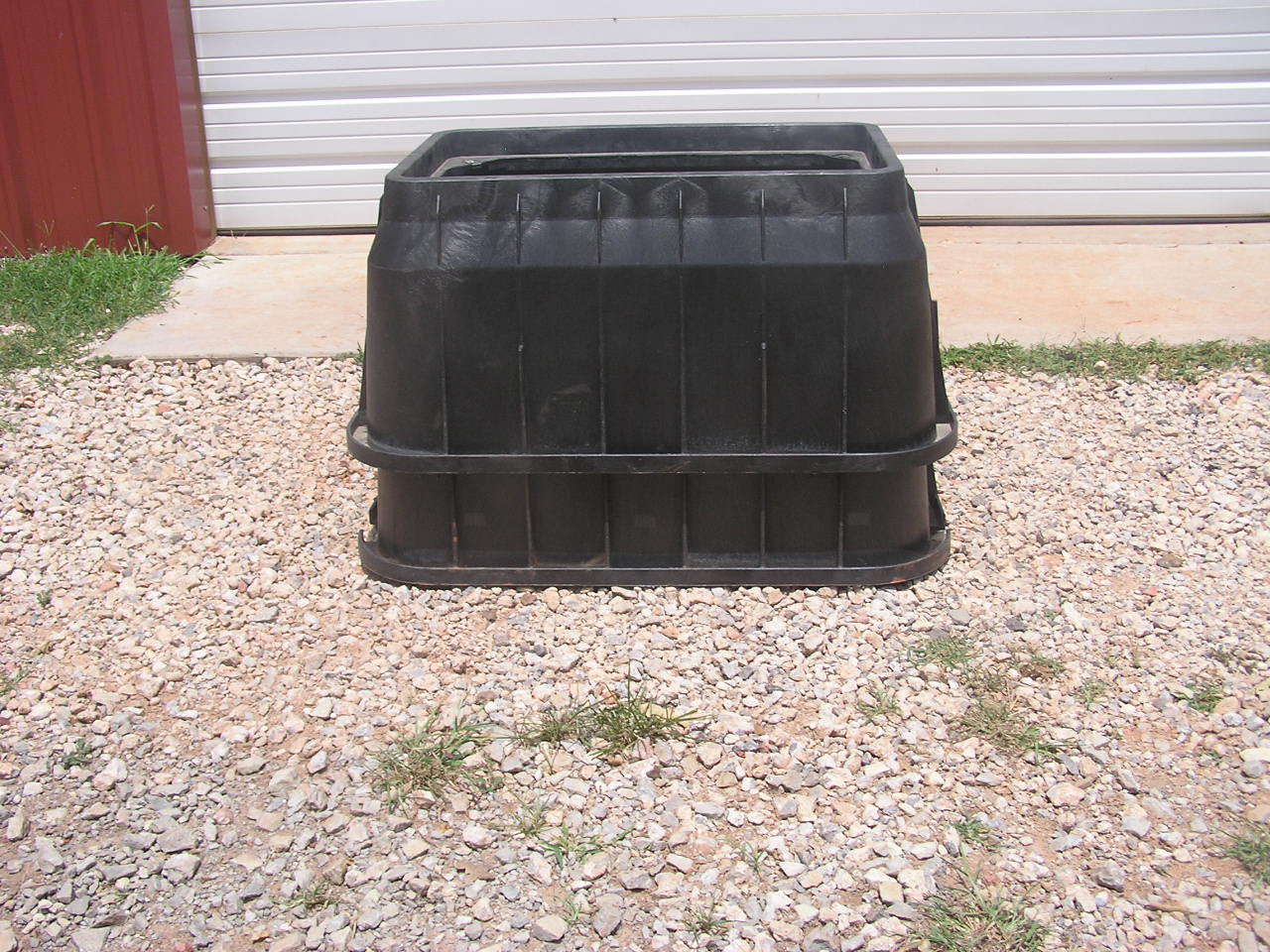

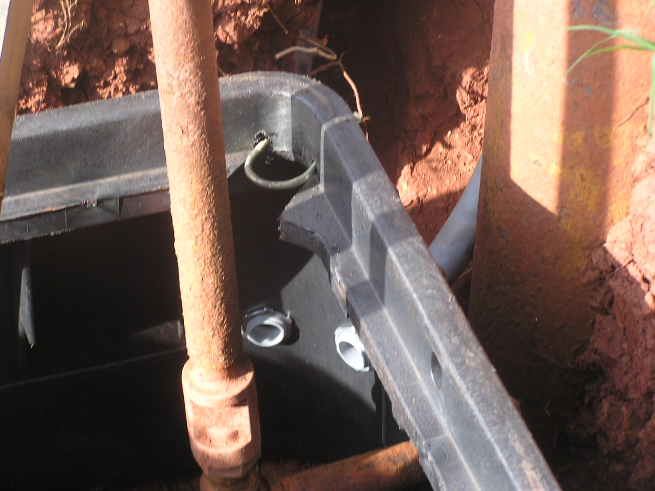

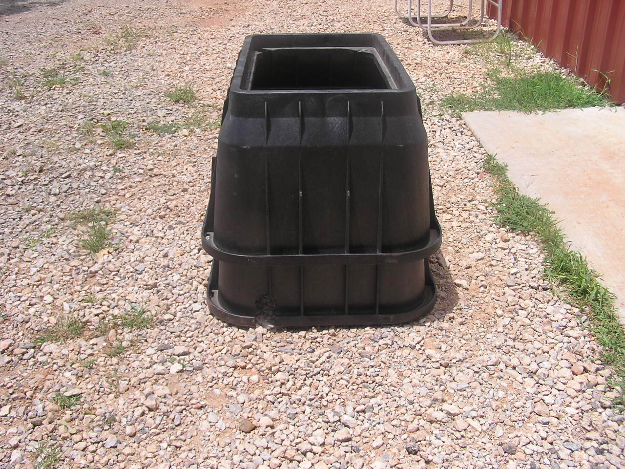

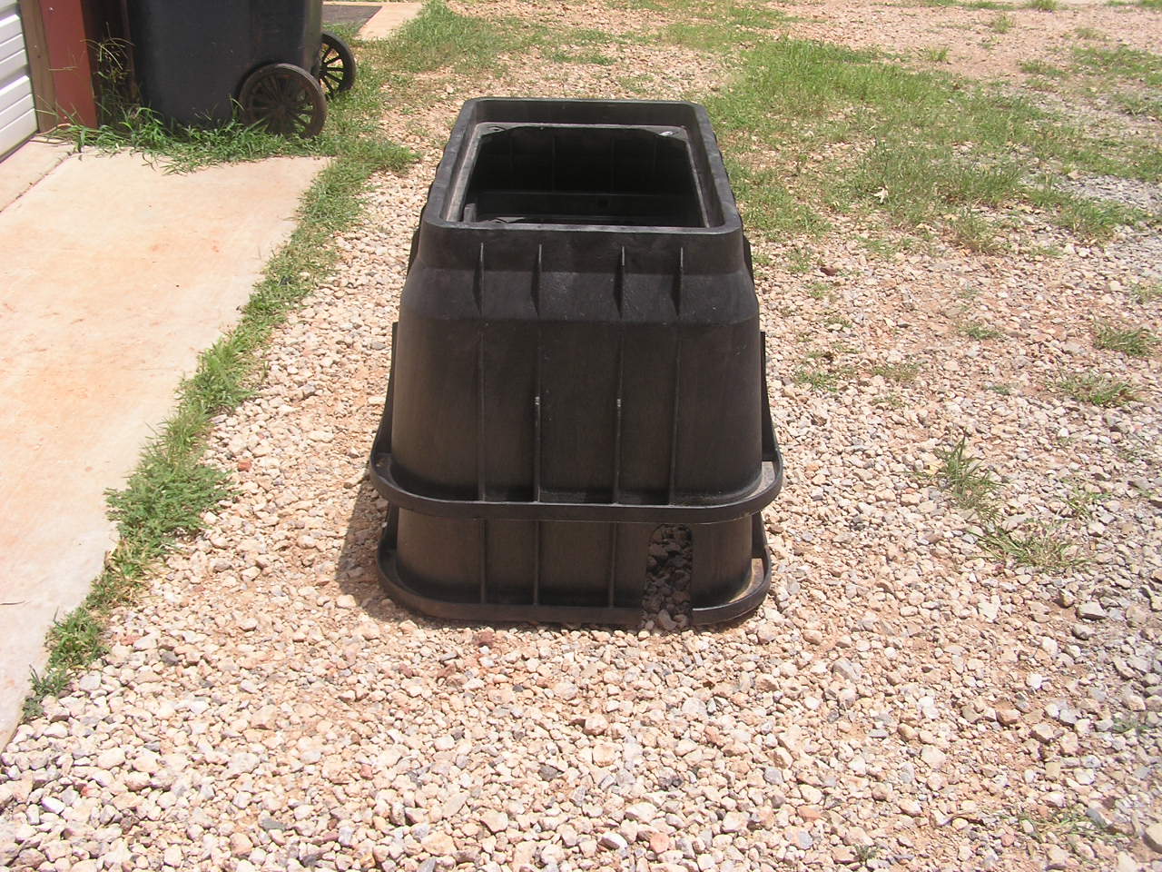

Spent many hours searching the WWW for a box to use, looked at Ground Sleeves, Handholes and Meter Boxes.
Found the Carson 1730, 18" body: http://www.oldcastleprecast.com/pla...ents/4024d4a7-3583-472f-84ab-bd837c9709ff.pdf
With the extension, it is 36" high.
attachment.php
That is too high, so I planned to cut 10" off the bottom to get the needed height.
Then I discovered if put this way it is the right height. :thumbsup:
attachment.php
Used a hole saw and recip saw to make slots for the pipe.
attachment.php
attachment.php

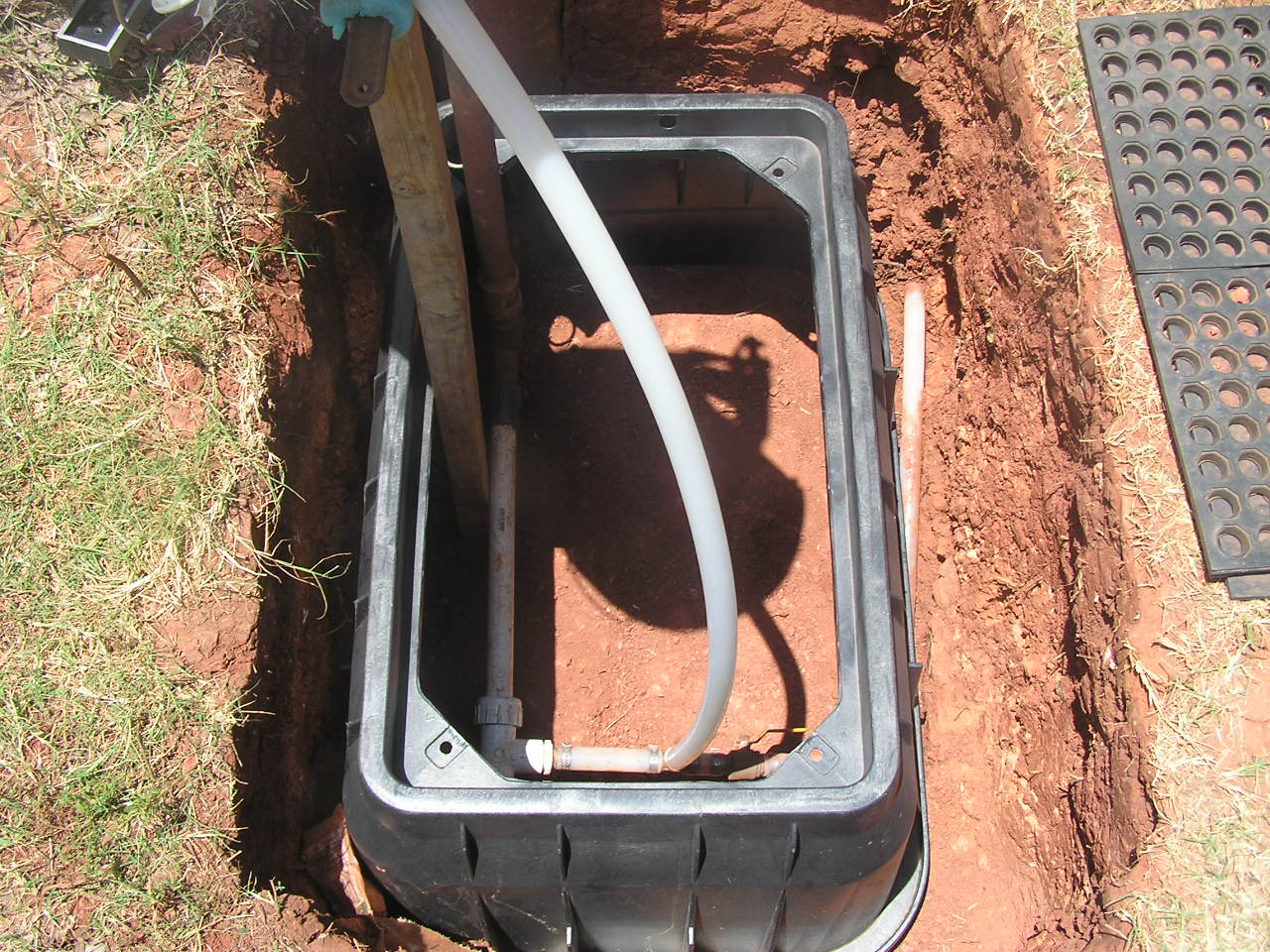

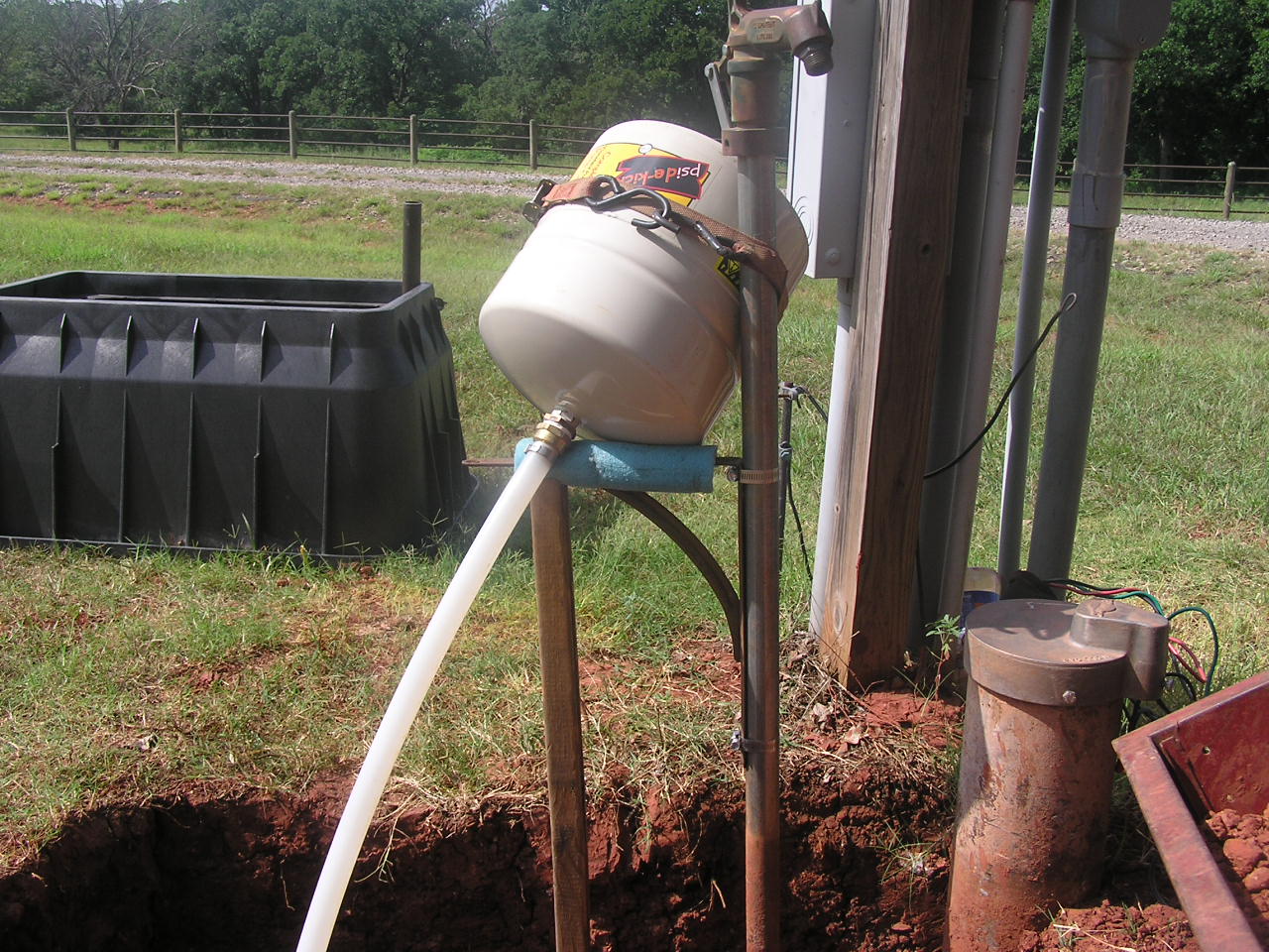

Moved the pressure tank up off of the ground so I could put the box in the hole for a test fit.
attachment.php
attachment.php
At the bottom flange it is 28" x 41".
attachment.php
attachment.php

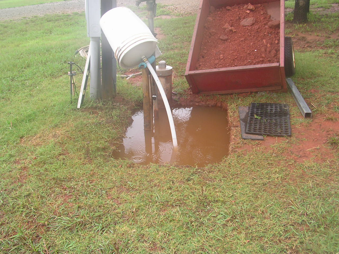

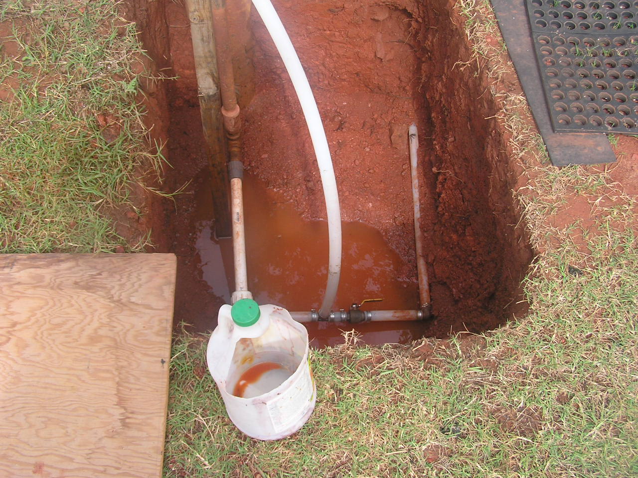

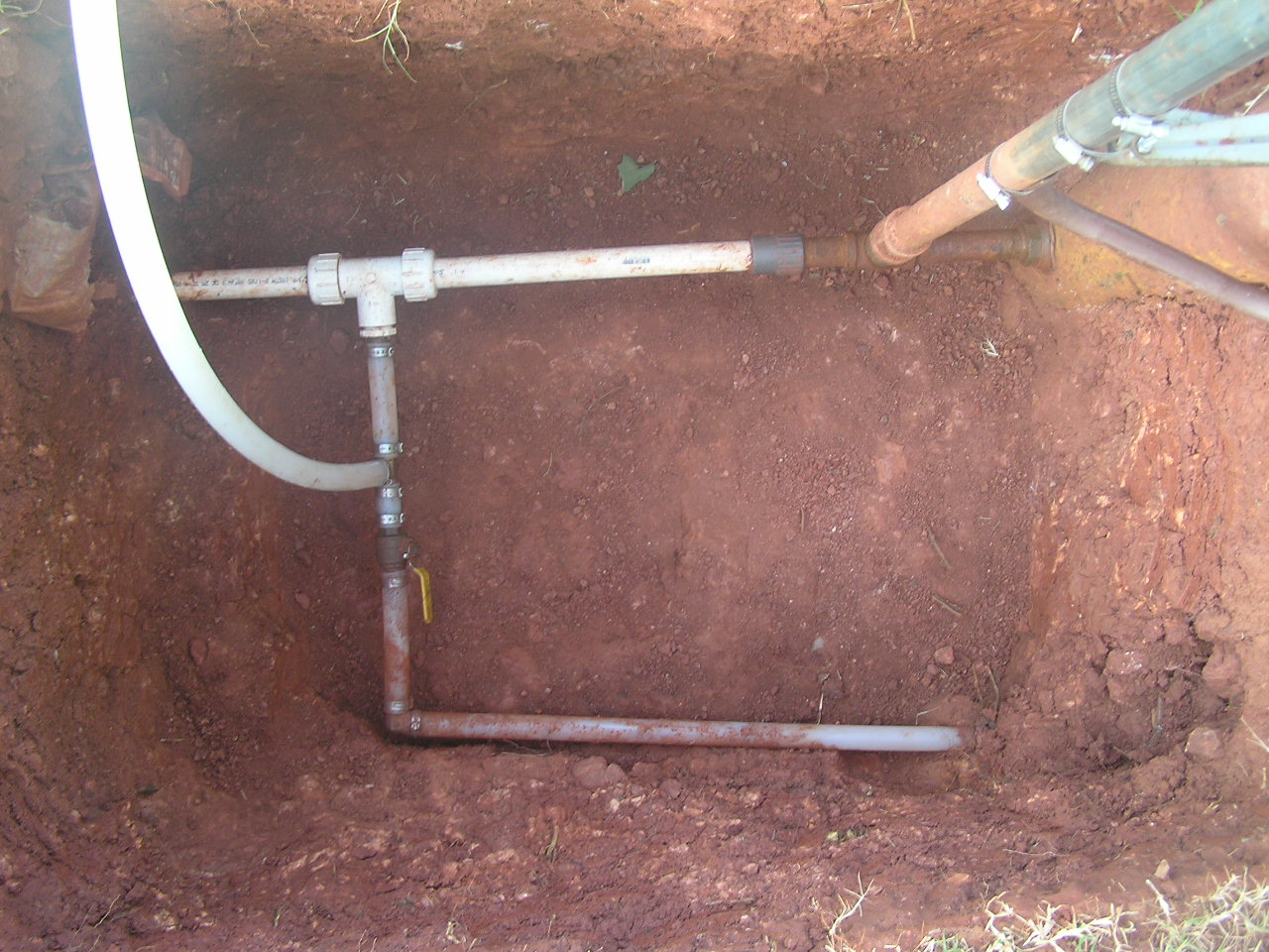

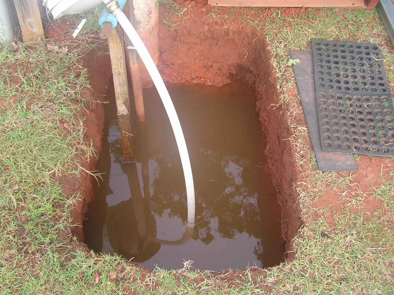

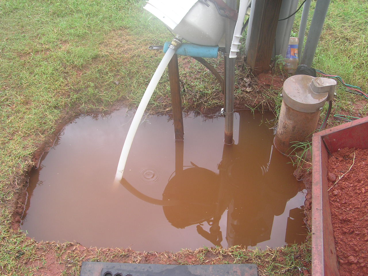

The project is in a rain delay after 1.9 inches fell today. :(
432384-water-well-pump-monitor-p7090007-jpg
432385-water-well-pump-monitor-p7090009-jpg
The hole is about 30 inches deep at the center.
Water level dropped six inches in six hours.
432418-water-well-pump-monitor-p7090003-jpg

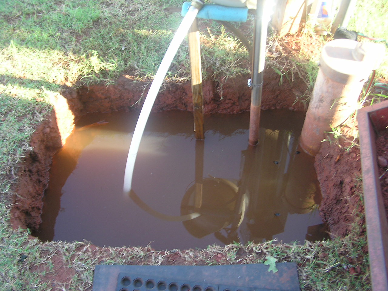

You need to pump that surface runoff water out. It will saturate and destabilize the hole.
   / Water Well Pump Monitor???
#68

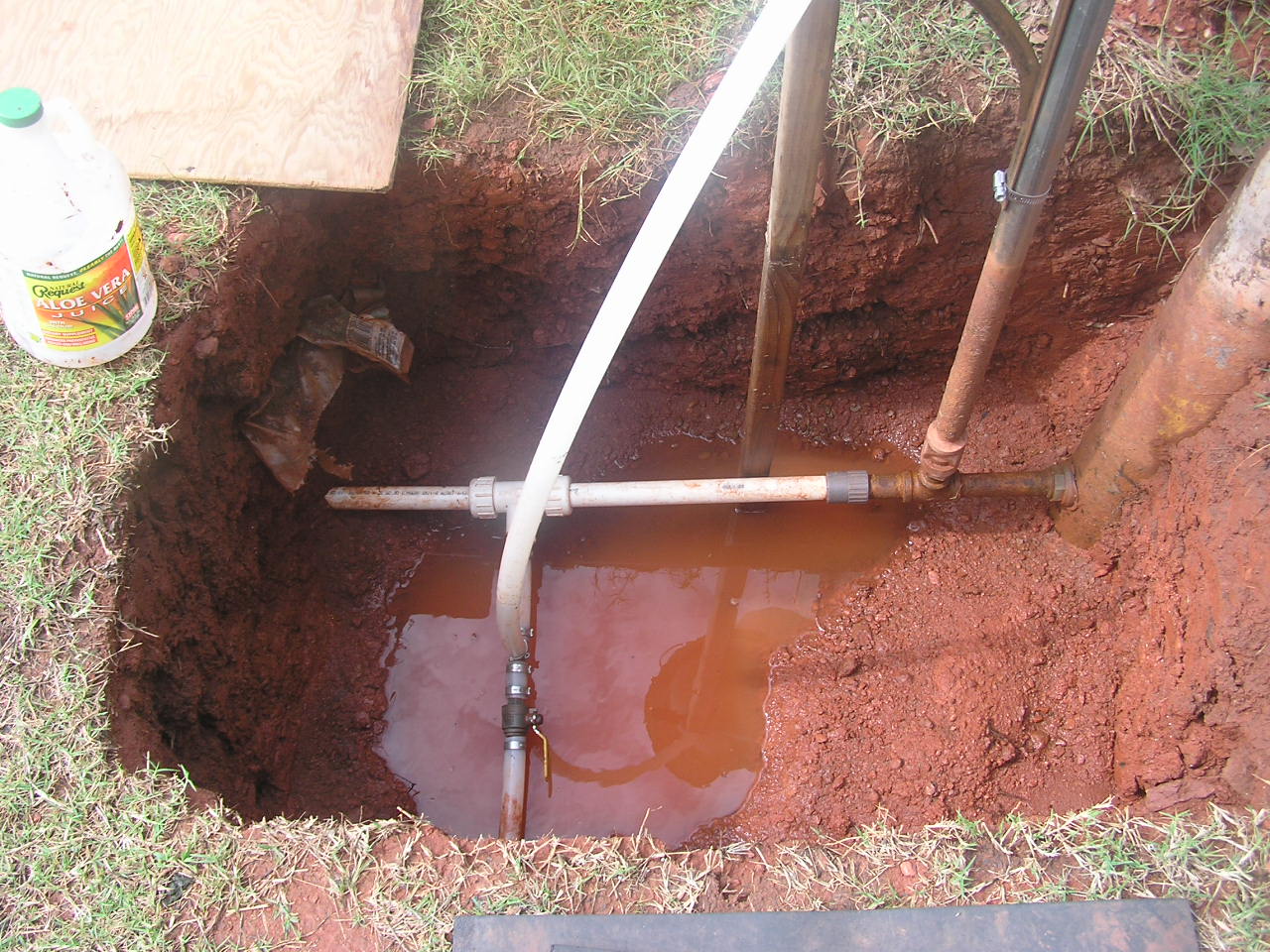

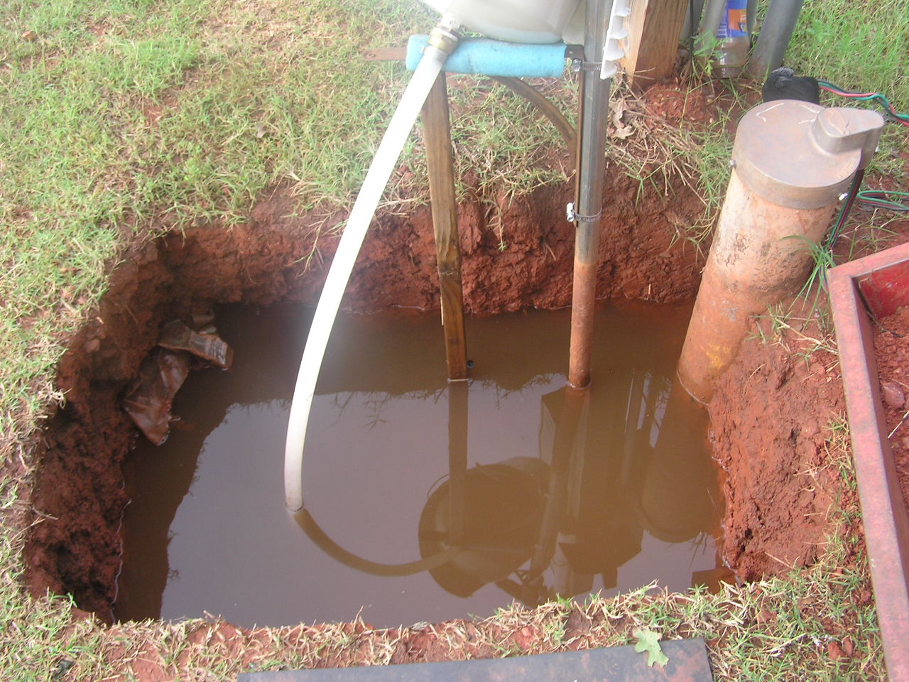

The water level dropped another six inches over night.
attachment.php
attachment.php
Yep, "Pumped" it out using a gallon jug, with part of the top cut away! Now my arm is destabilized. :eek:

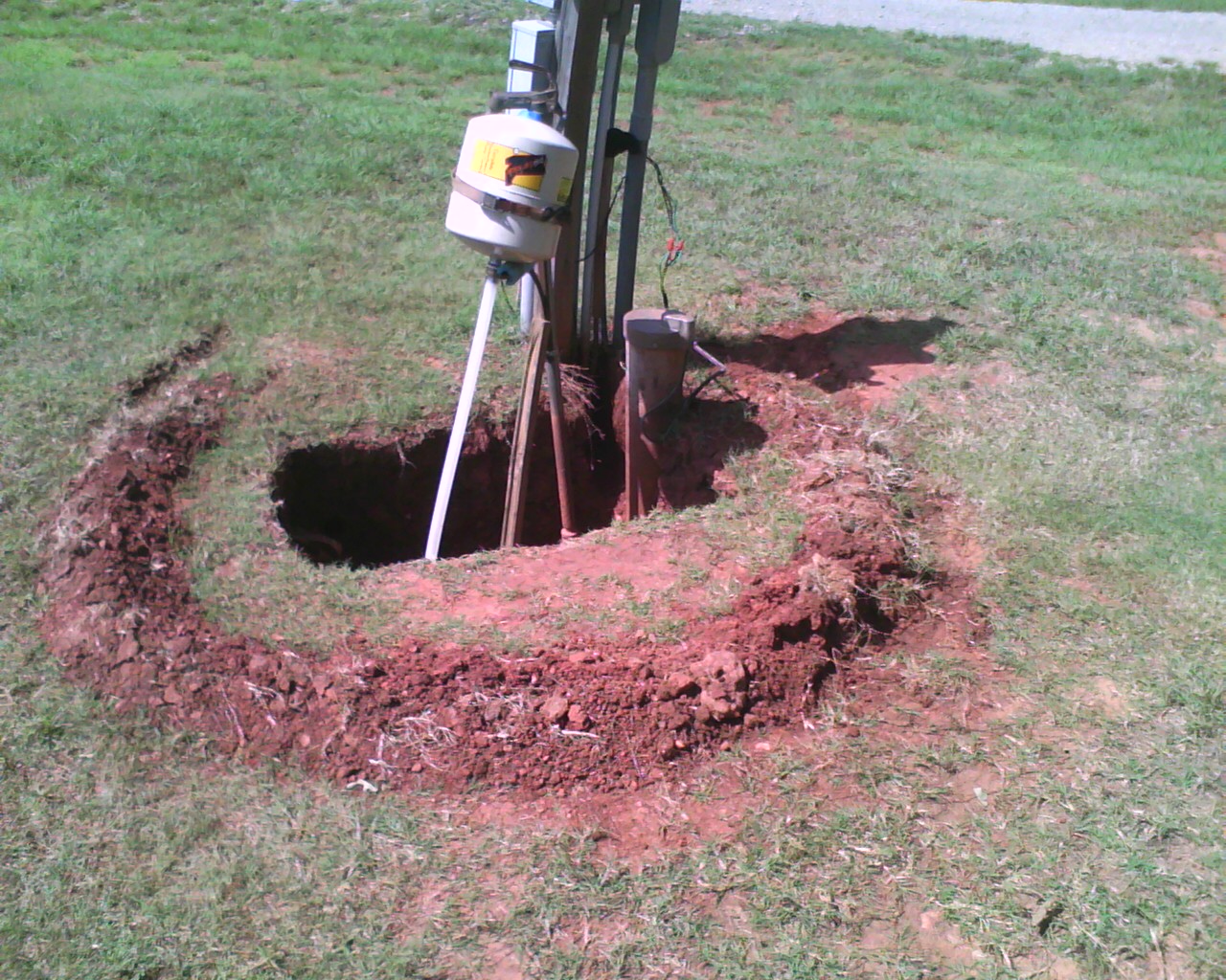

Moved the support bracket and tank to the center of the hole, that will make it easier to put the underground box in the hole.
attachment.php
Made a diversion dam and shallow trench to keep rain runoff from filling the hole again. :thumbsup:
attachment.php

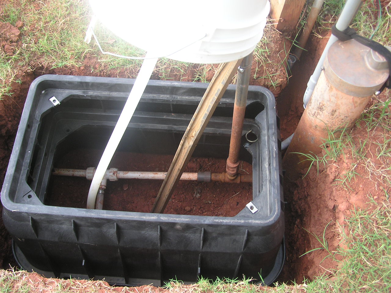

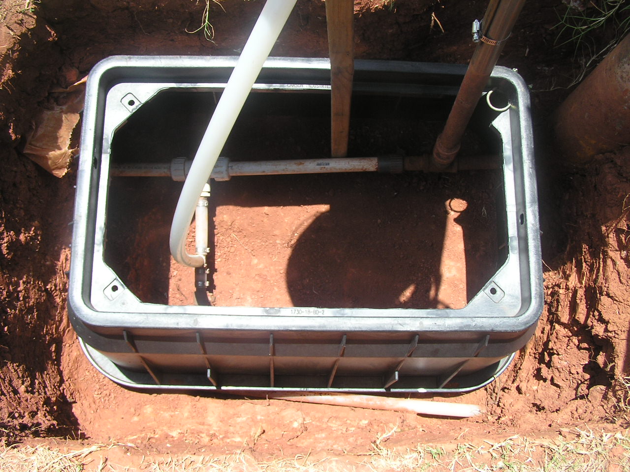

#70

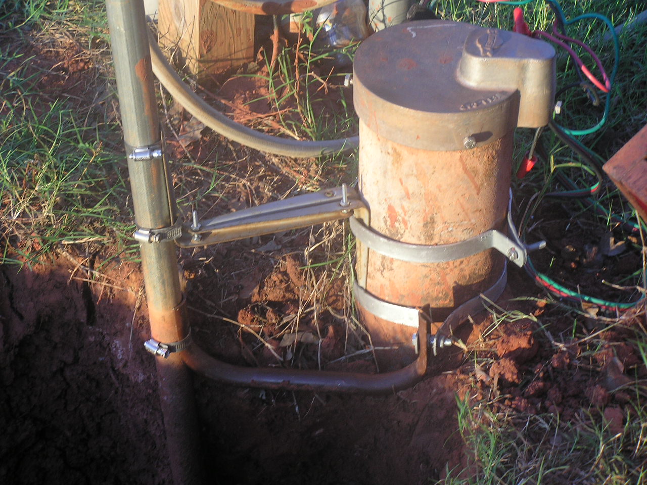

It has been too hot to do anything during the day, so I do a couple of hours in the mornings.
Last week I got the PVC conduit made up to run the wiring for the pressure switch.
attachment.php
attachment.php
This shows the top box in the hole. The hydrant will be installed in the corner were the slots are cut. It will be held in by U-bolts.
attachment.php
