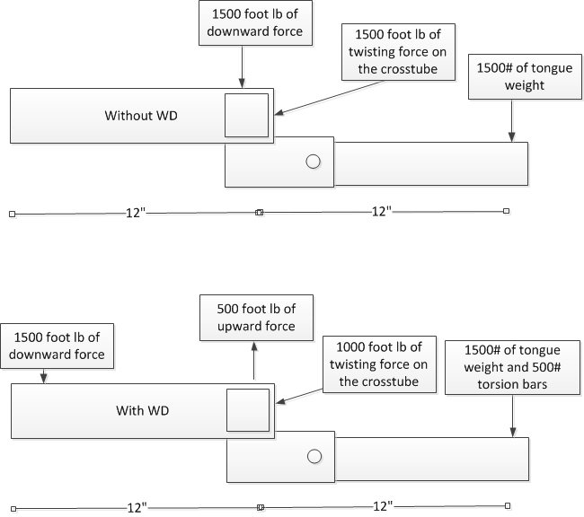

A WD hitch is going to put at least as much strain on the frame as a non-WD hitch. Think about the loading, instead of vertical downward loading in the back of the hitch, you now have upward loading on the back of the hitch and at least as much downward loading on the the front of the hitch. See below for an illustration
What WD gives you is less bending movement on the hitch which allows a lighter (and cheaper) crosstube.

Not really since it is actually reversing the conventional torque load on the tube to the other direction to load the front tires. Can't really make it lighter.
