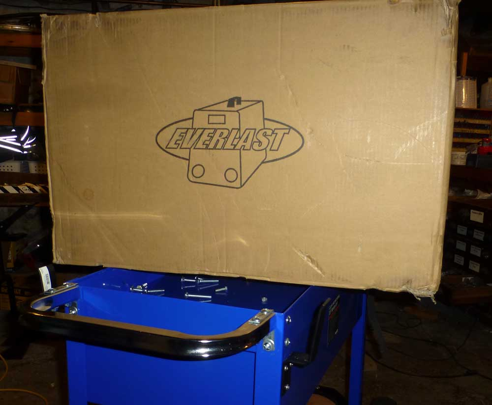

My deluxe welder showed up yesterday but i could not get it unboxed and placed in the carts top. I should be able to do this today. On a side bar I've had medical issues AND i had a job interview yesterday AND spring melt water is pouring into the basement. :LOL:

Welder was added but no photos yet. Will get some soon. Sorry for the delay.

I'm home today and I'll get to mess with the carts some. I've got a fellow coming by to wire in a plugin for it soon. I now see I need to move one cable hook since the cable will impede the drawer.... 😤 In this photo you can se the bumpers added to keep the welding in its proper postion AND it was a tab to low in the cart.

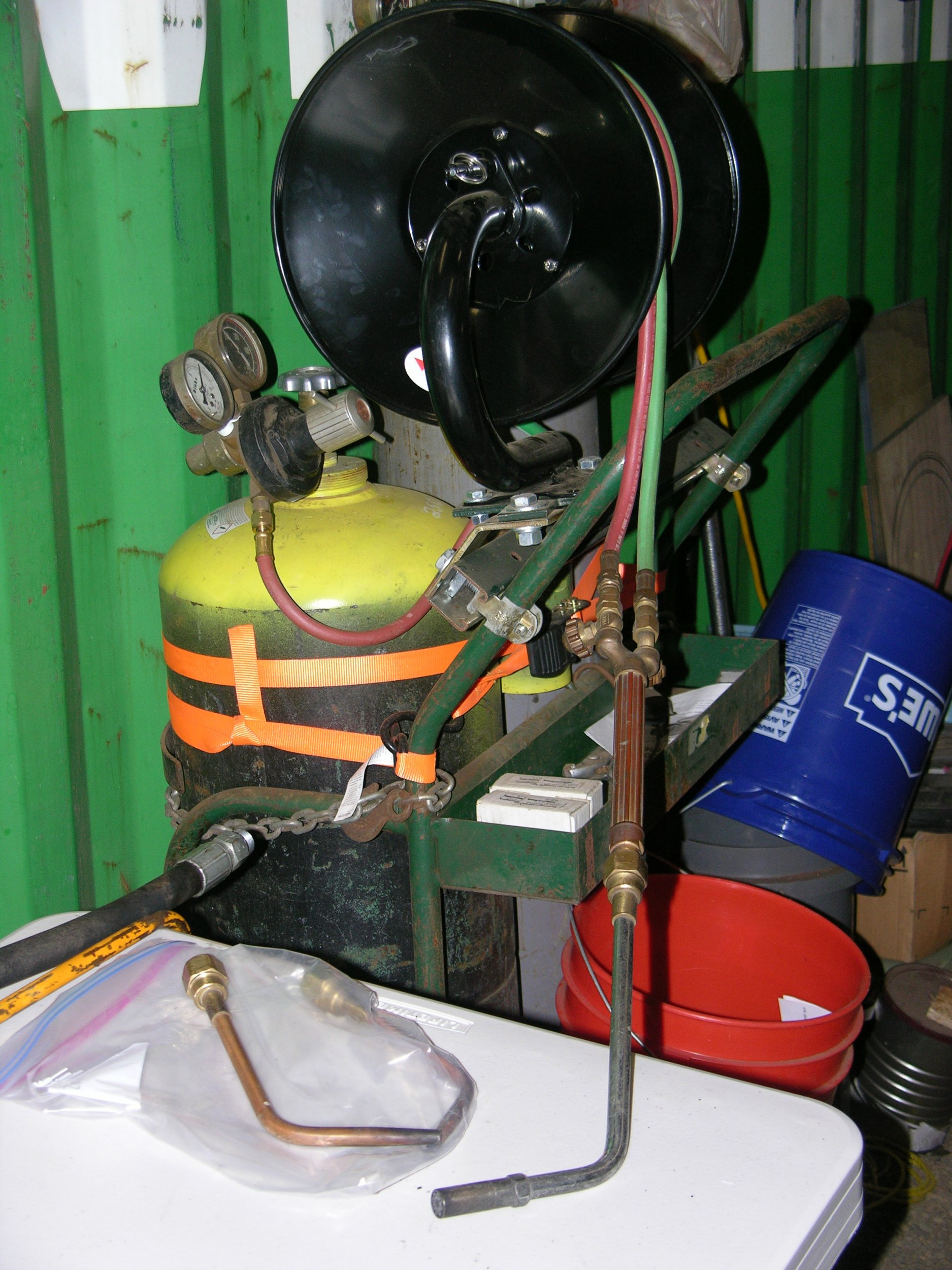

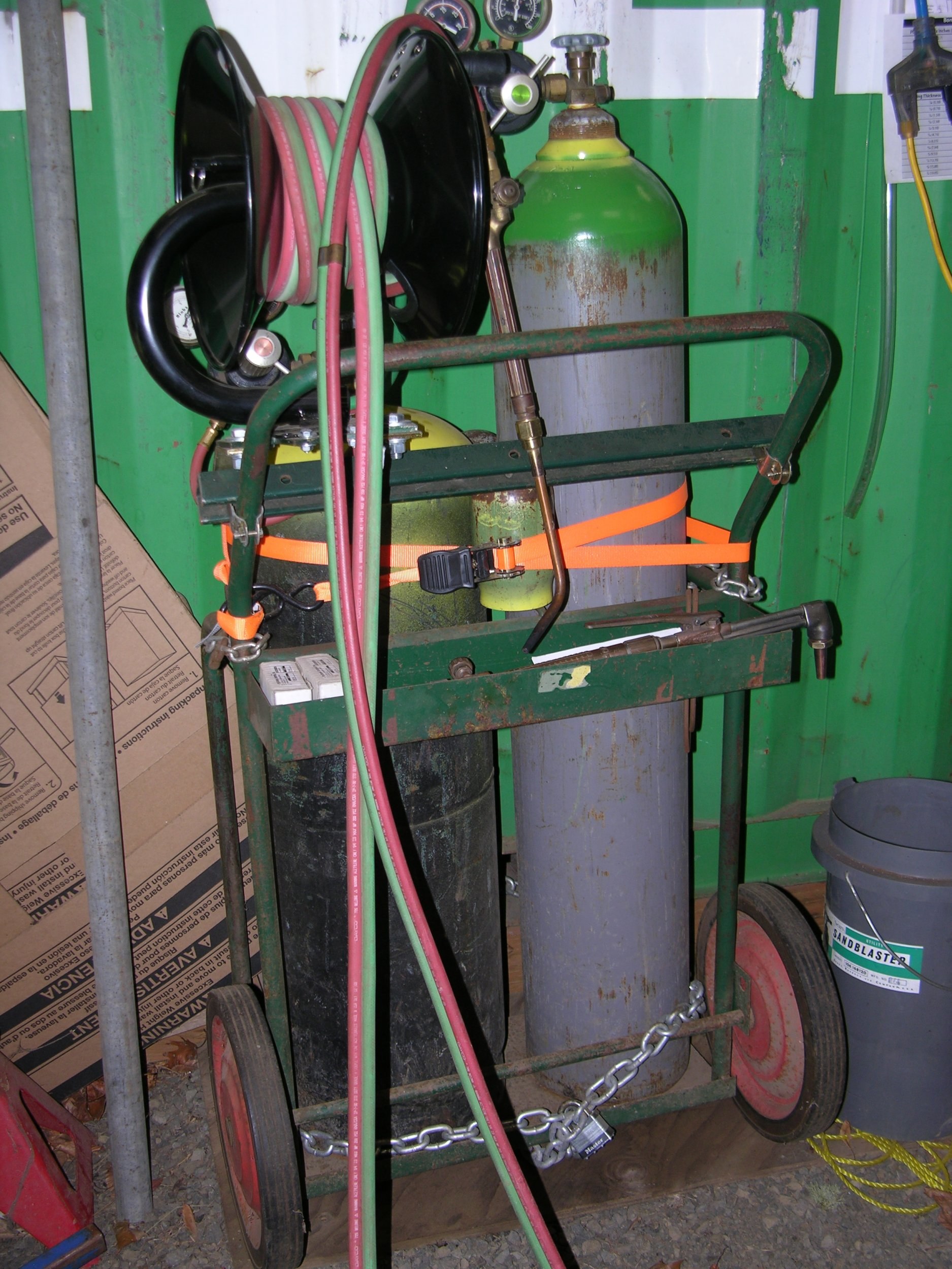

I discovered about 20 years ago that dead freezers aren't useless - this one was about 30 cubic feet, had a little mushroom thing over a drain hole in the bottom - I relocated that to the top and added a grommet to the bottom hole for a "outhouse" light fixture, running a 100 watt "rough service" (turned down to about half with a "drill speed control" - don't remember when I changed the bulb last, but it was probably about 10 YEAR ago.
I started with 60 watt (no speed control), changed bulbs nearly every month or two.
Everything in there is either delicate, expensive or "rustable", that includes welding wire (I have a rod oven for LoHi rod and sealable canisters for other rods.
One of these days I might get around to bulding more convenient shelving, just gotta find more of those "tuits"... Steve
