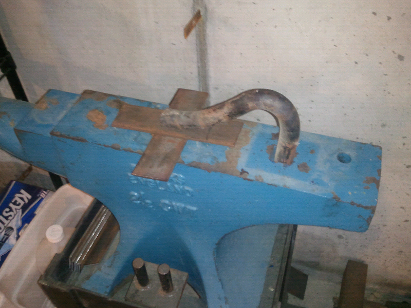

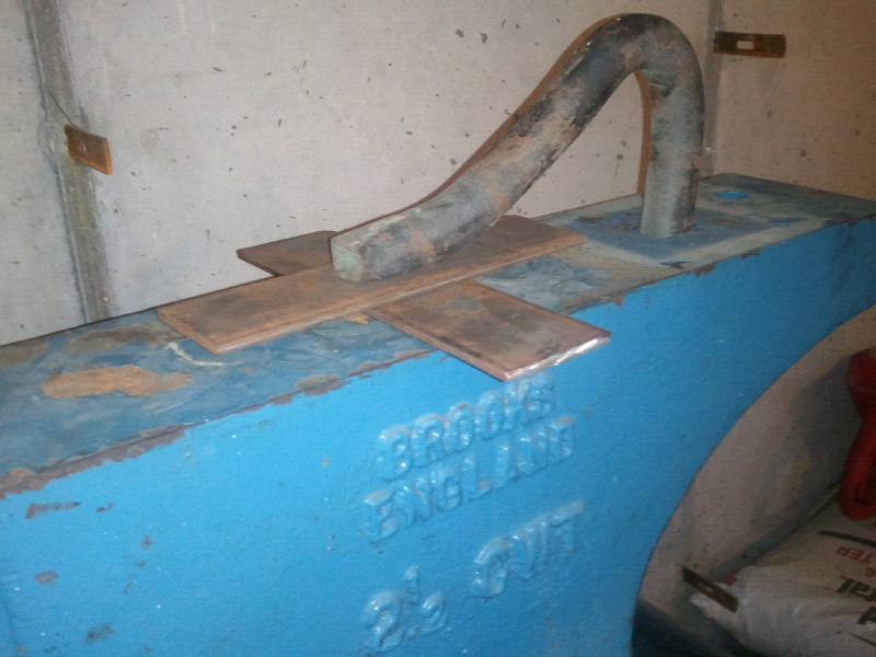

if you just want to clamp steel in place for welding, start by taking round stock and bending it past 90 degrees. I use 3/4 inch and bigger. Then drill holes that are 1/16 inch bigger diameter than the rod. The way it works is when dropped in the hole the tip hits and off sets the vertical riser against the holes edge. Need a tighter bight, smack the top down. Done with the clamp, smack the back of the clamp and it comes lose.
And you just need to have round stock, cheap and easy
/ welding table slots #26
I believe this is what your getting at. I use them all the time, and I was confused reading it. LOL!
