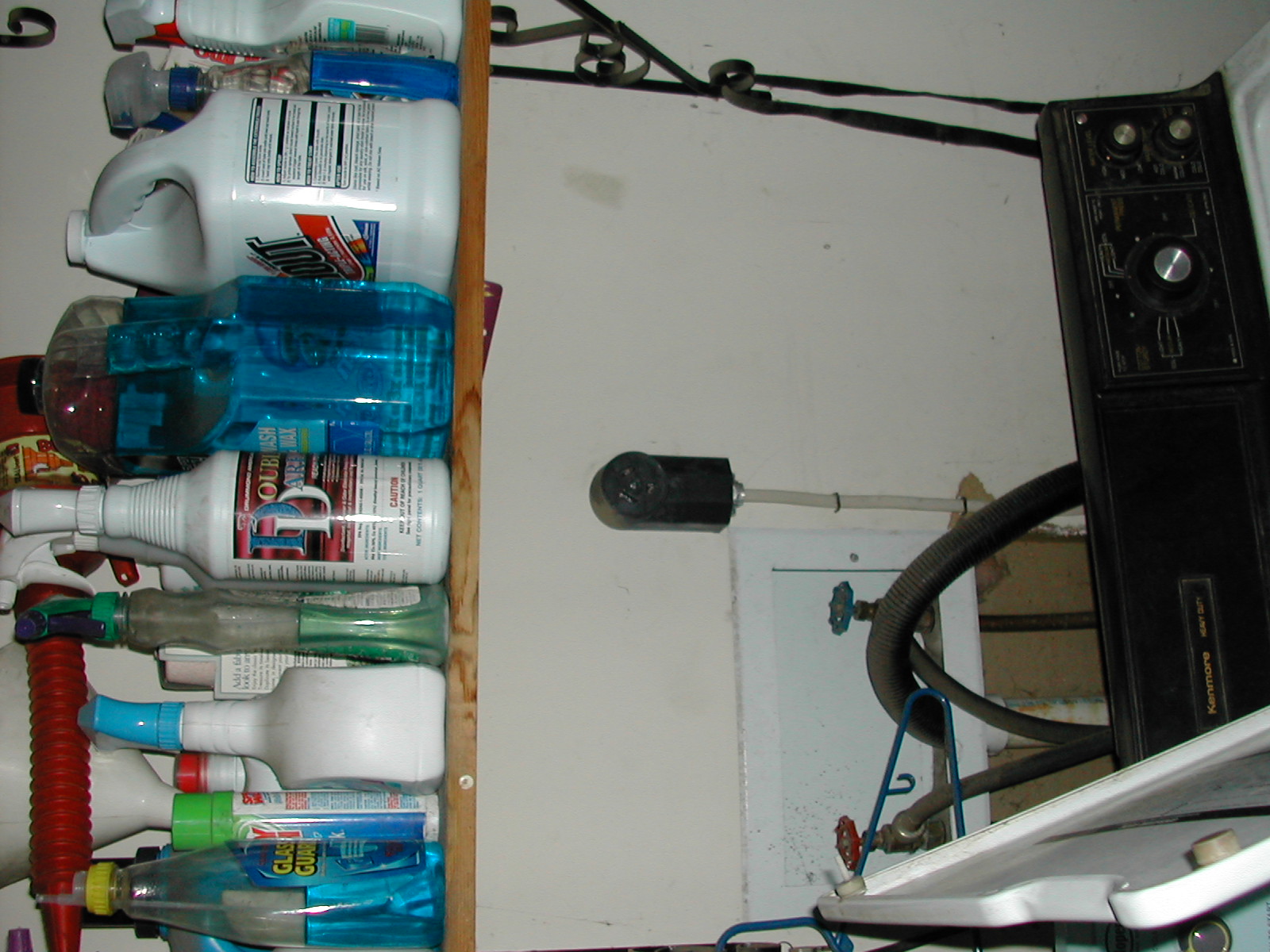

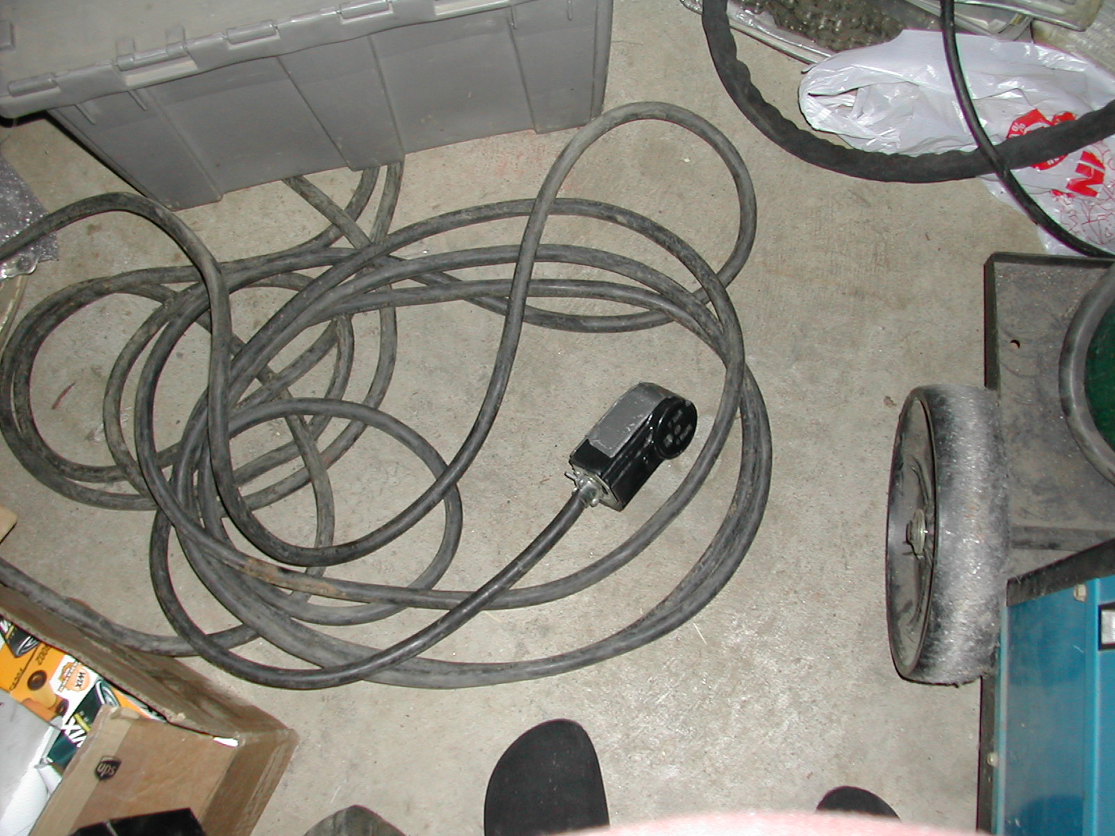

I'll throw in my three cents. I have a HF AC buzzbox, a lincoln weldpak 110v, a hobart handler 175, and a craftsman AC/DC stick. Each has different capabilities, each has different limitations.
HF buzzbox: It's like learning to drive on a manual trans car with no power steering. It'll do what you ask, but it's hard to get it right. I use it mostly to teach new weldors how to strike an arc and run a bead.
Weldpak: I have the gas mod to make it a true mig, but I run it mostly with fluxcore. It doesn't have great penetration, but is great for tacking stuff in place, which I then take back to the shop for the big welders to finish. It's also very good for sheetmetal work. One caveat to a 110v welder: You can't just plug it into the wall and hope for the best. I honestly think this is why most people that have tried them dislike them. You need to have a dedicated 20a outlet to run them at anywhere near full capacity. If you plug them into an outside outlet that also runs all the lights, etc. and it can only draw maybe 10a, you're going to get crappy welds. GIGO.
Handler 175: My workhorse. I've set it up with C25 and .030 wire. It'll weld from sheetmetal to 3/16 easily in a single pass, bigger with multiple passes, preheat, or fluxcore.
AC/DC stick: Big paperweight, most of the time. It'll do 180a DC, 240a AC. It works well, and the difference between AC adn DC is night and day. I honestly don't think I've had it on AC more than twice in the some years I've owned it. When I do use it is on metal where I need it to stick together, but not necessarily be pretty, or I don't have the time to properly grind every weld surface to shiny metal. I'm not one of the 'use 6011 and go through mud and rust' guys, but I am much less worried about it when using the stick welder. My preferred rod is 7014DC.
I run almost all (other than the weldpak) of these welders off of one, 50a plug. What I did was get a breaker, wire, and outlet all rated for 50a, and had that installed. Then I bought a bunch of dryer plug pigtails that fit it, and put a receptacle that matched my welder's plug on the other end. That way, I didn't have to modify the welders to fit the outlet, and I have a plug that's capable of running the biggest welder I'd ever likely have in my shop. I also had put in a single 110v plug on a 20a circuit with wire and outlet rated for a full 20a. This is what the weldpak gets plugged into.
