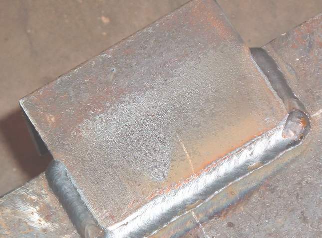

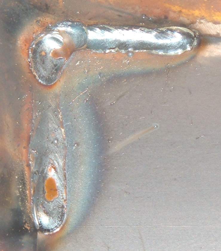

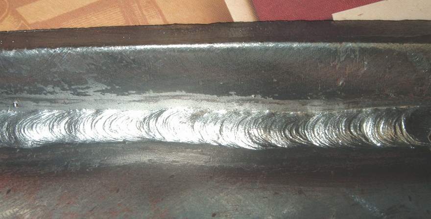

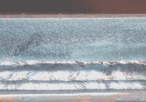

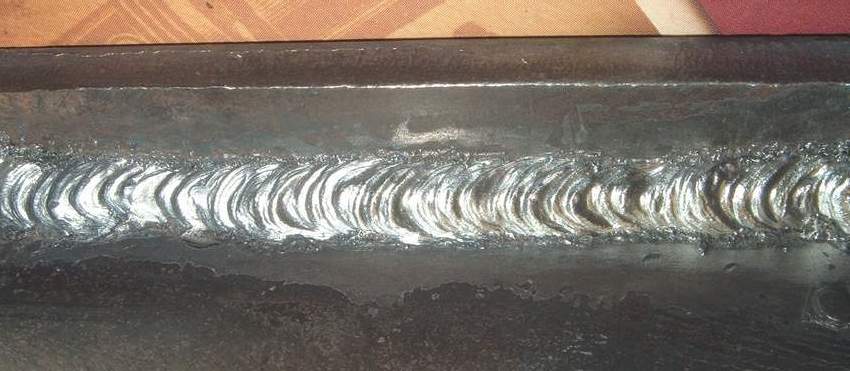

The ones that are listed as OH are overhead.
