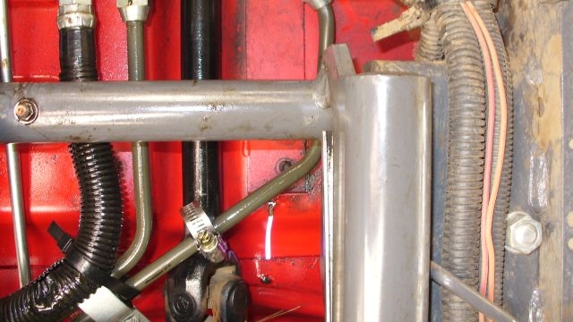

Did the unforgivable.... While working brush, I manage to poke a branch (I guess) up under my GC1715.... Unknown to me it bent a hydraulic line up against the drive shaft and drive shaft actually ground through the steel hydraulic line.... First clue was a trail of oil drops across the ground.... And yes its going to be a nasty job to fix... After looking at it its going to take removal of floor boards, ROPS, seat, and fender assembly.... Tractor is now sitting at dealer waiting repair estimate, after looking at it all weekend needed repair job is just to much for me..... Besides it was due for its next 250 hour hydraulics(HST) and front axle oil/fluid changes....
Yes there is a hose clamp on line, and yes there is a piece of rubber under clamp over hole in line, no its not a permeant fix, but it did slow the flow a lot so I could move it around and load it on trailer....And no the after market hydraulic filter guard would probably not have protected hydraulic line.... I guess moral of story is maybe one should inspect underside of tractor more often....

Well its good for you but hydraulic line on the MF is also up between the rails (about 3 inches above rail bottom) but when you poke the end of a stick up between the rails.....

Actually stick has to go up about 14-16 inches to get hydraulic line, the 6.7 inches is not real, mine has more room under it than that...

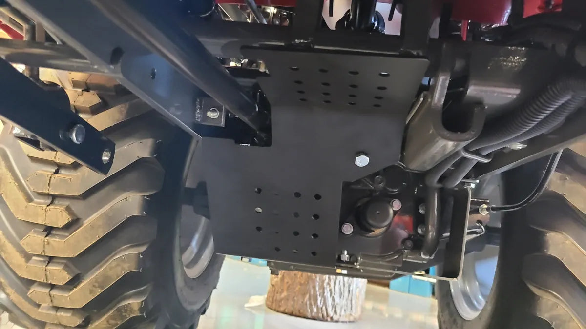

My tractor came from the dealer with a custom built skid plate, glad it’s there but when working in brush there is no guarantee something won’t manage to get in where it’s not supposed to and cause problems.

Jt’s already at the dealer so it’s a moot point but from here it sure looks like you could splice in a union And a ew piece of tuning somewhere on either side of the leak. Maybe not pretty but not expensive either. But you are likely better off taking the route you did.

I hear you. My machine has ZERO exposed components under it. All plate steel front to back....
EXCEPT! (there's always an except!) there are a few 1" drain holes and a hole to get to the oil drain plug. Several times a stick has come up through that 1" hole in the footwell and stabbed me in the leg! Ouch! The chances are pretty slim, but if there's a way, it can happen. 🙃

Yep!.... Lookin for plate and bracket material while tractor is in shop, probably first project with it when it gets home....
mines till in box but...unlike others this is ventilated for airflow
