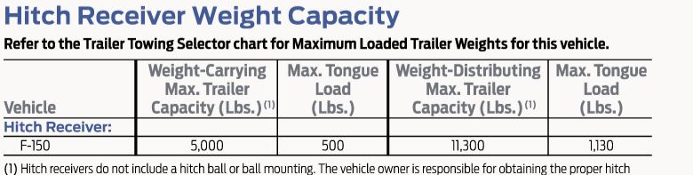

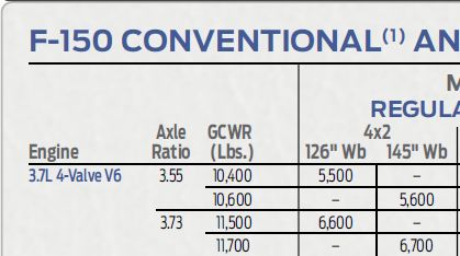

Your truck being equipped with the V6 non EcoBoost is limited to a max trailer weight of 5,600# per Ford. Per Ford also any trailer over 5,000# requires a WD hitch.
So to simplify things.
Max Tow: 5,600#
Max Tow Without WD: 5,000#
Chris
   / What can I tow ? Sooooo confused #12
Your bumper receiver is rated for up to 10,000 lbs by itself. .
Go read the sticker right below that one that says vehicle tow rating may be less.
   / What can I tow ? Sooooo confused #13
He asked what it is rated for. That is what a Class 4 receiver is rated for.

With your engine and gearing combination, things will get a little uncomfortable at around 7000 lbs. Your chassis will certainly take that, but you will be working the drivetrain. The number you see in your owners manual is the "suggested" maximum. Your legal maximums are found on the drivers door sticker. Those are the numbers you may not exceed legally.
Any trailer rated for more than 3000 lbs is required by law to have at least one braking axle. Braking is not an issue
Your bumper receiver is rated for up to 10,000 lbs by itself. It's up to you to select the stinger and ball of the correct capacity.
It is highly recommended to use a weight distribution setup for anything over 5000 lbs. Particularly RV's.
Not too worried about the 7000 #. Never gonna tow that . Funny thing is there is no mention of tow weight on door stickers . That 's why I had to got to charts . Yes, trailer brakes are a must at those limits . Also I 'm a big fan of weight distribution .
Kinda funny because I don 't own a cargo trailer that can load above 2000# ,but I might win the lotto one day :thumbsup: . Kind of a guy thing . We just like to know what our trucks can do, in case

Chris, that 's what I was thinkin' from the charts, but I wanted to see what others on TBN thought independently . I don 't know much about camper trailers, but I 'm wondering where that number fits in with campers size with cargo.
