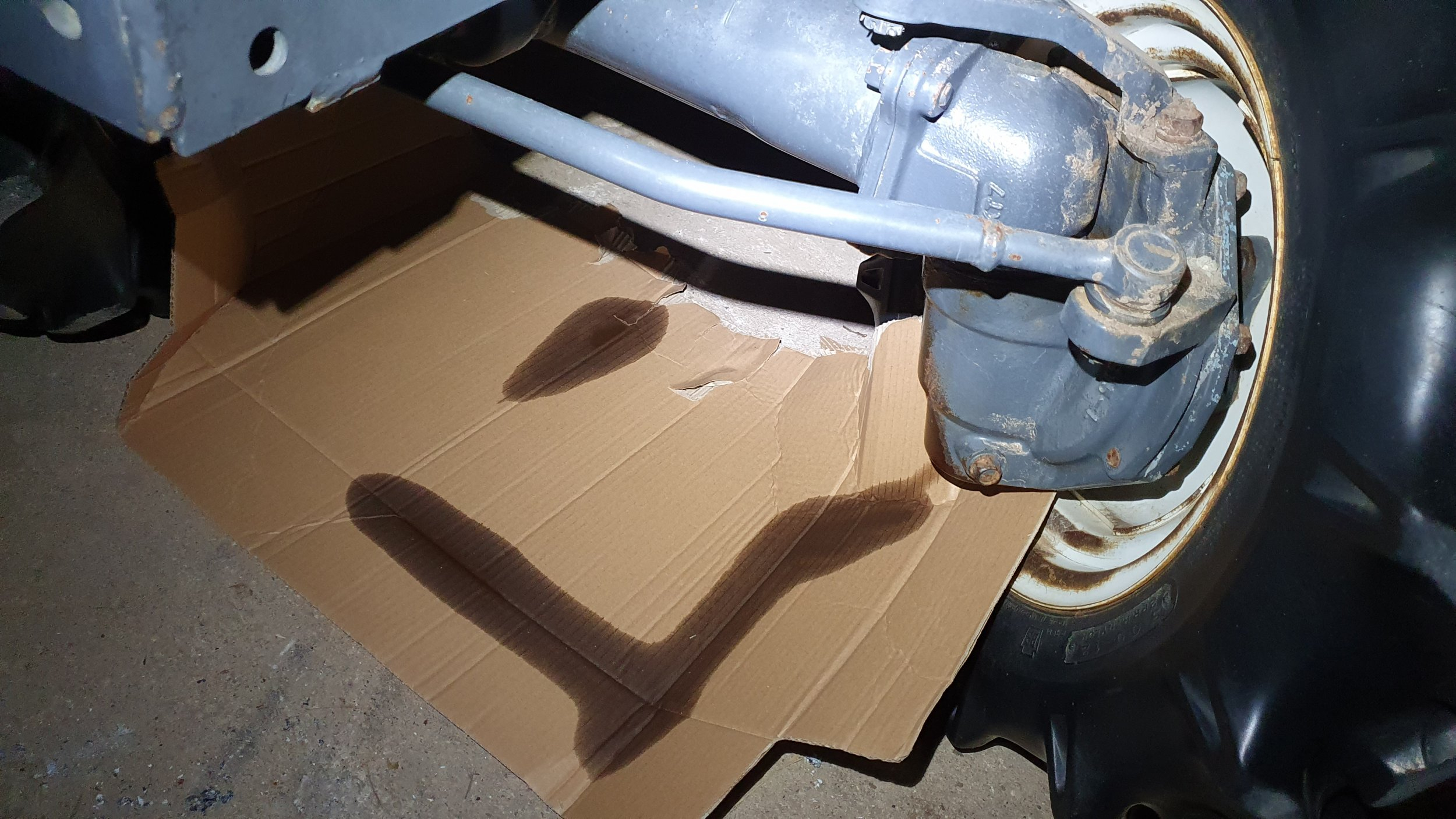

Oh no... First problems...
A tractor was stored in a garage for a week and here comes a trouble: front axle final drive and steering pivot axle seals are leaking!
It was driven just a few times on the snow for a test and that's it.
   / What Did I Purchase? #58
"It was driven just a few times on the snow" Are you using this for snow removal? If so this is what I would do. Keep an eye on the oil level and fix it when it is warmer. It has been my observation that when fixing something it is always easier ,with a higher rate of success the first time, when the repair is not done in the cold
Chances are you will find that in the short term it is both easier and cheaper to just keep an eye on the oil level. That would be your decision though
That said ,if it is leaking profusely [to me it doesn't look that way from the picture attached] you will want to get it sealed up again.
How long did it take for this oil to leak out?

No, I didn't use a tractor for snow removal. I did just some test drive. And it was left with the wheels completely in the left position. Maybe that could cause a leakage. With the wheels in straight position there was no leak noticed.
Week ago I've noticed a few drops of oil on the ground. This is why I put some cardboard underneath. And here is what i found yesterday. But it's not a problem to leave it until warmer time. I have another tractor to clear snow if necessary.

With the extra info you have given it seems like a seal that is drying out/hardening. There are some products that when applied to the seal will "soften" them up restoring them for a period of time with out needing to replace the seal
Just a thought.... might be worth a try.
Good luck sir
