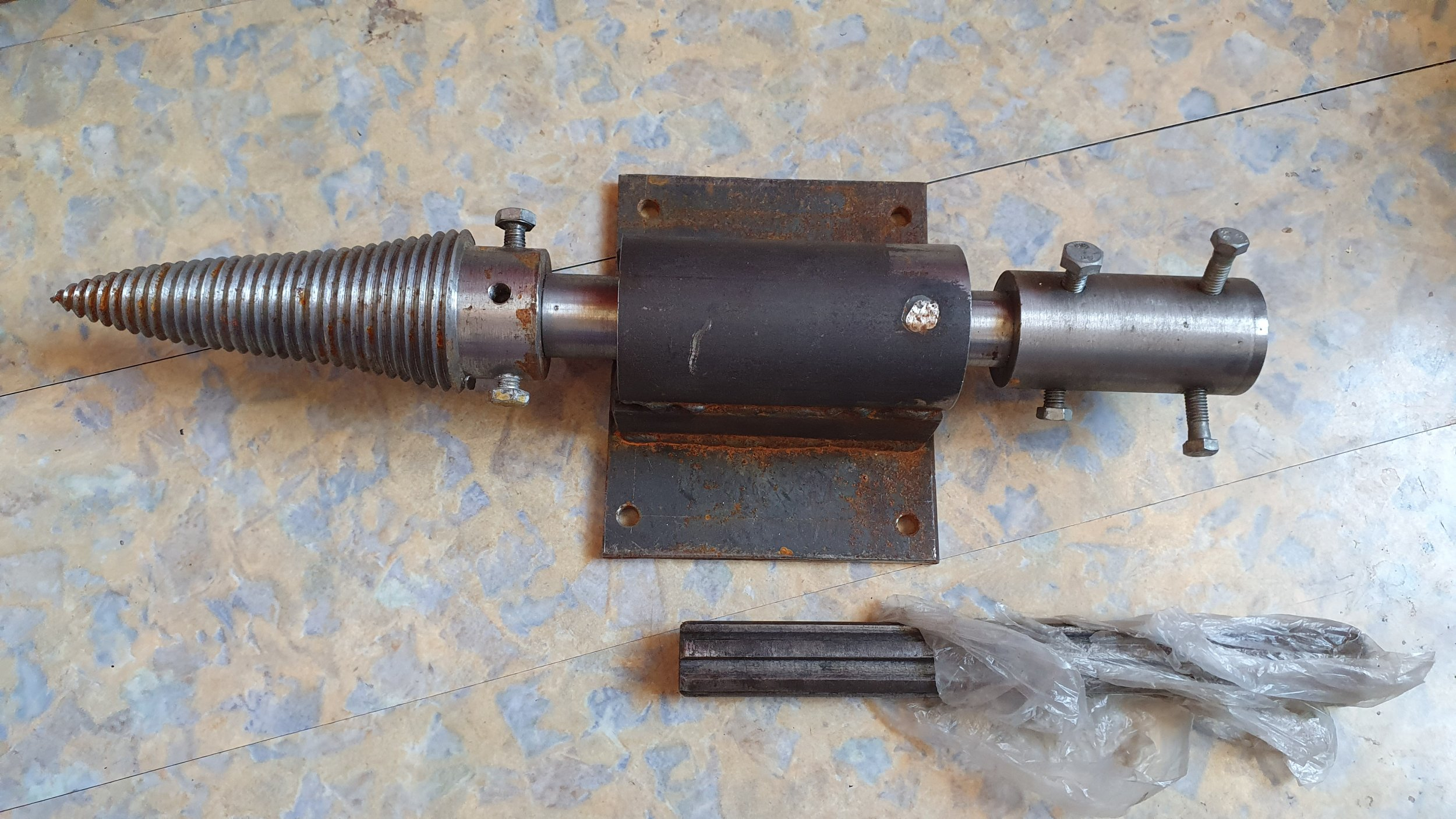

This probably will be my first attachment for this GB-15. 🤔:rolleyes:
I've bought it from a man who made it (lathe operator) for €70. They are more expensive here on the market than this price.
I will arrange it on a 3pt pallet forks which I'm gonna make myself so it'll be 2 attachments in one. I'll put that splitting screw on a steel plate, which will be screwed onto the forks. It'll be removable. Not a lot of work, not much expensive, hope it'll work well.
Be careful with this style of splitter. It can get really ugly really fast.
Weld a piece of flat bar vertically under the screw, leaving just a 40 to 60 mm of thread exposed so when the log is being split, the flat bar piece won't let it spin in a dangerous way.
Even if I know the emerging dangers, I still always thank everyone for warning.
Yes, for sure, it will be done. I've seen how that vertical bar should be arranged.
Thanks again for reminder. (y)

My promise.
It's interesting, because the screw consists of three different dimension cones. I never saw such before. Most of them have a double cone.

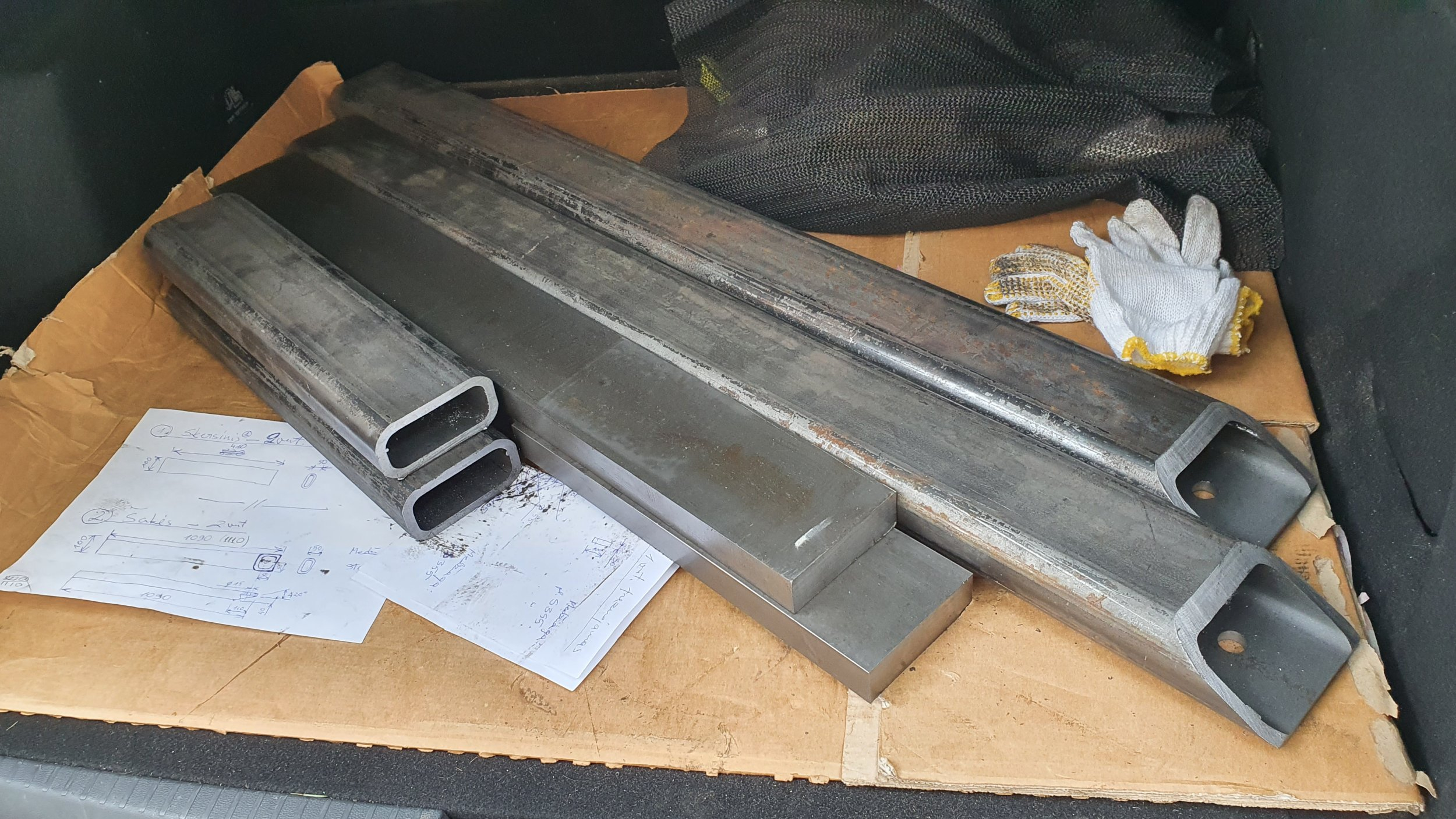

Today I've got some material for my 2 in 1 implement :)
pallet forks + screw log splitter​
Here it is:
1/ steel profile 100x50x10 mm for the forks;
2/ calibrated steel strip 100x20 mm, length 820 mm for the crossbars.
It costed me €100 totally.
   / What Did I Purchase? #70
That's a nice a deal. I would expect to be a lot more money for what you have there.
Looking forward to see more progress on this implement. (y)
