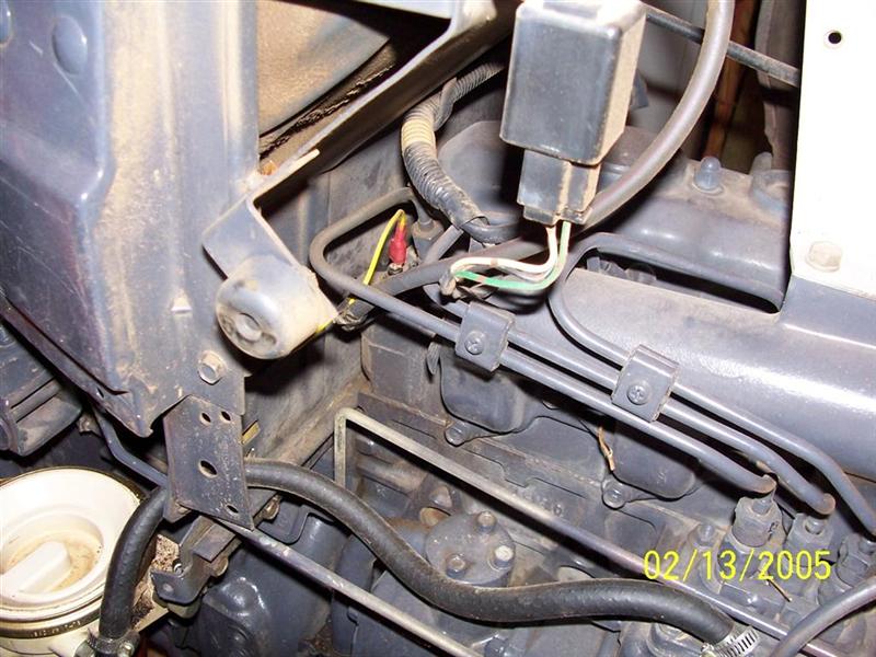

For the temp gauge I went with the standard Kubota set up because the sensor is the one for my engine. The gauge and sensor I bought from TractorSmart.com. While sitting on the tractor, on the back right side of the cylinder head, there is a plug where the sensor goes. You remove this plug and screw in the brass sensor. The plug is right next to a head bolt and injector. You should be able to tell which is which. From there you need to tap into a hot wire when the key is on, then the single wire from the sensor to the gauge. The gauge is marked + - S if I recall.
Wait, found the pics. First is the temp sender, you can see the yellow wire and red connector at the back of the head.

The oil sender, you can see the crass fitting in the far left sode if the picture. Then the plastic line wrapped around the large wiring harness....

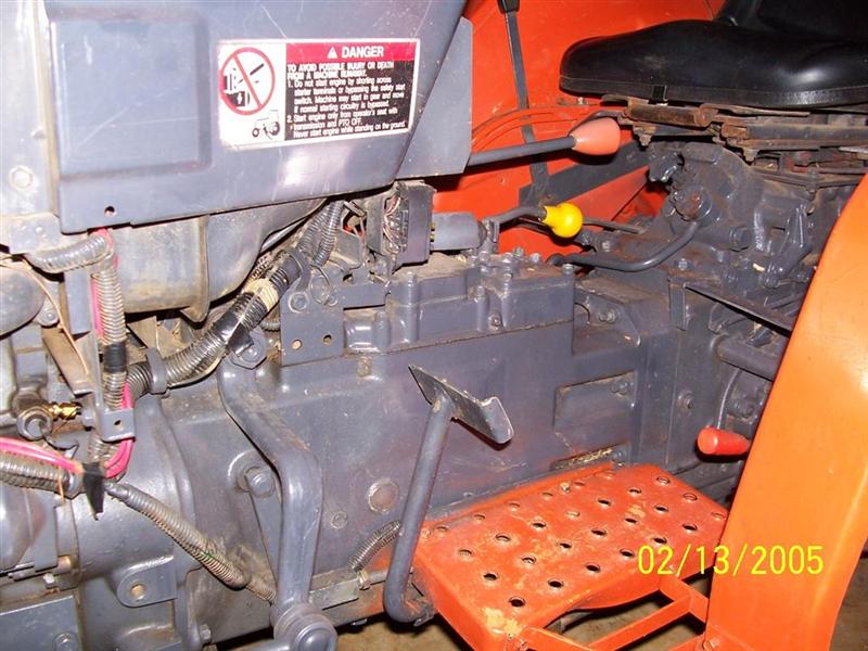

Another shot, you can see the shinny brass fitting just abouve the starter, the round/hex thing just in front of it is the oil pressure idiot light sensor. Looking at the top of the engine you can see the yellow temp sensor wire going into the back of the head.
BTW, the red wired going to and from the alternator are the ones I used for the amp gauge.
Good Luck!
