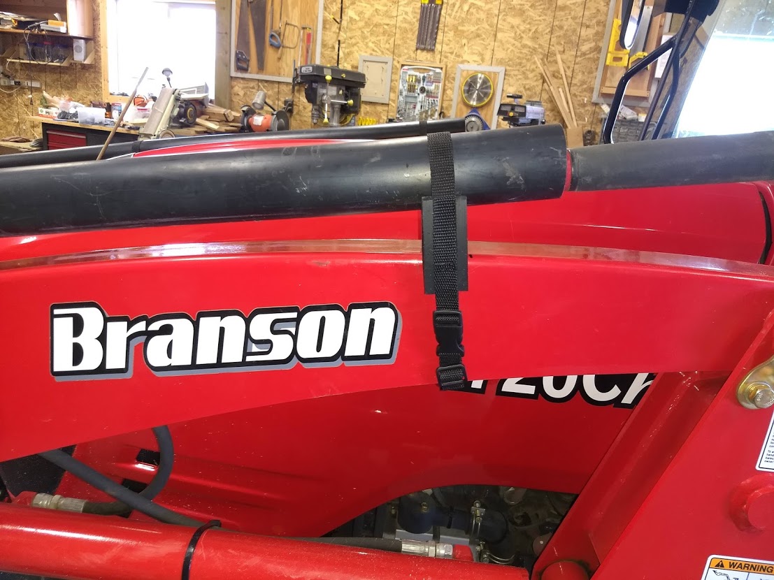

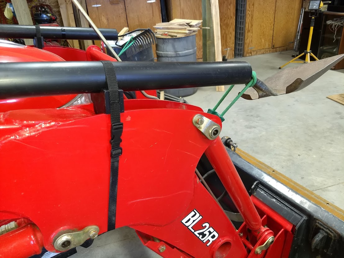

I got tired of never having the two most common tools with me: A shovel and a rake. There is no decent place to carry them on the Branson 4720ch, so I made a couple places out of some scrap 2" ABS pipe, some fabricated wooden support brackets and some nylon strapping. Probably an easier way, but this wasn't really that hard to make.

Cougsfan, that’s a first, seeing how it’s mounted! Wouldn’t it fly out while you are drifting?

Everything is easily removable for tractor drifting competition and ice racing:) Anyhow you might notice bungee cords wrapped around the tool business ends to hold them in place for the jumps and wheelies.
I had the ABS pipe laying around, but a 10' chunk of 2" ABS costs about $10. I used a 1 foot piece of 2x4 to make all 4 supports using my radial arm saw and belt sander. I should mention that the supports are notched to keep them from sliding sideways an the FEL rails. I painted the supports black to use up a partially full rattle can of spray paint. The 3/4 inch nylon belting and quick release plastic clips were left over from a motorcycle luggage project I did earlier, but can be bought on Amazon for under $10 (they cost a lot more at the hardware local store). The pipes are secured to the supports using wood screws. I think it would work on any FEL with minor modifications. I actually had the rake mounted last summer in the same pipe on a hack job for a mounting system and this is just a refinement. It worked just fine.
