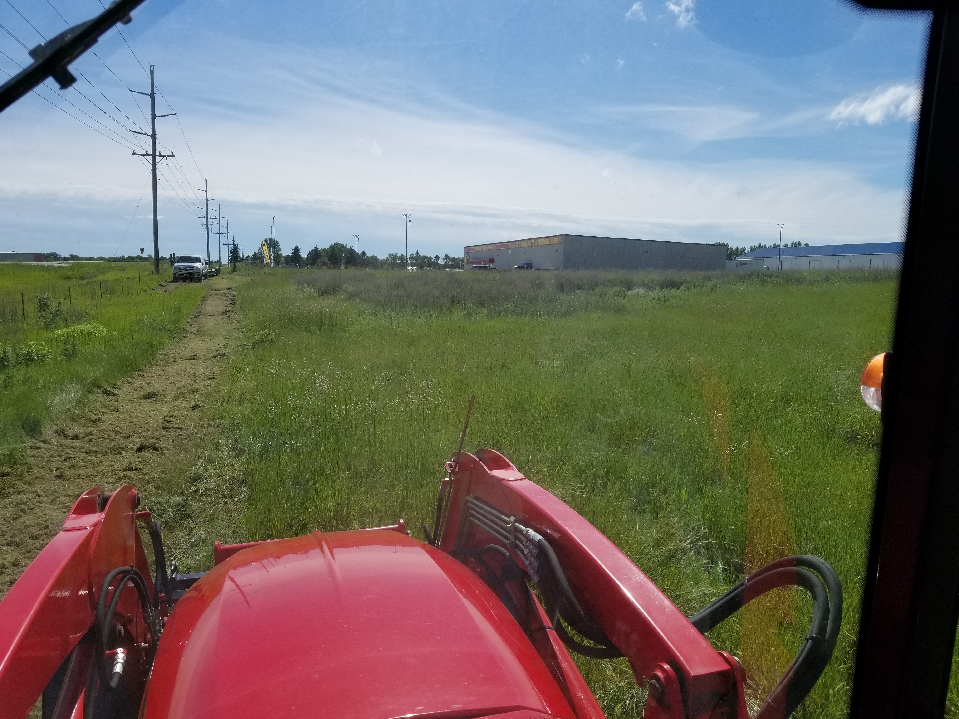

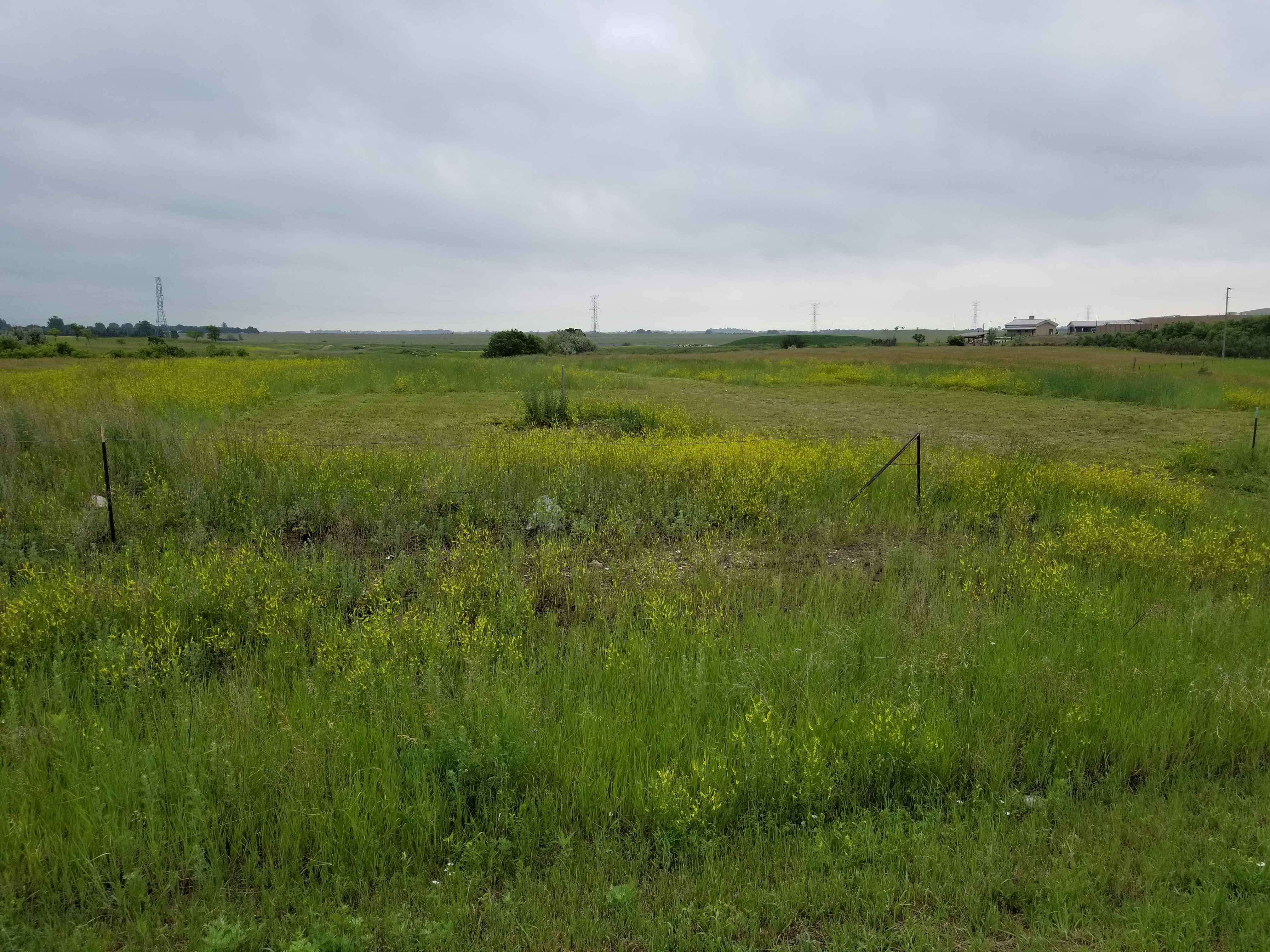

Got roped in to helping some folks that were up against a pretty severe time crunch. They needed some areas mowed because they have survey crews coming in next week. So an "excuse" to get some tractor time, and some mowing time. So we started yesterday, after some short heavy rains and thunderstorms delayed our start time to almost 10 am.
First, had to mow a staging area so they can come and setup some equipment, and have a place to drop off jobsite materials.

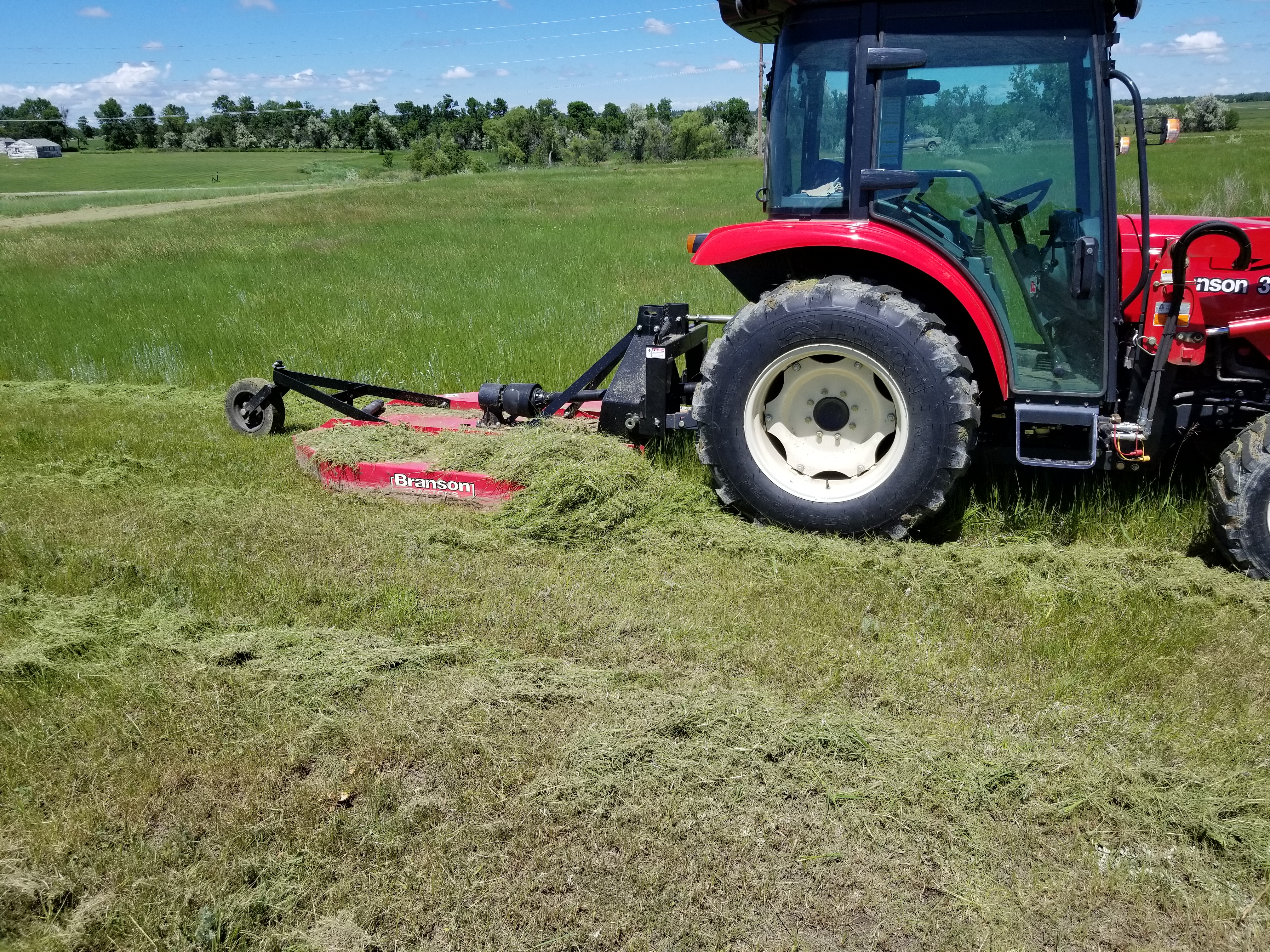

Field was pretty rough, has been ignored for the last 3 years straight. I ended up raising my mower height later on, to try to compensate for the rocks and thick grass. I had this set up to do my own road ditches with, and it was set up pretty low since I don't have rocks or debris to deal with.
EDIT-- The thumbnail at bottom is supposed to be here. Don't know what happened, or how to fix...

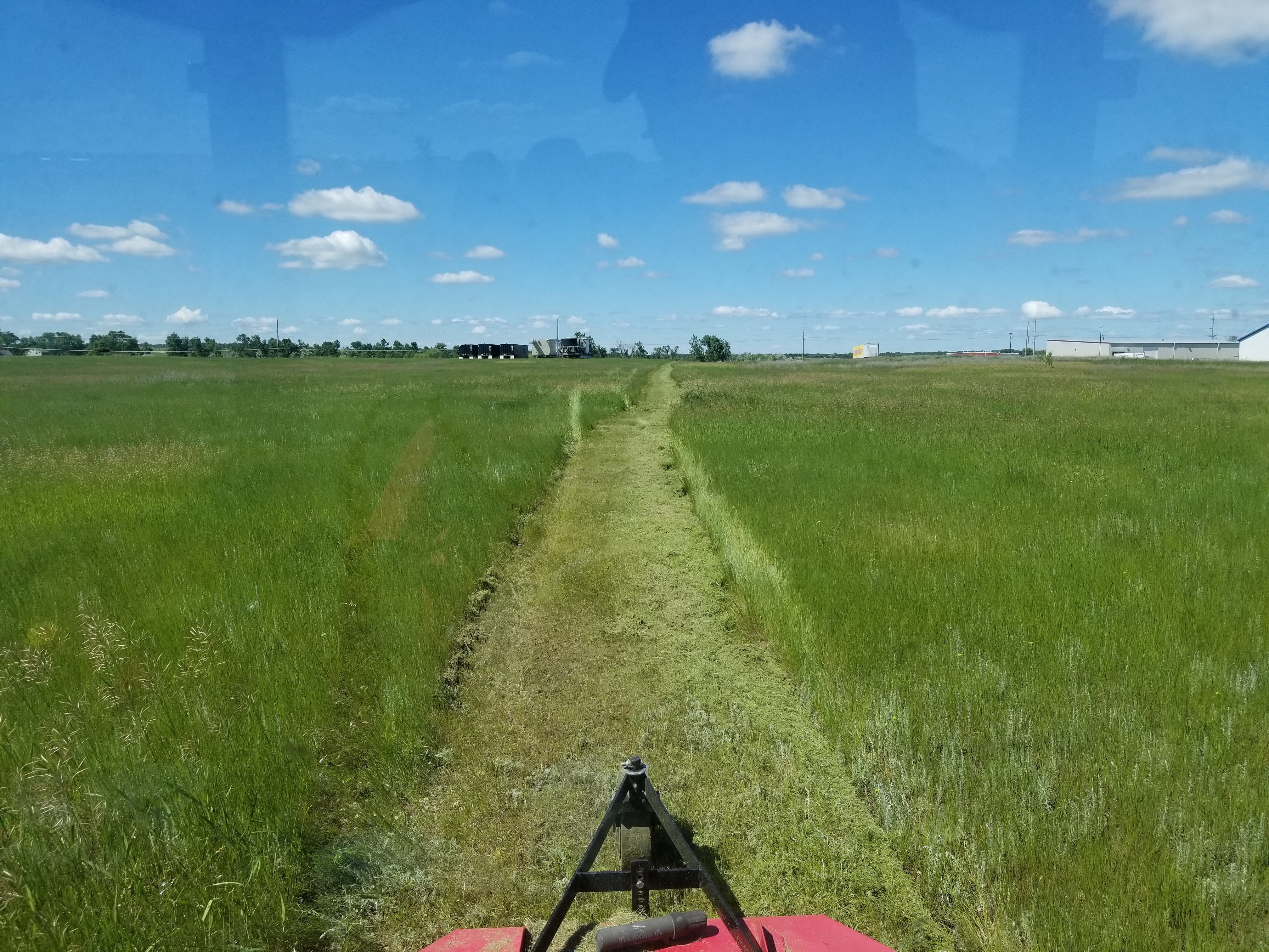

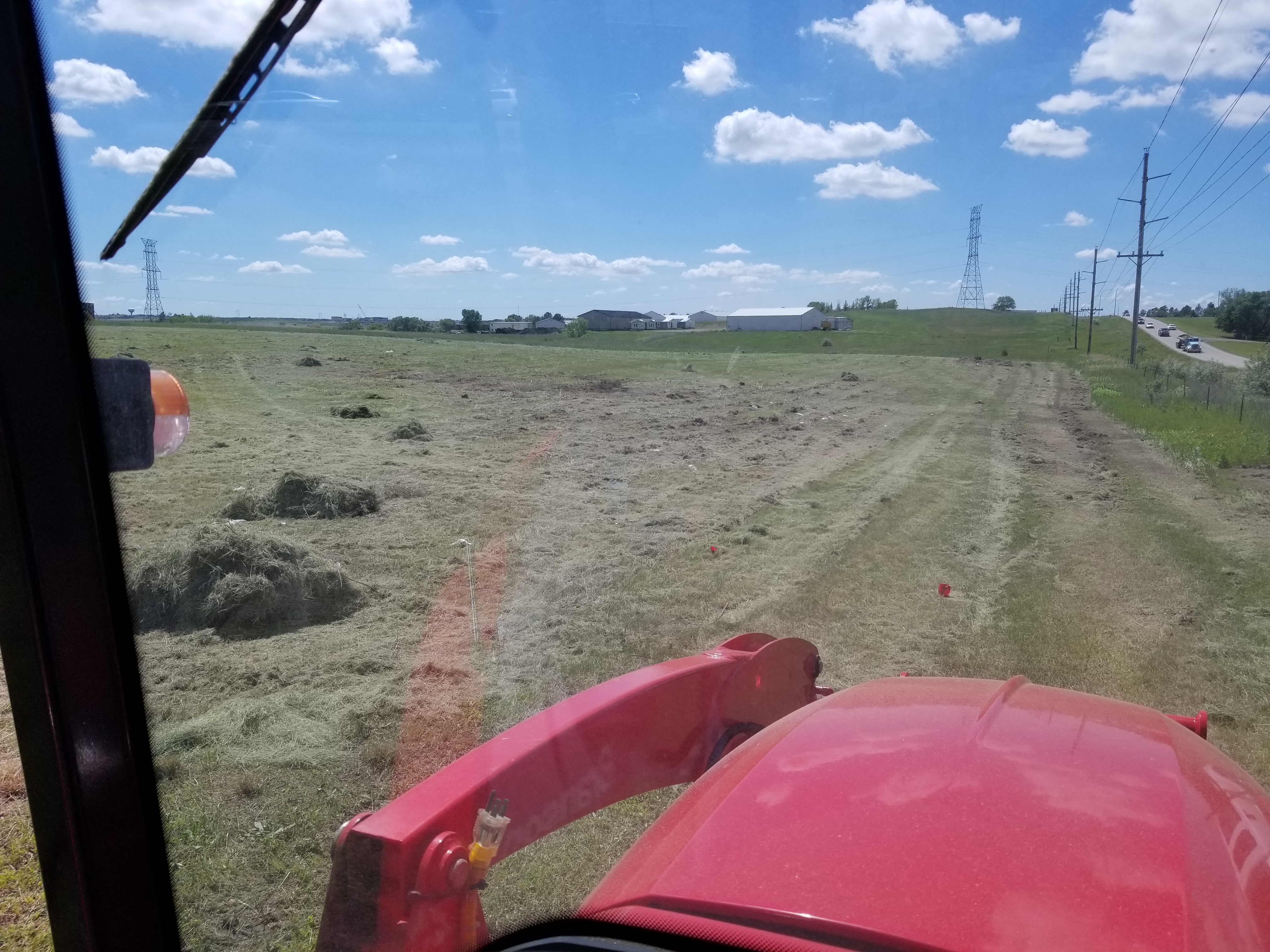

Getting there on the initial staging area. The hawks were having a field day sniping mice out of the cut grass. I couldn't get a pic of one getting taken, as the hawks were hitting them pretty fast and getting away before I could grab my phone for a pic.

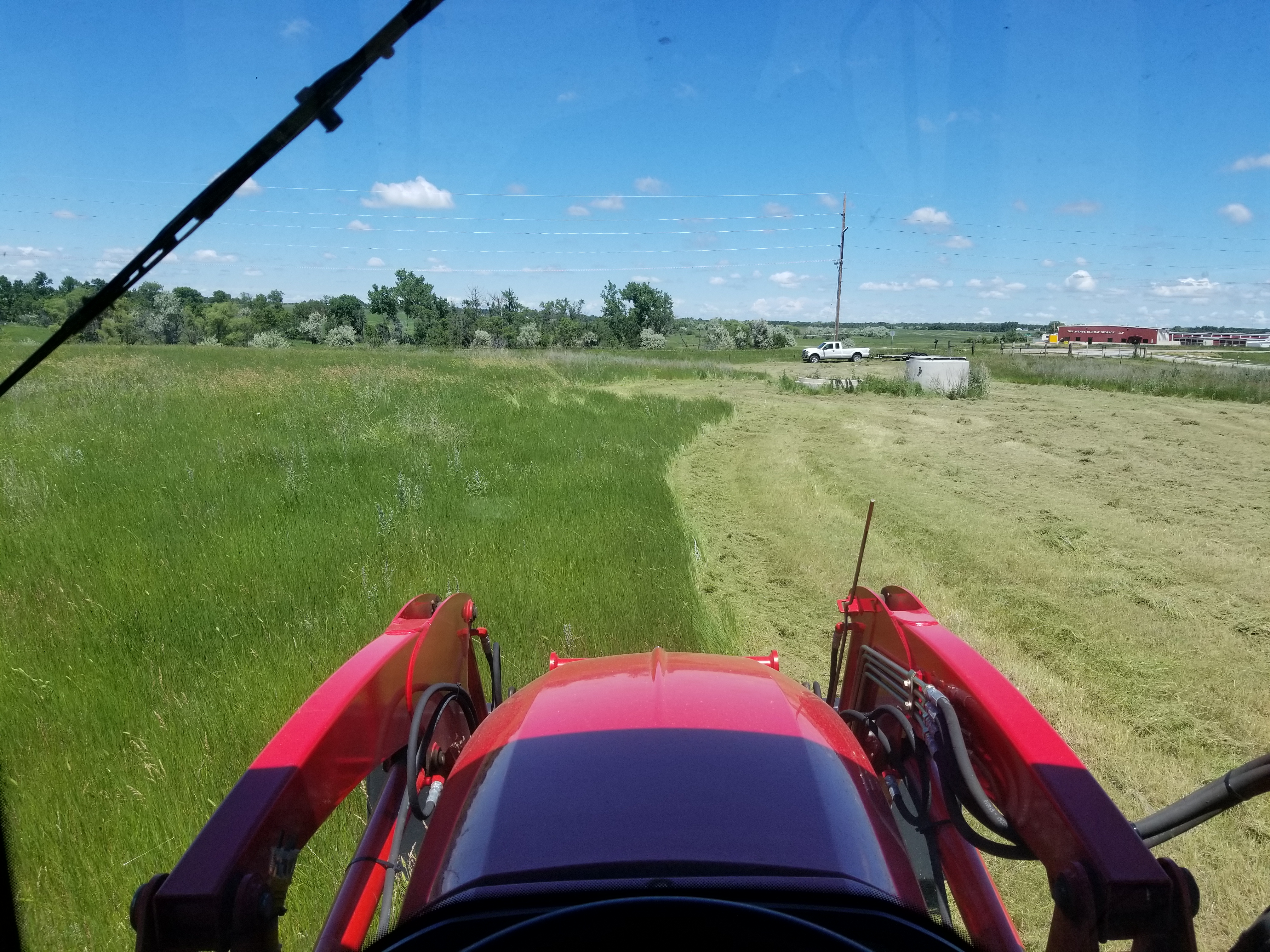

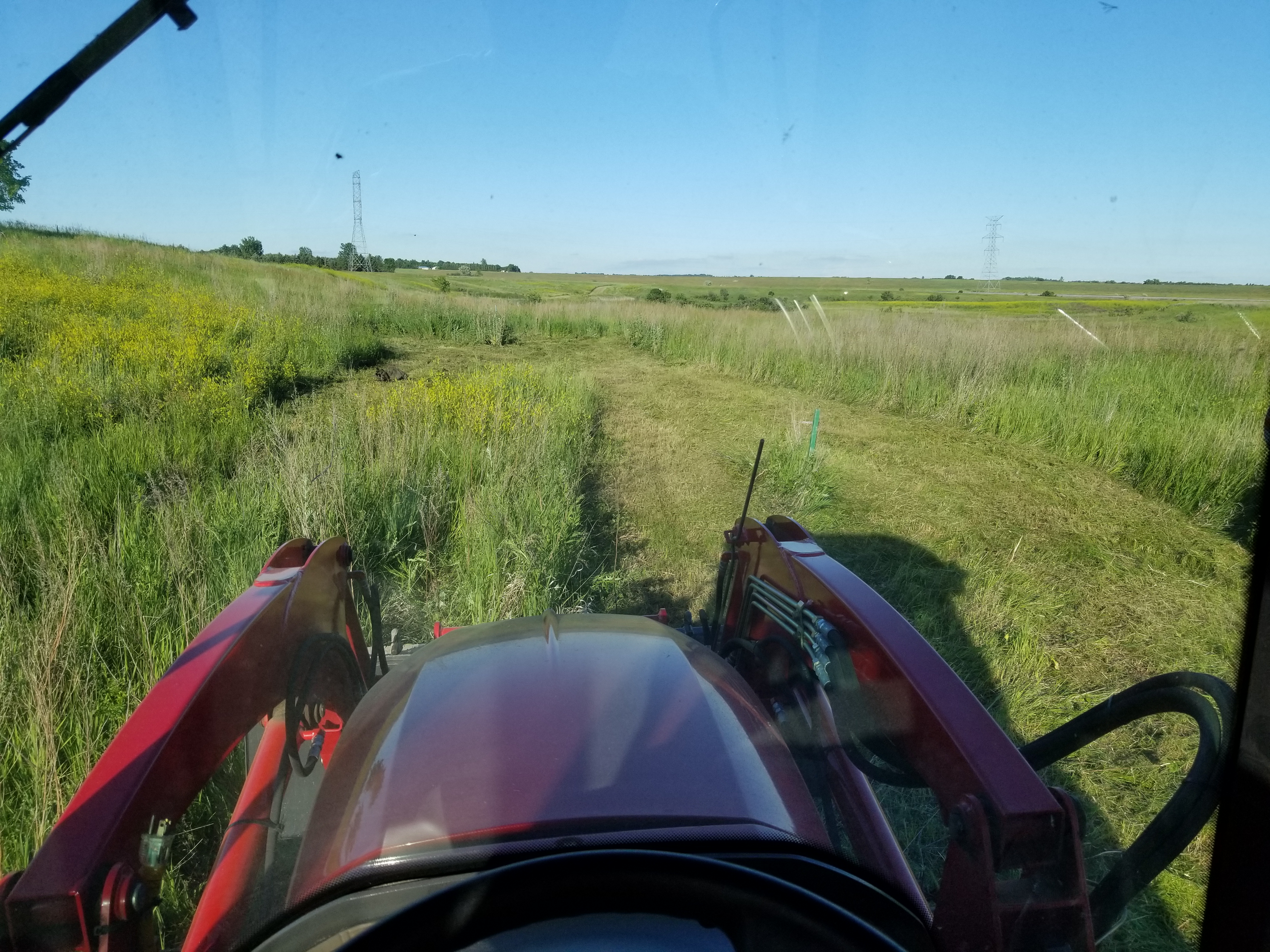

Cutting paths deeper into the fields for the next staging areas. Some areas the grass was pretty thick, and was hood height or higher. Other areas were more brush and I could go faster. Sure found a bunch of rocks. Only time I broke a shear pin was hitting a rather small rock (the exposed portion), but it was buried in the ground. Some of the rocks I did hit that didn't break the shear pin were pretty big, like head sized or bigger. Go figure.
One of the areas next to a creek bottom that the survey crew needed opened up so they can get it staked.

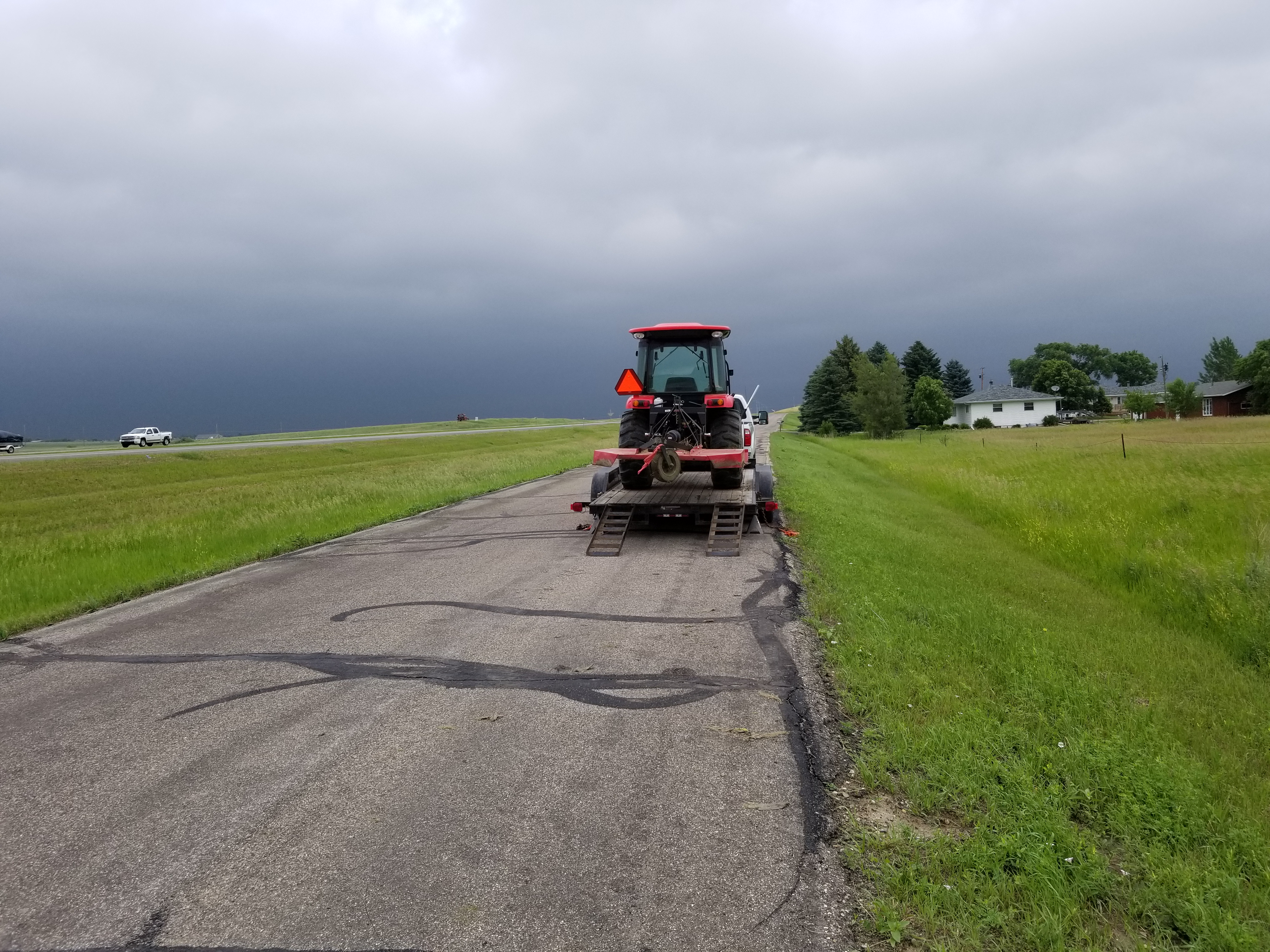

Finished up the job this morning. Didn't take many pics as we were trying to beat a storm system coming at us, so not much dilly-dally-ing for picture taking.
While loading up to move to next site location, was watching the storm cell coming at us.
The storm actually ended up going around us, but it was looking pretty serious for a while. Got everything done and headed for home before 11 am.

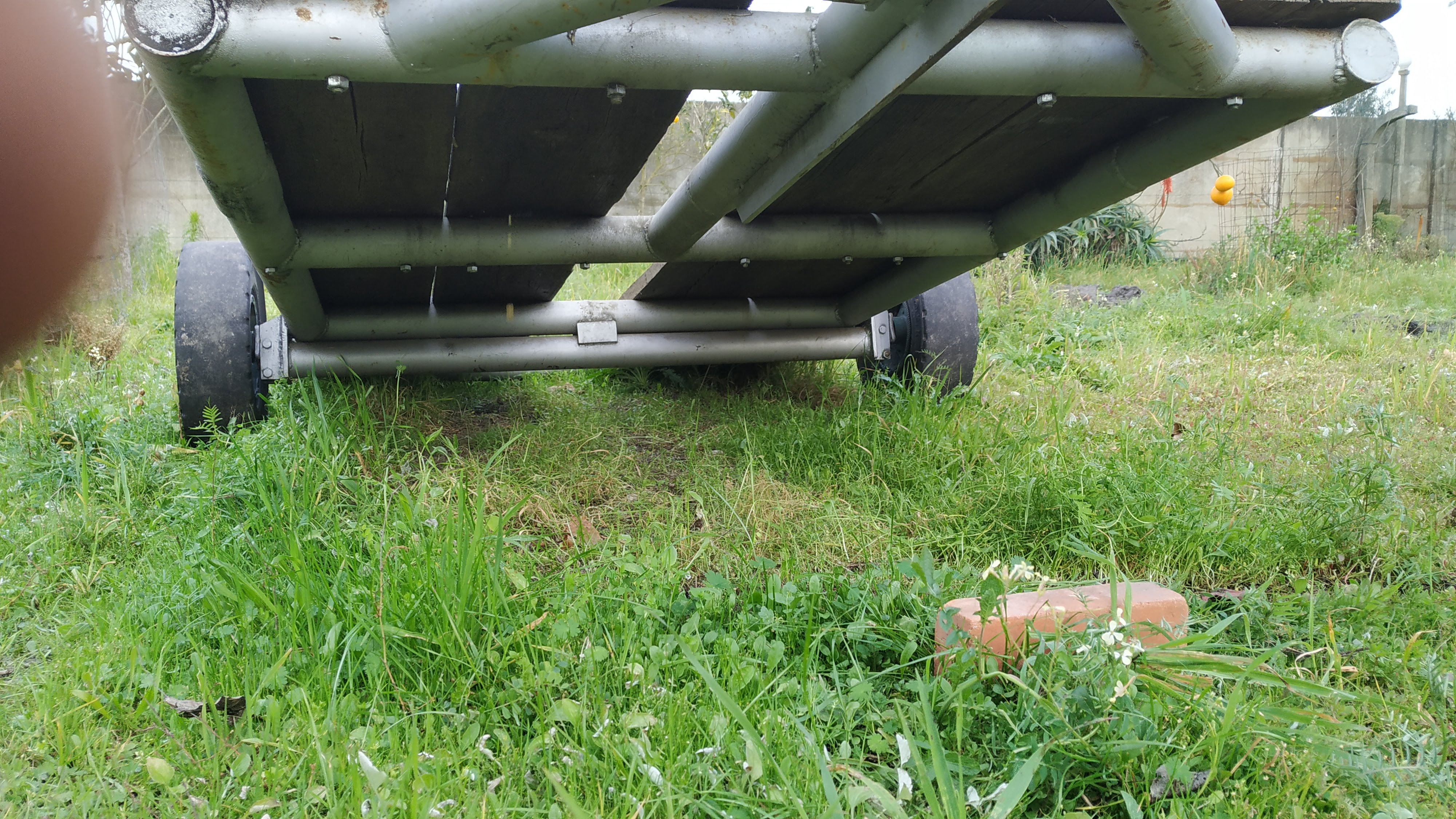

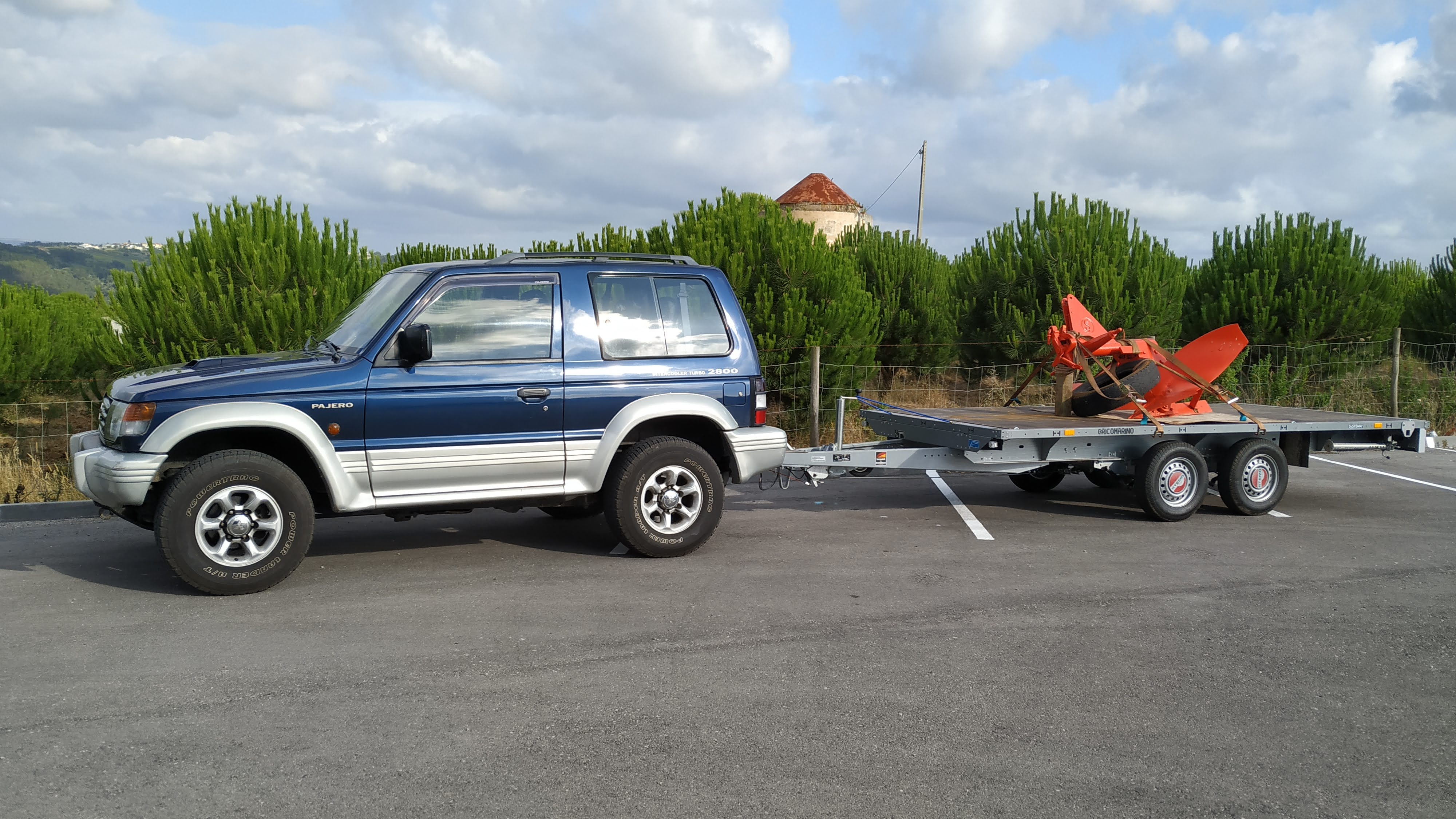

Yesterday had someone interested on a "lowboy type trailer" I had for sale. I made this trailer a couple years ago, to move my crawler tractors around without destroying the pavement. Anyway, the guy offered a 16" reversible bottom plow as a trade in for the trailer. I went and looked at it, realize it's too big and it's actually a Cat 2 implement, but still accepted the offer and took it home with me as it actually holds a better value than my trailer and it's easier to sell.
I don't really need a plow but I've always wanted to play with one. I will keep it for now and maybe sell it later, if I really need to.

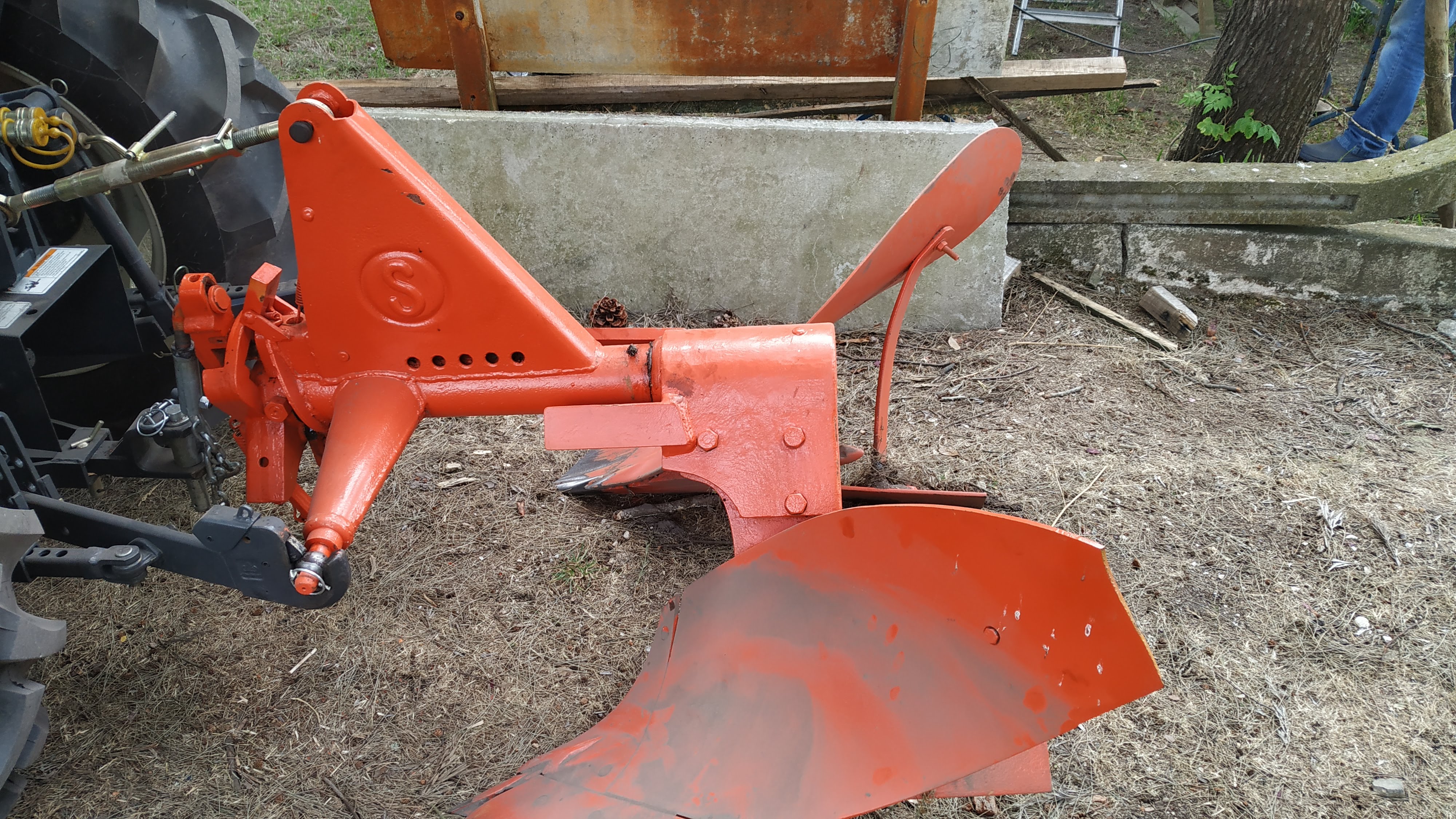

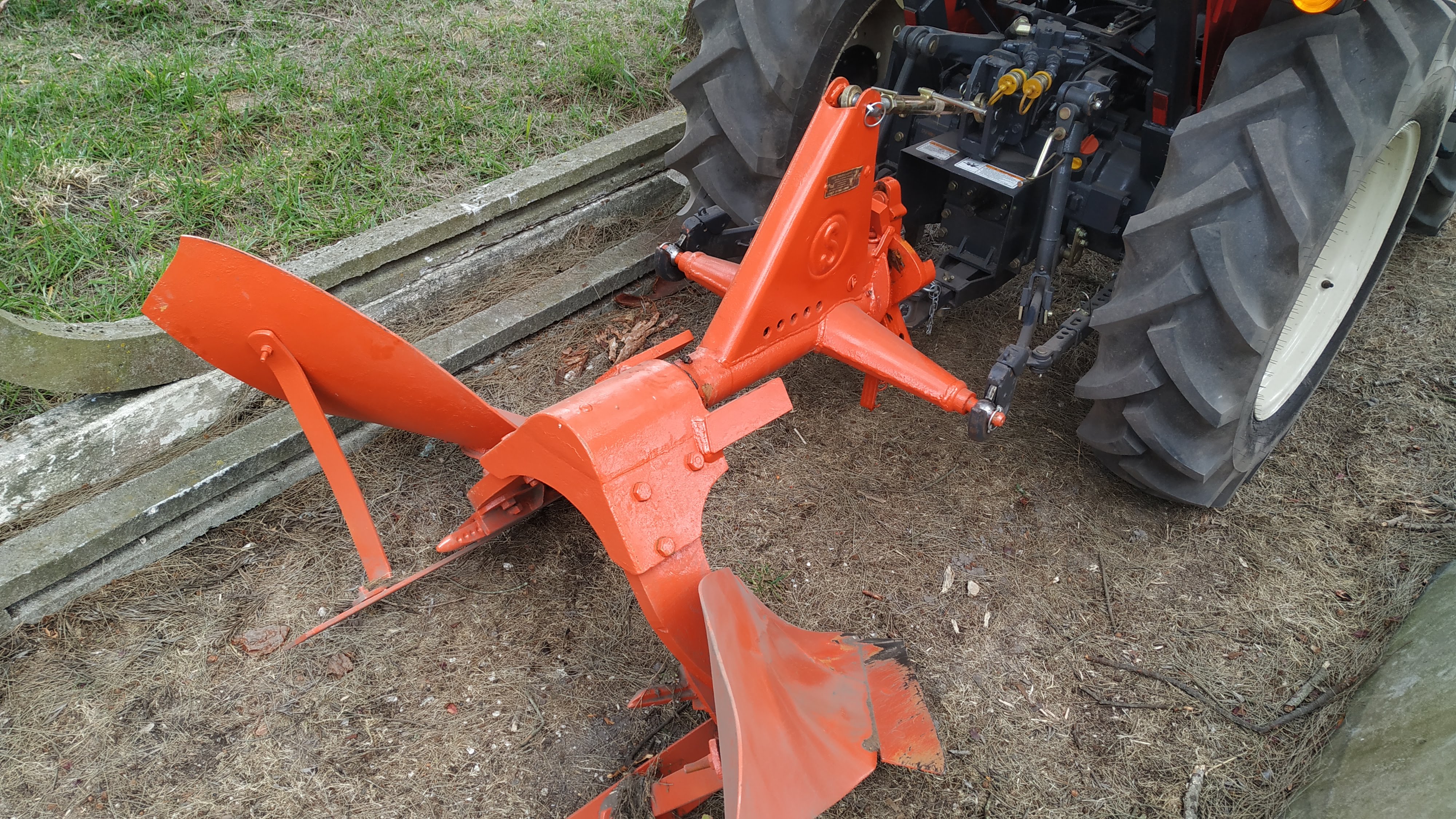

This is a mechanically or automatically (as we know it) reversible plow. This means at the end of the furrow, you can turn the tractor around, flip the plow to the other moldboard by just lifting the 3pt all the way up, then start plowing again. Instead of having to reverse all the way back to the starting side. The specs for this asks for a 40 to 50 HP tractor, goes 16" deep and 16" wide.
The plow has some wear and was missing a couple parts for the trip mechanism. So after about 1 hour on remaking this missing parts, hooking it to the tractor and finding that since it's a cat 2 implement, I had to spread the lift arms much more than cat 1, which pushes the implement closer to the tractor, therefore, the trip mechanism would hit booth the hydraulic top link and the hoses and here I go, dig out the mechanical top link and everything was ready to go.

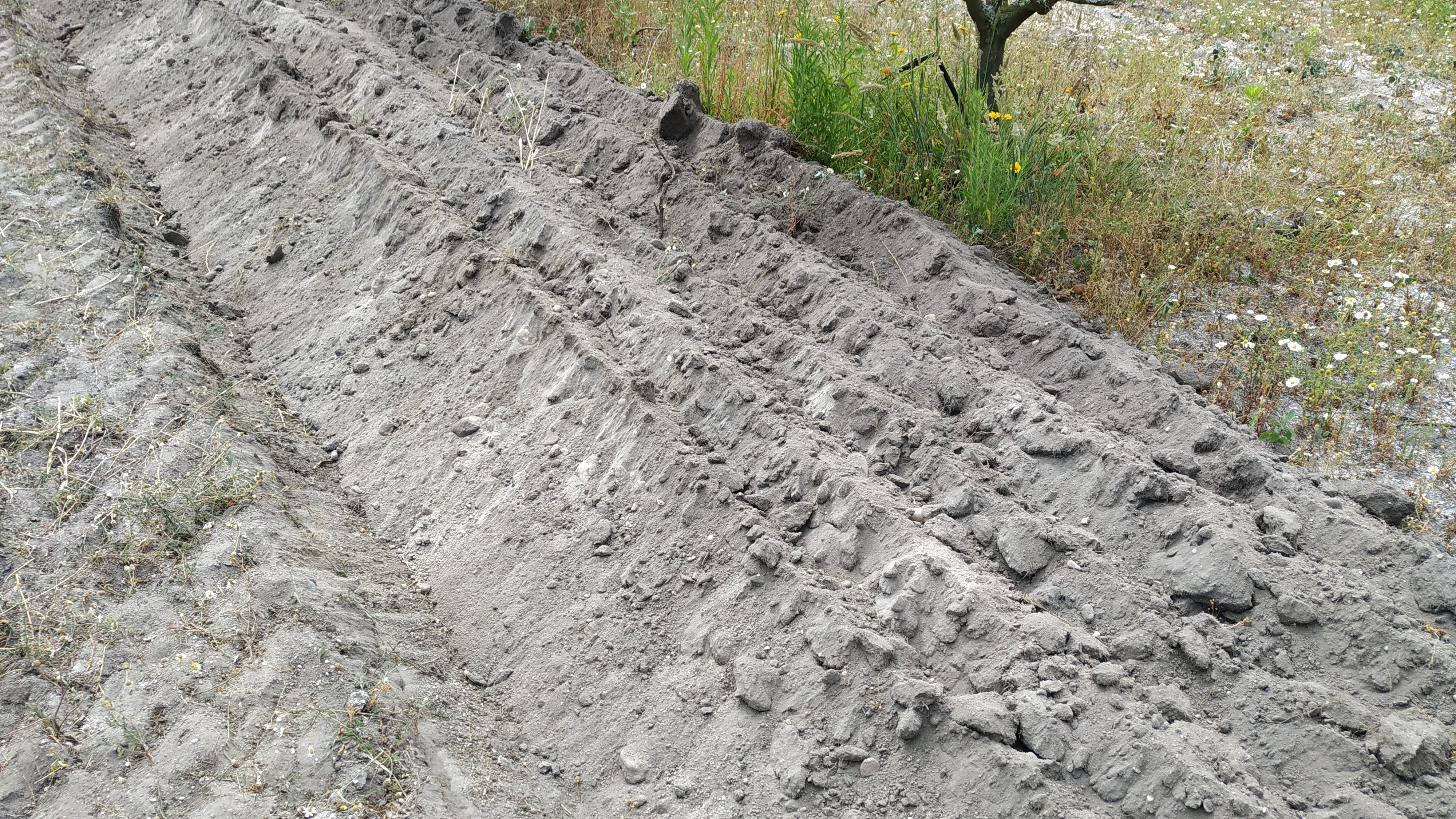

Here I go for my first plowing adventures with about 8 passes of about 50 ft long with barely enough room to move the tractor around :D
Everything went really nicely. I had to adjust the top link a bit and set the draft control also. I went about 14" deep with the plow and besides the plow being too big for the tractor, it handled it just fine and easily. Anyway, this soil is more like sand, although when compacted, it's still hard. I still want to take this to another place we have, about 45 miles away, where the soil is red clay that hasn't been touched for over 25 years, so it's really compacted. And there I can push it harder and faster and actually see how the tractor handles on some harder soil.
Here are some pictures of the trailer:
And pictures of the plow:
IMG_20190707_160400.jpgIMG_20190707_160347.jpgIMG_20190707_160338.jpgIMG_20190706_184218.jpg
Some pictures of the furrows:
