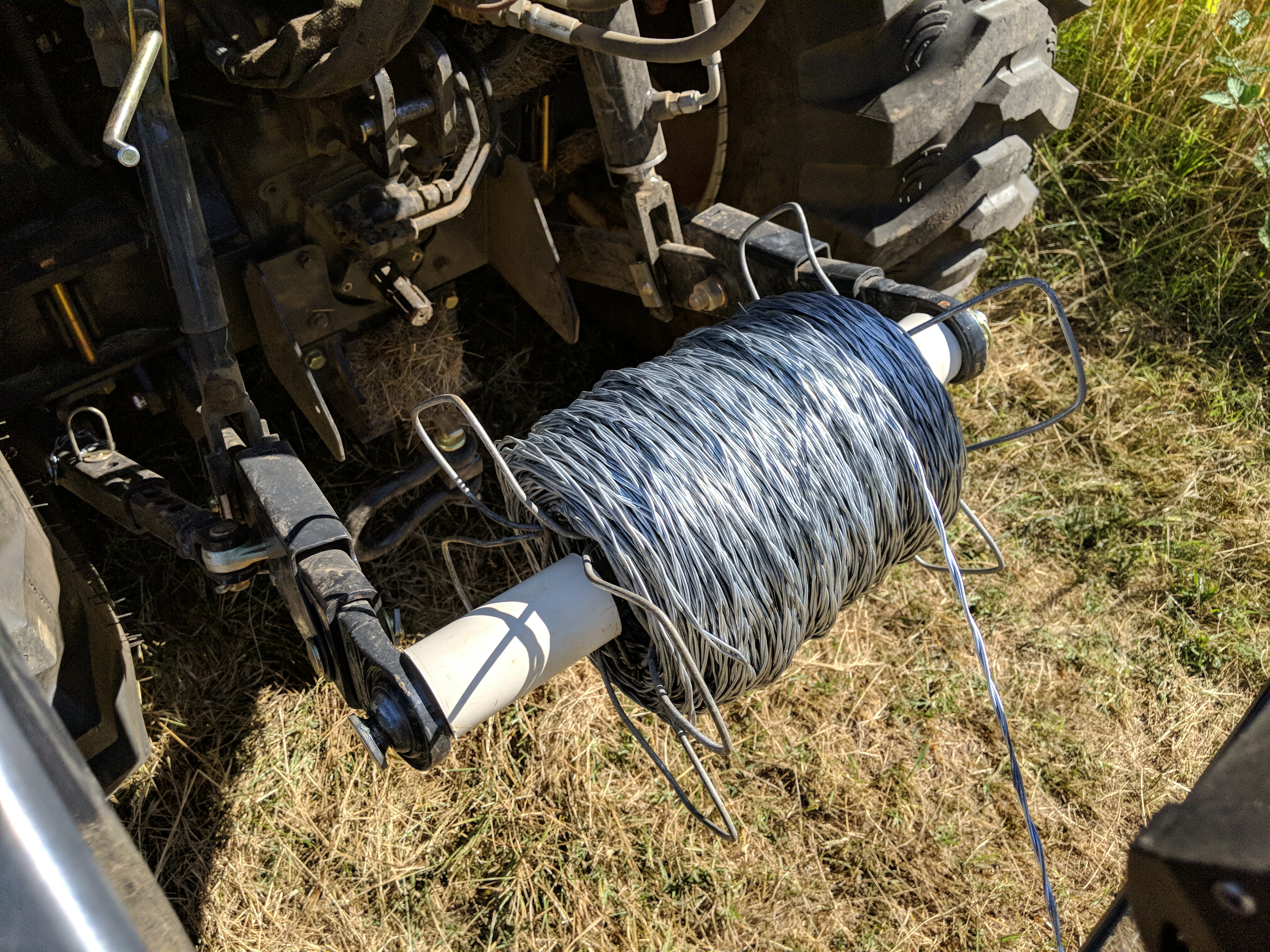

The last few days I somewhat casually used my tractor to run some barbless wire on top of some field fence around our place, with the goal of excluding deer from our land.
I didn't feel like carrying an 80# spool of wire by hand, so I picked up an "fence unroller" from TSC which mentioned on its packaging that you can slide a 1/2" pipe through its handle and put it in your 3ph.
Results:
1) the 1/2" galv pipe I had didn't go through easily due to a seam on the inside of the unroller's handle
2) grinding out a groove on the pipe allowed it to go through; I welded a big washer on one end of the pipe and drilled a hole for a lynch pin on the other
3) it spooled out a bit of wire quite nicely until
4) not sure what happened but one of the hooks bent down and then broke off when I tried to bend it back
5) would not advise purchase, we'll see if they refund it
I ended up with this rig:
It's the same 1/2" galv pipe with washer on the end and lynch pin, through the center hole of the fence roll; there's a couple pieces of 2" PVC pipe which keep the spool centered away from the 3ph arms. This successfully ran out about 3000' of wire; I was quite happy with it.

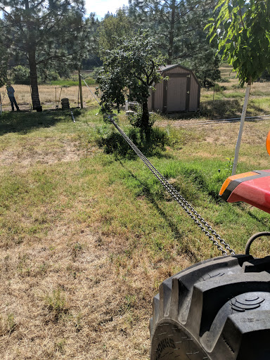

Unfortunately one of the posts I put in for this new fence a couple weeks back had a change of fence direction on it that was bigger than I expected when planning - I thought it was going to be small but it ended up being an unbraced 20 degree bend, and the post got a tilt from the fence tension. Yesterday I dug a hole inside the bend to pour an anchor for a diagonal brace (thankfully the bend is outside the yard so a diagonal brace won't be generally in the way); today I used the tractor to gently pull the post straight... it's parked to hold it while the concrete that the diagonal brace (now attached to the previously leaning post) is in sets for a couple days...
Unfortunately the hole had to be dug in hard clay with rocks in it by hand as the space behind the tractor has a steep slope for 10' before there's an irrigation canal - no corkscrew action there, just lots of sweat on a 90 degree day.
