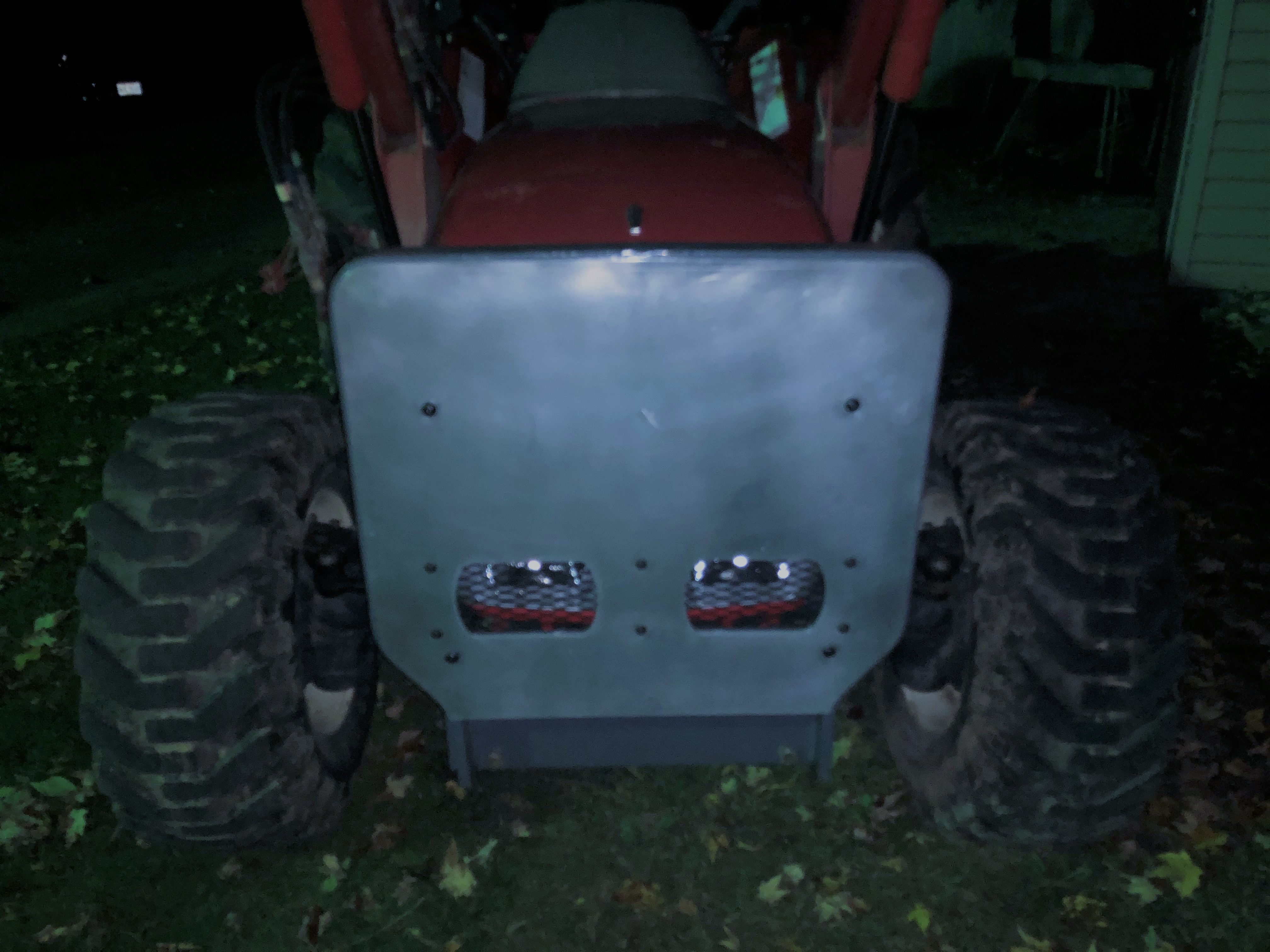

Replaced the original tie rods with the upgrade kit due to a busted right side tie rod.
Replaced the front mask (grill) assembly with headlights including new camlocks.
Replaced the non-existent hood side panels. Had to modify a set from a 3820 as the 3520痴 are no longer available. Had to remove the lower attachment pins then touch-up the paint with Rustoleum Cherry Red spray paint then modified the tractor lower brackets to accept the bottoms of the side panels. Placed some セ ID hose over the tractor brackets to keep from scratching the panels.
Replaced a busted left tail light assembly.
Replaced the non-functioning temperature sensor.
Replaced the radiator over-fill container.
Modified and painted the front grill guard with Rustoleum Charcoal, they now have a Slate which is a better match.
Added a shield over the guard to better protect the headlights and grill.
Used a CV Boot from a Razor RZR XP to replace the FEL Joystick boot.

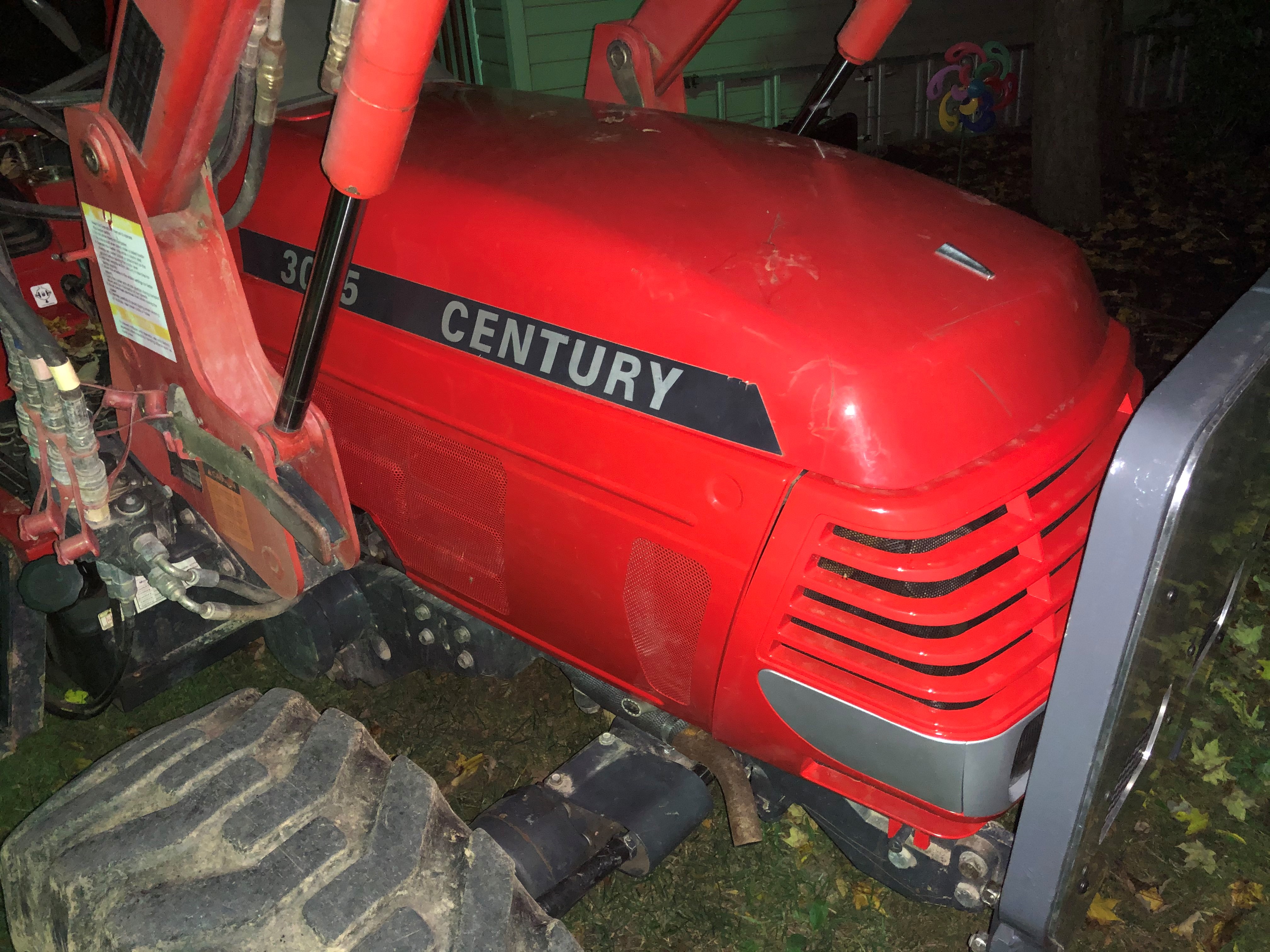

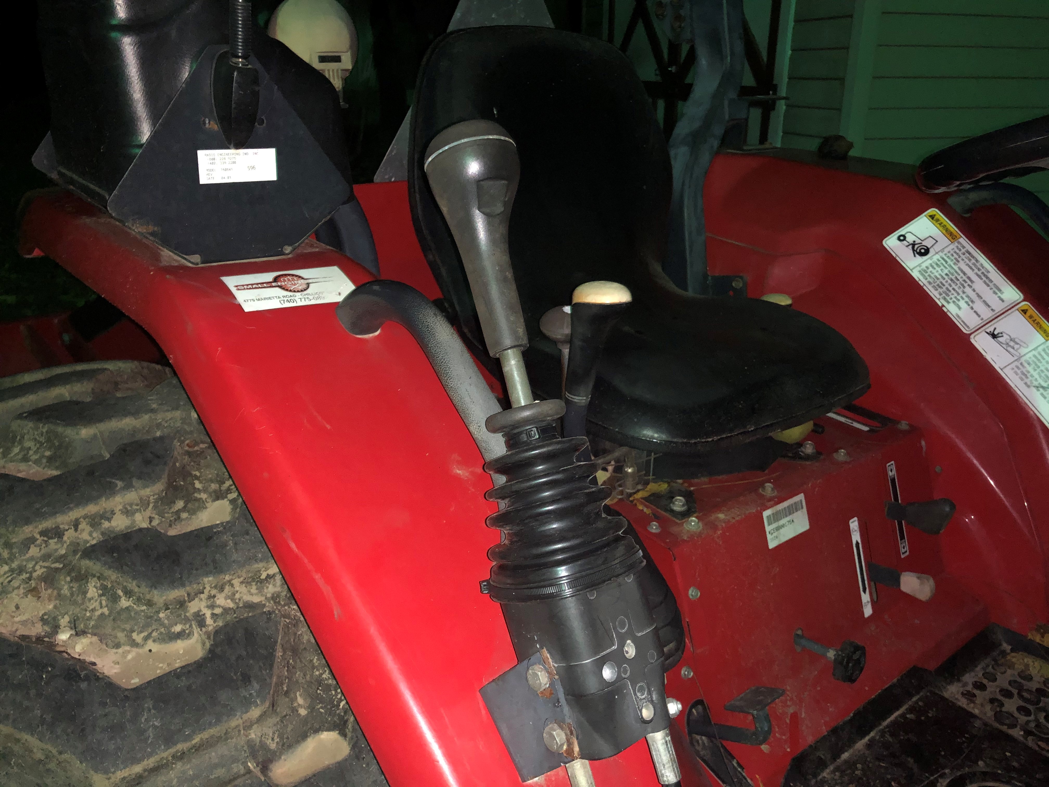

Replaced the non-existent hood side panels. Had to modify a set from a 3820 as the 3520ç—´ are no longer available. Had to remove the lower attachment pins then touch-up the paint with Rustoleum Cherry Red spray paint then modified the tractor lower brackets to accept the bottoms of the side panels. Placed some ï½¾ ID hose over the tractor brackets to keep from scratching the panels.
View attachment 671514View attachment 671515View attachment 671516
Very nice! Looks great!

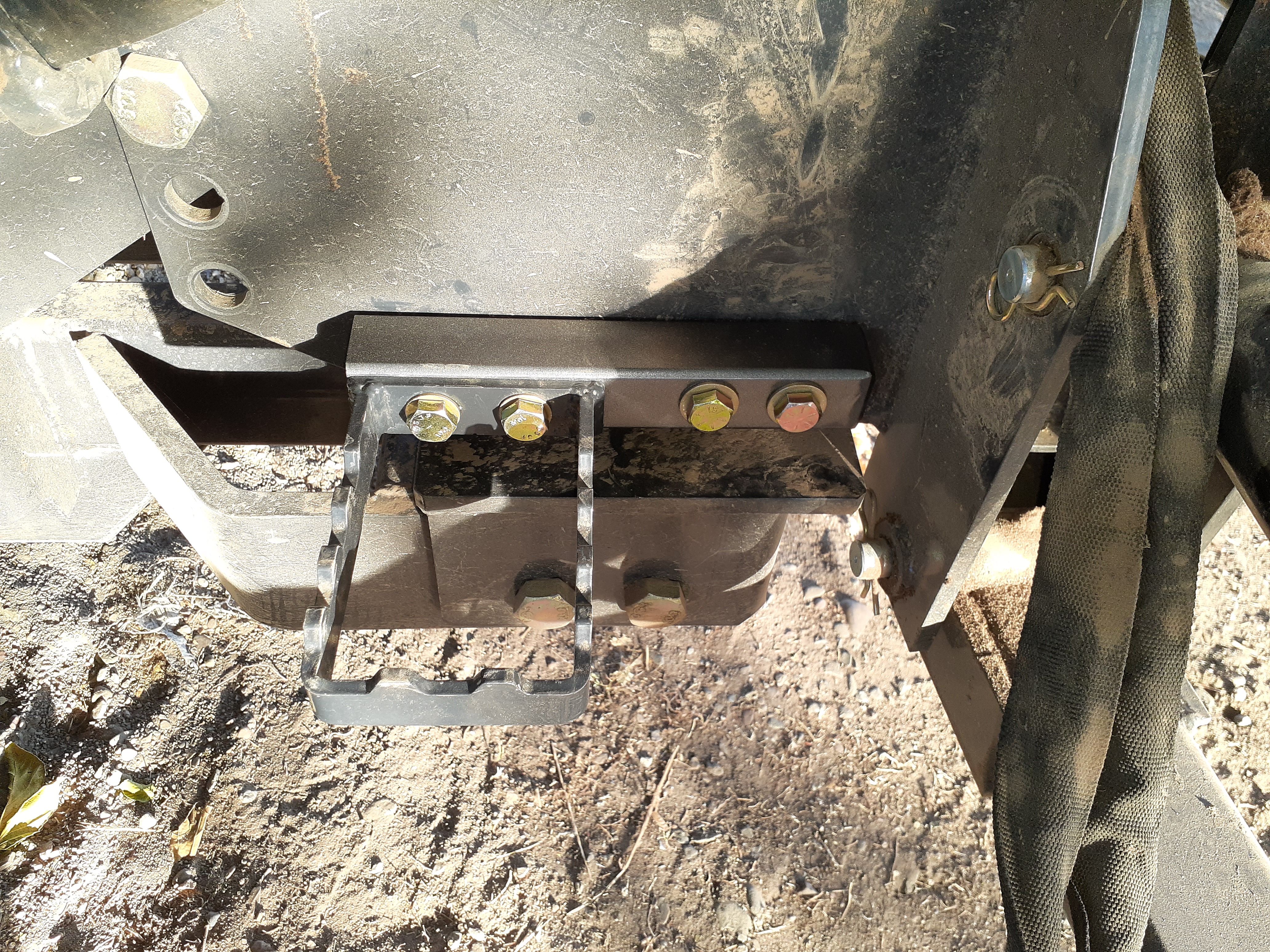

Hello All,
Well, after using my new unit for about 20, hours I still had not gotten comfortable with the location of the step on the backhoe. I feel like I was struggling to find the step when climbing down. So.... I did something about it.
Using a 1.5"x.187"x9" tube, I welded a cap on one end. I then transferred the step bolt mounting pattern to each end of the tube. On the capped end I drilled two 7/16" holes completely through the tube. On the open end, I drilled two 7/16" holes through the outer face of the tube. I then bolted my step onto the tube and then bolted the tube to the backhoe at the original step mounting location. This effectively moved the step 5" forward and 1.5" outward.
Now I feel much more comfortable stepping up onto and back off from the backhoe. I did this on both sides, just in case you were wondering. Enjoy. B.

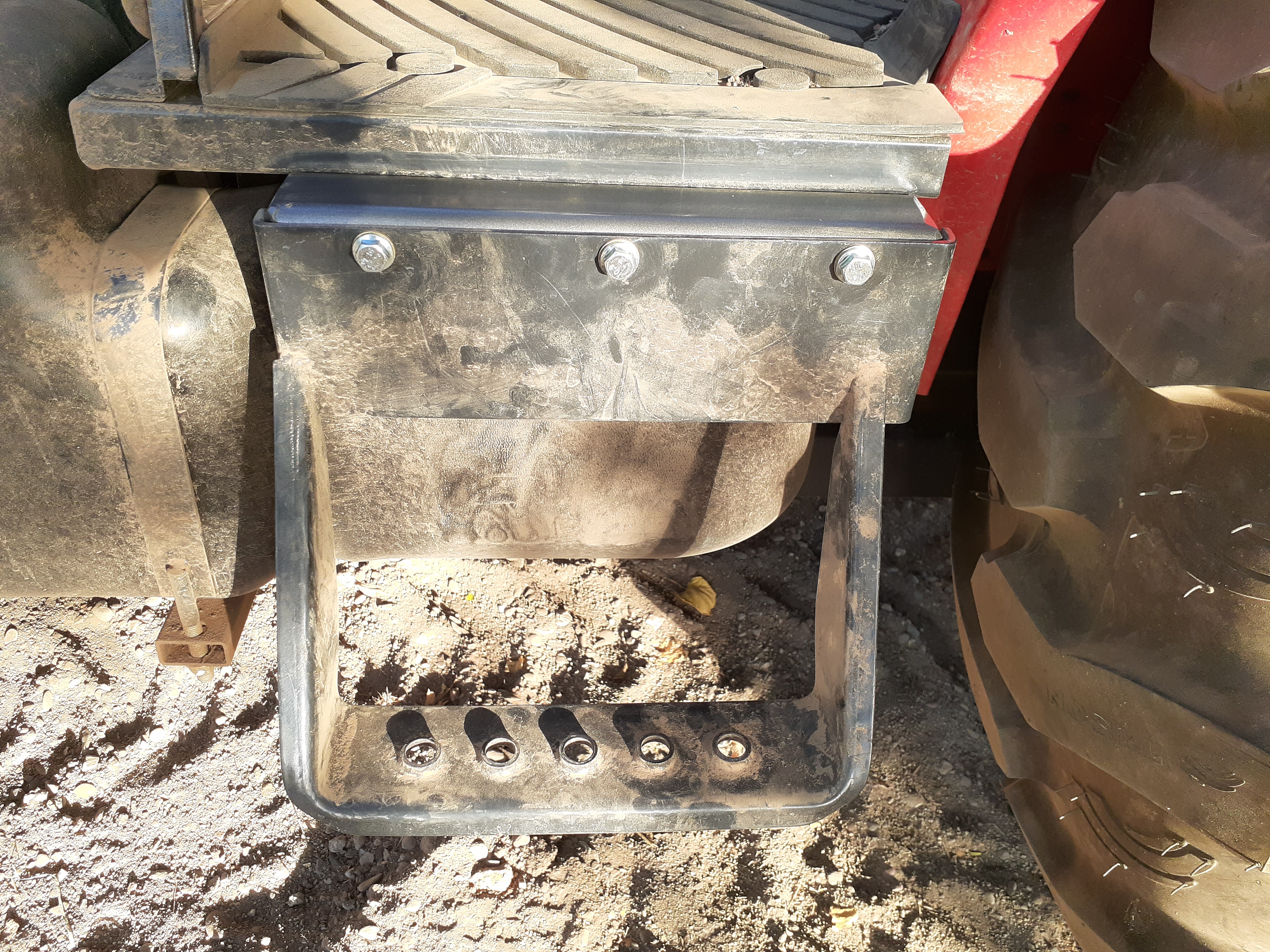

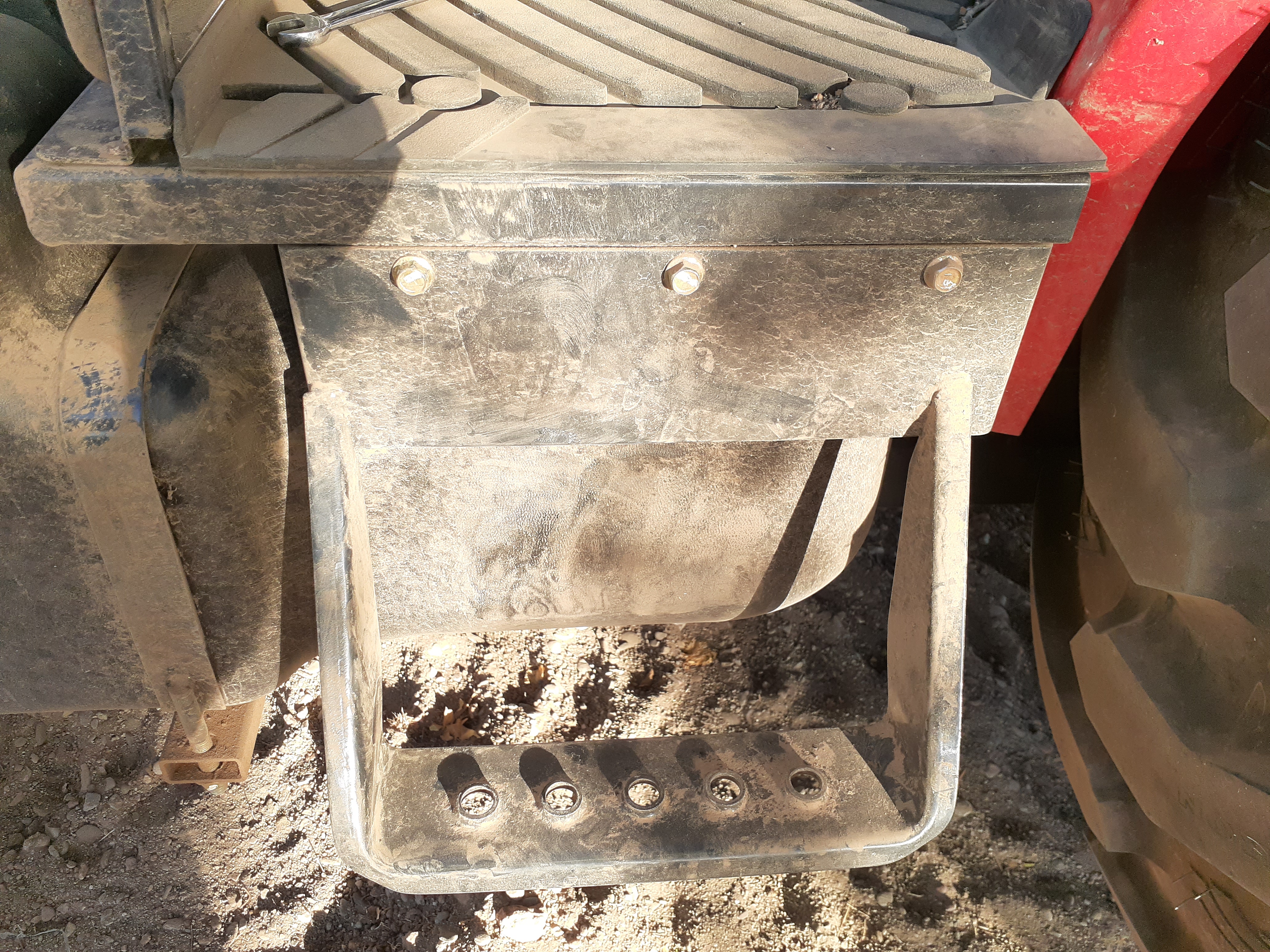

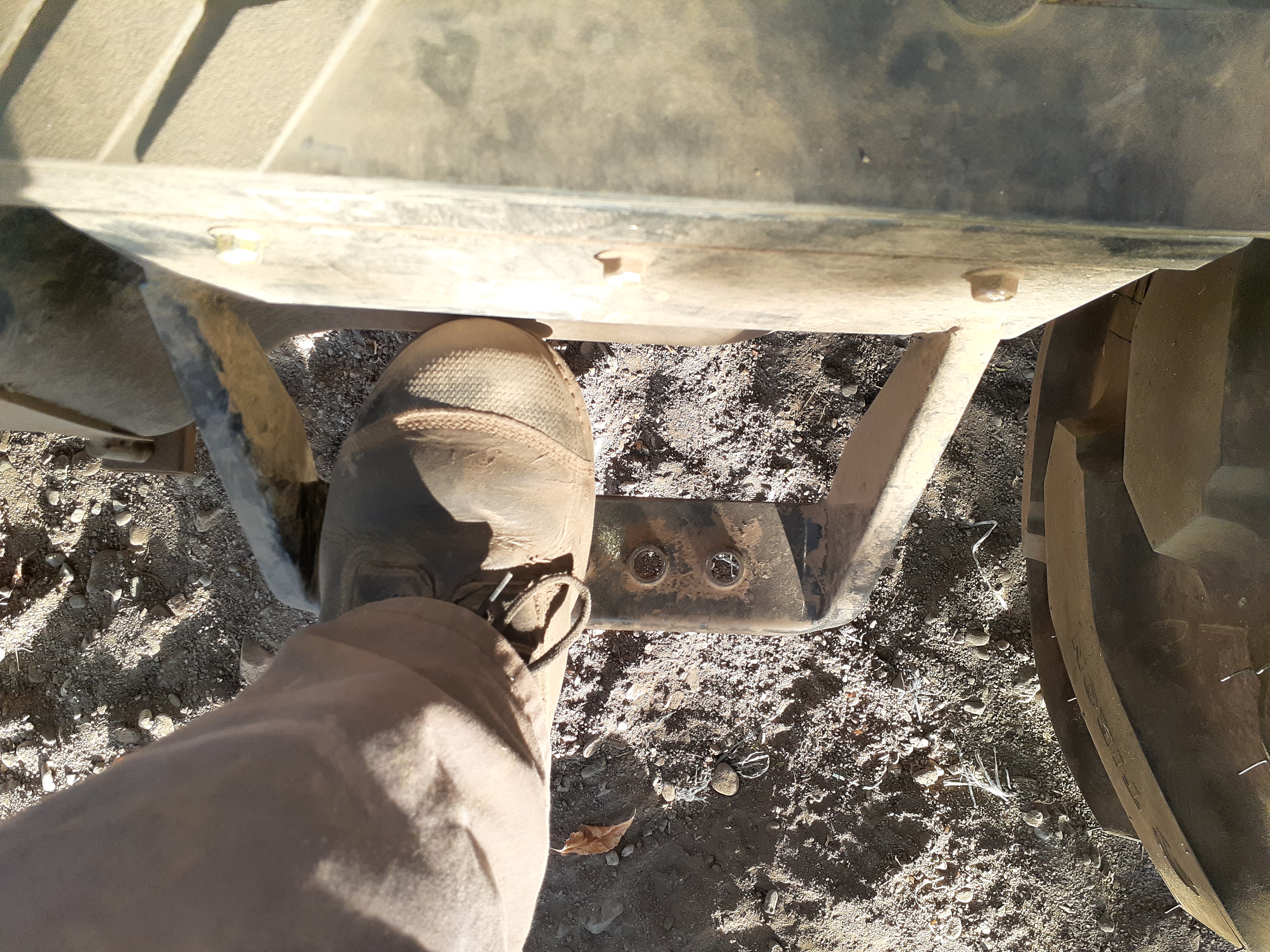

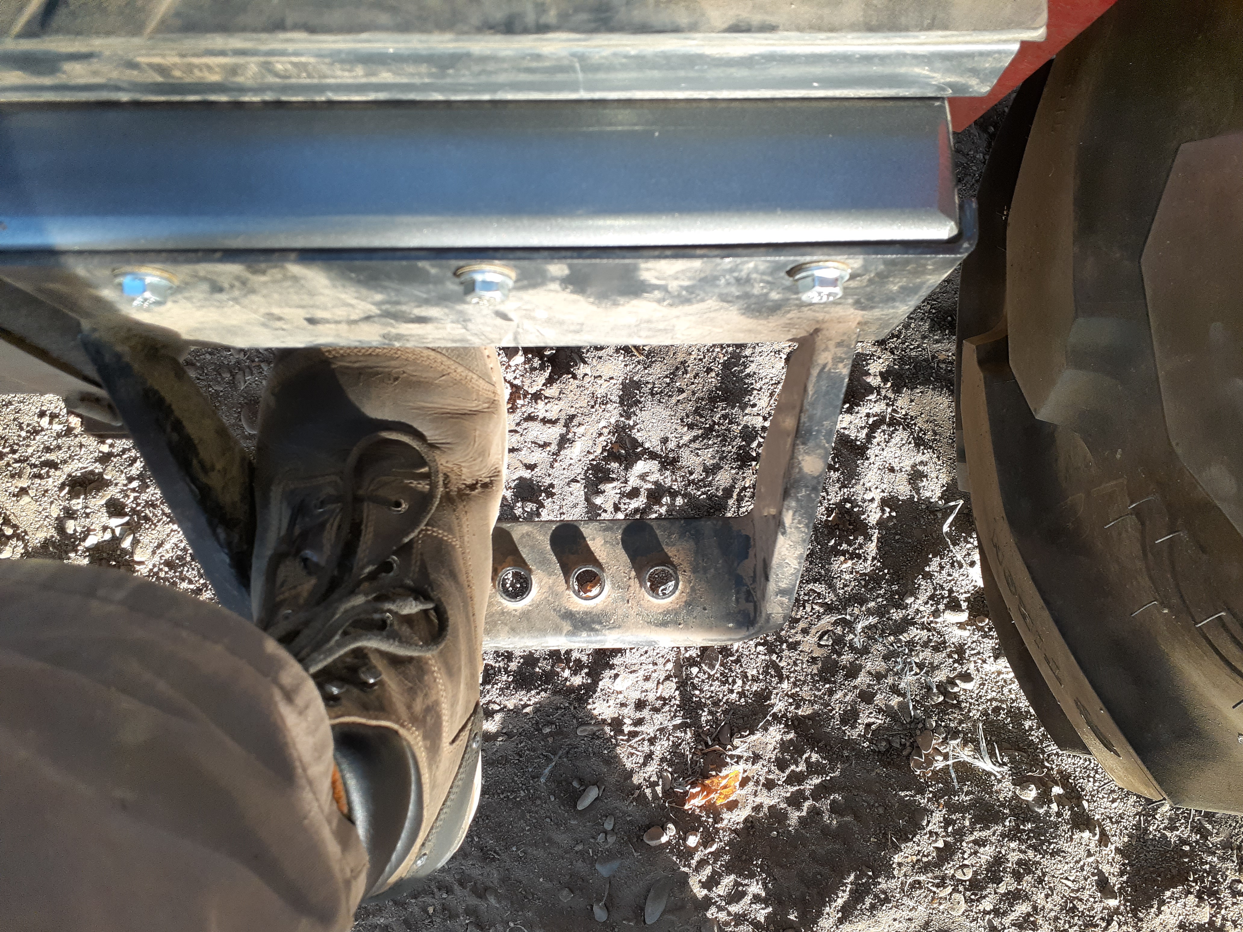

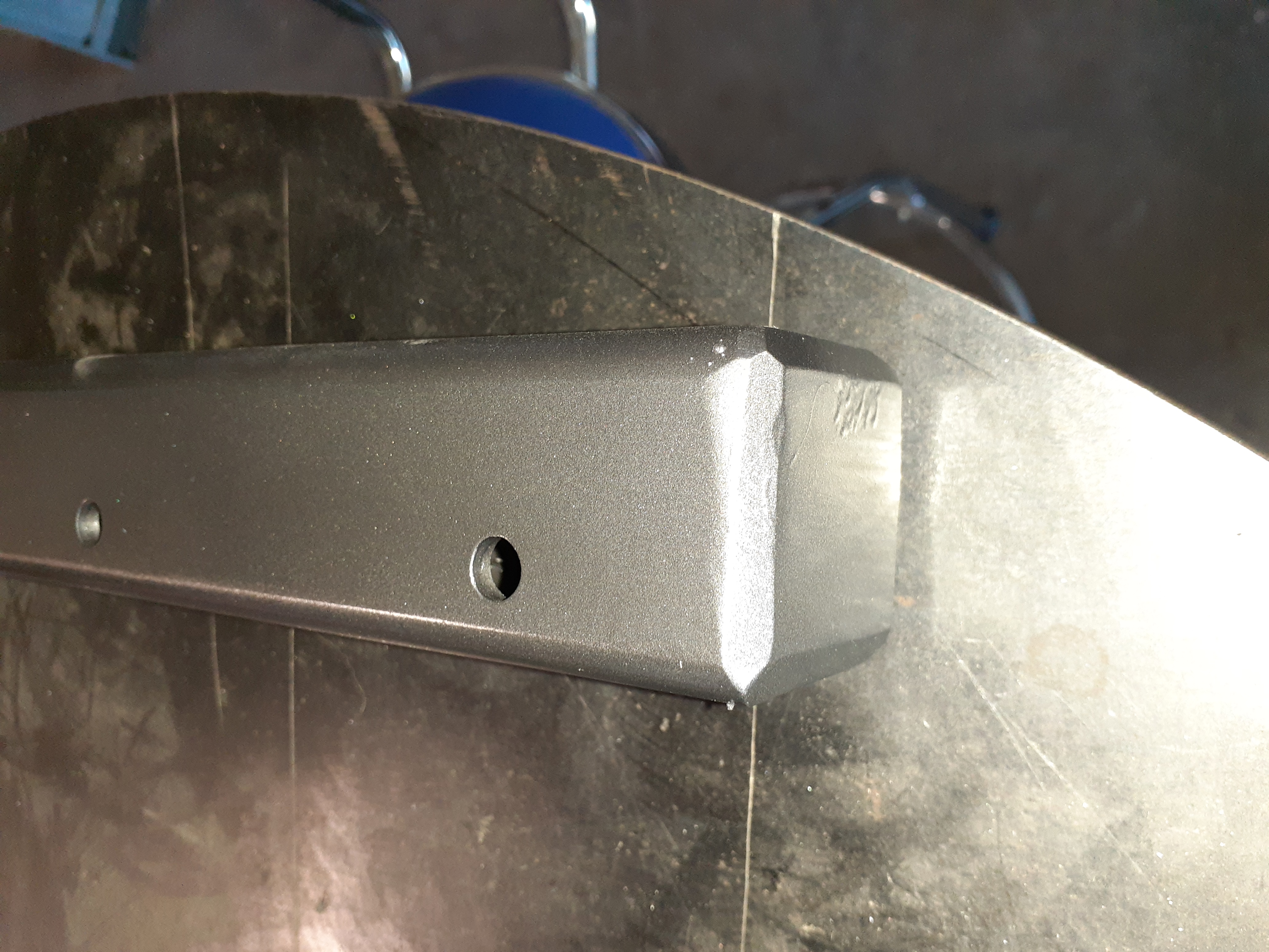

Hello All,
Well, just as with the step on my backhoe, I was having an issue with mounting and dis-mounting the tractor. The fuel tank is right behind the step on the left, and the right side is a little cluttered with controls. With my big old clawed hoppers on, I just could not get a comfortable purchase on the left step. So here is what I did to make it a little more secure.
Using a 2"x.187"x11" tube I capped both ends. Then I transferred the step bolt mounting pattern to the tube and drilled three through holes. Using new 8mmx1.25x70mm flanged bolts, I bolted the step back on sandwiching the tube between the tractor and the step. This pushed the step out 2". Now I feel like I have plenty of boot on the step and it is a much more secure feeling. I did this on both sides, even though I don't plan to use the right side. I was afraid the tractor would lean to the left with the extra weight of the spacer tube on that side (add sarcasm LOL). B.

Nice job on the steps!
I'm been meaning to make a plate to go behind the step, so the step doesn't poke the tank when I'm getting in and out of the tractor.

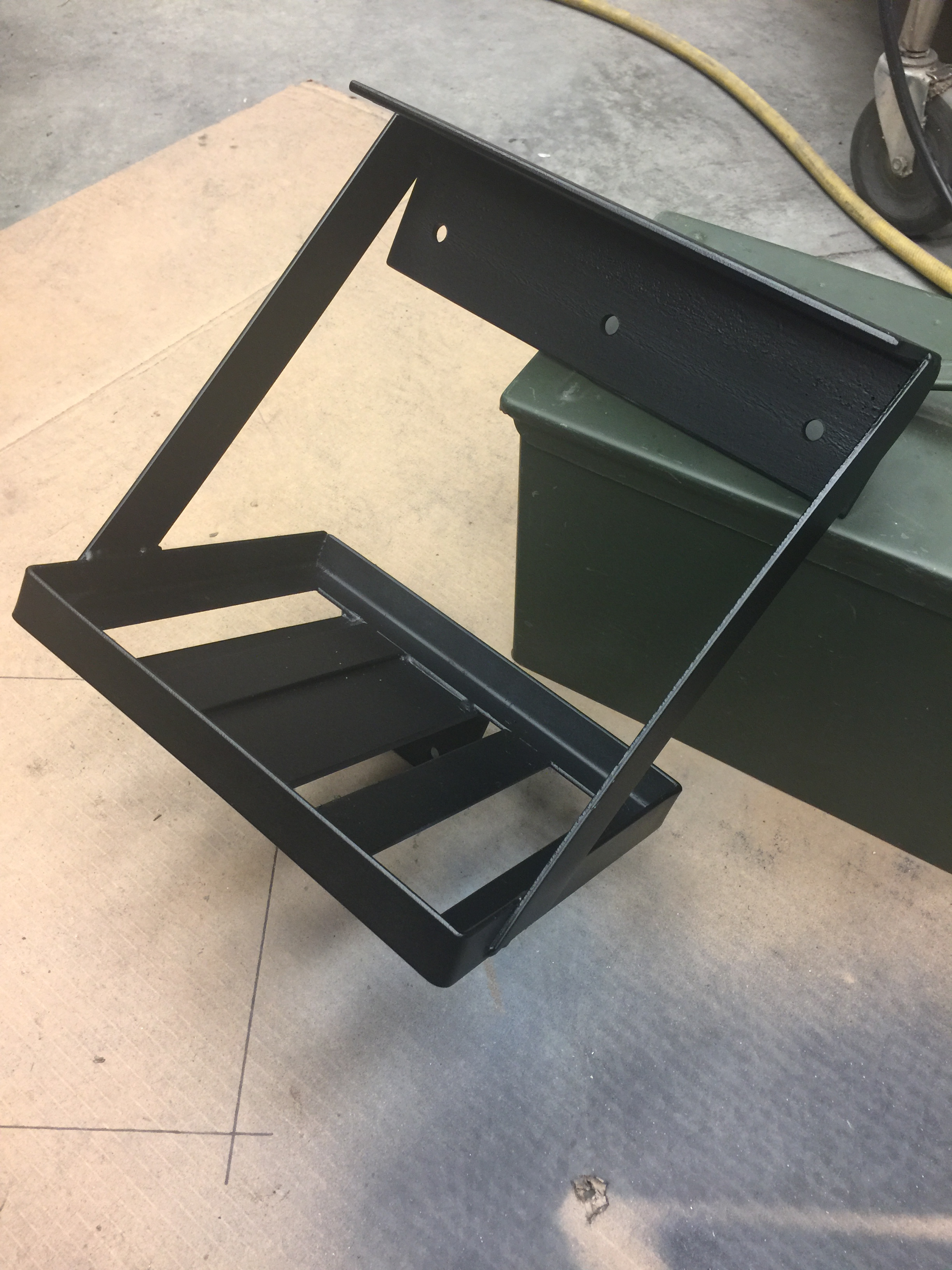

Since the right side is difficult to enter from, I removed the right step and fabricated a 1.25 gal mix gas can holder to go where the existing step was and installed a tool box with dual bottle holders for water & bar chain oil.

Thanks PTSG. Yeah, on the left step there is nothing protecting the tank. But, where else do you mount it? On the back is a real pain for filling. Aquamoose do you have a link to a thread on that mod? Could always use more beer, um.... Water holders. B.

I thought I had more pics but I’ll take more. For now, here’s the image of the painted bracket.
