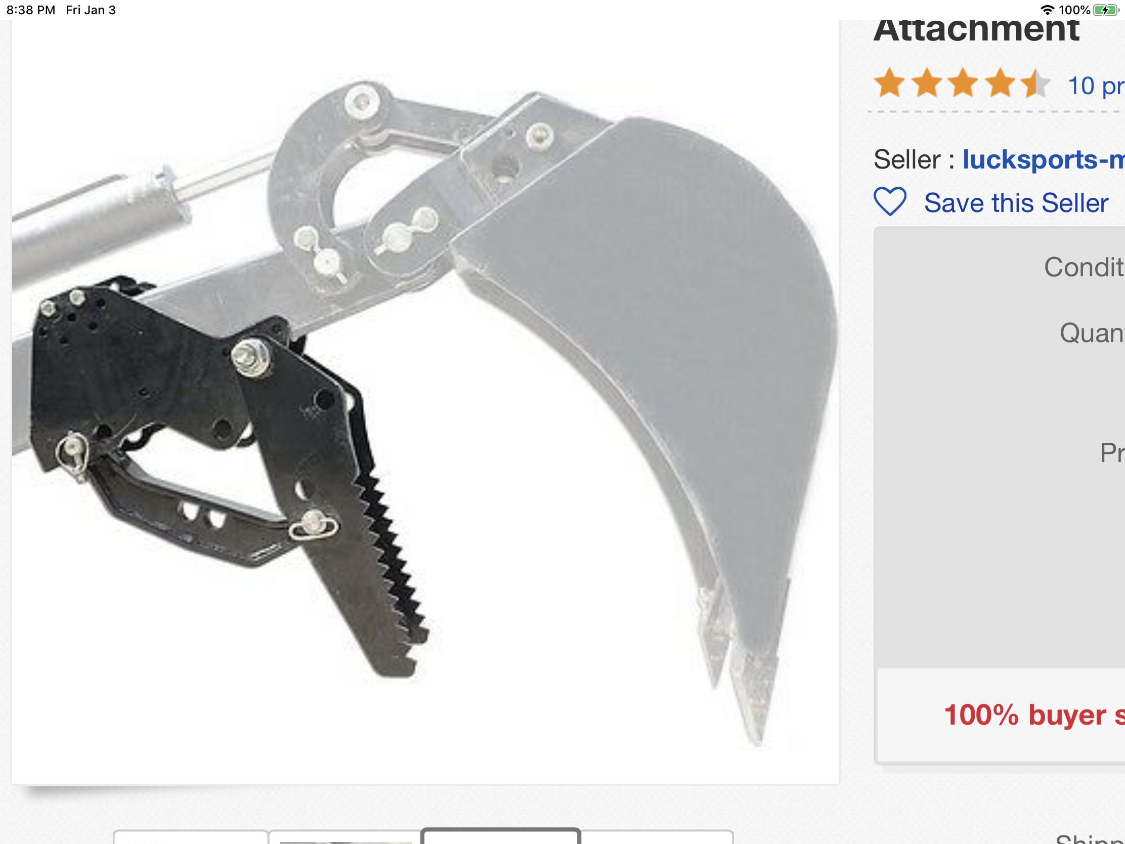

Even tho it is not on my GC1705 I do consider it part of the poor mans 1705/TLB and that is the HF Trencher I bought but anyway I ordered a 16.5 inch bolt on thumb for it.
Oh see, I forgot you got the tow hoe when I was telling you about how I do big tree limbs, in that other thread. You gonna love having that thumb. :)
That is part of the reason I ordered it :thumbsup:.
   / What have you done with/to your GC Series 2300, 2400, 1700 Tractor TODAY
#116
You'll love that "Power Shovel" with the "Thumb", my BH has saved me $$$$ from not having to hire a contractor for many projects and repairs...

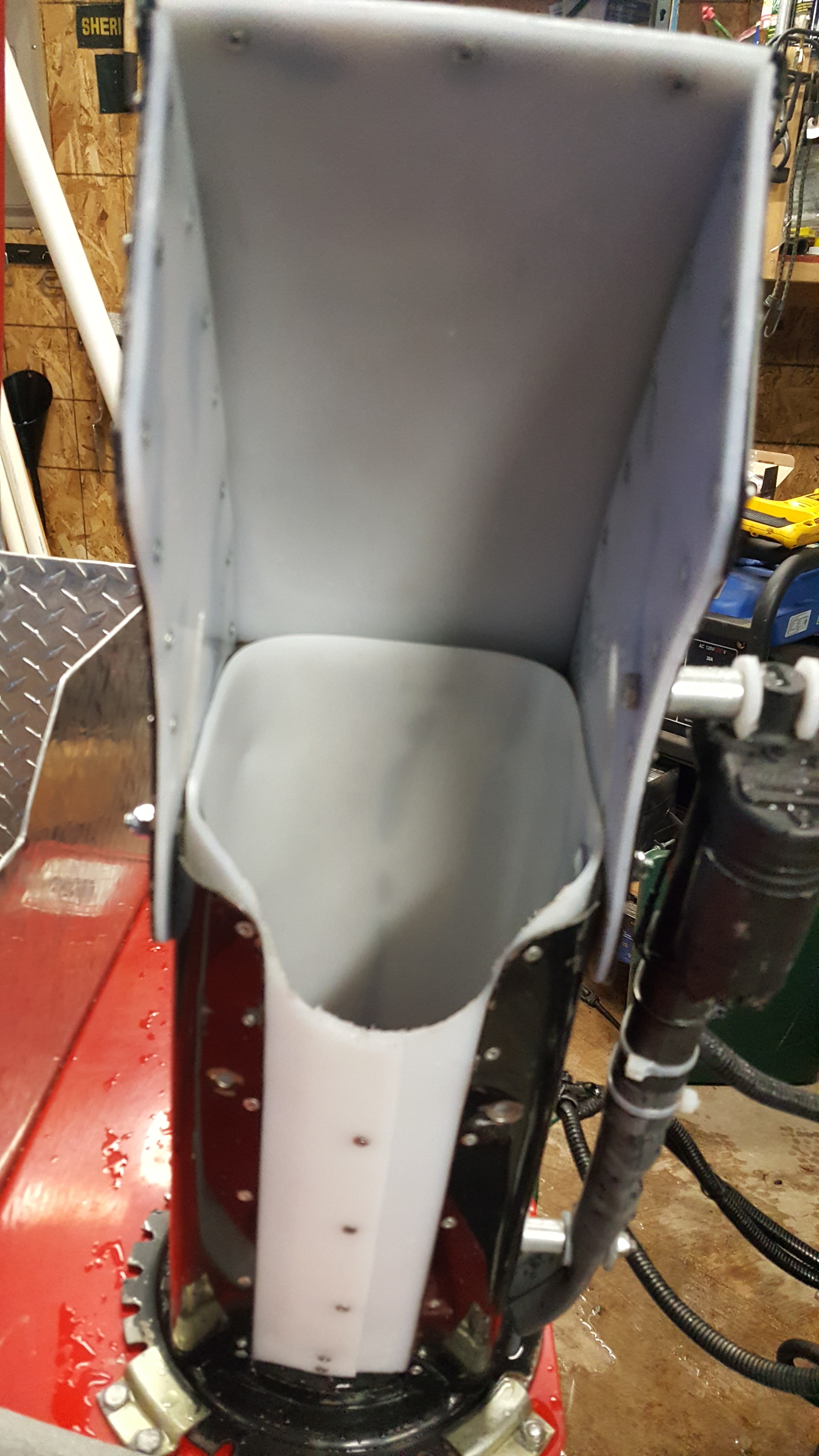

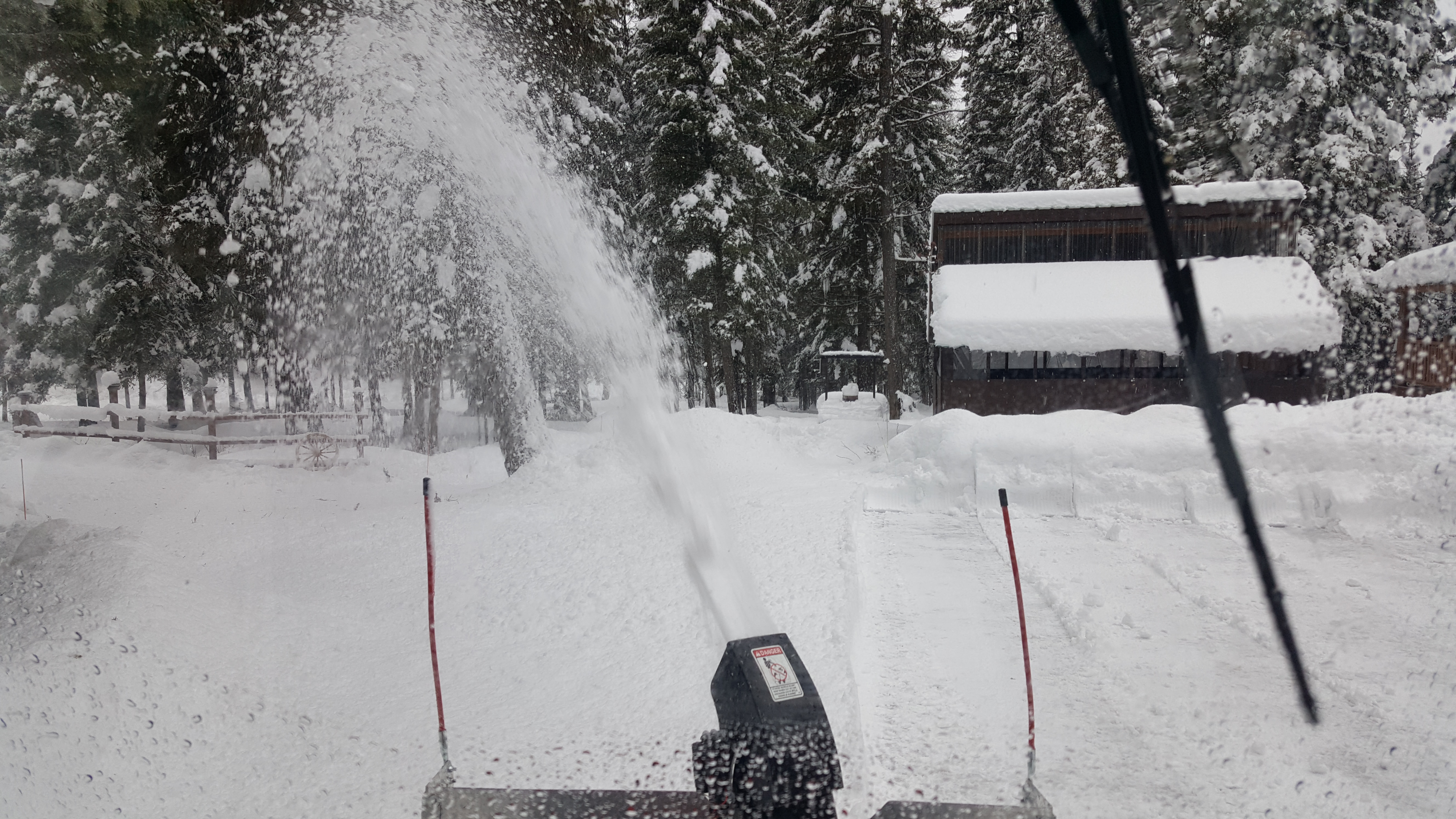

Yesterday with over 18" of new wet snow on the ground, I finally got to try out my UHMW lined snowblower discharger chute modification.
I did not have any problems with the chute clogging up and noticed that there was hardly any snow build up inside of the chute.

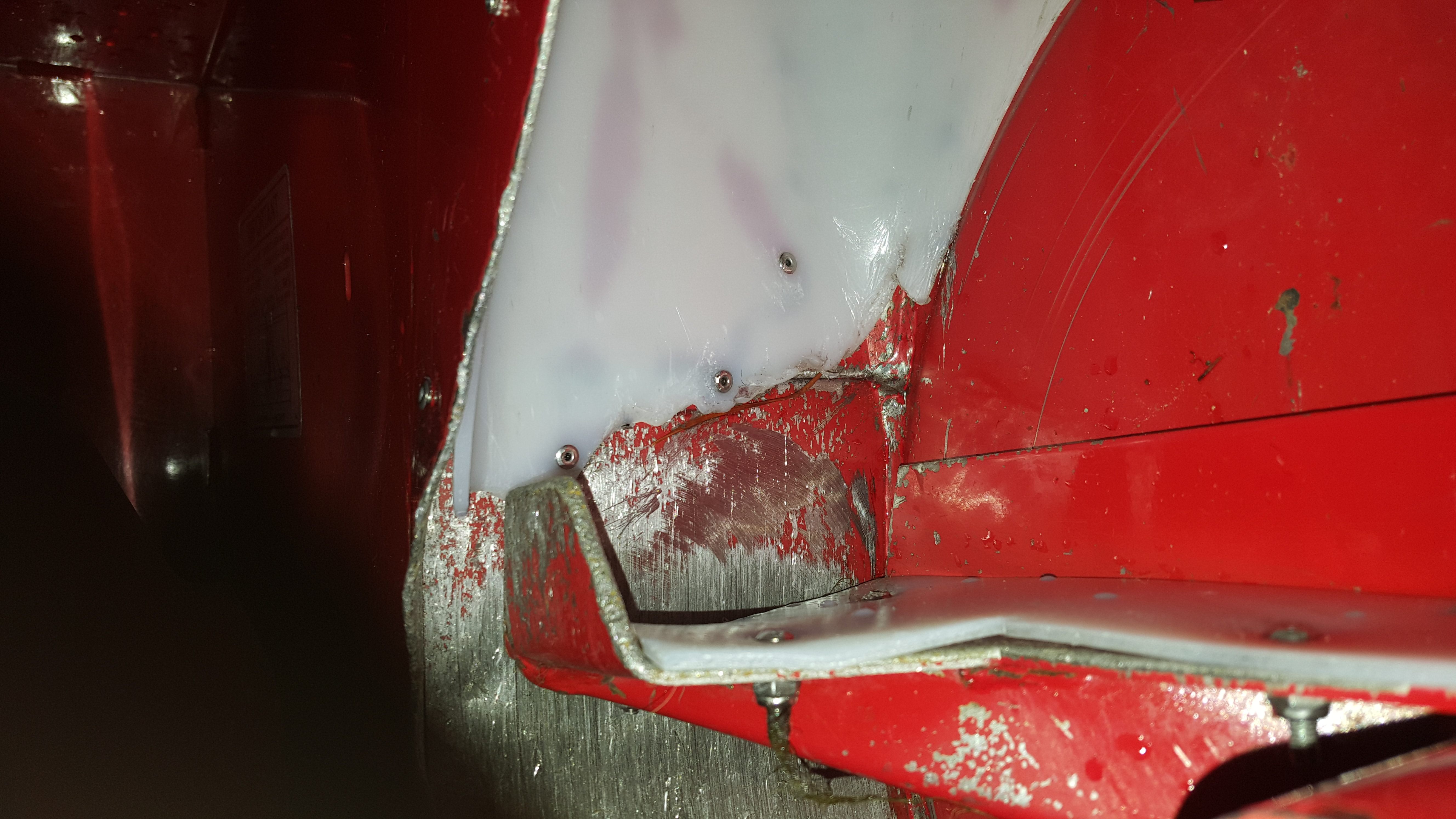

However, I had to trim some UHMW from the bottom of the transition chute where the blades come very close (1/4" gap originally) to it.
I had installed my blind pop rivets about 1" from the bottom edge and the snow/ice appeared to get underneath the UHMW and raise it enough to have contact with the rotating fan blades.
Now this area has about a 1/2" gap between the parts.

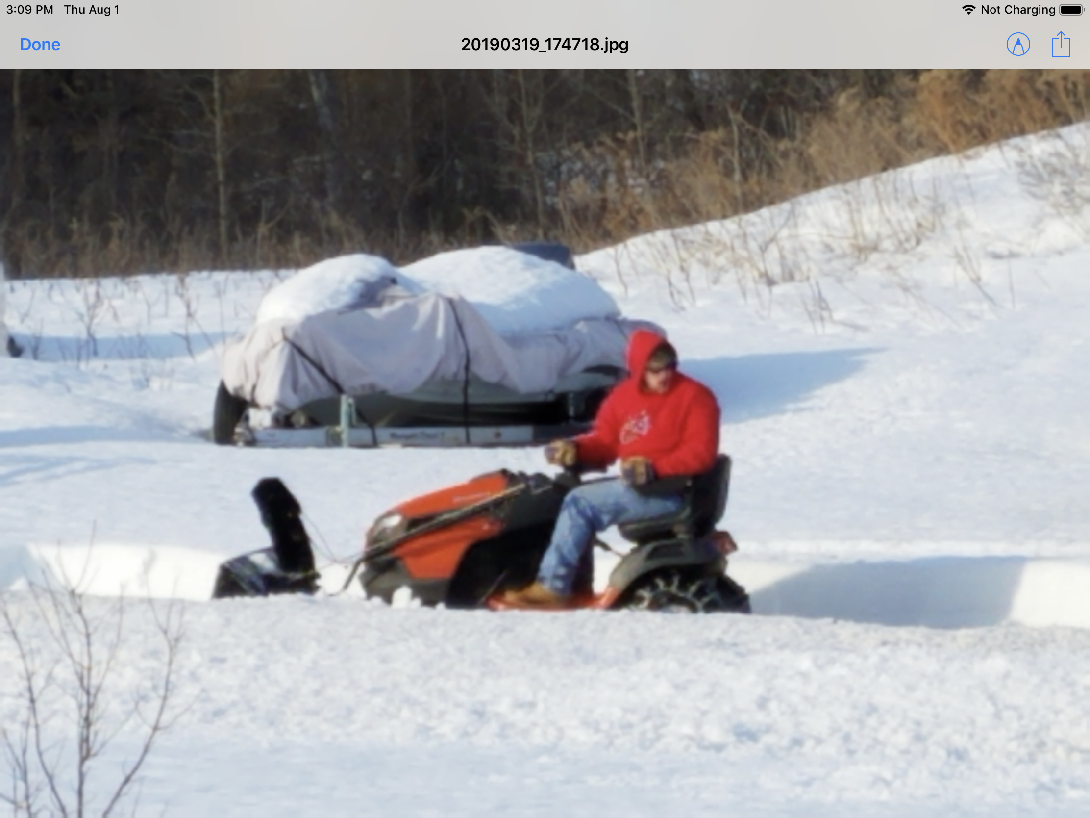

Last night was cold, at 9am this morning it was only -12* and now it痴 3* with real feel at -16* and we are supposed to get a light dusting of snow this evening.
I am surprised at how well my Husqvarna tractor and snowblower handles the heavy wet/slushy snow. My son moving heavy wet snow last spring, it is not throwing it very far as you can see but it is not plugging up either.
