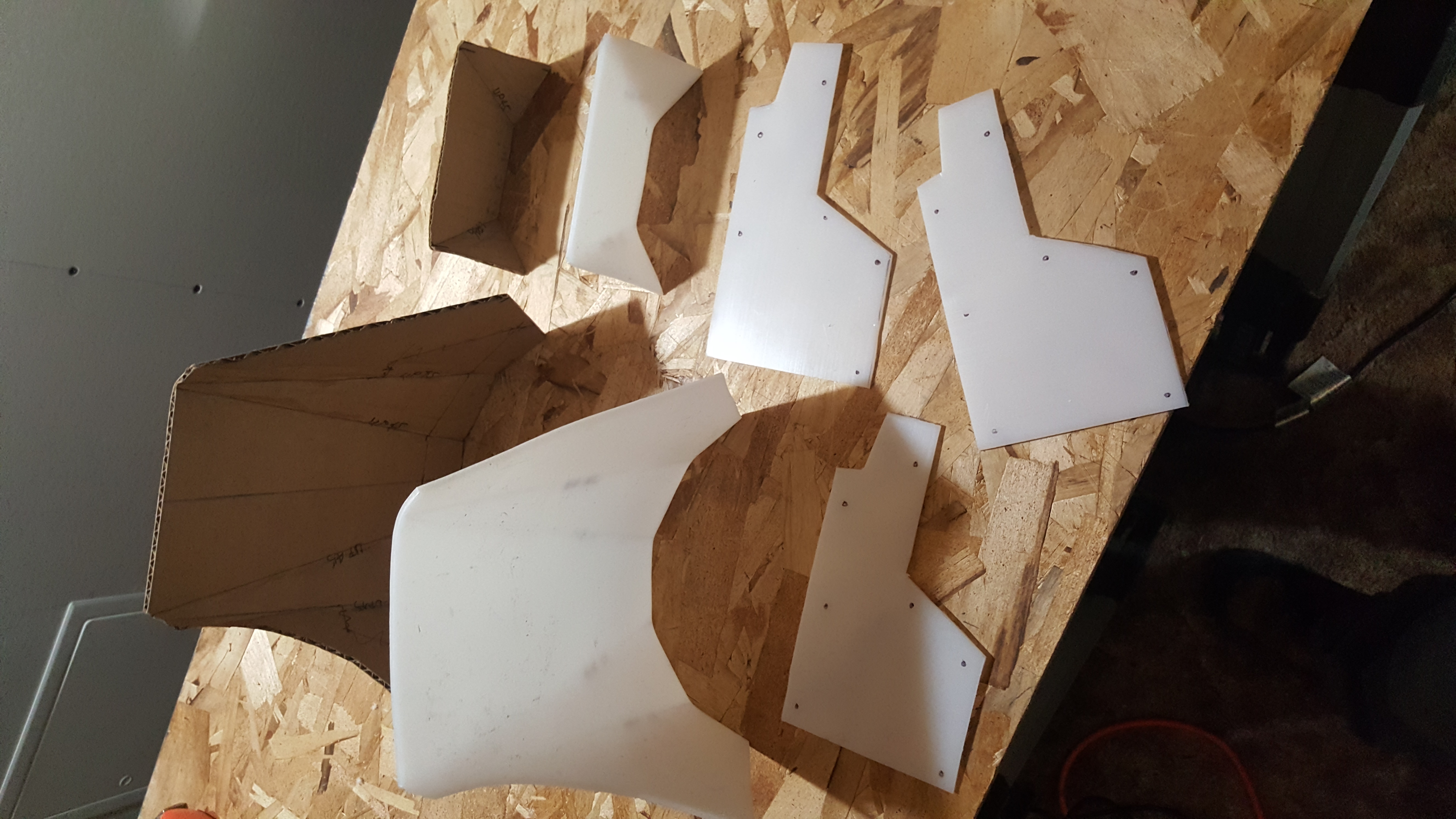

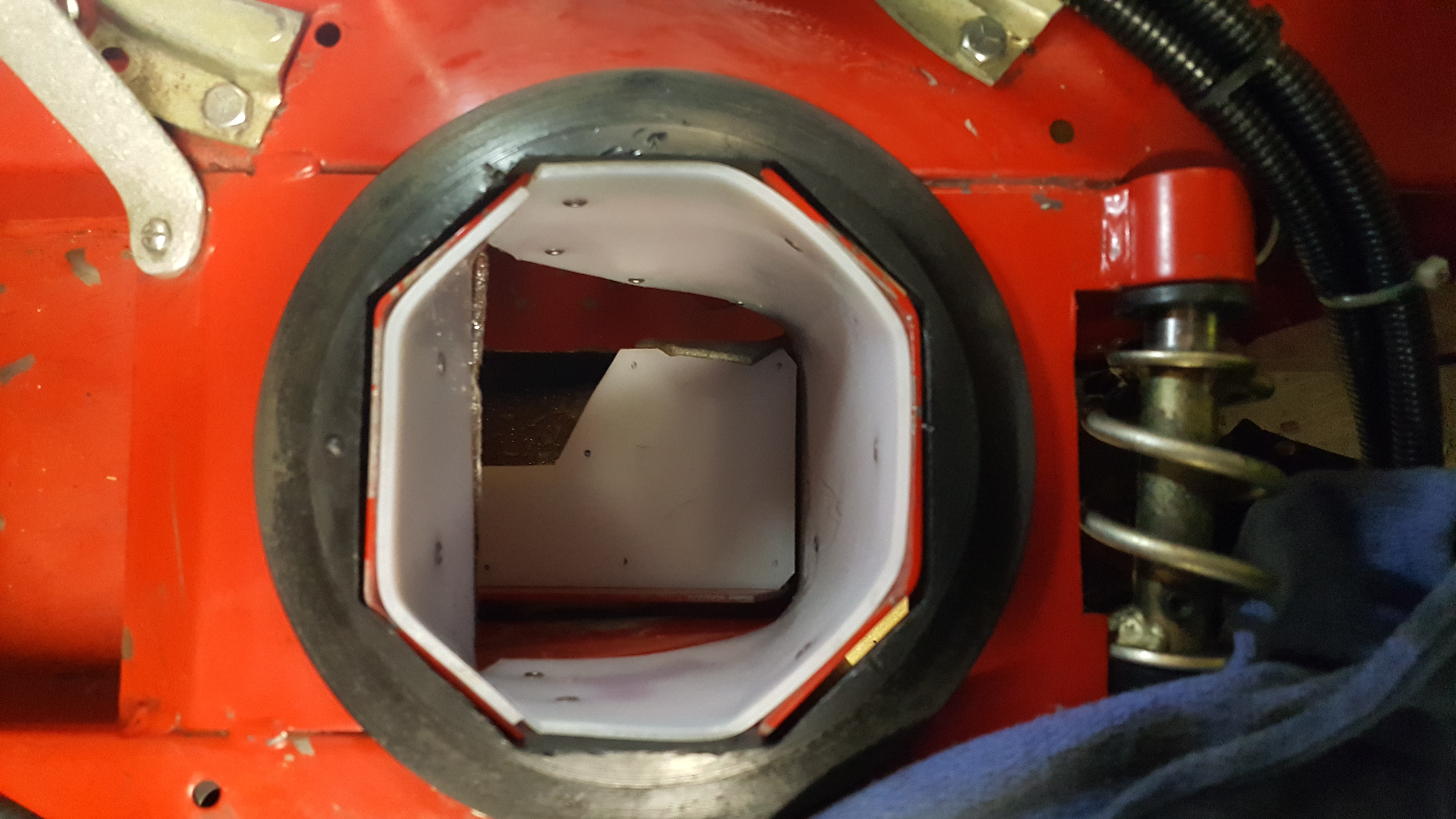

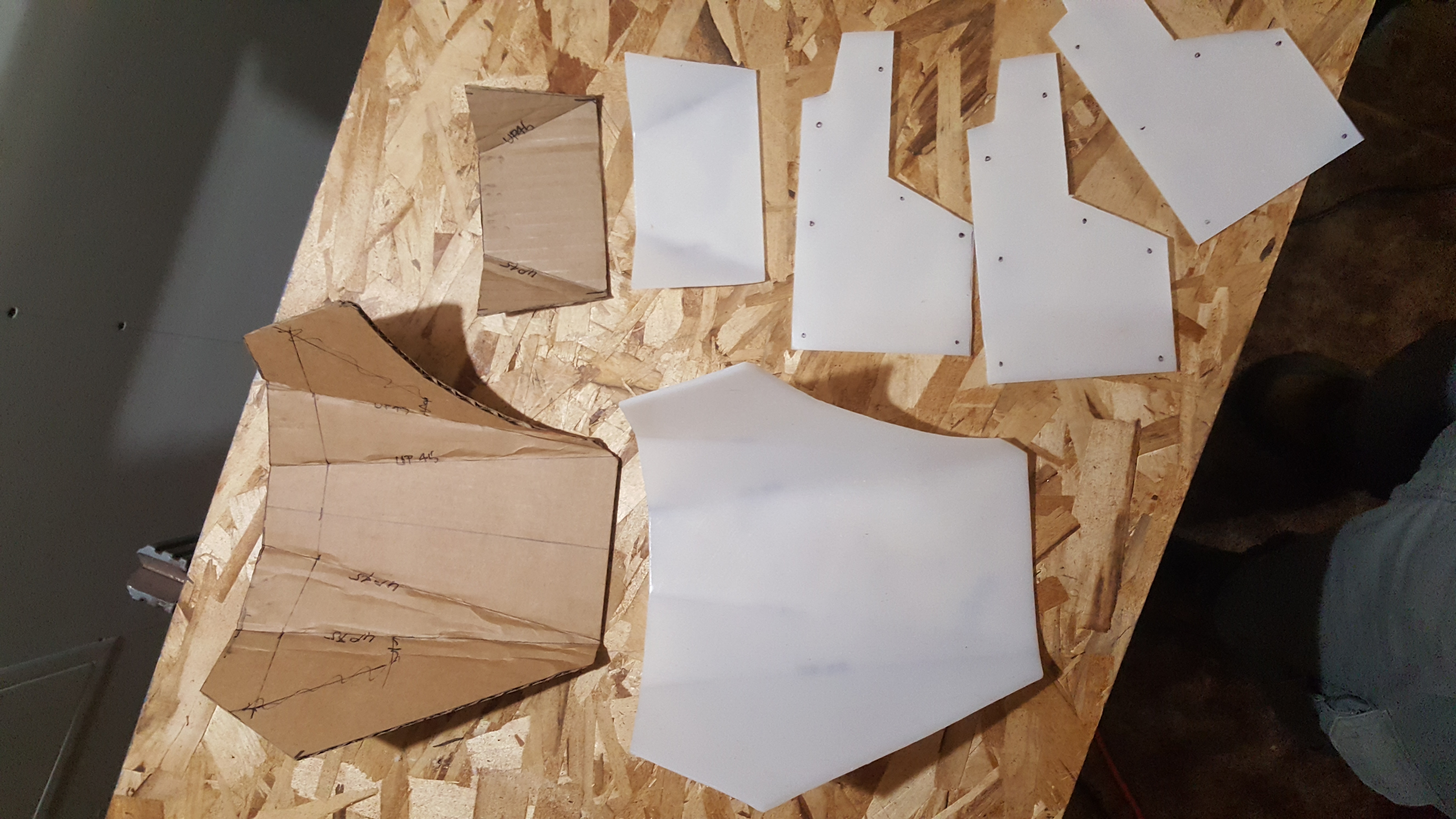

Almost done with my MF 2360 snowblower modification project using 1/8" thick UHMW to line the 3 fan blades, the transition discharge area and the chute.
Finished installing the UHMW on the small transition area in between the fan/fan blades and the discharge chute (used 1/8" diameter stainless steel blind pop rivets).
Pictures are: cardboard patterns and UHMW shaped for installation (2 pics), and UHMW installed on the transition area of the snowblower.
Only thing left to do is install the 3 fan blades UHMW and reassemble everything.
KC
KC
