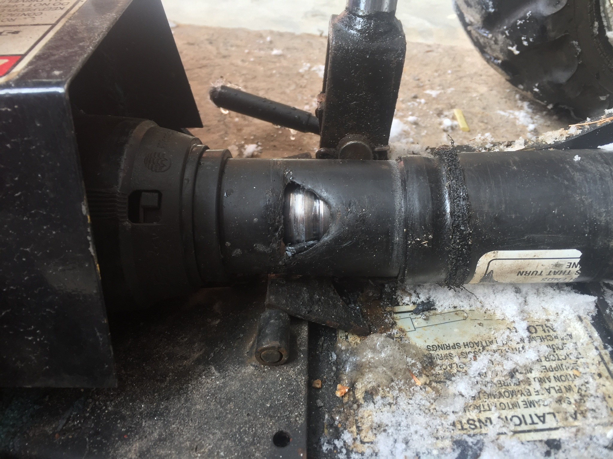

I looked at my snow blower today to find the sleeve and part of the shaft worn down and this was new a couple of storms ago.
Any ideas? Doesn't appear that anything is hitting at least in the lowered position. I did run it in the up position for a while but geesh.

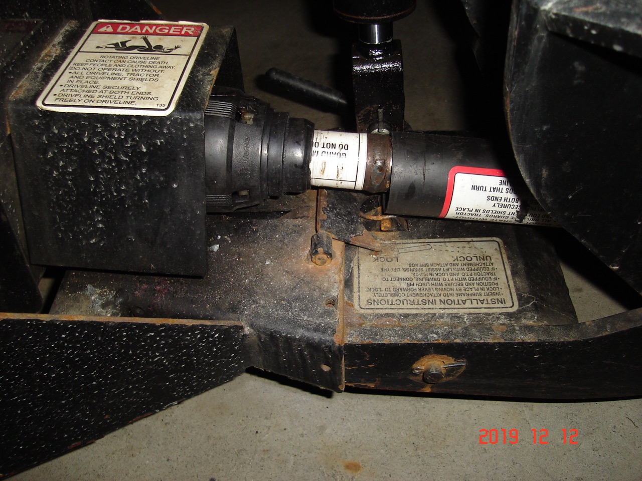

Mine cut itself off some time ago. Partly due to my leaving the little flip-up shaft stand up and in the way a few times, partly just wear, I guess. Almost looks like yours is a bit closer than mine...? Anyway, no biggie, IMO.
Mine also cut in two pieces just like irvingj's about 10 years ago, very first time using the snowblower, didn't know any better and ran it with the saddle in the vertical position.
All I did to fix it was to slide the two cut pieces back in position and wrapped black electrical tape around both pieces (about 30 to 50 wraps?) and I think I have only replaced the tape twice to date?

That sleeve is a safety device and meant to free-wheel around the shaft to prevent entanglement and loss of extremities. Ensure this sleeve does not spin when the blower is engaged. From the photos it appears that is not the case except for the hole that burned through.
