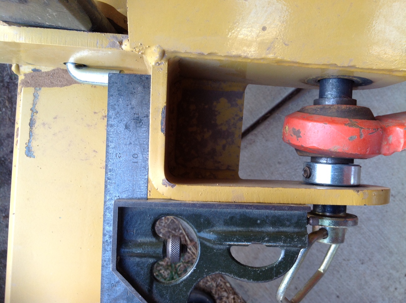

The ear itself is a perfect 90 degree piece of angle:

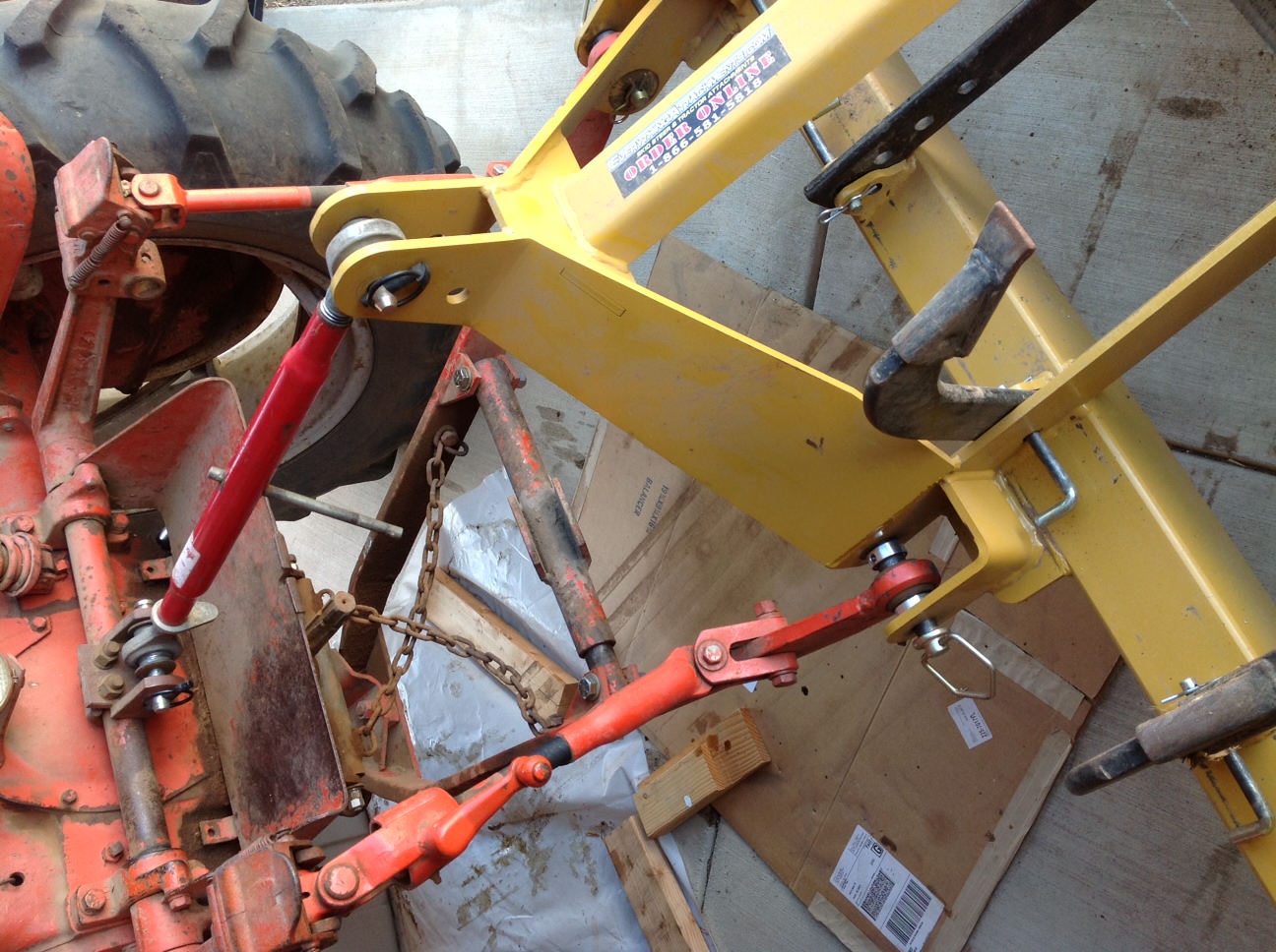

Here's the 3 point hitch:
Some of the problems you are having has to do with the 3 point on that AC tractor. It came from the factory with an Allis-Chalmers snap hitch not a 3 point hitch. It has an aftermarket 3 point hitch on it that is compounding your problem. Cat 1 lower hitch arms should be almost parallel spaced at 26? Cat 2 is 32? A 3 point hitch should never have a sway bar in the middle like this. The tractor mounts for the lower arms are too close together to give proper 3 point geometry. The Welding angles are not perfect on the box blade but they are well within industry standards. If you want one perfect angles then go buy a Gannon that cost $1800. You got a good product at a good price. I don稚 have any connection to EA but the truth is the truth.
Well, you are partially right- the tractor did originally come with a snap coupler system.
However, the three point hitch adapter is a factory Allis Chalmers part, not an "aftermarket" 3 point hitch. It was intended to support all manner of implements and has many installation options, including multiple beaming screw mounting positions, stabilizers, cross links, parallel lift, etc.
I suppose that if these adapters were sold for decades and used for over half a century in production agriculture, it is likely that they are sufficient for the job.
There is no "sway bar" in the middle of the hitch. The cross tube can be used for beaming tube connection and keeps the 3PH arms parallel. That is not an anti sway function. The somewhat limited sway control is provided by the sway/check chains.
As to your claim that any welds are within "industry standards"... What industry are you in? :laughing:
Regardless of your misguided claim, I do not think that EA has any intention of slapping out cheap and shoddy products in the name of low price. This just looks like "the one that got away..."
I guess this is getting into the weeds anyway, but I must admit that I thought your post was rife with inaccuracies masquerading as experience.

I hesitated for some time before writing this post, but decided I could use a little community input.
I purchased a 78" box blade for tractors between 30 and 70hp from Everything Attachments a few months ago. I hadn't even heard of Everything Attachments at the time, but I was searching for a box blade made in the USA, and when their site came up on searches, I did a little research and found that they were a legitimate company. I ordered the blade and it came via freight right on schedule.
I was very satisfied with the apparent build quality, especially for the price, over anything I could source locally. The blade had one small defect; one of the lower 3 point mounts was narrower than the other due to a welding mistake.
I spaced out the narrow side differently, and went ahead and used the blade. I eventually decided I'd drop EE a line and mention that although I really liked the blade, they should be aware that they had a little QC problem and should watch out for it in the future.
Well, I heard back from EE, and they seemed polite enough in acknowledging my email, but then a few days later I get another email saying they thought that I had a stabilizer issue which was letting the box blade swing from right to left and causing the ears to bend. (note that the outer ear is angled inward, which isn't something that could be caused by swinging in the first place).
I sent a few additional pictures showing that the ear was simply not welded square to the center clevis panel when the implement was manufactured, and it was not bent in any way. The ear itself is a perfect 90 degree angle with perfectly straight sides, etc.
What did I get? Another email saying I would "continue to bend the ears" if I continued to use it without a stabilizer.
I'm pulling the 78" box blade with an old farm tractor that makes under 25 drawbar horsepower. The box blade is rated for tractors of up to 70hp. I am using a factory 3 point hitch adapter that has pulled box blades for hundreds of hours without bending them up. In fact, if this blade can be bent - even if it was abused (when in actuality it's doing light work in light soil) - by this old tractor, it's got a problem to begin with.
I don't understand this kind of response insisting that the customer is essentially destroying equipment through misuse when it is clearly a manufacturing defect. I have several other implements on my shopping list, and due to my overall satisfaction with my box blade, I was going to buy them from EE. At this point, seeing their attitude when a defect or quality control issue is pointed out to them, I am concerned about what kind of response I would get if I had a real issue that needed to be corrected!
I'll say it again - this box blade is better than locally sourced blades that cost $500 more -
I guess I'm just looking for some input from someone who's had to deal with Everything Attachments after the sale...
