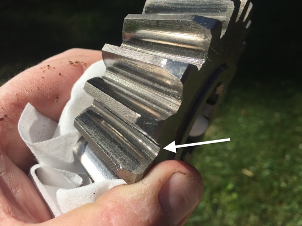

Well, I don't understand what the dark line in the tooth above my thumb was in the pic. I looked the gear over about 5 times and there is no crack or sign of the dark line.
That's good news, I was very concerned.
   / What is going on here? #12
I think it is just a shadow:
It lines up with the shadow on the tip of your thumb.
