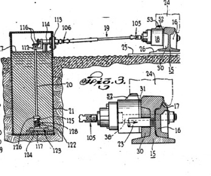

Here is a patent drawing of the lubricator with a drive shaft.
Full diagram:
http://patentimages.storage.googleapis.com/pages/US2486600-0.png
Patent:
Patent US2486600 - Rail lubricator - Google Patents
Secured to the other side of rail is plunger mechanism,... including a plunger adapted to be depressed by the treads of wheels. The plunger mechanism operates through suitable clutch mechanism, ... to drive uni-directionally a flexible shaft extending to a lubricant tank set in the ground alongside the track and filled with lubricant ... The flexible shaft drives a vertical shaft in the tank which in turn drives a series of gear pumps...
