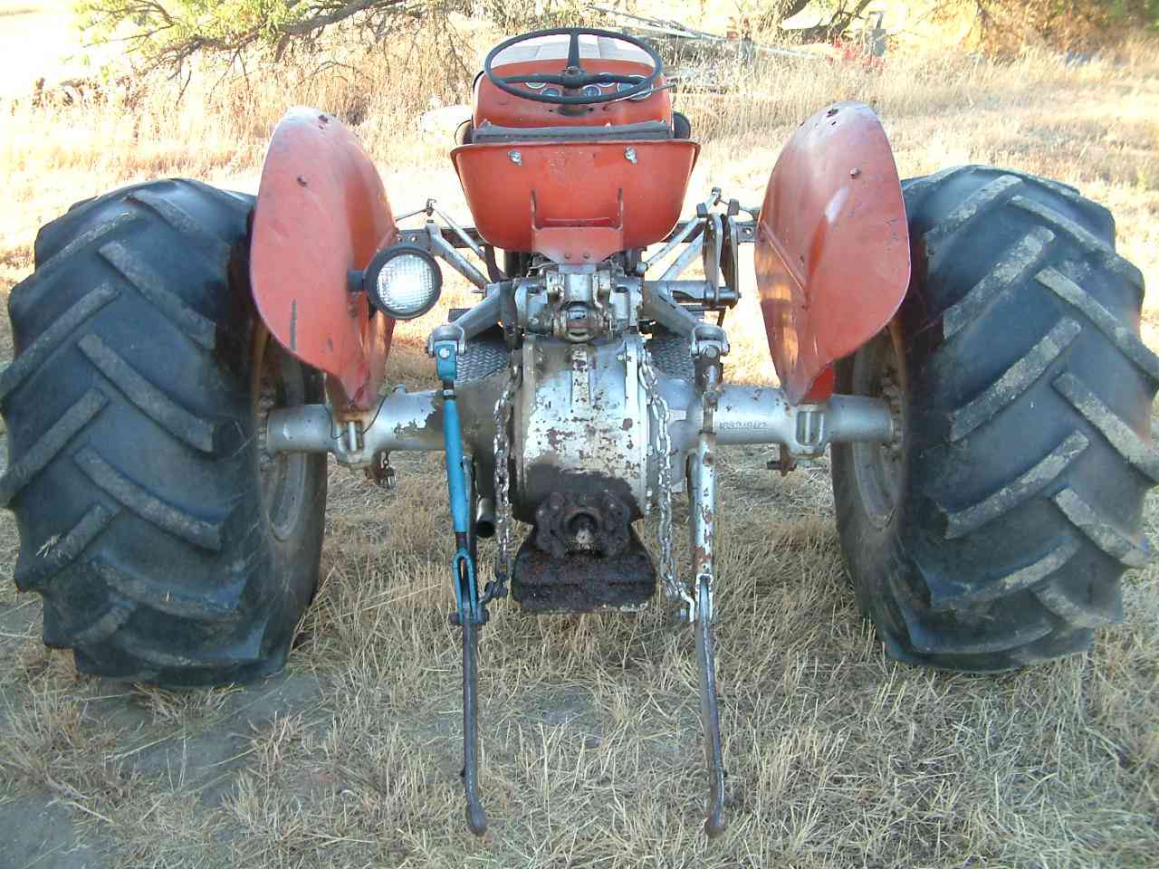

I have a MF CG 1750 (SCUT) ... Just put a set of Bro-tek 3 inch spacers on it and I am amazed at the difference in what the stability seems to be with the extra 6 inches of width made... Went for 53 to 59 inches outside of tire to outside of tire...
