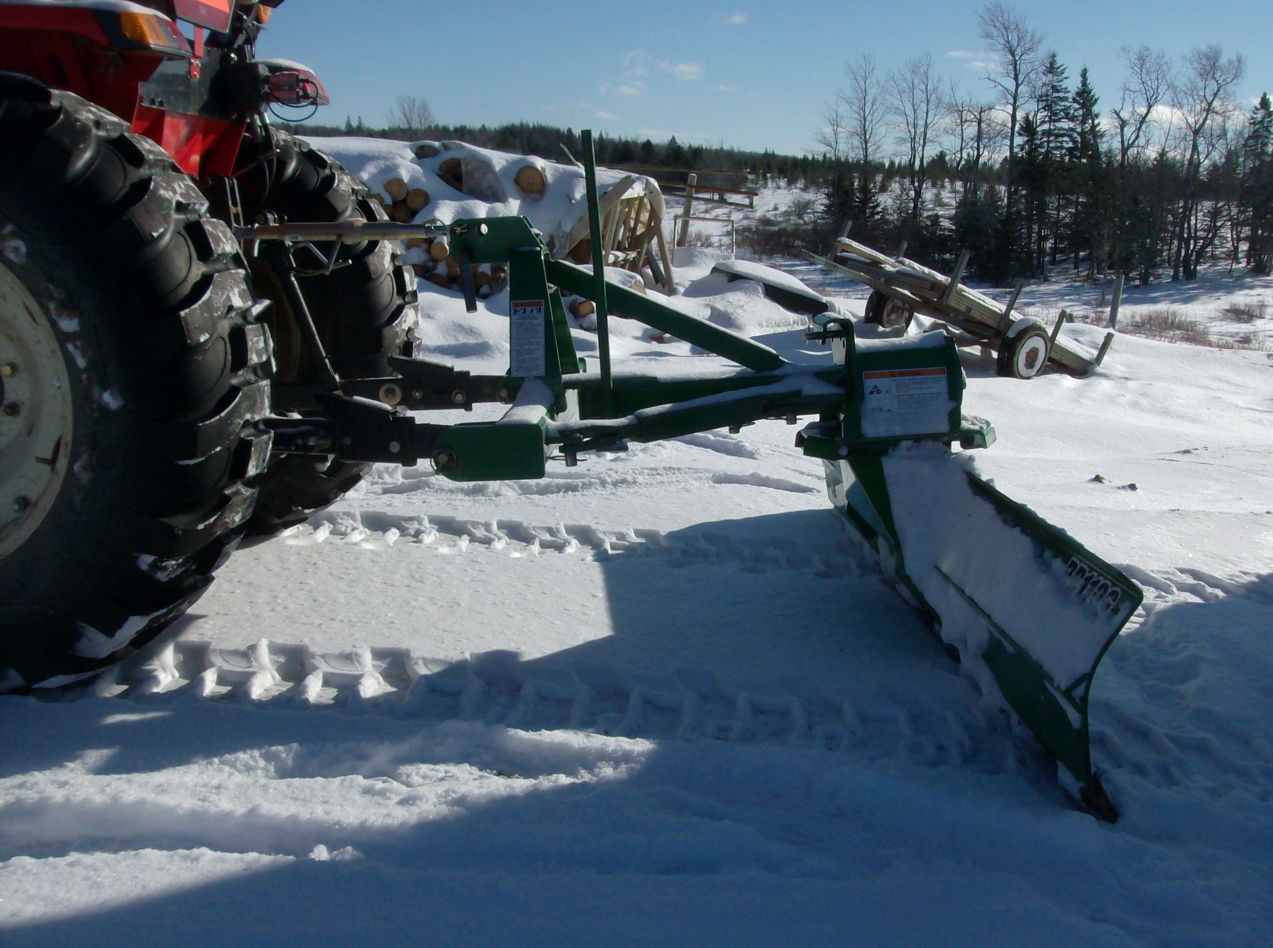

Several posters suggested shortening the top link. I don't understand how you could do that. Whenever I plow snow I turn the blade fairly sharply to one side so the snow is discharged to the side as I plow. If I were to shorten the top link the leading end of the blade would dig sharply into the road while the trailing end would be high in the air. I always have to keep the frame nearly level to keep the blade parallel with the road along its length.

You need to adjust the sidelink to level it.
There isn't enough range in the sidelink adjustment on my JD 870 to overcome any noticeable amount slant to the frame. In fact, I mostly ignore the sidelink adjustment when I do want to cant the blade at an angle to clear the ditch, and adjust with the top link instead. Do other tractors have more range in the sidelink adjustment?

I agree. That was the point I was trying to make in that long discourse. But if someone insists on shortening the top link, which is OK with me, to make the blade less aggressive it may float up on you.
I keep the frame and blade level like you do so that I can put the blade at any angle w/o readjustments. If it digs in I just raise it a little.

You should be able to get about 10 degrees of tilt to either side with your side link adjustment. ;)

Alot of tractors have additional holes in the lift arms so you can get more tilt or in thr sidelink itself.

Here is the plow with hydraulics all the way down
Pic with hydraulics about 4 " up plow is just touching ground.
I can see if I lengthen the top link it will sit more level
