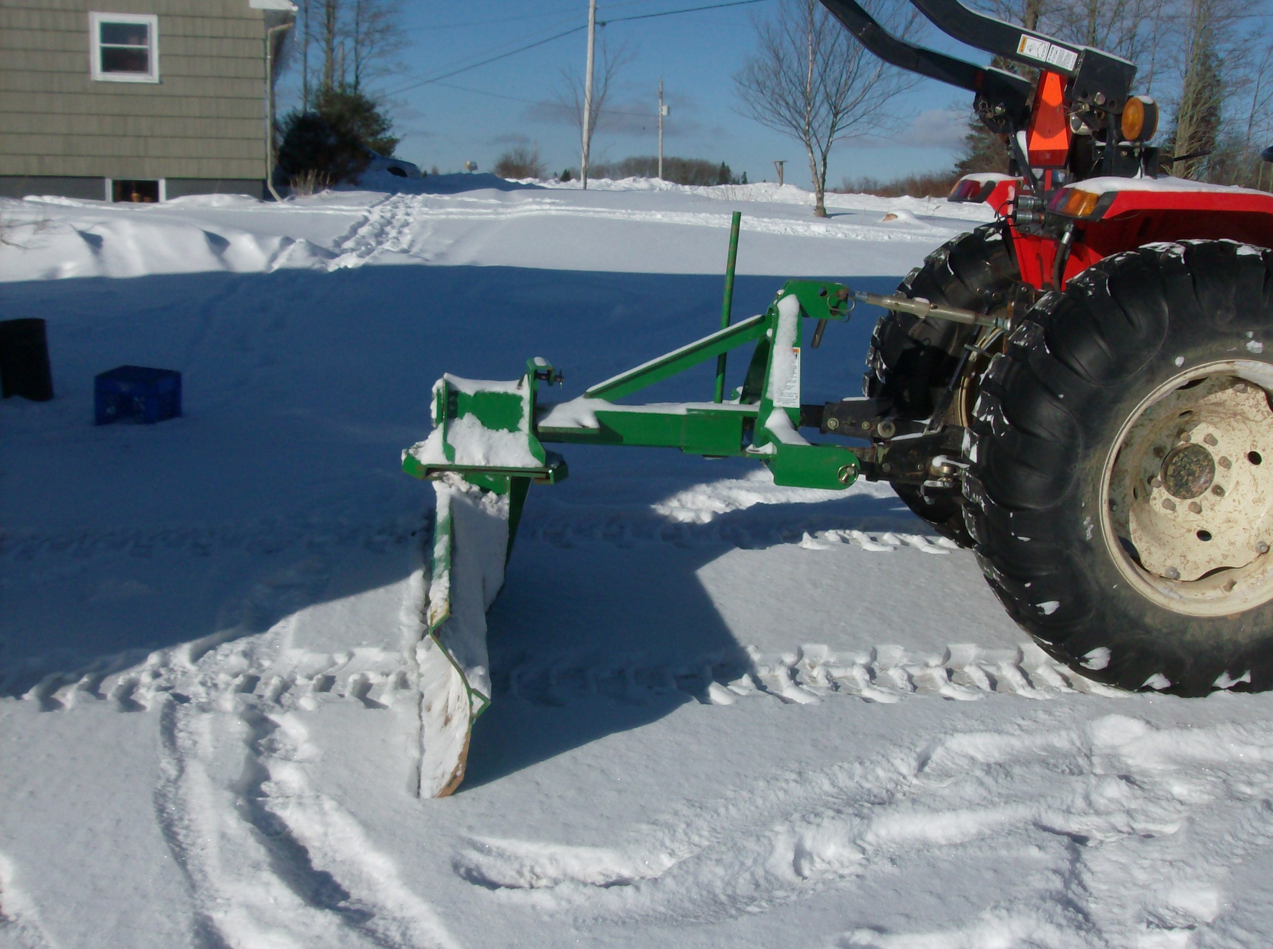

Here is the plow with hydraulics all the way down

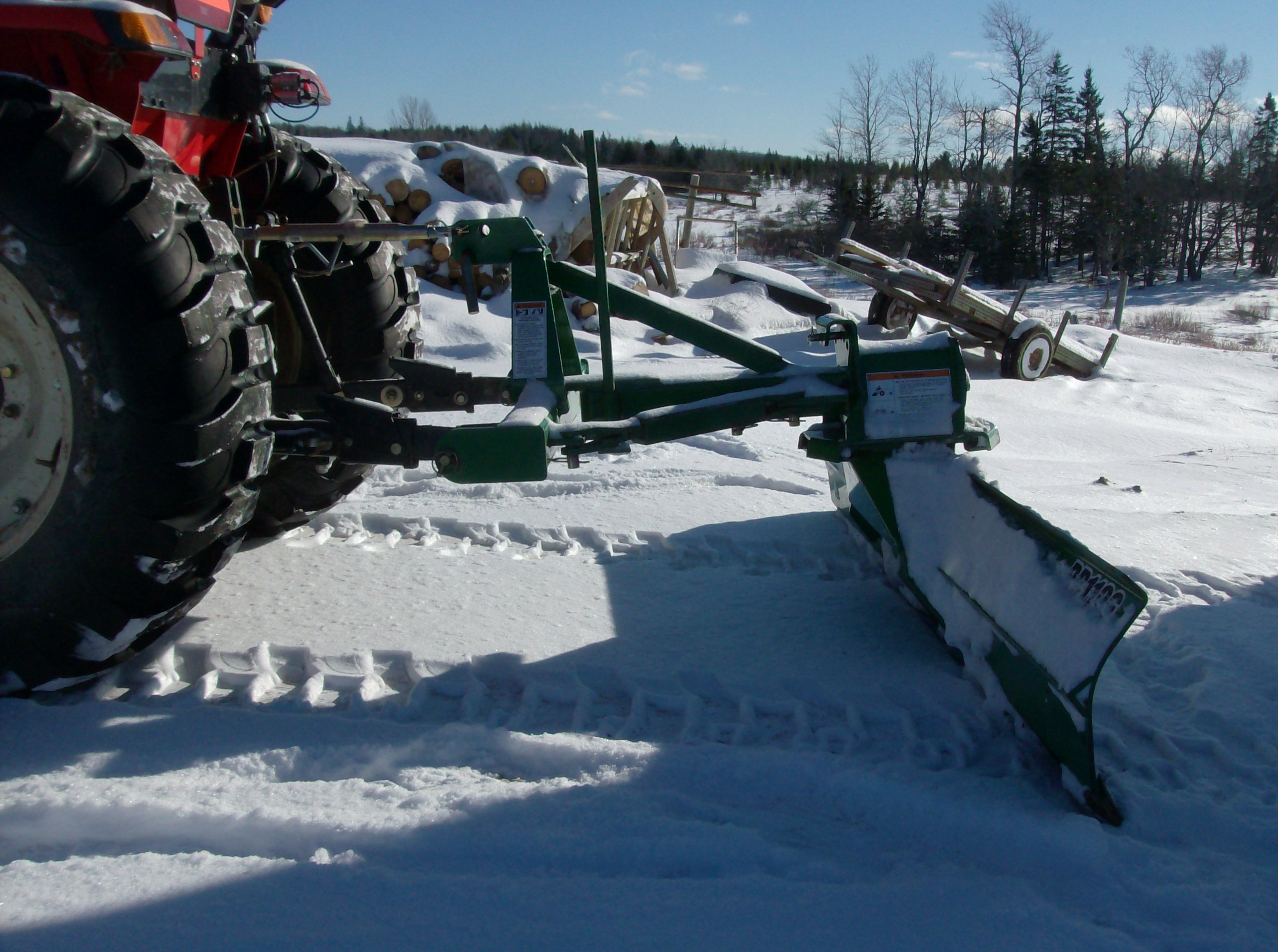

Pic with hydraulics about 4 " up plow is just touching ground.
I can see if I lengthen the top link it will sit more level
That is about how I plow with mine, maybe a hair shorter on the toplink. It is going to vary by how hard the ground is frozen as to how short you can run it. I have the same blade, it is made by Woods. It just takes practice.

I saw you have a rear remote a hydraulic toplink is very handy. You can make adjustments on the fly if it is cutting in to much or not enough.

Seems his blade back bone was very level when he plowed in the video
