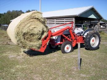

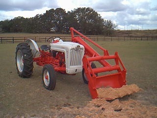

The more i thought of that 1000# rated loader.. I started thinking... Here are some pics of my 1000# rated loader.
She's only got 1 support arm, and is 51 years old and runs fine of a 4gpm pump...
That other loader sounds like it was built to scoop pine bark.. or maneuer.. and or be fit to a SCUT.. etc..
