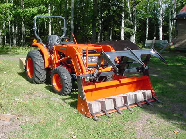

I have the 72" bucket and 72" box blade. Both seem to be ok. If you come close to filling the bucket with gravel (see pile in background), the box blade is a nice counterweight. I used the back side of the box blade for backfilling around my camp - worked good. Attaching a pic of the bucket - was moving some block. Also got the bolt-on grapple. Bush hogged for 5 hours today with my older 48" - would have been nice to have a 5 or 6 footer.

SkyPup,
Just a quick question......Why do you have the teeth in the box blade backwards? Just something I noticed in the pic.

Wasn't using them, and alot easier to just reverse them than to take them off and store them somewhere. Plus, if they are on forward, when I adjust the angle of the BB with the TNT, it can force them into the ground when you don't want that to happen, as in grading our limerock road without ripping it.
