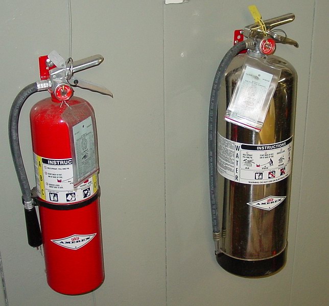

Chico922, I have seen many a thing burn and know that you can stop the fire if you have the right gear. So outside my tool shed is not one but 3 fire extinguishers. 2 are water type I think 2 gallon and one is a 10-pound ABC chemical type. These are all in addition to one ones in the house, cars and trucks. It is always nice to be able to grab the water one and take it up the hill if you know you are going to be brush cutting or use a cutoff saw. I have started many small fires with the cutoff saw so having a fire extinguisher is a must. I have attached 3 photos of where I place them on the shed to give folks a better look at commercial quality fire extinguishers.
George

   / What size fire Extinguisher??? #39
Closeup of Fire extinguishers
