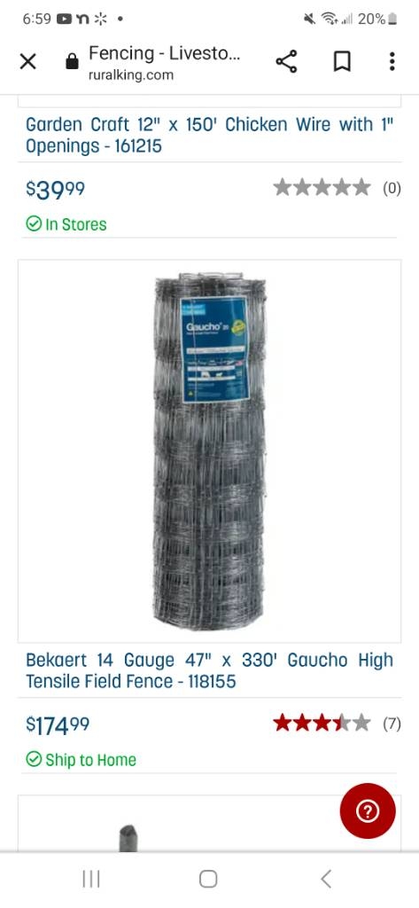

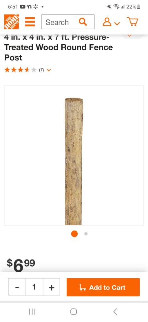

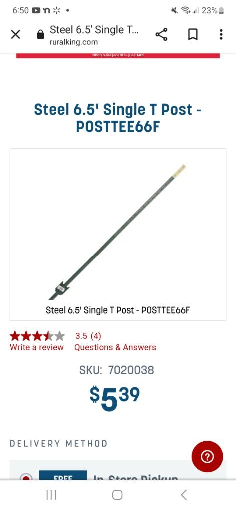

I've got approximately 1000 lf of fence that needs to get installed. The front 220lf plus about 60 ft on other sides is done; and I used all 4" wood posts, 6.5-7 ft long; with 6-7", 8 ft corner posts, line posts at 12 ft OC. For the sides and back, I had planned on doing 6.5 ft tee posts, with some wood posts, maybe every 4th, at 8 ft OC. I've got all the corner posts and posts for 2 minor gates. Question is; with the current price I'm seeing for 6.5 ft Tee posts ($5.39 ea) vs 7 ft 4" wood posts ($6.99 ea); what would you use. Plan is 54" high; running 47" Guacho field fence (might run a single strand of barb one day, or get fancy and run a 1x6 top board). The sides are pretty level for 2/3s of the run, dropping about 6 ft on the last 1/3. The back has a pretty steady side of 4 or 5 ft in 220 lf, if that affects suggestions.

Without livestock, space your T-posts farther apart. I use 10' spacing for my property line-dog-fence.

I have cows and T post is what I use. Spaced 8-10' apart. T post should hold your dogs just fine.
Those wooden post will rot away. I have seen some very old T post and none are rotted away

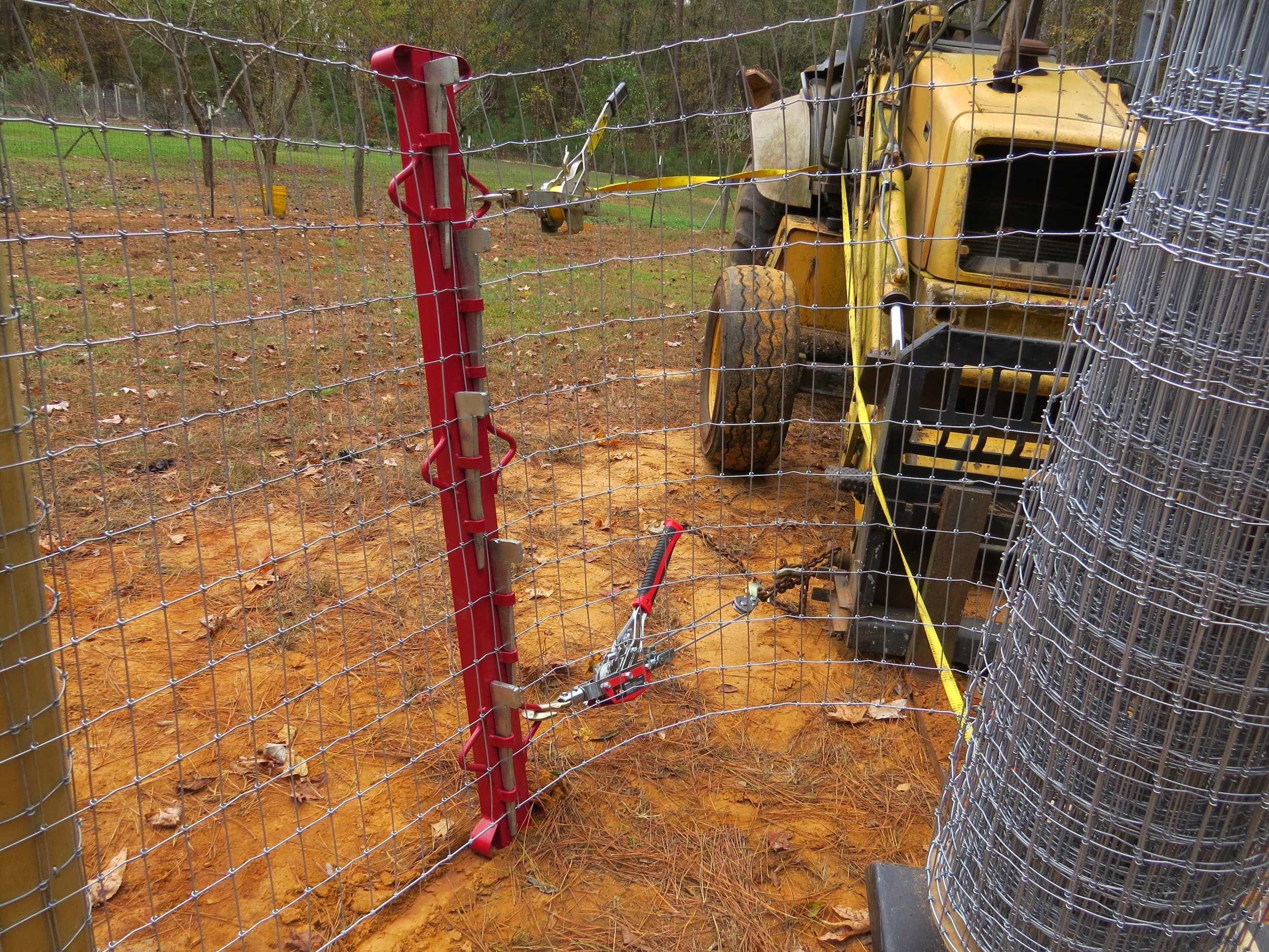

How are you stretching your wire? I bought one of these 4 foot stretcher bars from Kencove that I highly recommend. I put a come along on the top and another on the bottom, and I can really pull the fence tight quickly and easily on my own. I use my backhoe with some chains to anchor the come along's.

The front fence I stretched with 2-2"×6"×4' with bolts comnecting; and pulled with a SxS. Worked OK, but not attached to the method.

I think T-posts are the way to go. You live in a very challenging environment for wood posts. If you have access to marine pressure treated wood, UC4A/U4B/UC4C, you could use those and expect some longevity, but around here, they are neither easy to find, nor inexpensive.
Don't use round posts; those are almost always peeler cores from plywood manufacturing. They are a very soft, low strength wood, and while treated, aren't treated to a standard, and will decompose rather quickly.
Here, pressure treated posts are gone in 5-7 years due to insects and fungus. I'm having to self treat all my pressure treated wood with copper naphthenate to try and get some longevity from it. However, the treatment is only 1/4" deep, so if the wood cracks in the future, the post is toast. Don't forget to treat and cap the top of the post to keep rainwater out.

The comment about cost was; I always treated Tee posts as the inferior product, that was 1/2 or 1/3rd the price; when I saw them basically with 25% of each other, that's what got me wondering; was there a cheap source of Tee posts. I swear I thought they where around $2.99/each; but I guess everything has doubled over last 4 or 5 years.

Having bought lots of T-posts, they do come in various qualities. The cheap ones will bend the moment the weather changes. (Kidding) Seriously, keep an eye on the weight/ft, and buy the heavier ones. I think that pulling bent T-posts and replacing them is no fun.
I don't know when I last saw even cheap T-posts for $2.99, but whenever it was, it was a long, long time ago.
