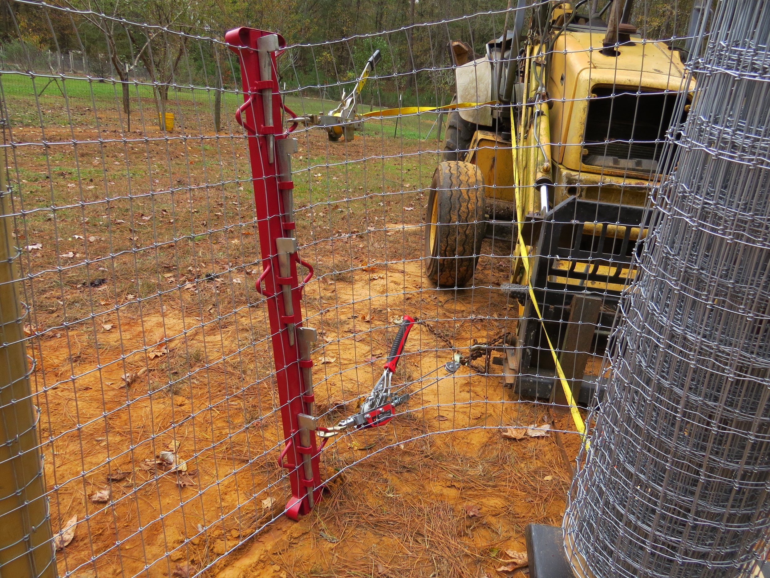

How are you stretching your wire? I bought one of these 4 foot stretcher bars from Kencove that I highly recommend. I put a come along on the top and another on the bottom, and I can really pull the fence tight quickly and easily on my own. I use my backhoe with some chains to anchor the come along's.
