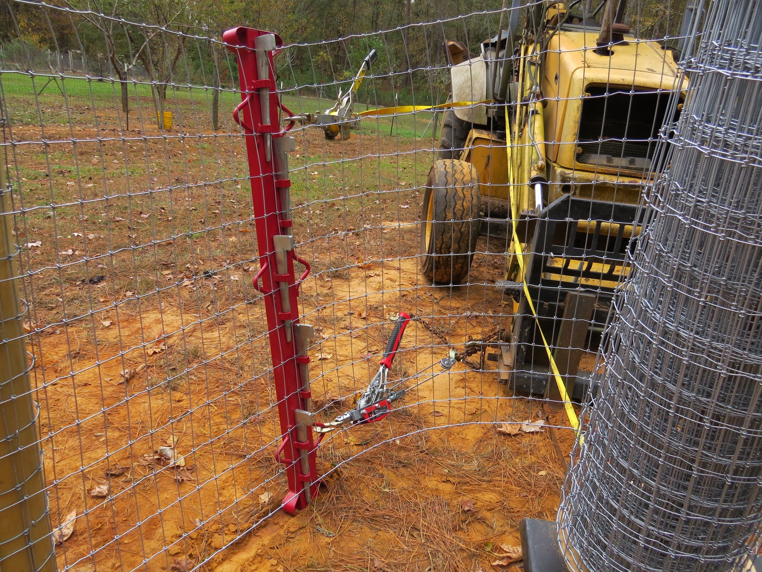

How are you stretching your wire? I bought one of these 4 foot stretcher bars from Kencove that I highly recommend. I put a come along on the top and another on the bottom, and I can really pull the fence tight quickly and easily on my own. I use my backhoe with some chains to anchor the come along's.

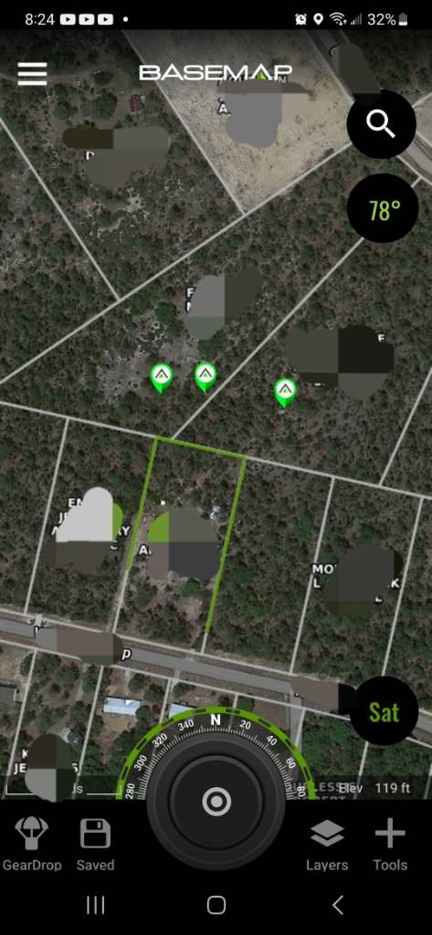

The one side with a aerial power easement half on mine/half on neighbors parcel, I'm putting a 10 ft gate that I had in the bone yard. The Green outline is roughly what still needs fenced. Gate on left side of picture.
Wife wants to install gate opener on the main 16 ft gate at the road.
