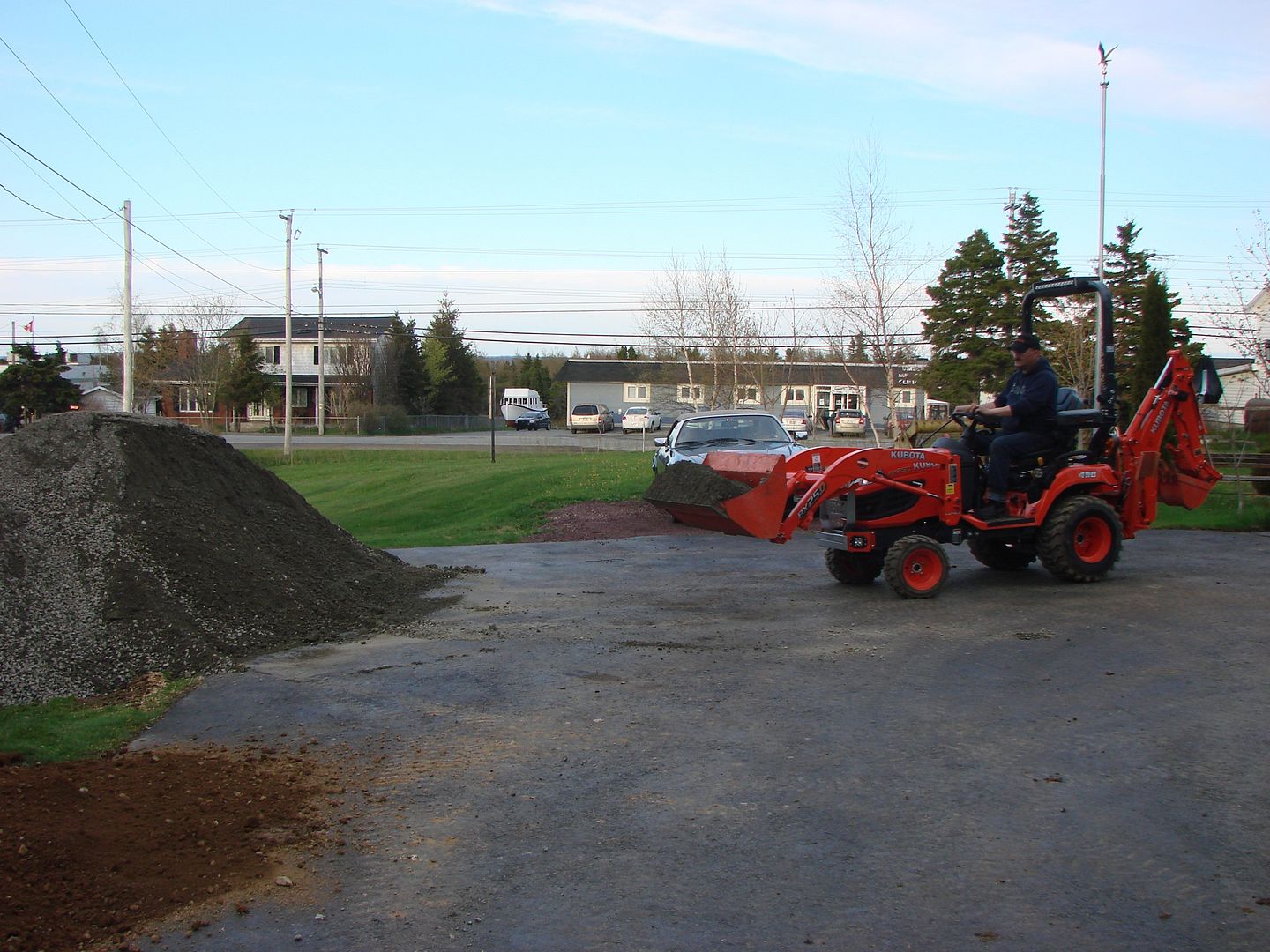

Man I don't know. There are hundreds of these BX tractors out there with wheel spacers installed on them mine included that haven't had an issue. Actually yours is the only one that developed a crack that I know of and where a wheel spacer was mentioned in the same sentence. Maybe you just had a bad casting? Maybe something else? I realize that you said you don't know if the wheel spacers were a direct cause of your problem but when you mention nuclear inspector and saying the crack appeared two months later you sure are insinuating they were the cause when in actual fact you have very little evidence that the spacers had anything to do with it at all. :confused3:
I've hauled at least 12 tandem loads of heavy gravel with my BX at long distances and never had an issue. If the spacers were going to cause a crack they sure would have done it on my job. (See photos)
Now I appreciate the fact that you are a Nuclear inspector and I am a licensed vehicle inspector and in my opinion the wheel spacer had nothing to do with it.
Remember, this is someone's lively hood and good reputation here we are dealing with. I think you should have had more definitive evidence before dragging Bro-Teks good reputation through the mud.

I'm running 1.25" front and 2" rears.
