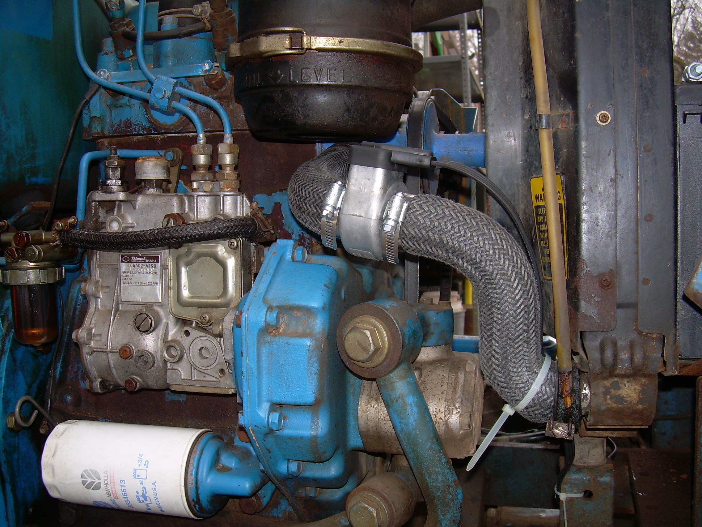

Update, I went with the lower radiator heater. it's only 375 watts but after only about 1/2 an hour the block felt warm to the touch, they recommend 2 hours min and up to 5 hours to get max heat rise of 60* over outside temp.
Got it from Pep Boys for $ 29.99, came with a 3 ft cord, easy install. this one is for 1.25" hose, the ones for 1.5" and 1.75" are 600 watts. put a new hose in at the same time also 30 bucks. Just installed it today so haven't tried it yet with a cold start but I think it's gonna help alot.
JB.

That looks good. I need to do the same to mine.

My vote is for a lower rad hose heater. I put one on and cant believe I lived with out it. I had a mag heater and a dipstick heater and they were worthless.

I did the same thing to my old Ford 1100 years ago. What a difference in starting :D! Good job JB :). Jay

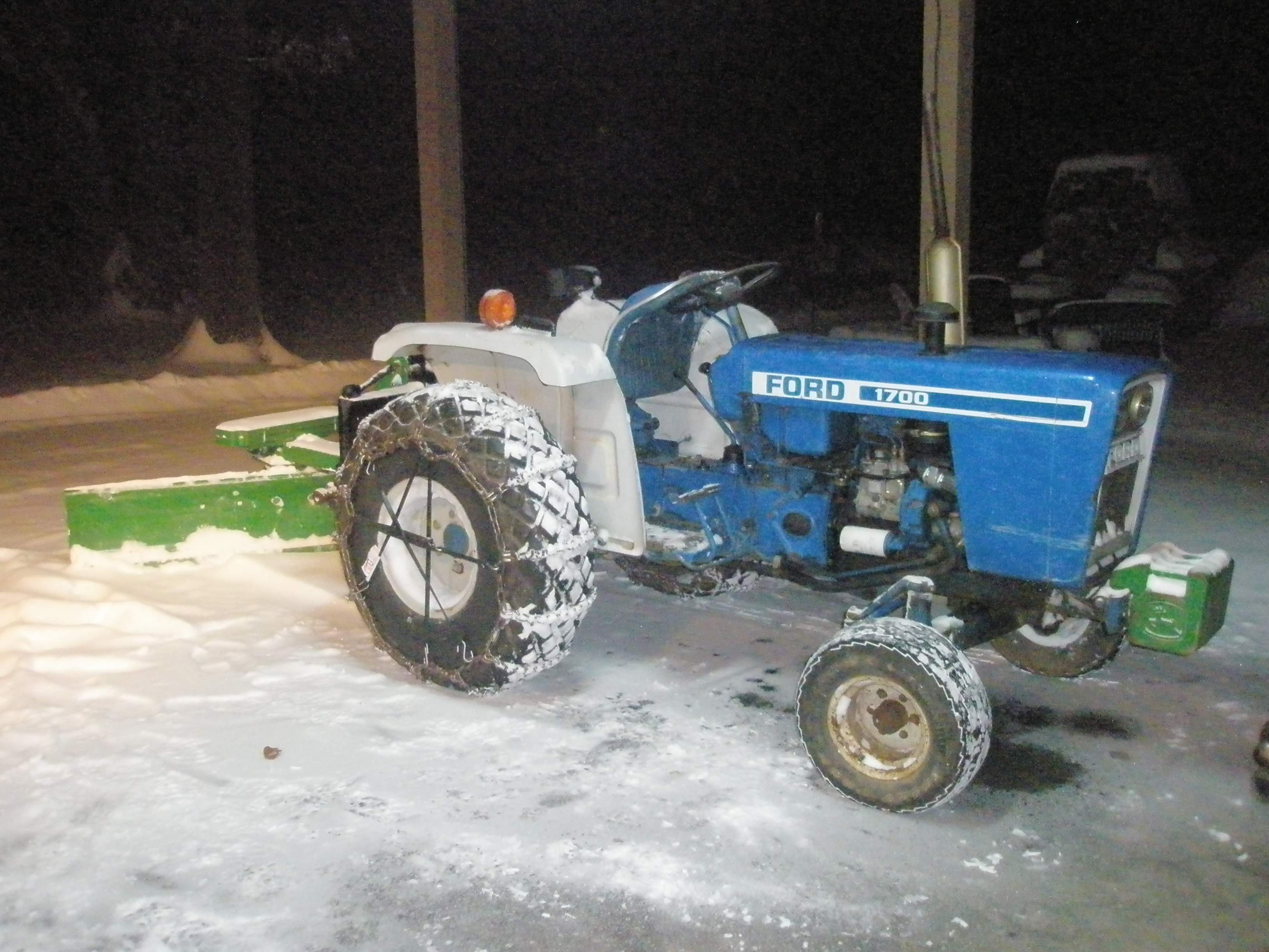

Update, After having some cold temps to test this heater out.
They told me 2 hours min on time, but it seems after 2 hours it doesn't get any warmer, after 2 hrs everything is warm the whole block and top of the radiator.
Even after just 1 hour the tractor fires right up, better than it did in the fall with much milder temps.
Seems to be just what this machine needed to be happy, I'm happy to:)

On mine I turn on the key after about fifteen minutes to see if the temp guage has moved -- it usually has -- and then it will fire up like it's summer time. Even an hour seems like a long time but may be it needs it -- try the temp guage thing
