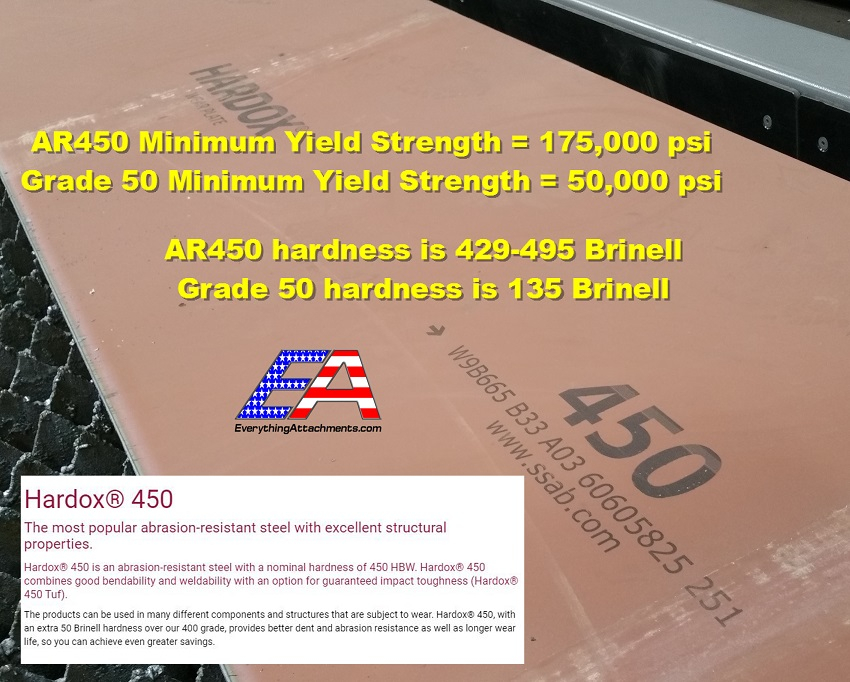

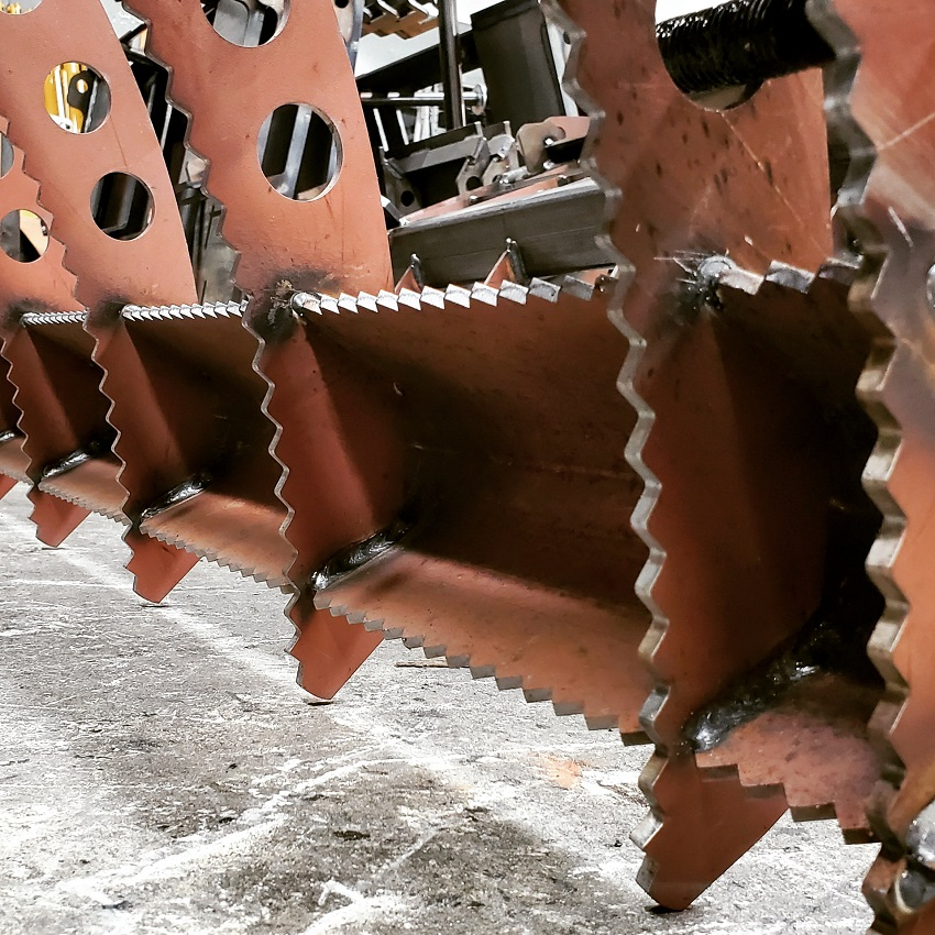

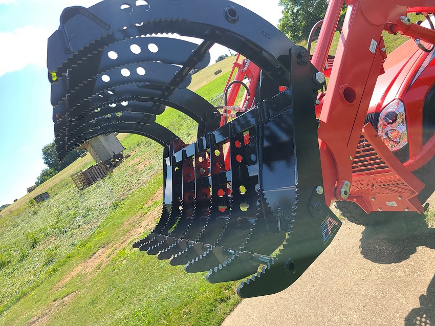

The flat steel on all of our rake style Wicked Grapples is Hardox AR450, and we also use it where needed on the longer bottom models.
Also, the Wicked 55 and Wicked 60 features this horizontal Hardox channel which greatly increases it's ability to smooth while back dragging, and obviously also increases the Wicked grip ability.
Travis
What's so special about Hardox?
For 60hp Kioti which size would you recommend? And the images on your site don't show the new Hardox channel but I am sure you plan to update that.
Easiest question I'll answer all day, man! 400 pound Wicked 60 is simply ideal for it.
Yes, it'll have the new horizontal Hardox channel. Nothin like er!!

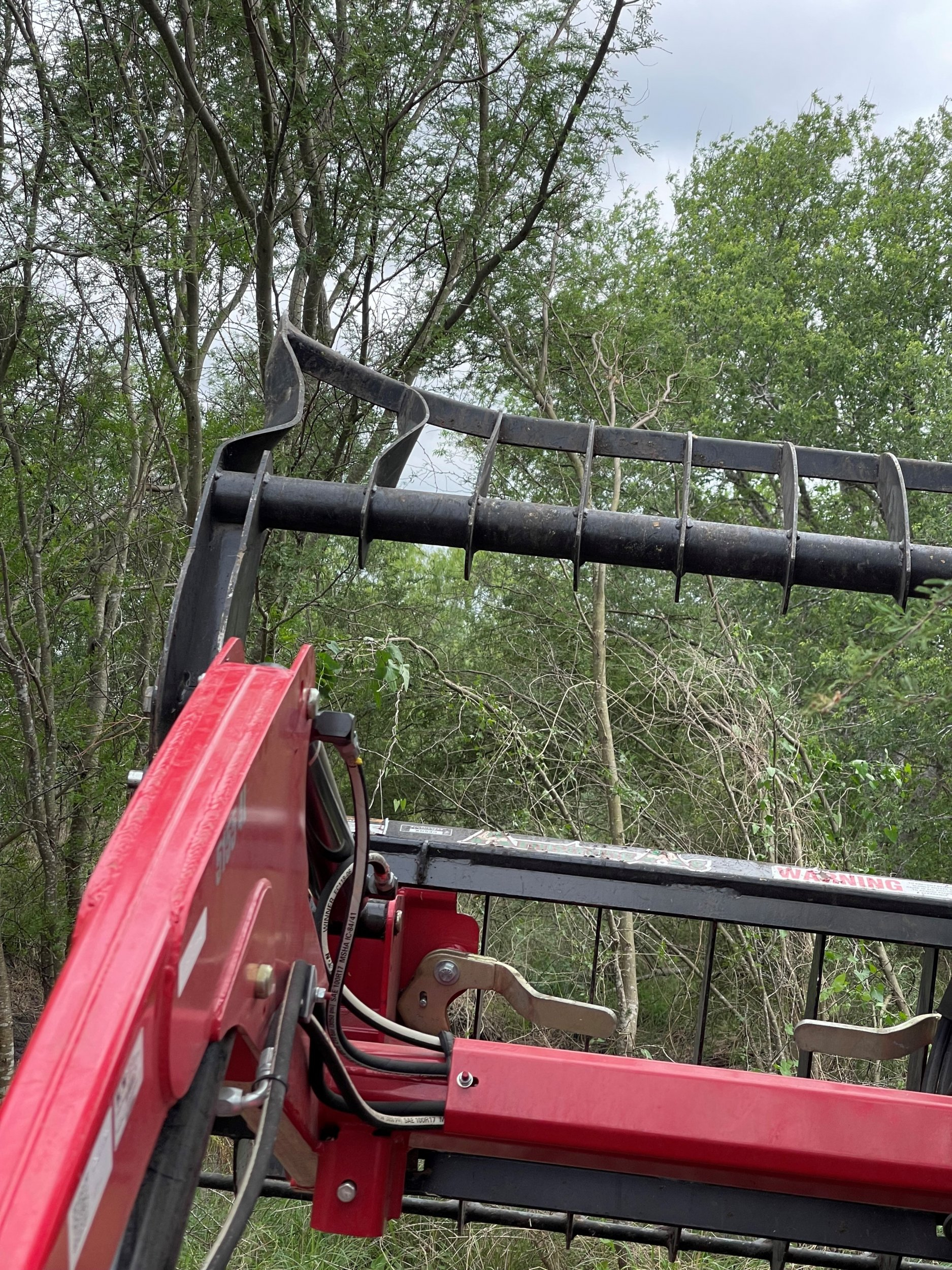

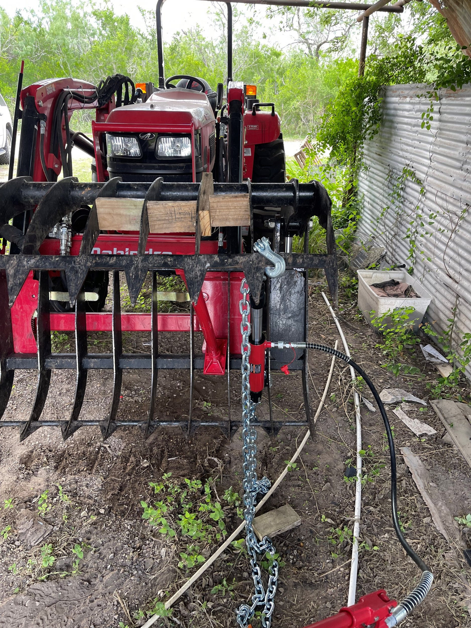

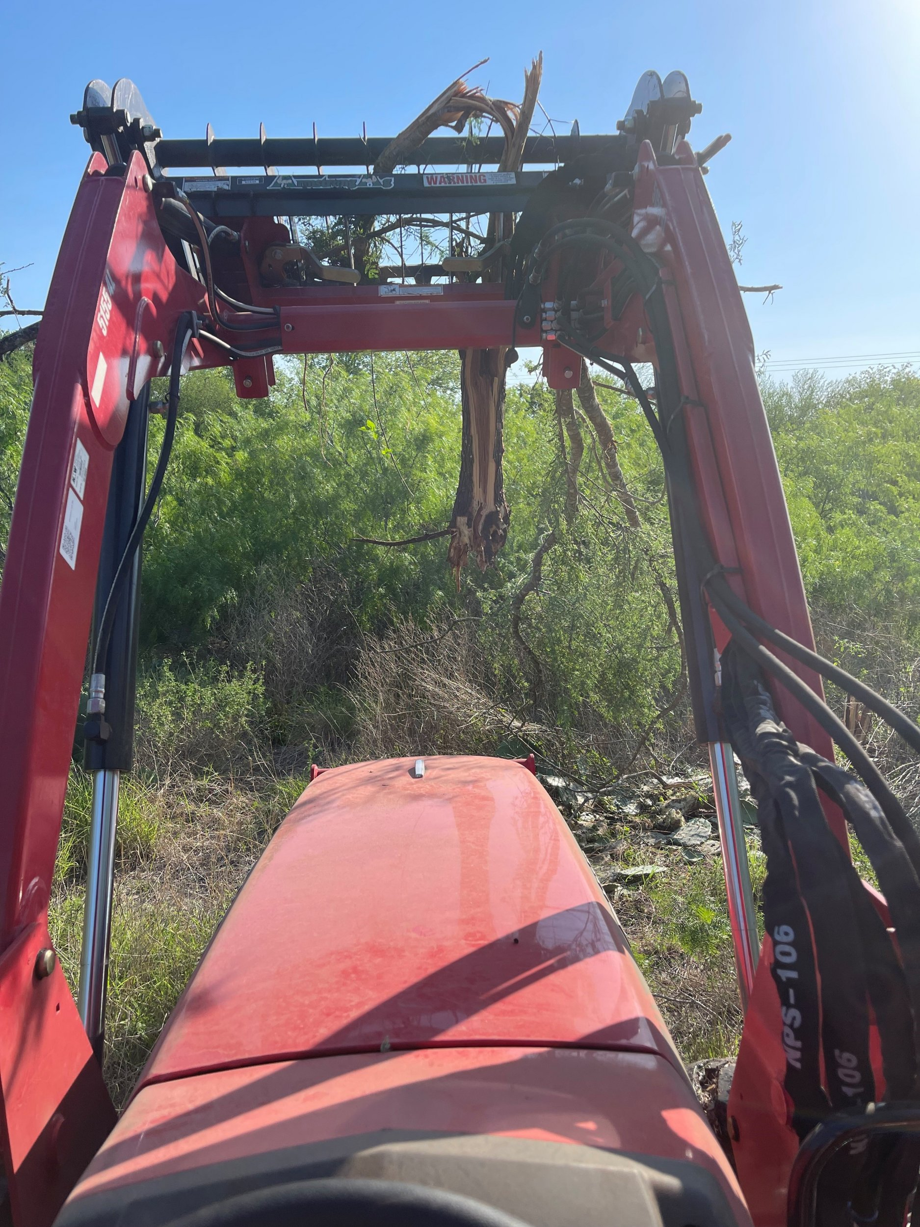

I have the armstrong agg BGR-mini on my 5145, the BRG-M is rated for up to 30hp tractor but im abusing mine on my 45hp 7000# tractor with 3100# of lift. all in all i'm very happy with the BRG-M. the few points that I feel should be addressed are 1. I'm not afraid of bending a sub $2k attachment (serves as a fuse) to keep me from tweaking my $8K loader. 2. you can bend the clamshell if you pull agginst the cover, i normally pull 4 - 6" huisache trees up with mine but if you do not watch the angle on larger stuff and pull against the side of the cover you can bend it see photo. 3. there should be a piece of plate welded in to block stuff from poking thru the back side of the grapple and disengaging 1 side of your SSQA, if you notice it np if you don't and pull on something you can bend the SSQA mounting plate and or your loader SSQA brackets. keep in mind i'm not careful at all and intend to use my equipment (not abuse it but i do not take it easy on my tractor) i broke a set of front axel spider gears at 22 hrs using the BRG-M. in the end i used a porta power from HF to repair the clamshell and a sleg hammer to repair the SSQA bracket (it did not hurt my loader SSQA bracket, as intended).
in the hill country on the juniper trees that do not have a tap root like huisache you should be fine on pulling anything up to 6" out root and all.
oops sorry just realized that i had already posted most of this.
