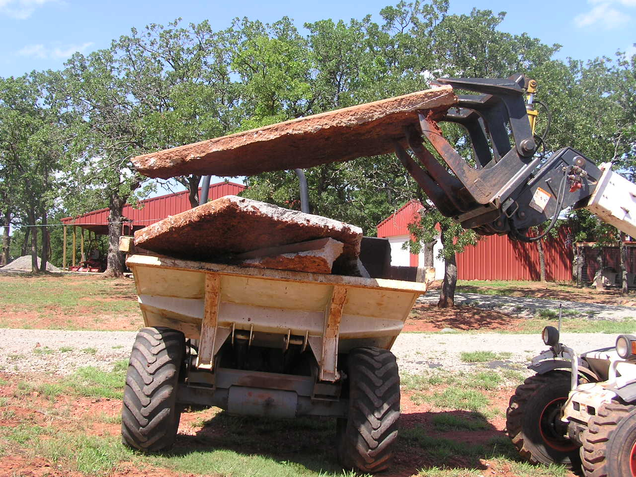

Unbalanced loads in a grapple try to free themselves by pushing against the rod in the cylinder on the grapple lid which can spike pressures in the hydraulic system. Every hard bump makes it worse.
I wonder what the pressure spiked to on my Gorilla Grapple with this concrete slab: Compact telehandler
   / Which grapple? Landpride vs EA vs MTL for Kubota L3560LE #45
I don't know how to do the calculation, but I suppose there's a way to figure the leverage against the lid based on the depthxwidthxlength of that chunk of concrete. Probably worse when you were prying it loose from the ground.
