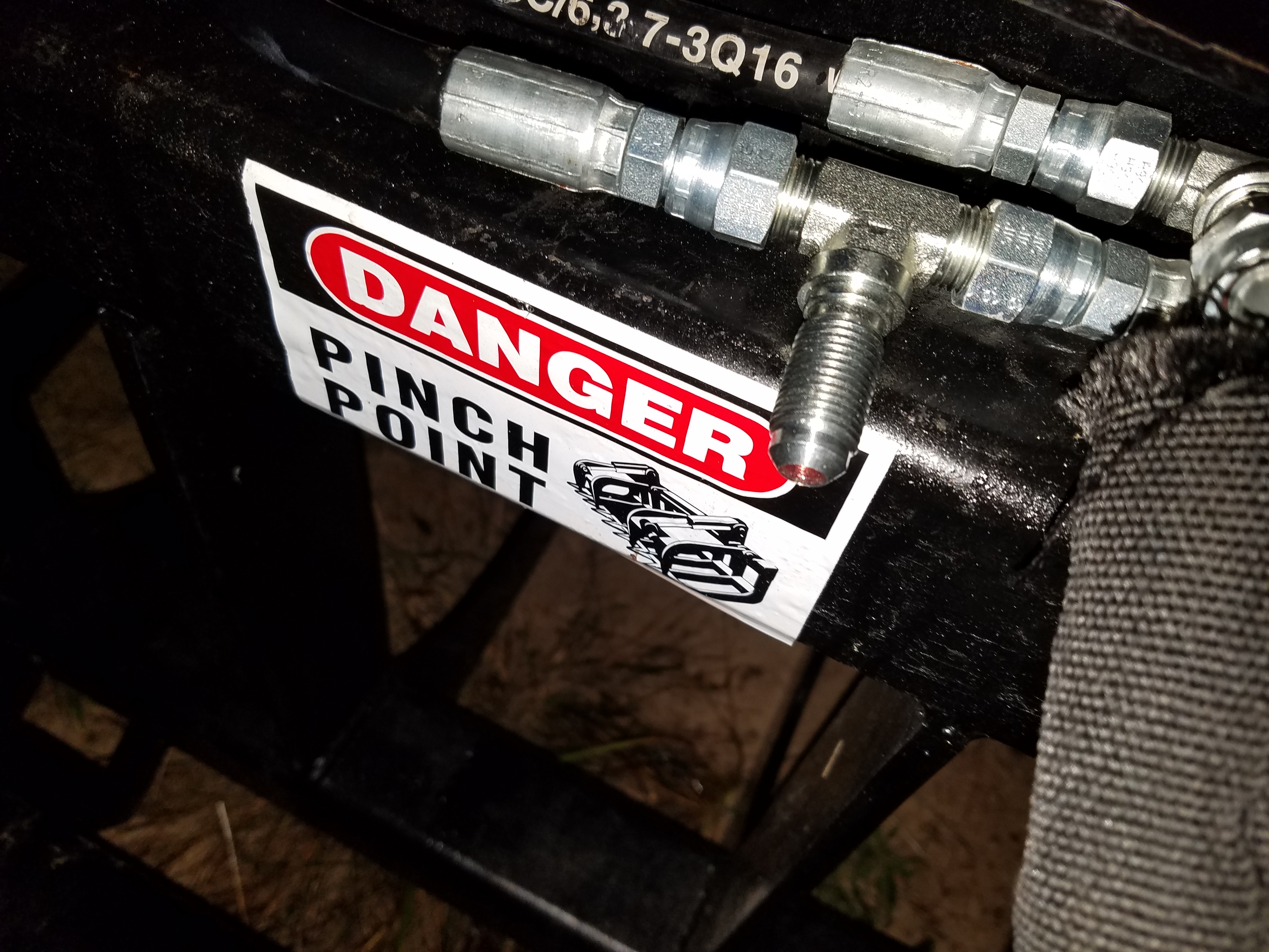

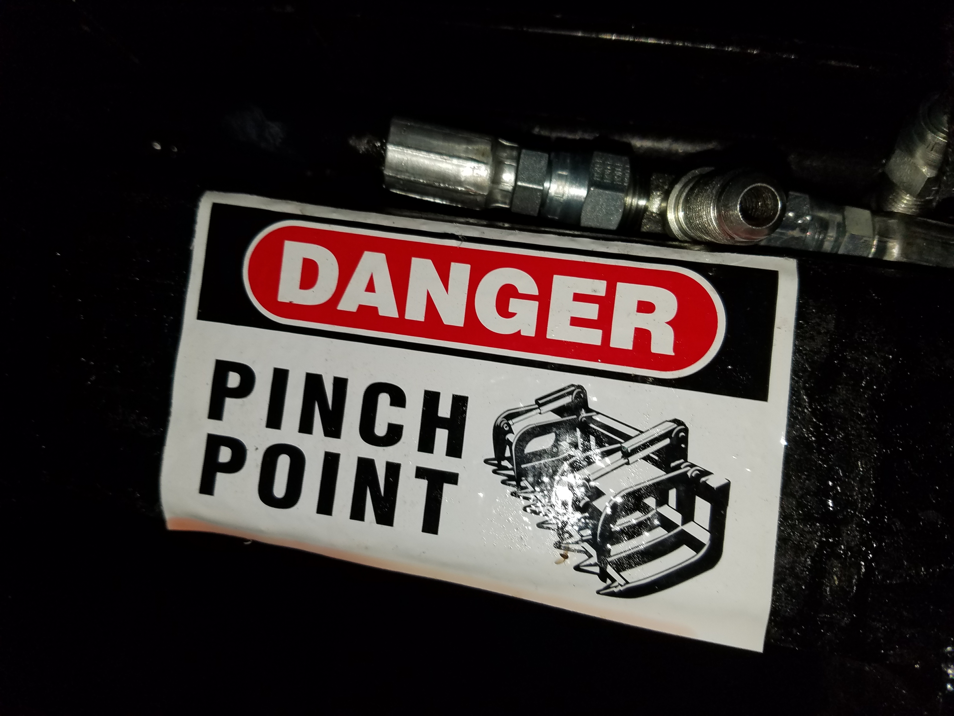

I don't think it was an issue w/ pressue or anything. It was still very hard to get in/almost impossible even when I took the coupler off the the tractor and tried putting it on the grapple coupler. I think it was just a defective coupler. Tonight I did replace the coupler/line going into the grapple and it does plug into the tractor fine now. However I can't seem to find what kind of 1/4" fitting goes into the below T. Anyone able to point me in the right direction? What I thought would work and found locally isn't quite deep enough to get the threading started. The hose they where using is a Parker 471TC-4 WP and the fitting that came on the hose works with that T but I just can't seem to find it locally. Once I find that fitting I'll be back in business....I hope.
   / Which is more common: 1/2" or 3/8" couplers? #39
That is a JIC fitting, probably -04 (1/4") or -06 (3/8")
   / Which is more common: 1/2" or 3/8" couplers? #40
Yep, JIC for sure. Cant read any of the numbers on the fittings that ID their size. If they are the approximate size of a 1/4" pipe nipple....that would make it a 3/8 JIC fitting.
If you have some calipers, measure the OD of the threads and you will know for sure. Several charts online that list thread sizes of JIC. Here is one such chart https://www.surpluscenter.com/images/techhelp/JIC.pdf
Another option, though there can be some variations especially on older stuff.......what wrench size did you use on the hose to remove it?
9/16" wrench would make it a -04 JIC and an 11/16" wrench would make it a -06 JIC fitting
