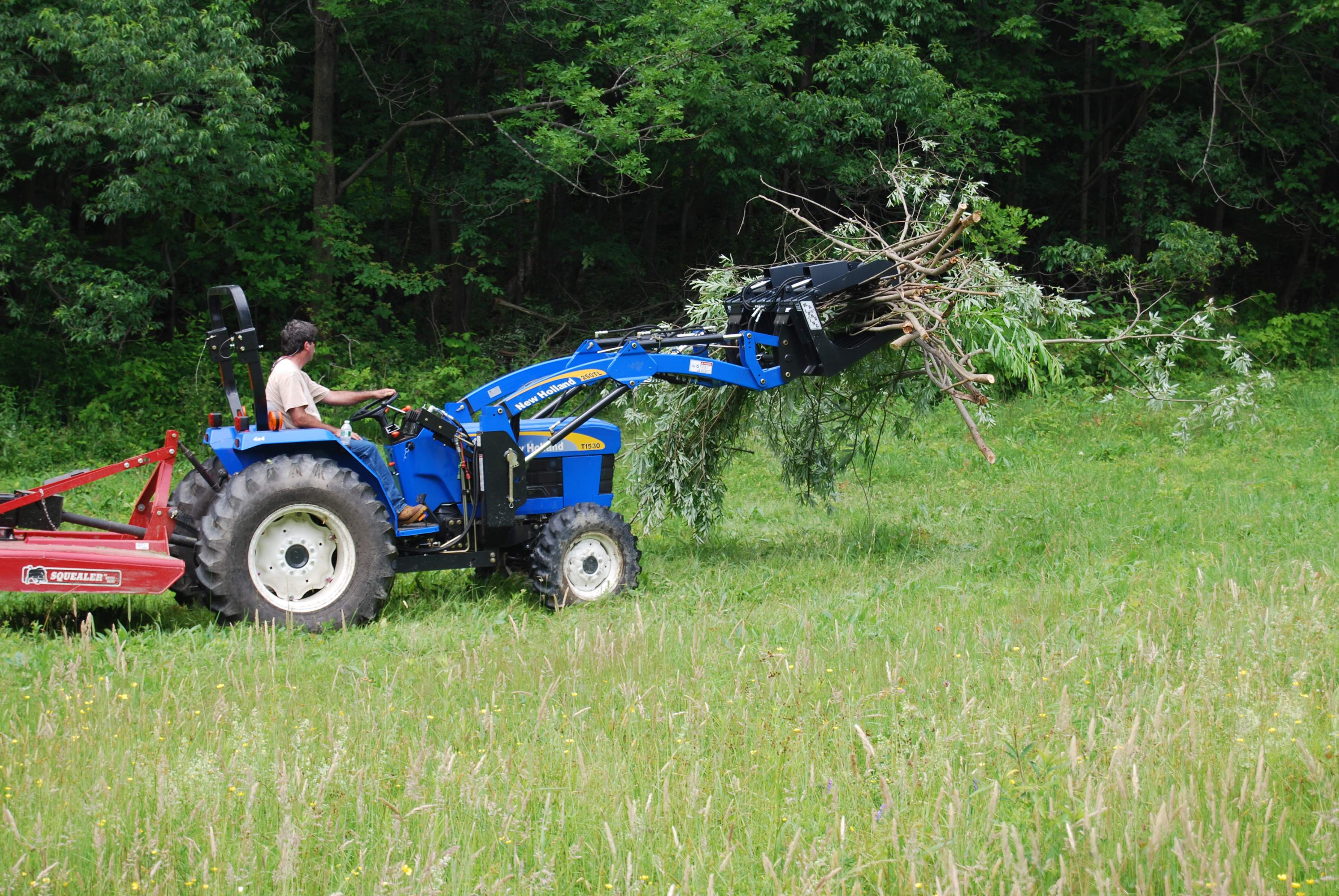

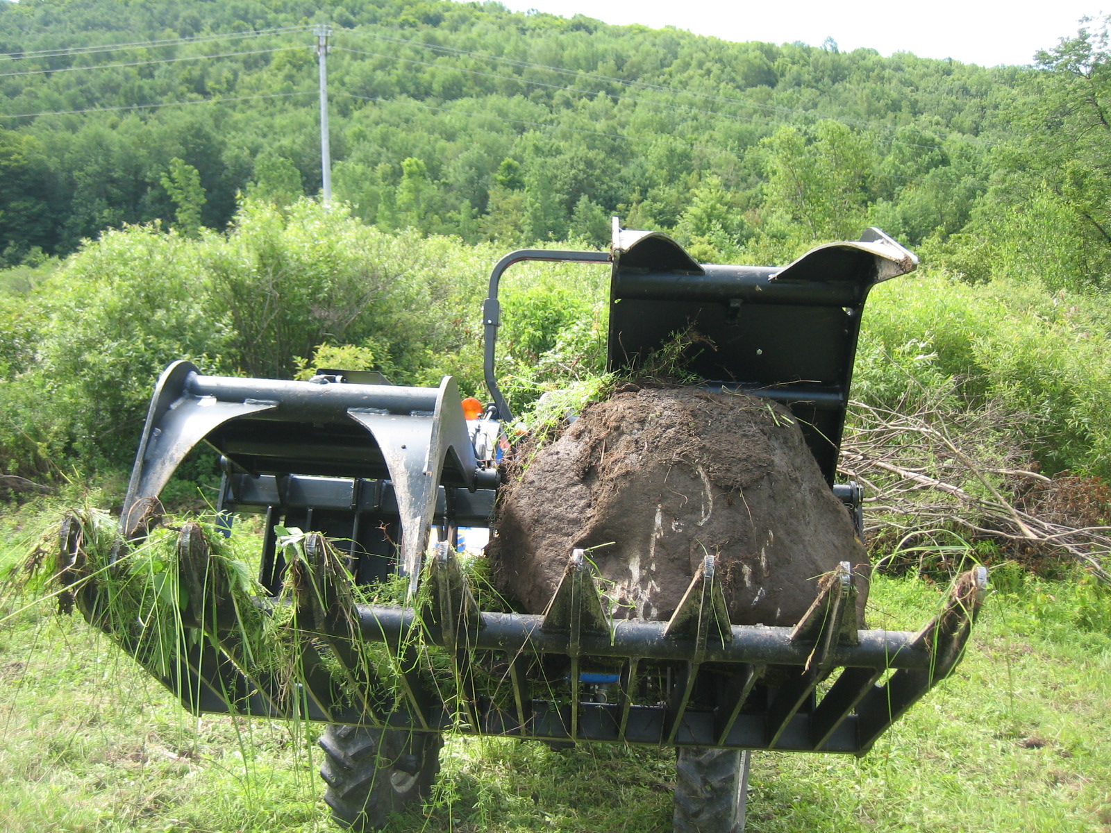

That is a nice looking setup. I have the same model grapple and absolutely love it. Mine is the 64" model. Do you happen to know what size steel they put in between the main tines? I want to add that to mine, I didn't have it done when I bought it but wish I did.
It looks to be the same size as the primary pieces. And they are welded perfectly because I tapped them and they all ring out loud. Hey if you can play a steel drum maybe I should record a grapple music video ... :laughing:

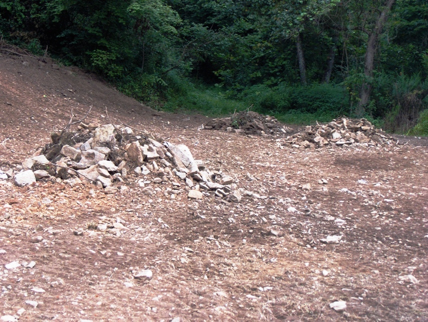

Well I picked up another landscape rake today. There is a used farm equipment dealer that had a new old stock Hawkline 7" rake that is built heavier than the Countyline TSC unit that bent when I used it. I am gun shy about bending this one so I am going to beef it up a little before using it.
Hawkline Rake
   / Which Landscape Rake for rocks and why?
#31

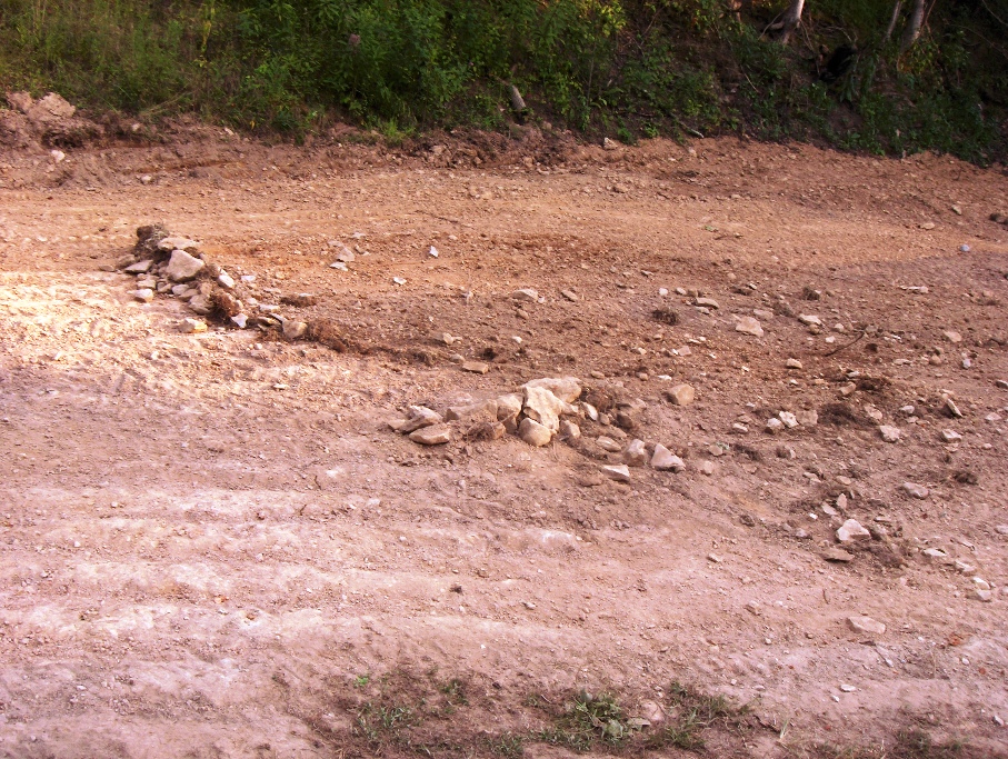

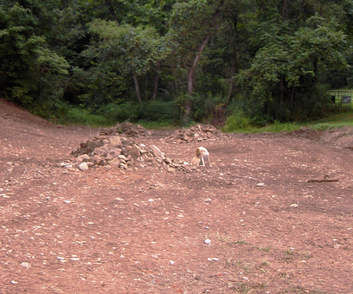

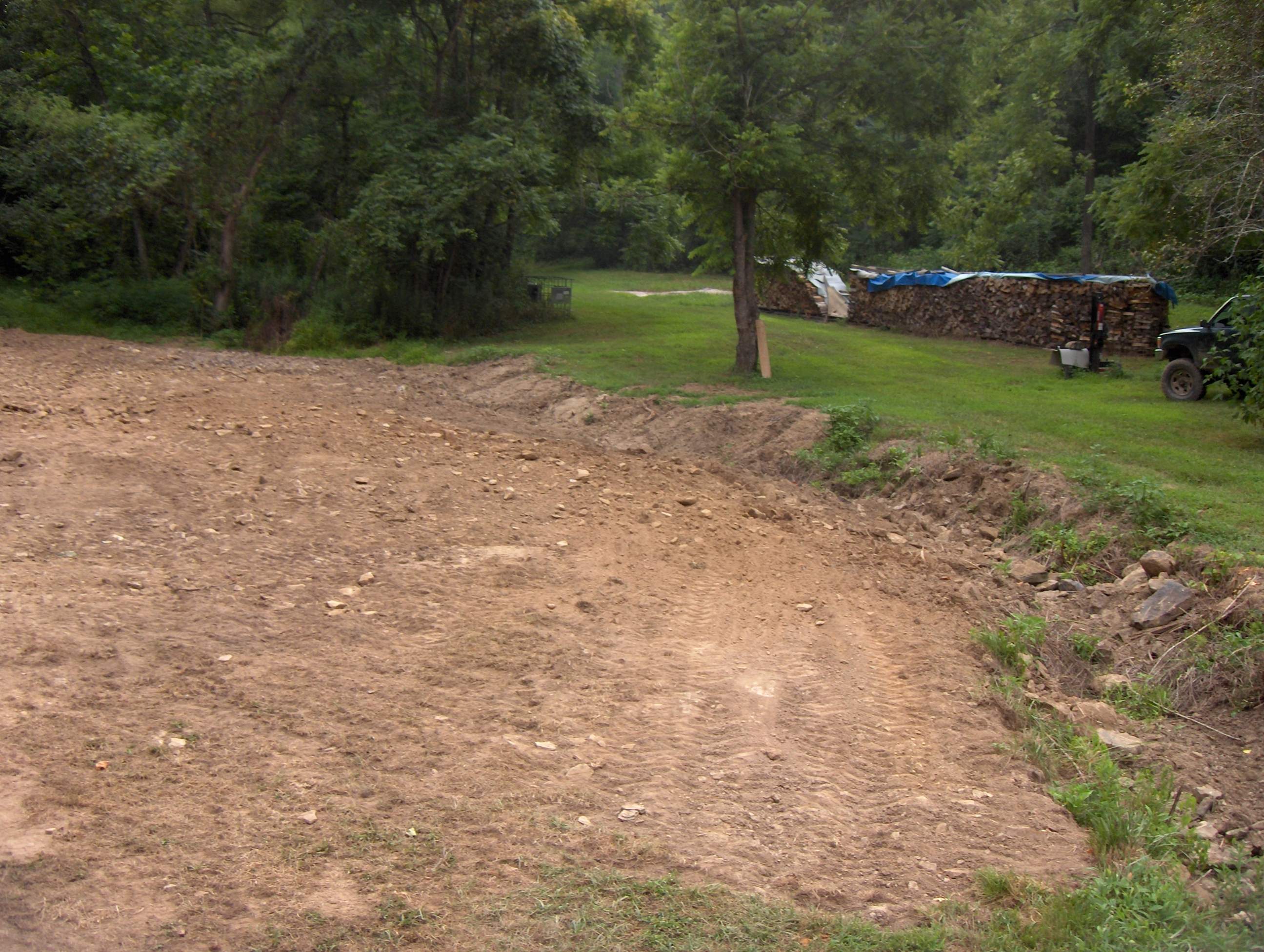

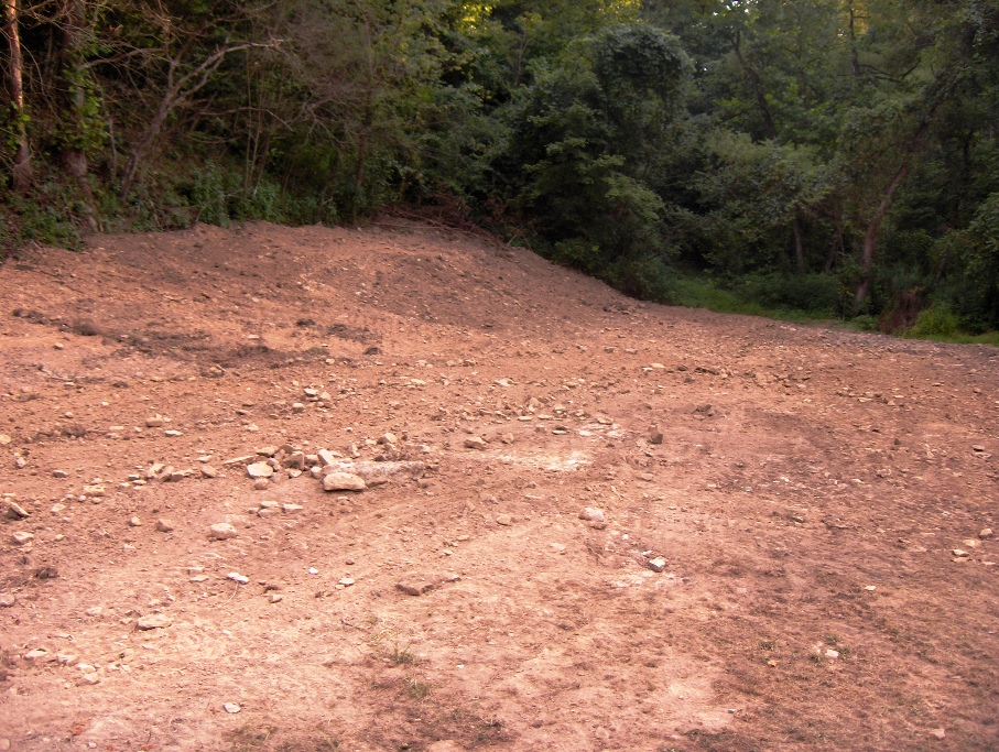

Here are a few pics of the 3x4 box tubing that I used to reinforce the Hawkline Landscape rake. I tried it out and used it the same way I used the weak TSC rake that I took back. I win rowed the smaller rocks and it worked really well. best of all it didn't bend or warp. I may make up a set of wheels if I see the need. I will make up a stand for it as well.

That was a smart idea adding the box steel to the frame. Nice welds too. I think I'll start looking for a rake, these rocks are just too much on/off tractor, bending, lifting, throwing in bucket....it never ends :mad: Thanks for the photos.

that area doesn't look that big but I have removed 50 6' bucket loads of rocks from that area. I just could not hand pick that area in less than a few weeks and that is not how I wanted to spend my time. :D
   / Which Landscape Rake for rocks and why? #35
Sometimes you have to give up a little soil in the name of efficientcy, as you mentioned you could spend an inordinate amount of time sifting and picking throught the debris. Have to consider what your time is worth, so I agree.

Yes you are right though I was surprised how well wind rowing the rocks separated the soil out. You do end up loosing soil.
