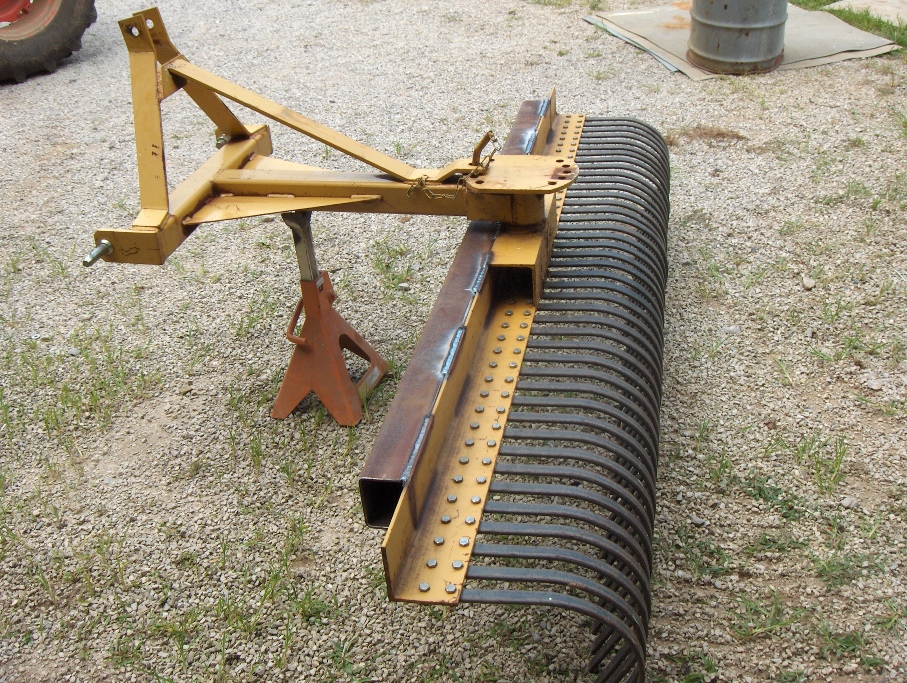

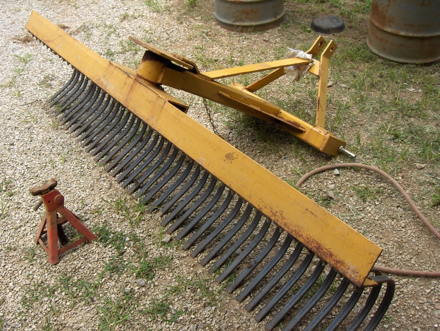

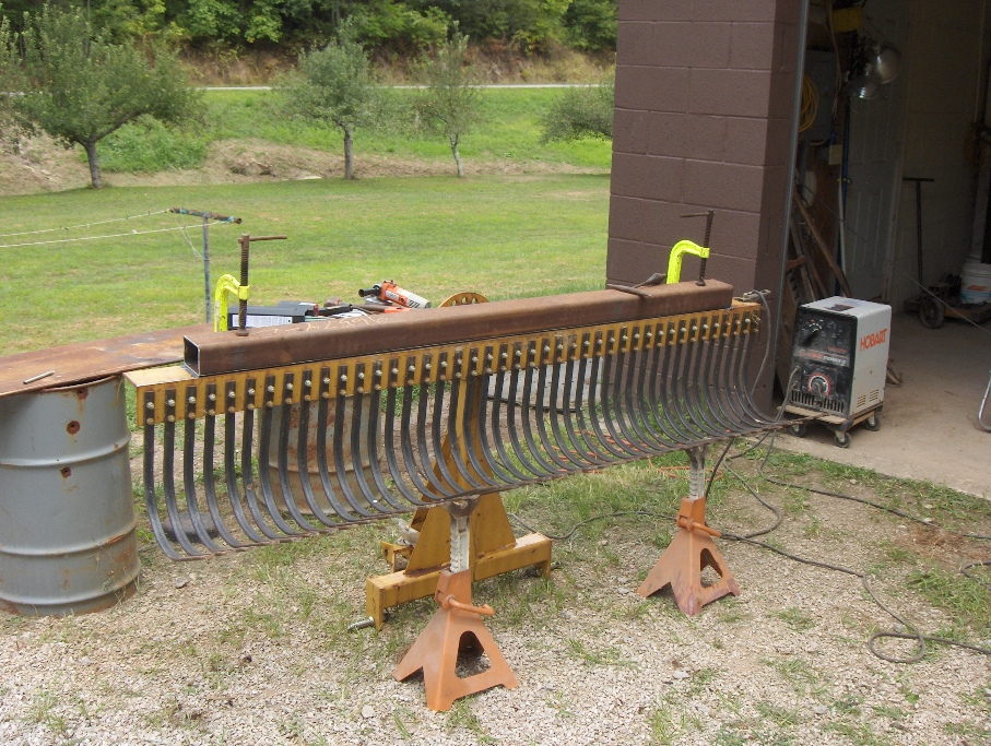

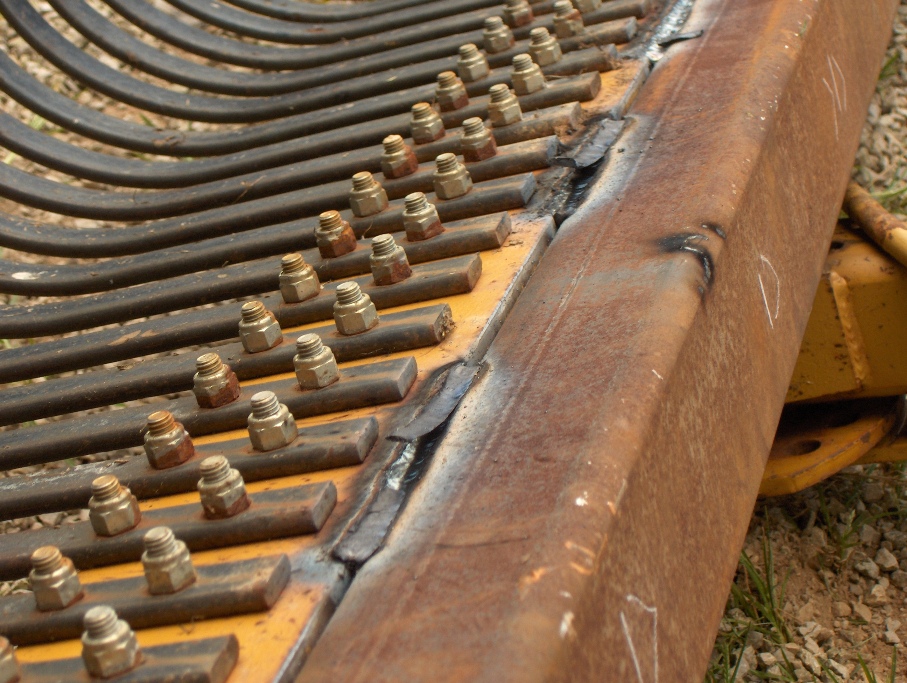

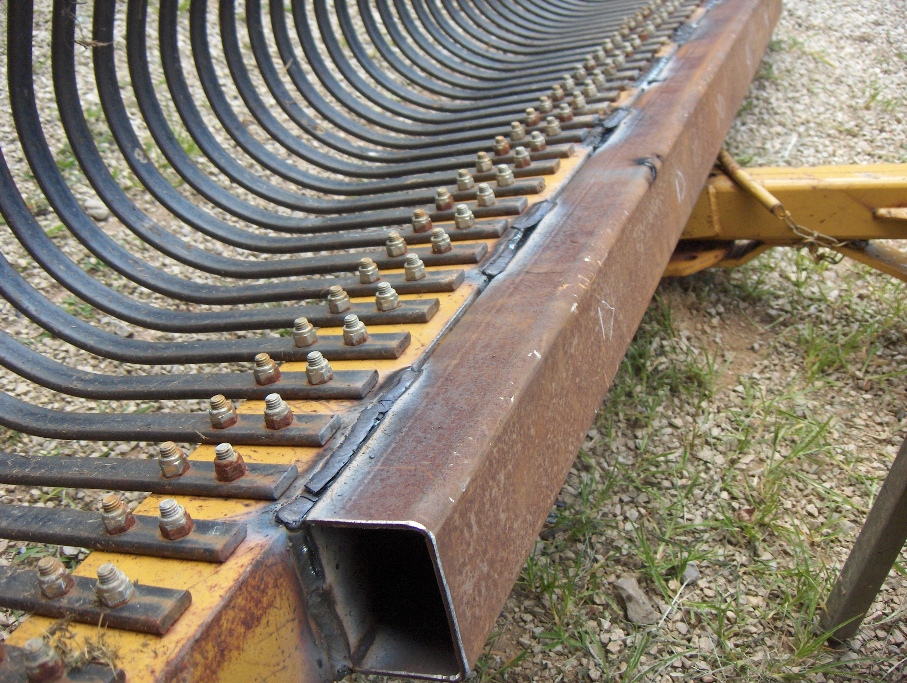

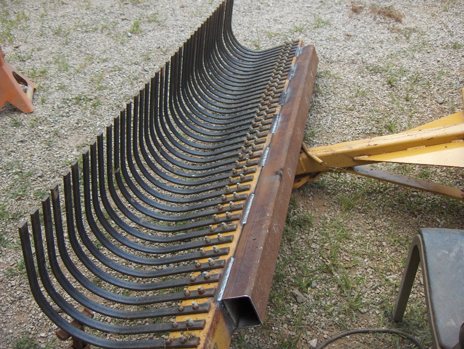

Here are a few pics of the 3x4 box tubing that I used to reinforce the Hawkline Landscape rake. I tried it out and used it the same way I used the weak TSC rake that I took back. I win rowed the smaller rocks and it worked really well. best of all it didn't bend or warp. I may make up a set of wheels if I see the need. I will make up a stand for it as well.

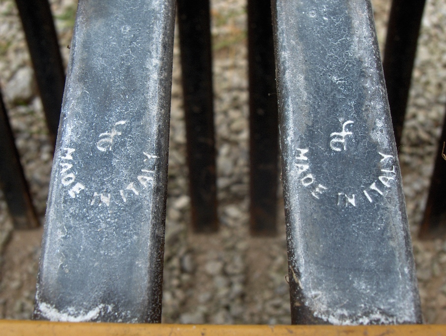

I just love it when a weld does this. I used 1/8 6013 rods on something like this and they put down such a nice looking weld. I will use it a bit and then paint it. The last pics shows that the tines are made in Italy supposedly where the better tines are made. I guess we shall see.

That was a smart idea adding the box steel to the frame. Nice welds too. I think I'll start looking for a rake, these rocks are just too much on/off tractor, bending, lifting, throwing in bucket....it never ends :mad: Thanks for the photos.
