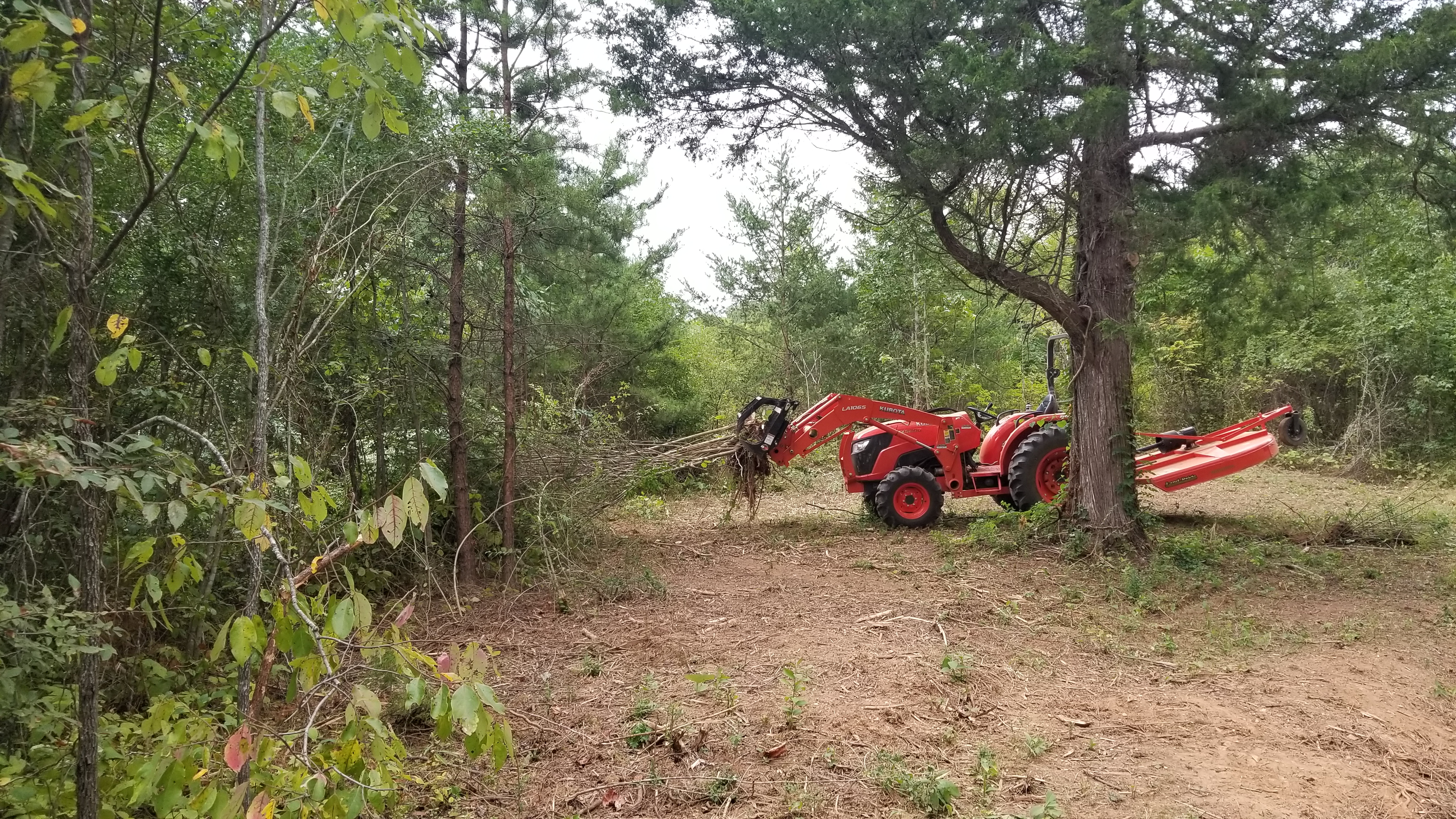

Your Land Pride certainly does look like a very nice grapple.
The problem for me though would be the tooth design.
I need the longest teeth possible, and spaced much wider than those appear to be.
I need to reach into trees/bushes to hook/snag the bittersweet vines, yet keep the actual damage to the trees/bushes to a minimum.
I am thinking longest possible teeth, with tooth spacing at 11" or slightly more.
Any more closely spaced teeth will likely pull/break off branches of the trees/bushes themselves.
It would be nearly impossible for me to grab the bittersweet at ground level, but I can grab it much higher on the tree/bush, where it is actually weaving it's choking vines up through the tree/bush.
If I can snag the vines, curl up or down, and pull up, some will break off, but when the ground is moist, most vines will cleanly rip out.
Getting rid of bittersweet (like kudzu) is a reoccurring problem.
It will eventually grow back, and need to be ripped out again.

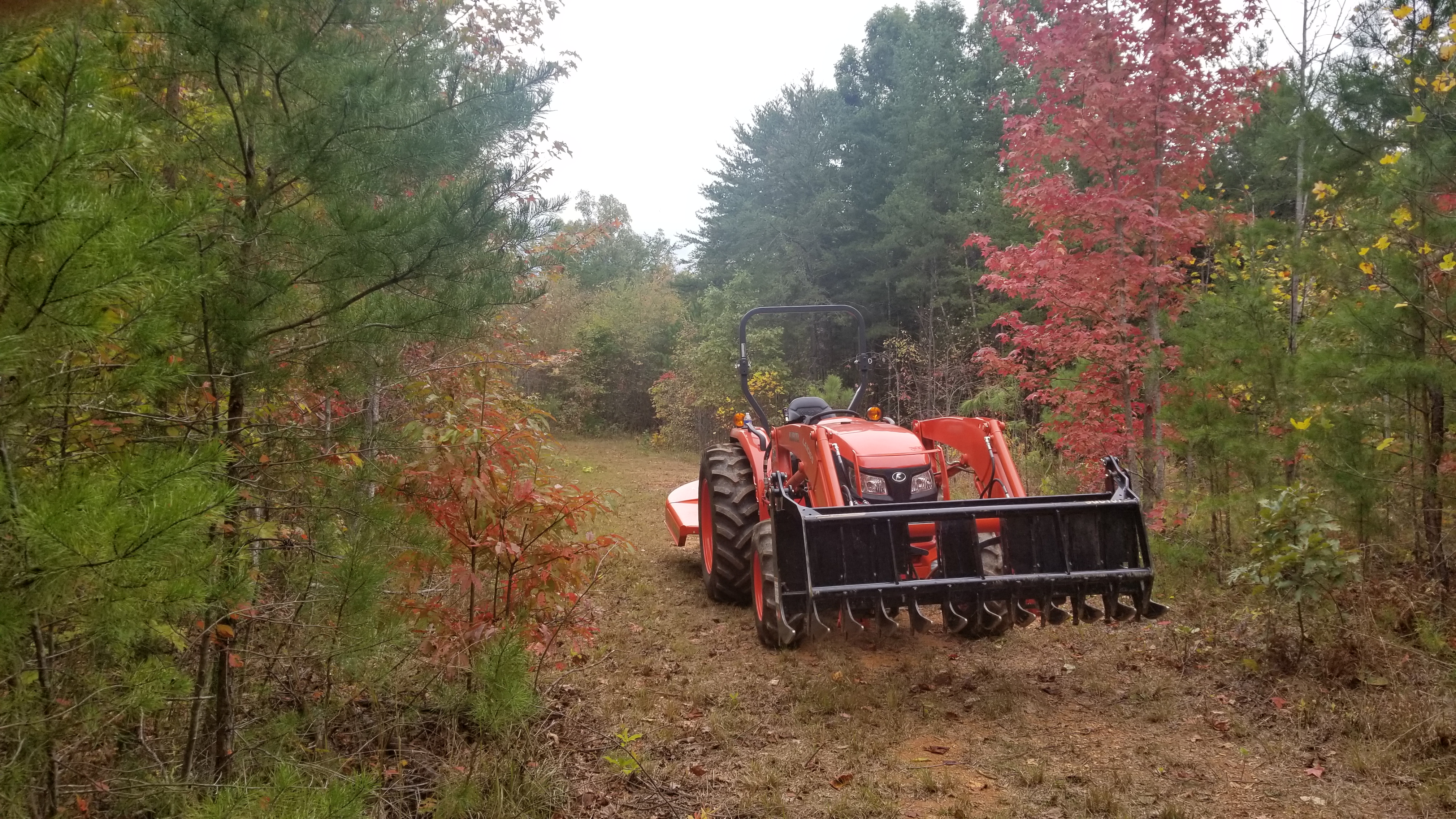

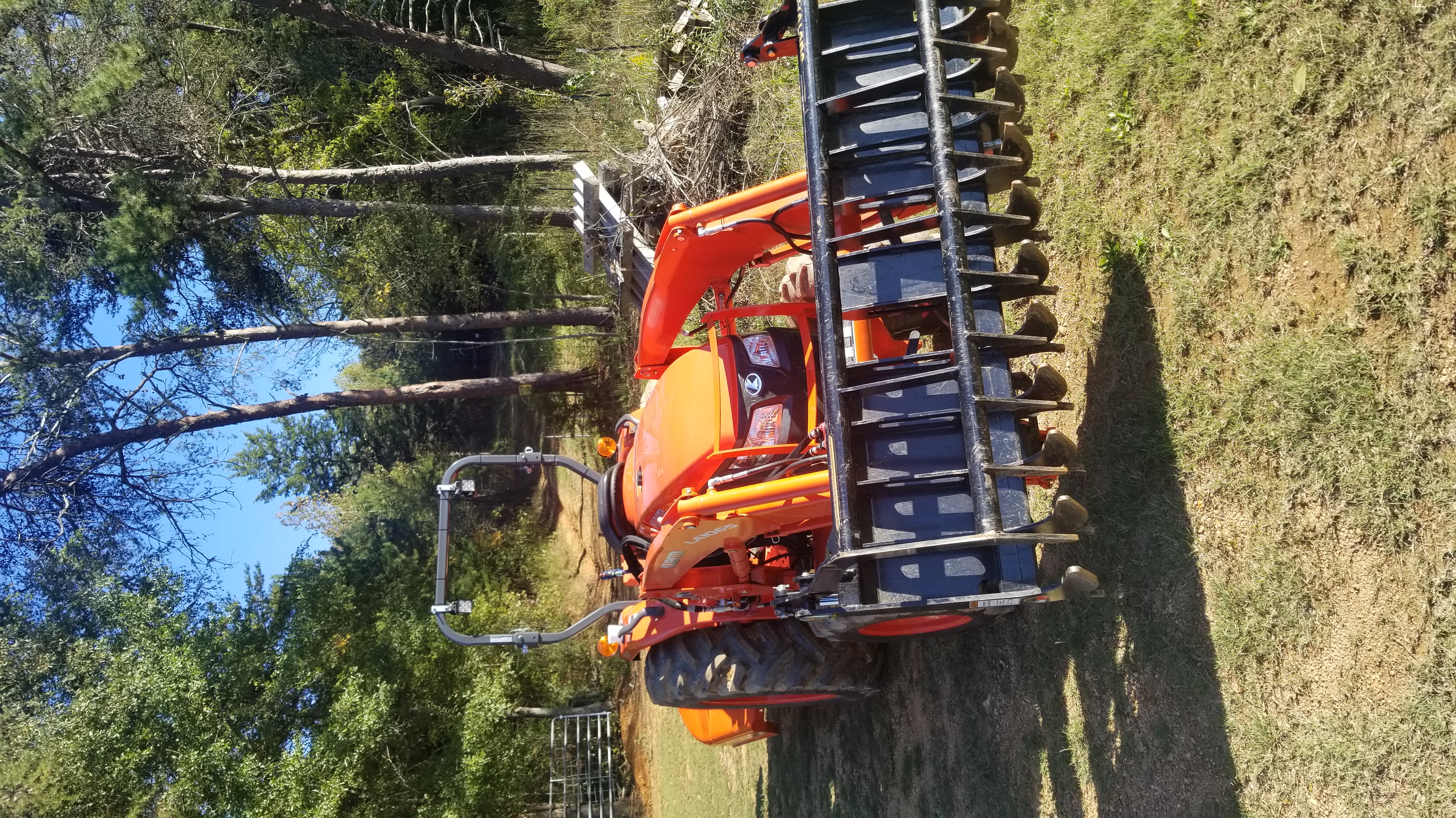

/ WHICH ROOT RAKE/GRAPPLE ? #47

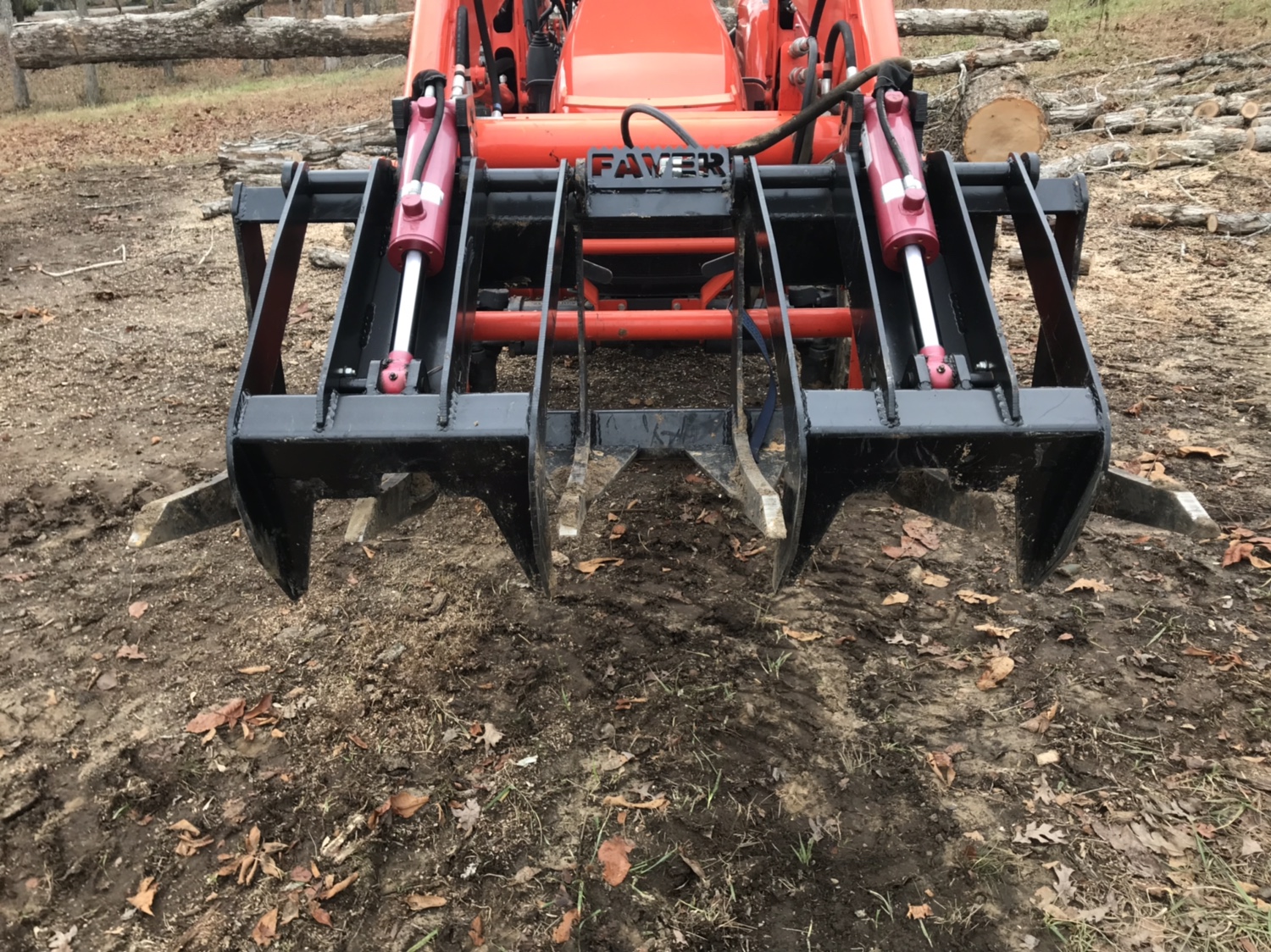

I don’t think my Favor is going to let go of much that a single lid would have caught. It covers the teeth pretty good and the lids overlap. IMG_7872.JPGIMG_7873.JPG

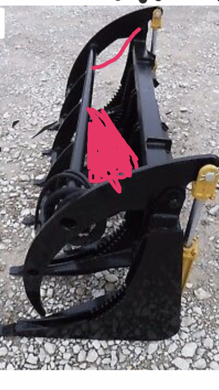

I have never mastered the TBN picture thing, but if interested, here is what I am thinking might work for me.
E-Bay # 193184262157
The pivot wear points do not have zerks, and with A36 steel, that is an issue that must be resolved.

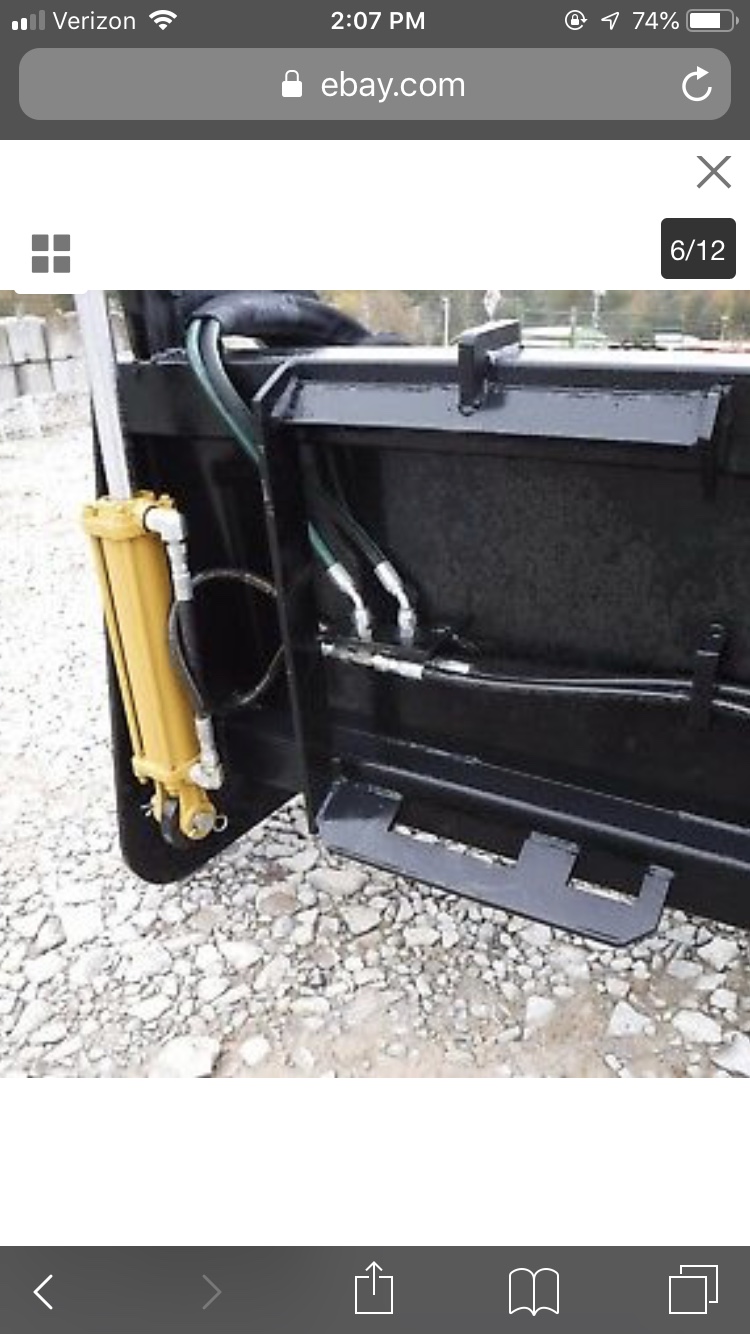

So I looked up your eBay grapple and the 2 problems biggest problems I see way ahead of pivot points is the hose routing sucks and there’s nothing to keep the lid from racking sideways. My Titian suffered from the same failure. I bent both lids and tore one cylinder mount off. That piece of crap is the reason I tripled my budget the next go around. If the first thing you did was weld a brace like this it would be better off. IMG_7877.JPGIMG_7874.JPG
#55
So I looked up your eBay grapple and the 2 problems biggest problems I see way ahead of pivot points is the hose routing sucks and there’s nothing to keep the lid from racking sideways. My Titian suffered from the same failure. I bent both lids and tore one cylinder mount off. That piece of crap is the reason I tripled my budget the next go around. If the first thing you did was weld a brace like this it would be better off. View attachment 630731View attachment 630733
Good info!
Thank you.
Those angle braces make complete sense.
If I buy that thing I will definitely do the angle braces before using.
I hadn't noticed the hose routing, but that does look to be an issue also.
For fun, I just might take a trip up to Denton, NC. to see how it is made, and if they will build to my requirements.
