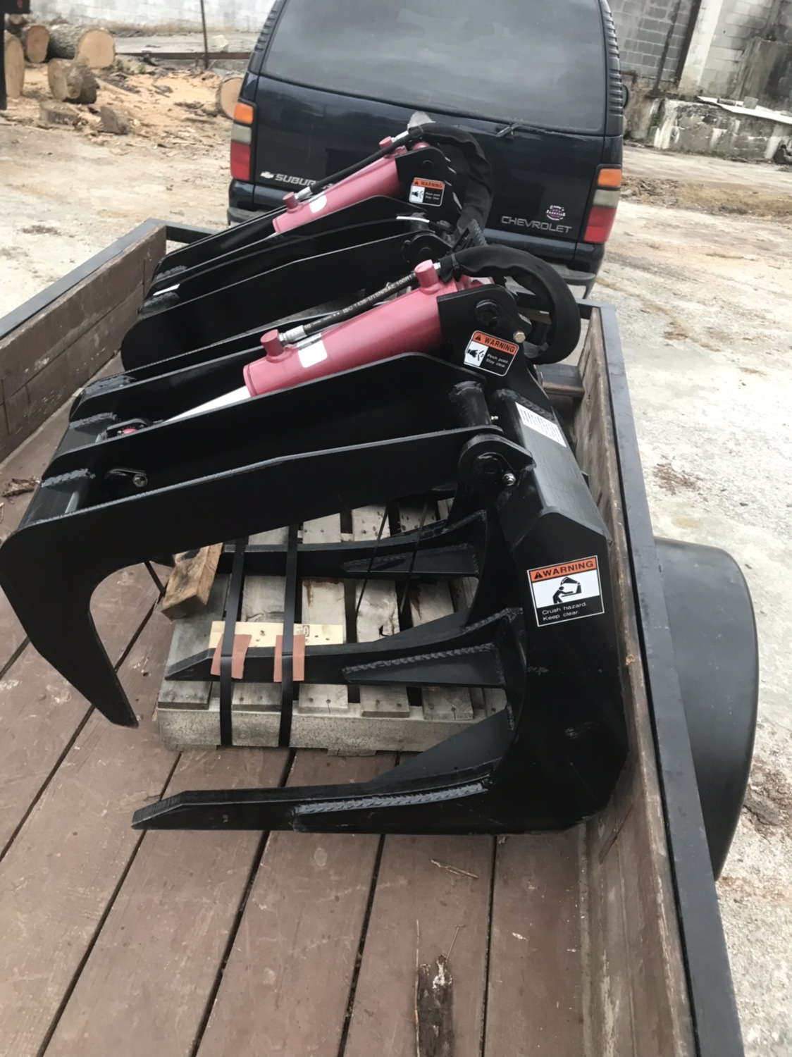

This is my Land Pride SGC1560 grapple with WRLong third function. It's probably more than you want/need. It shows one style of root/rock grapple. View attachment 630798View attachment 630799
It is extremely HD (820#) and didn't come cheap - $3175. Five years of extensive use and no problems so far.

That is truly a magnificent looking piece of equipment, but serious overkill for my needs.
I have zero rocks.
My 48HP Kubota backhoe will eat any roots, and stumps.

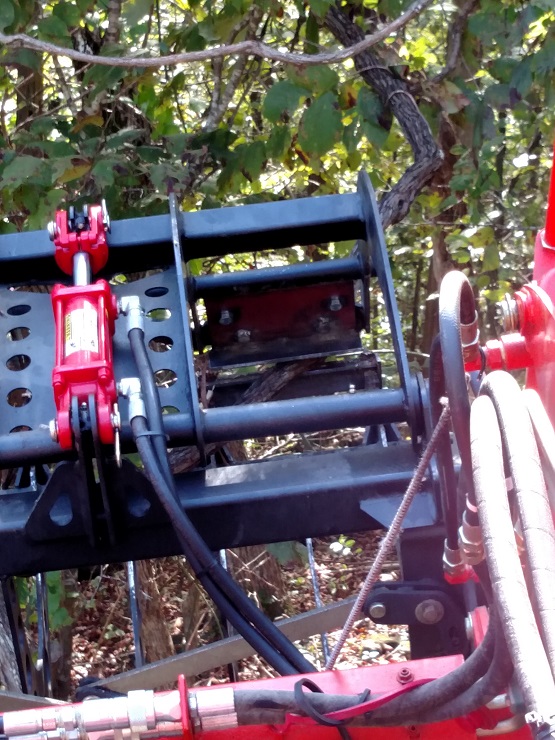

Before ordering I will ask MS about ordering that exact design direct from them.
Perhaps I could also pay MS to use bronze bushings, or pivot bolts with zerks.
I have also thought that I might just tack weld each pivot bolt, and put a zerk in each cylinder end fitting.
I have never seen a bronze bushing used on any tractor loader or equipment pivot. All I have seen is steel on steel with grease fittings.
It would be much less trouble and expense to just replace or modify the pins to be greasable.

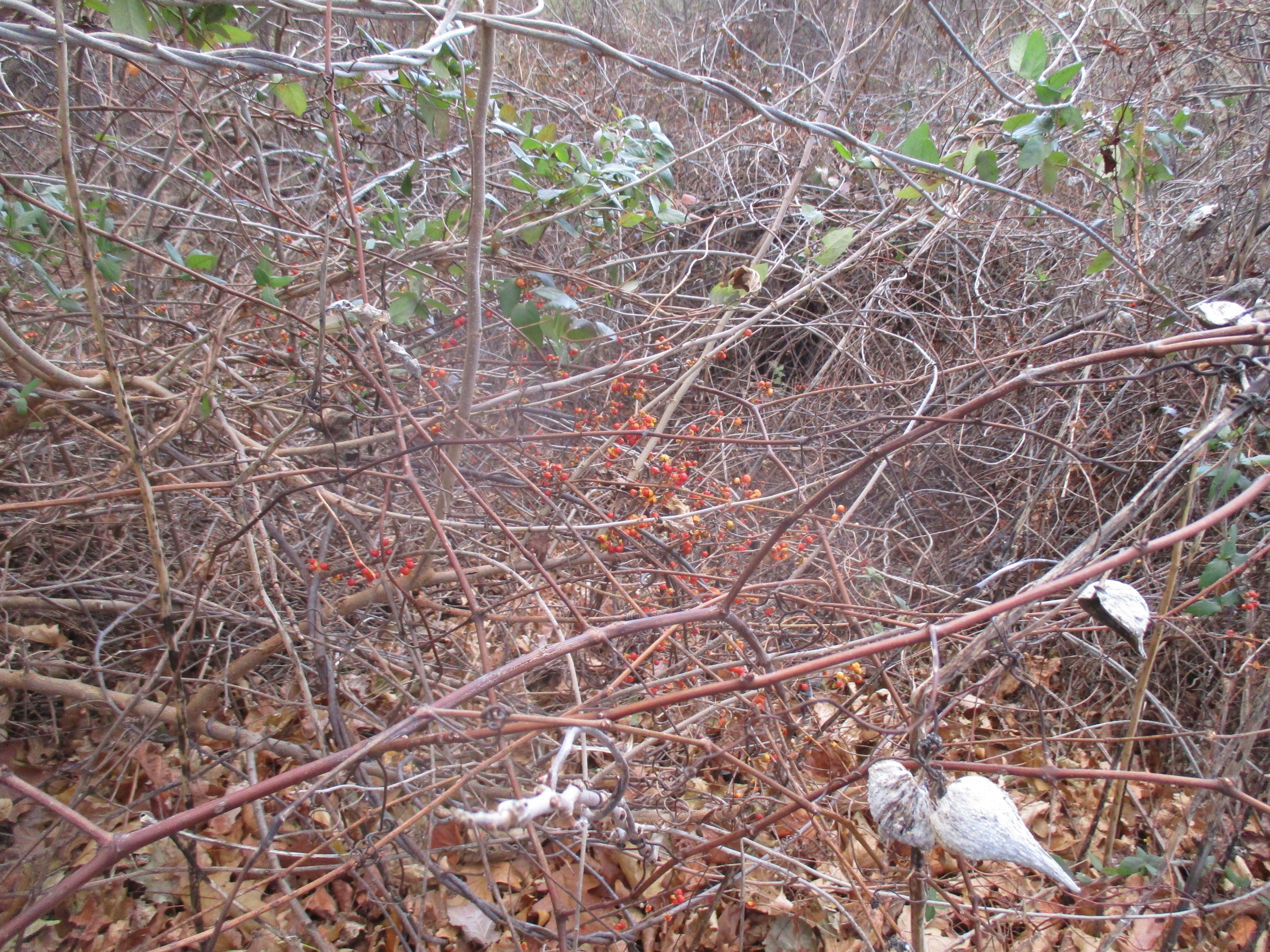

I think in my case it really comes down to tooth design, and length of teeth.
It is about what I believe will best snag a bunch of nasty tangled vines winding deeply within branches and thick foliage, but will do minimal damage to the branches and foliage.
ANY grapple design with cross members welded between bottom teeth, will simply destroy the branches.
I do note that your Faver does NOT have those bottom teeth cross members.
I think bronze bushings could work, but as you suggest, I think I would/will/may be able to modify the pins to accept grease.

What about a landscape rake for the 3 ph? Back in, push in the Holly bushes, drop the rake on the vines, pull out. By far your cheapest option.
LR16 Series Landscape Rakes* | Land Pride
That might seem like a good idea, but it really is not.
The best way to snag the multiple bittersweet vines is about 6'-8' above the ground where they are usually in a twisted mass, almost like a giant bird nest at times.
At ground level they are many individual small vines, that grow mostly vertical for several feet.
The vines would slip between the landscape rake tines at ground level.
Something like a landscape rake on the end of my 11' backhoe could work great, but that something would need to be custom made.
A grapple with the right teeth seems like the next best idea to me.

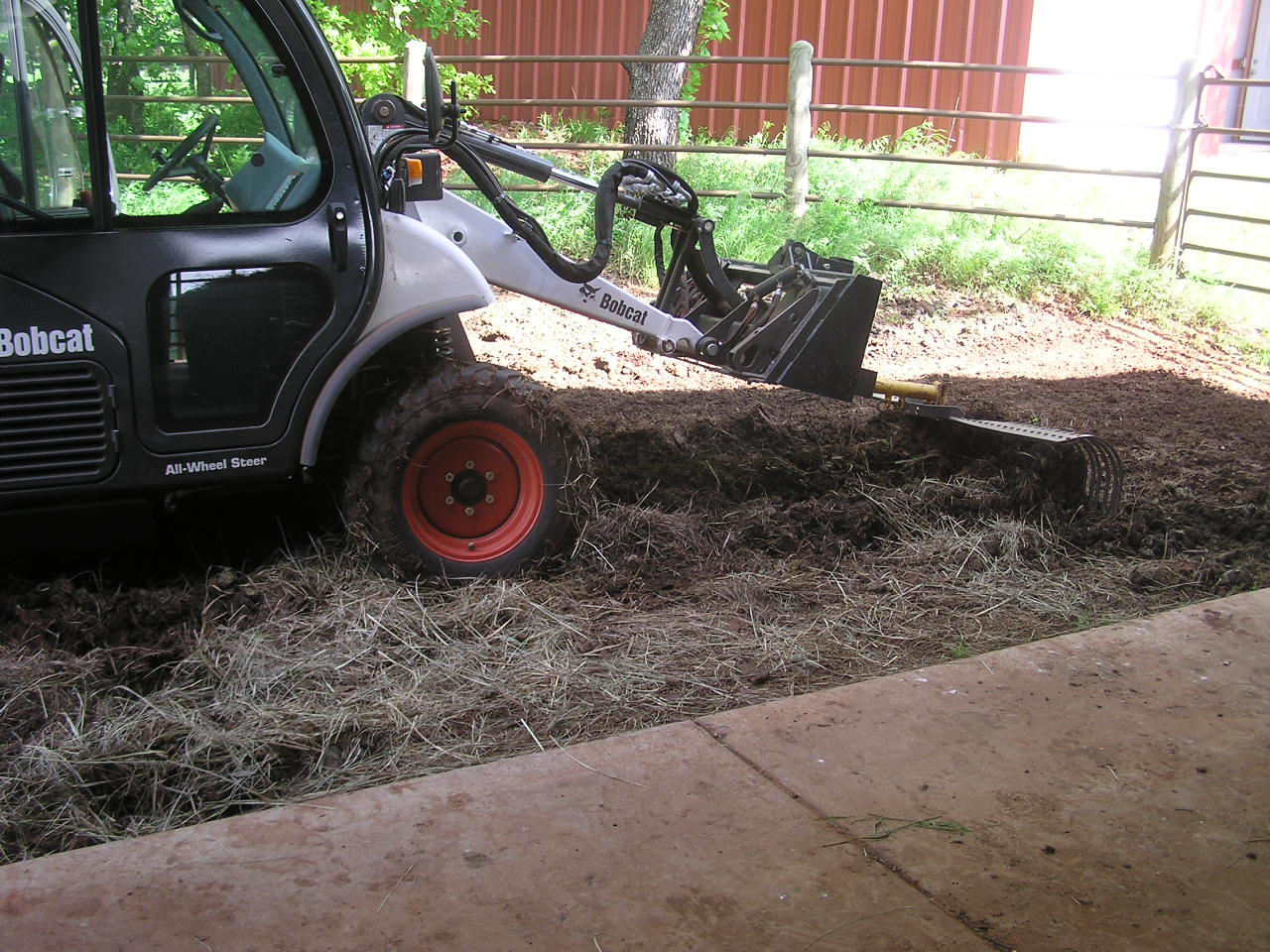

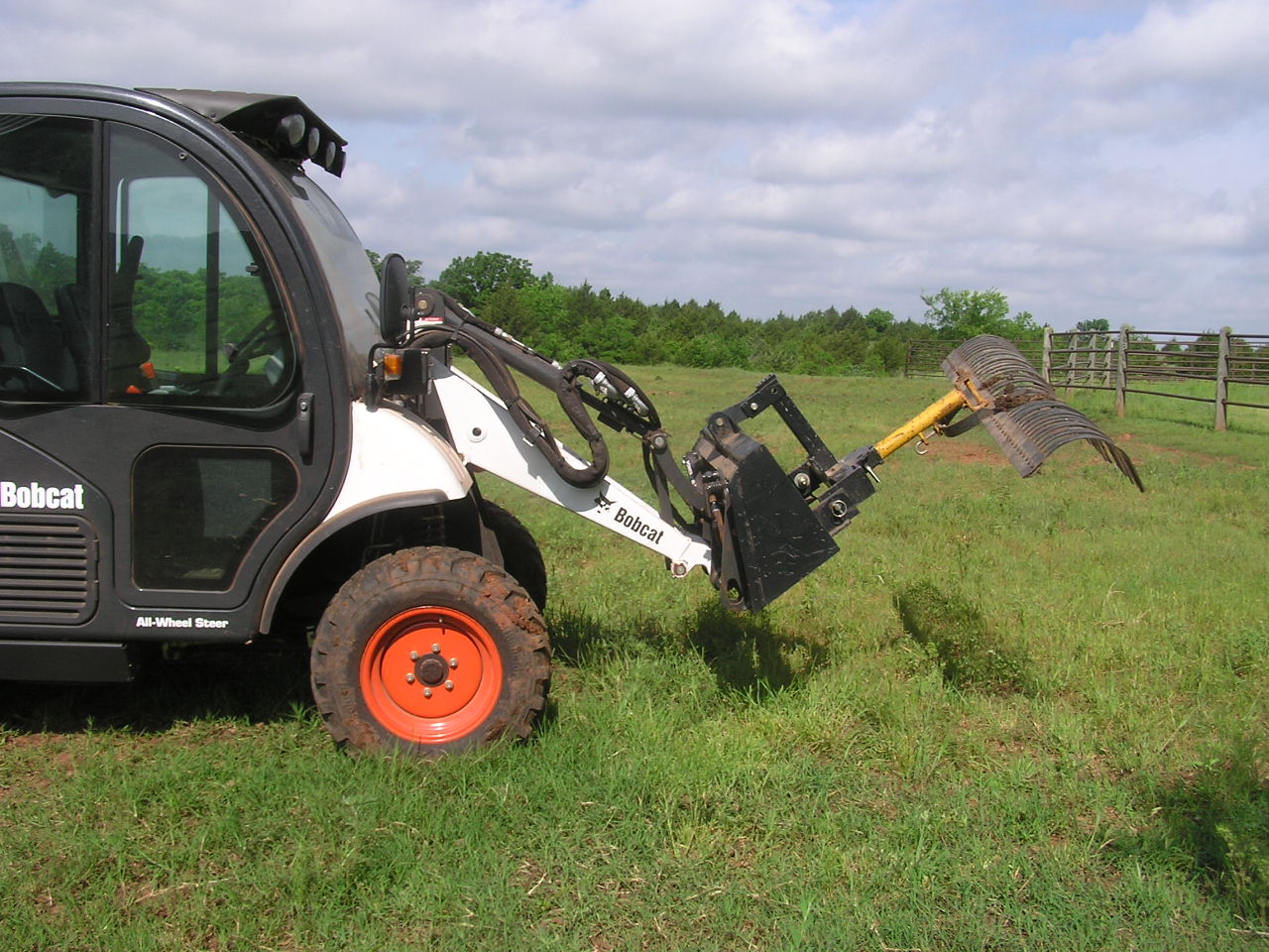

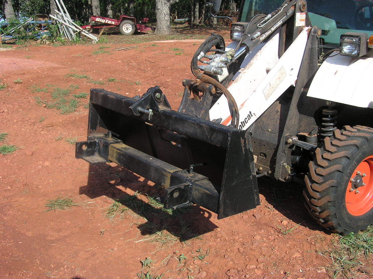

/ WHICH ROOT RAKE/GRAPPLE ? #75
HKS003 may have hit upon something here.
I built a SSQA to 3 point hitch converter several years ago. This allows me (among other things) to attach my york rake to my FEL. I haven't used it for vines in a tree, but I have raked out shrubbery and such from stream banks and cleaned out ditches.
Because of the curve of the teeth I can see how it may work. Once the vines are dragged to the ground they could be picked up for disposal with about any grapple. If this would be the only use for the rake, It could simply be welded directly to a SSQA plate and the 3PH converter would be unnecessary. You wouldn't need a high quality rake for this application and teeth could be removed if desired to increase the spaces between them. Reach would be about 14ft, I'd guess.
Thoughts?
OP,if you want to see what it looks like, I would be happy to connect it together and submit a photo.

If you have time, I would love to see a photo of that setup.
/ WHICH ROOT RAKE/GRAPPLE ? #79
------------------------ I would love to see a photo of that setup.
Found the photos of my 6' landscape rake on the 3 point adapter:
