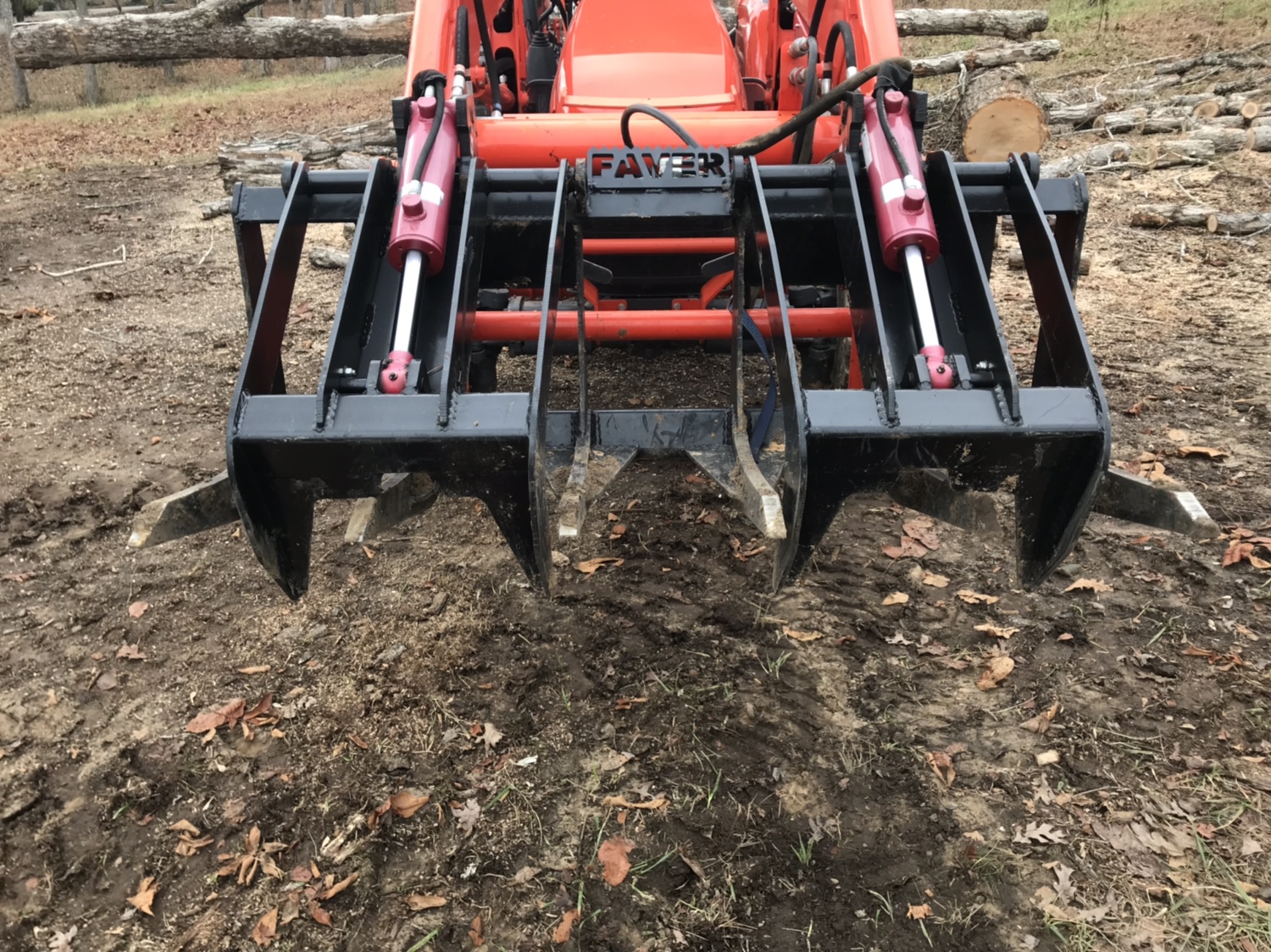

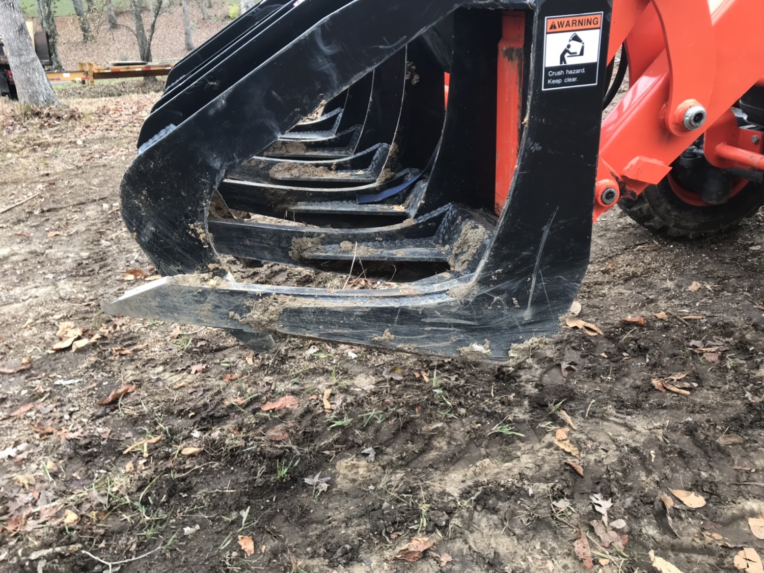

I don’t think my Favor is going to let go of much that a single lid would have caught. It covers the teeth pretty good and the lids overlap. IMG_7872.JPGIMG_7873.JPG
