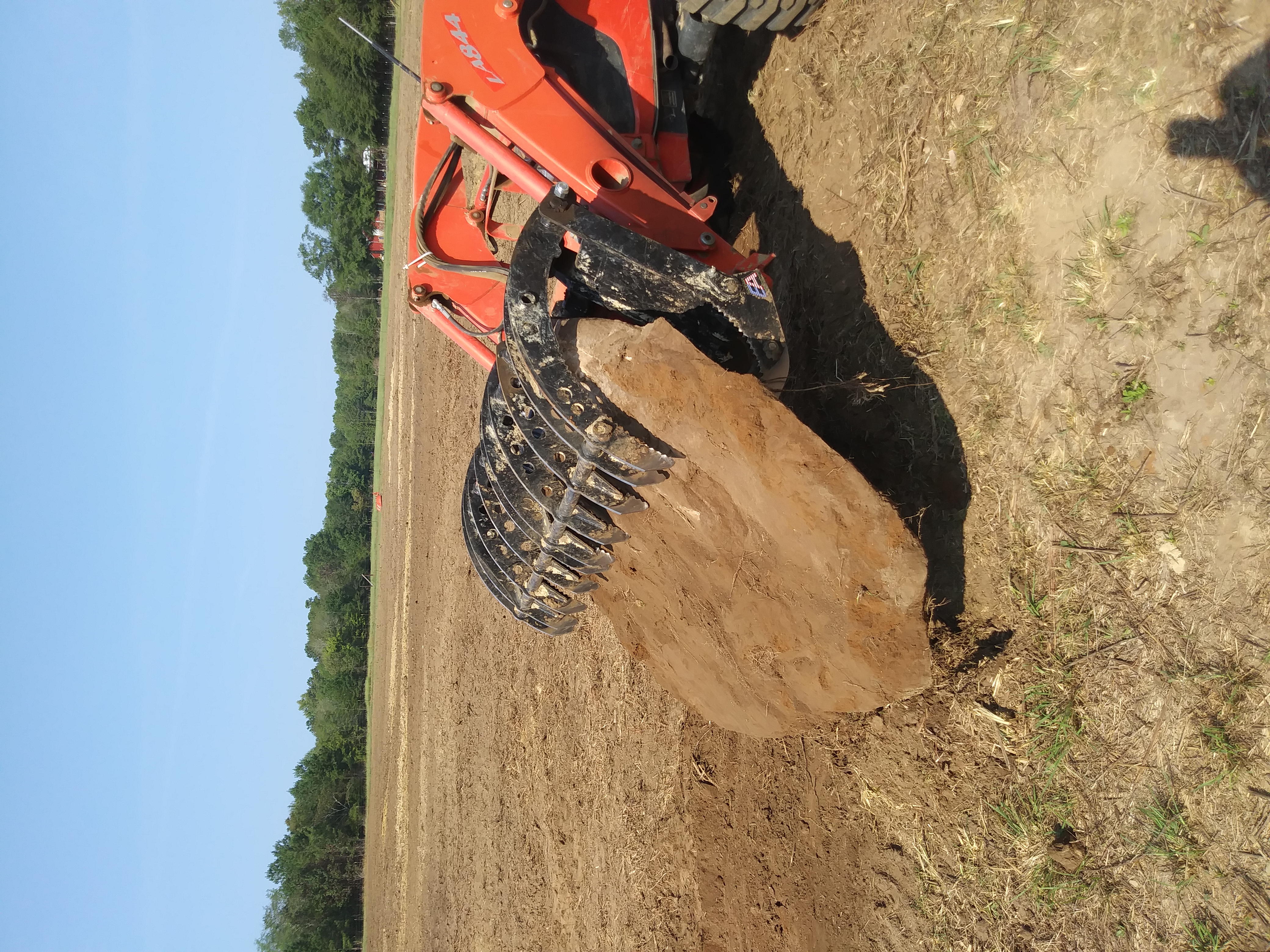

rocks ? No problem for the wicked to dig up
Wicked !! There's No substitute for quality ! Guaranteed..... And, made right here in the USA !
Please read my entire post #1: "I have absolutely zero rocks in my area".
Why would I need a "wicked grapple"?
To dig up rocks that do not exist,.... at any depth?

Never said you had rocks...I was just showing how tough it is by showing the rocks.
Never said I didn't buy other things made in other countries. In a lot of cases, there is no way around that. I will buy made in the USA when I have a choice.
Sorry you can't understand my post.
I really don't care what you buy. You are the one that asked which grapple to buy

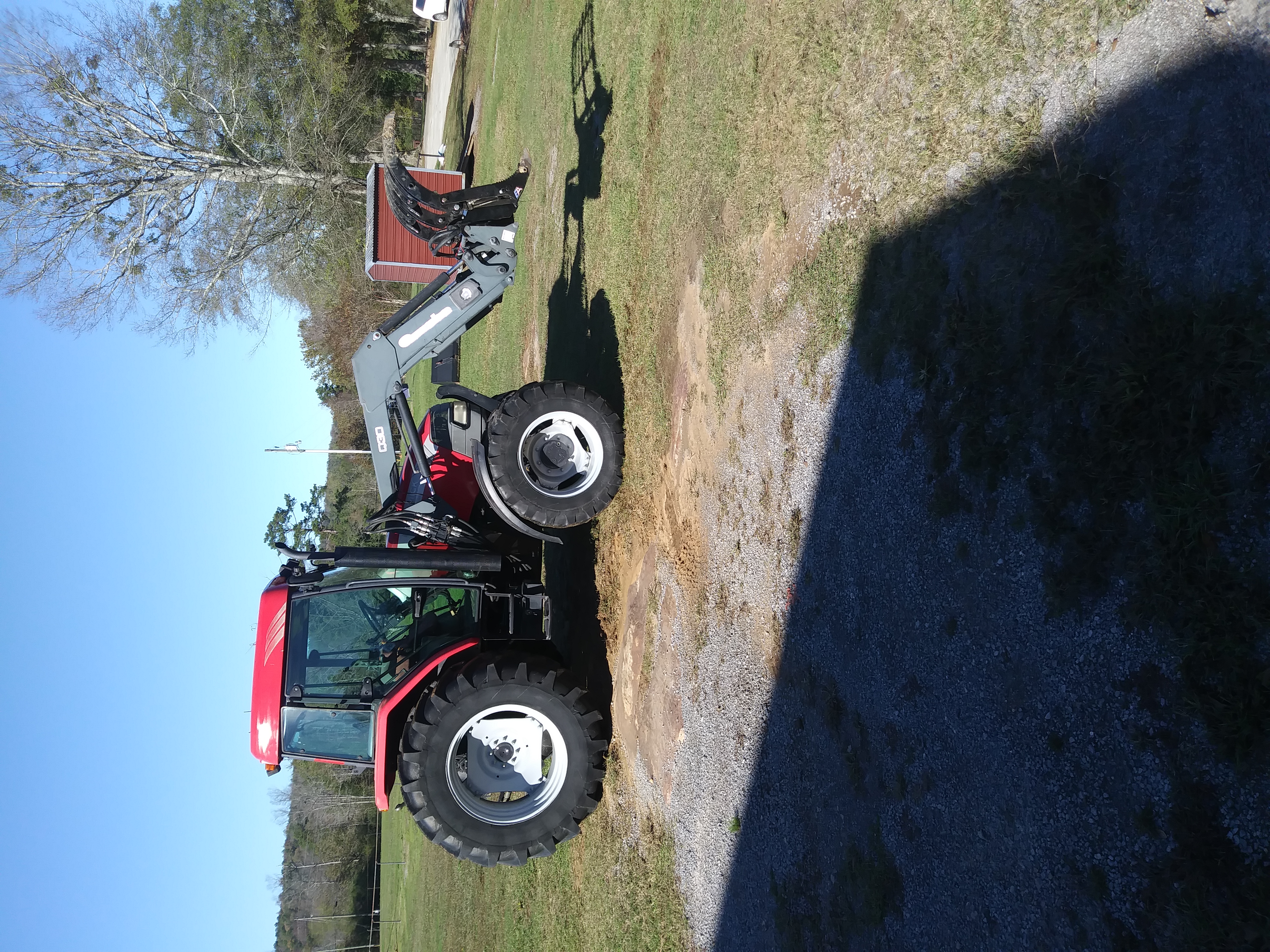

I bought the land pride sgc 1072 it's 450lbs and I love it on my mx5200. I use it for pulling up privet and raking up sticks and piles of cut trees.
Your Land Pride certainly does look like a very nice grapple.
The problem for me though would be the tooth design.
I need the longest teeth possible, and spaced much wider than those appear to be.
I need to reach into trees/bushes to hook/snag the bittersweet vines, yet keep the actual damage to the trees/bushes to a minimum.
I am thinking longest possible teeth, with tooth spacing at 11" or slightly more.
Any more closely spaced teeth will likely pull/break off branches of the trees/bushes themselves.

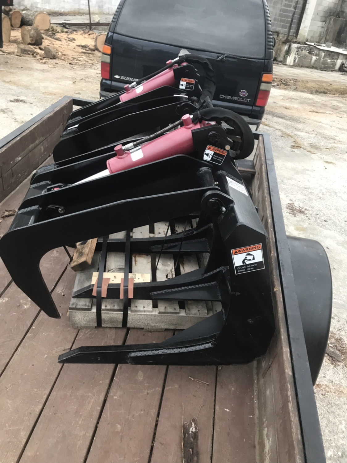

I think you need a danuser puller or maybe just use the thumb. I’ve never seen a grapple that worked good for pulling brush. My Favor has long teeth spaced pretty far apart. IMG_7685.JPG

I think you need a danuser puller or maybe just use the thumb. I’ve never seen a grapple that worked good for pulling brush. My Favor has long teeth spaced pretty far apart. View attachment 630611
The Danuser puller appears to be primarily for single stalk growth.
That would not work for my application.
The thumb/bucket is not nearly wide enough to grab many vines, and reaching in with the hoe bucket seems as though it would do a lot of branch damage.
The bittersweet grows as a tangled mass of vines with multiple pieces that are individually rooted.
I need to snag the tangled vines at 6' or 8' above the ground, and try to pull up, and out.
The bottom tooth design of your Faver is exactly what I want.
I think I want a full width single lid top though, instead of the two separate lids as on the Faver.
