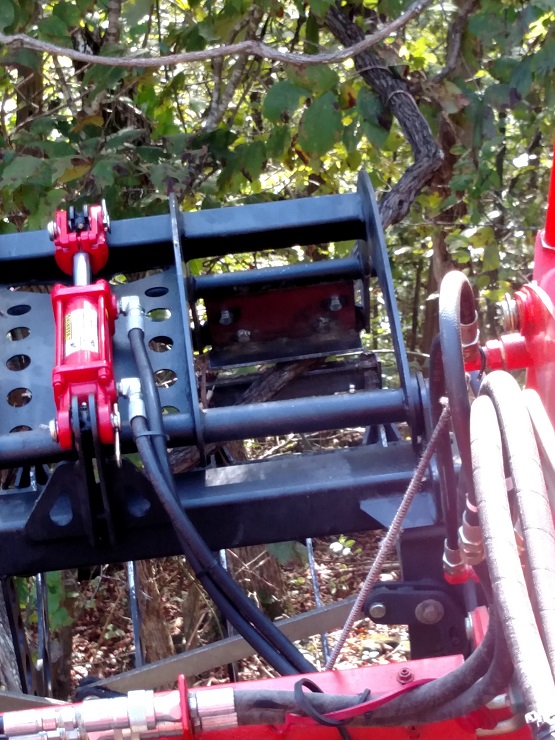

This is my Land Pride SGC1560 grapple with WRLong third function. It's probably more than you want/need. It shows one style of root/rock grapple. View attachment 630798View attachment 630799
It is extremely HD (820#) and didn't come cheap - $3175. Five years of extensive use and no problems so far.

That is truly a magnificent looking piece of equipment, but serious overkill for my needs.
I have zero rocks.
My 48HP Kubota backhoe will eat any roots, and stumps.

Before ordering I will ask MS about ordering that exact design direct from them.
Perhaps I could also pay MS to use bronze bushings, or pivot bolts with zerks.
I have also thought that I might just tack weld each pivot bolt, and put a zerk in each cylinder end fitting.
I have never seen a bronze bushing used on any tractor loader or equipment pivot. All I have seen is steel on steel with grease fittings.
It would be much less trouble and expense to just replace or modify the pins to be greasable.
I think bronze bushings could work, but as you suggest, I think I would/will/may be able to modify the pins to accept grease.
