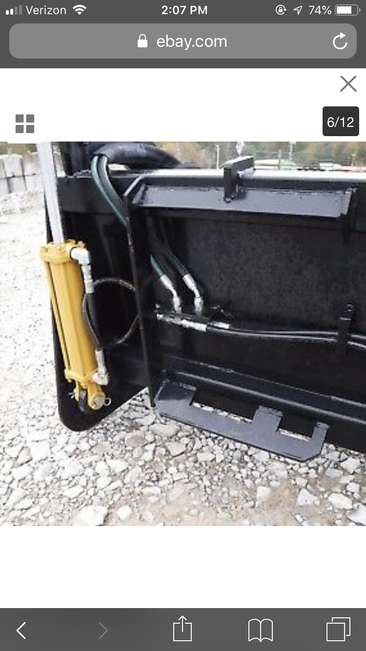

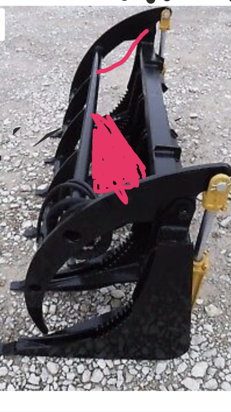

So I looked up your eBay grapple and the 2 problems biggest problems I see way ahead of pivot points is the hose routing sucks and there’s nothing to keep the lid from racking sideways. My Titian suffered from the same failure. I bent both lids and tore one cylinder mount off. That piece of crap is the reason I tripled my budget the next go around. If the first thing you did was weld a brace like this it would be better off. IMG_7877.JPGIMG_7874.JPG

So I looked up your eBay grapple and the 2 problems biggest problems I see way ahead of pivot points is the hose routing sucks and there’s nothing to keep the lid from racking sideways. My Titian suffered from the same failure. I bent both lids and tore one cylinder mount off. That piece of crap is the reason I tripled my budget the next go around. If the first thing you did was weld a brace like this it would be better off. View attachment 630731View attachment 630733
Good info!
Thank you.
Those angle braces make complete sense.
If I buy that thing I will definitely do the angle braces before using.
I hadn't noticed the hose routing, but that does look to be an issue also.
For fun, I just might take a trip up to Denton, NC. to see how it is made, and if they will build to my requirements.
