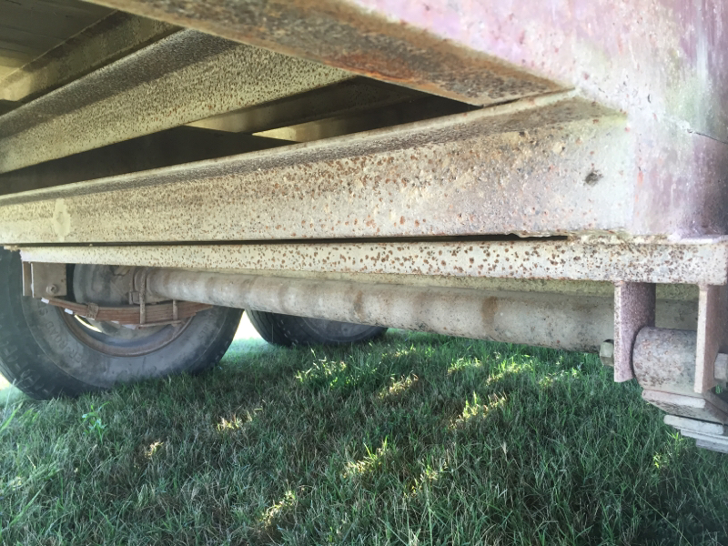

I did the same thing a couple of years ago. I think I did mine hauling hay with the tractor. It was on a 7k axle. When I welded the new one back on I added a piece of angle iron on one side of each hanger. Welded it to the hanger and frame. Kind of as a support. I seen the angle iron idea on a different brand trailer of the same weight.

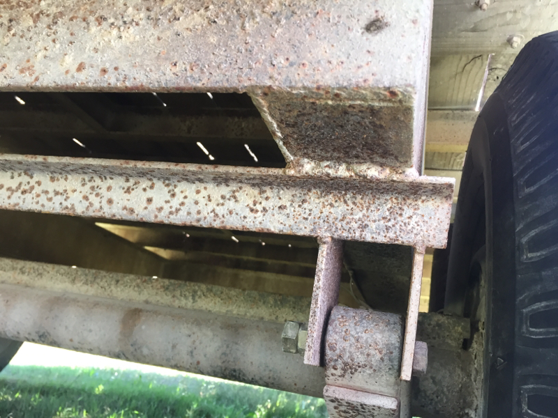

One option would be to add a web stiffener between the top and bottom of the channel to bring it out flush. Could be just a section of strap or plate the same thickness as the channel flanges, or could be a length of angle or tube. That will at least keep the channel from flexing as much where the bracket attaches.
I am not sure how the angle farmer2009 describes is running, whether it is vertical from the bottom of the bracket to the top of the frame, or horizontal behind the bracket tying the two sides together and also up the frame. I want to say I have seen someone's trailer done that way where the angle goes clear across the frame, tying all 4 bracket sides together and also keeping the channel sides from flexing. Don't know how in-the-way that would be for you.
On the outside, maybe a gusset to your fender brace: if it's solid and in the way, make use of it?

Sorry if I wasn't clear on my description. The angle runs under the frame across the trailer. Here's some pictures. I did this for both axles.
   / Why does my trailer suspension keep breaking? #16
Only one picture per post.
