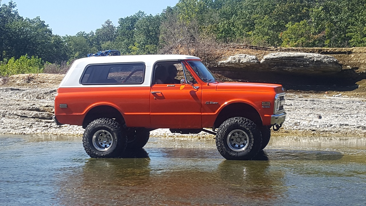

Definitely. This is the Blazer. My Son owns it now. It was freshly restored when Mike blew out the rear end. :D
When you said "Blazer" I thought that you were talking about one of those little things the size of my Ranger. I didn't know that you meant a Blazer

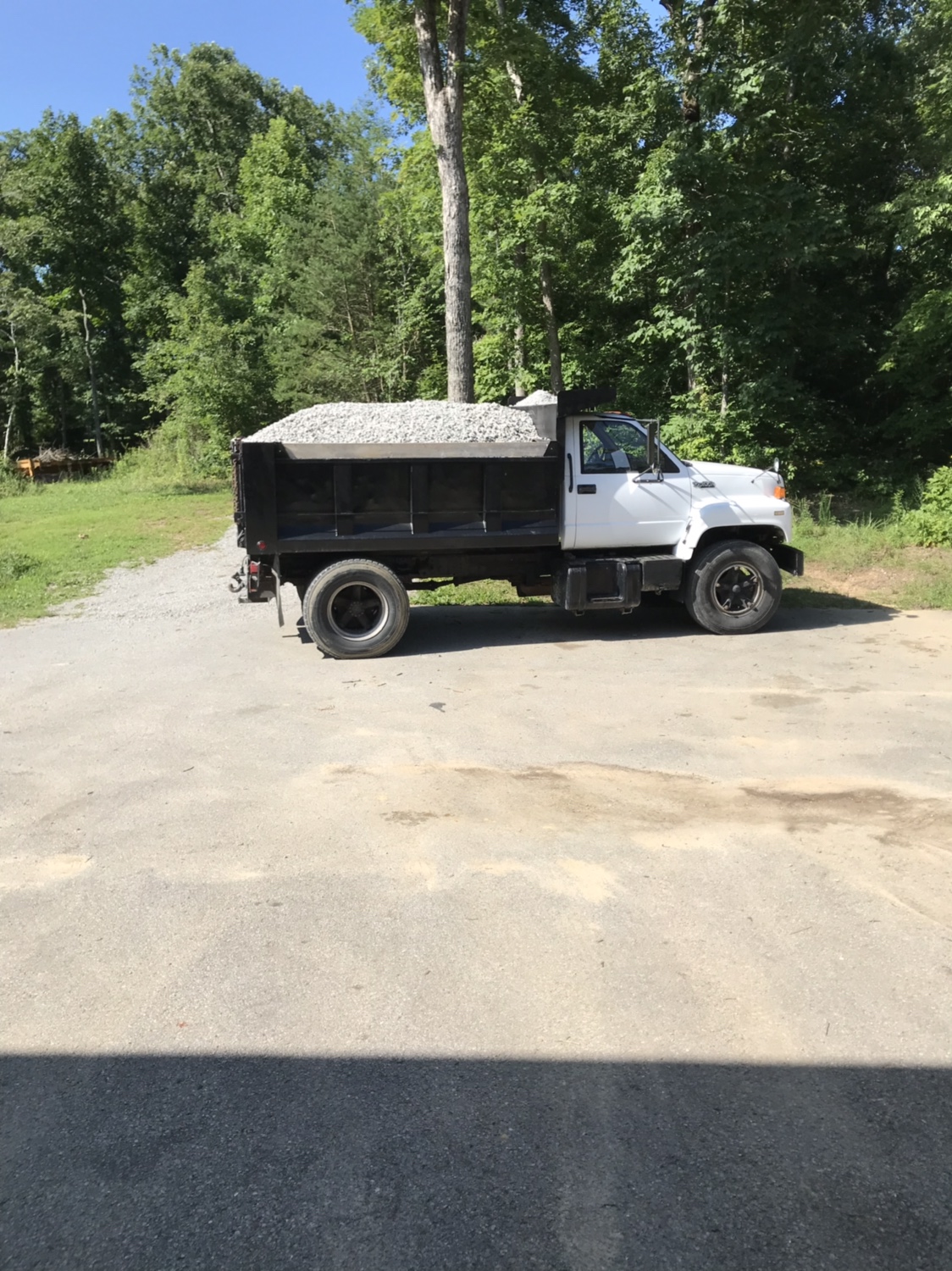

Exactly. Load the curb weight barley 1 ton car like this and let us know how it turns out. Considering that load ( just the load ) weighs 8.3 times more than the Miata I don’t think it’s going to turn out good. IMG_7076.JPG

It’s not like 4low. It is a service gear. I hit it for pretty much every start loaded. My 6500 will only go about 5 mph in first/low. For on road use usually first/high or second/low is a better choice but when the truck is marred on soft ground or pulling the steep hill out of the quarry first/low isn’t overkill at all.
Ah, didn't realize you were talking about your dump truck. :)
