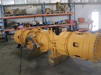

Wanna see a big differential ? Google mine haul trucks. Caterpillar factory in NC assembles them. Rear axle and diff in one housing. Shipped one diff per container or about 70,000 pounds. For a Cat 793F truck the rear axle fill is 260 gallons.
Cat | 793F Mining Truck / Haul Truck | Caterpillar

Hmm. Nothing makes a whole lot of sense. There are some cars out there with some diesel engines with high torque not having differentials the size of even the fairly large one on our Tacoma (compared to those Subarus, Miatas and Benzes that I've seen them on).
Ralph
Think of it this way: Why is a 1/2" ratchet bigger than a 3/8" ratchet? The body is bigger, the gears are bigger, and most times the handle is longer. Why....you need those things to achieve higher torque levels. When a truck has a two speed transfer case, it is essentially a torque amplifier and all of the driveline must be heavier because of it. :duh:

I can understand the torque bit, especially for large equipment. However, how do they keep the ratio down to around 4.0 in regular pickups with such huge ring gears? Ratio on the tiny Miata differential is 4.1. Think the ratio in my Tacoma is about 3.6. It revs MUCH lower at speed than the Miata.
Most trucks get those granny gears via the gearbox and/or transfer case, not in the differential.
