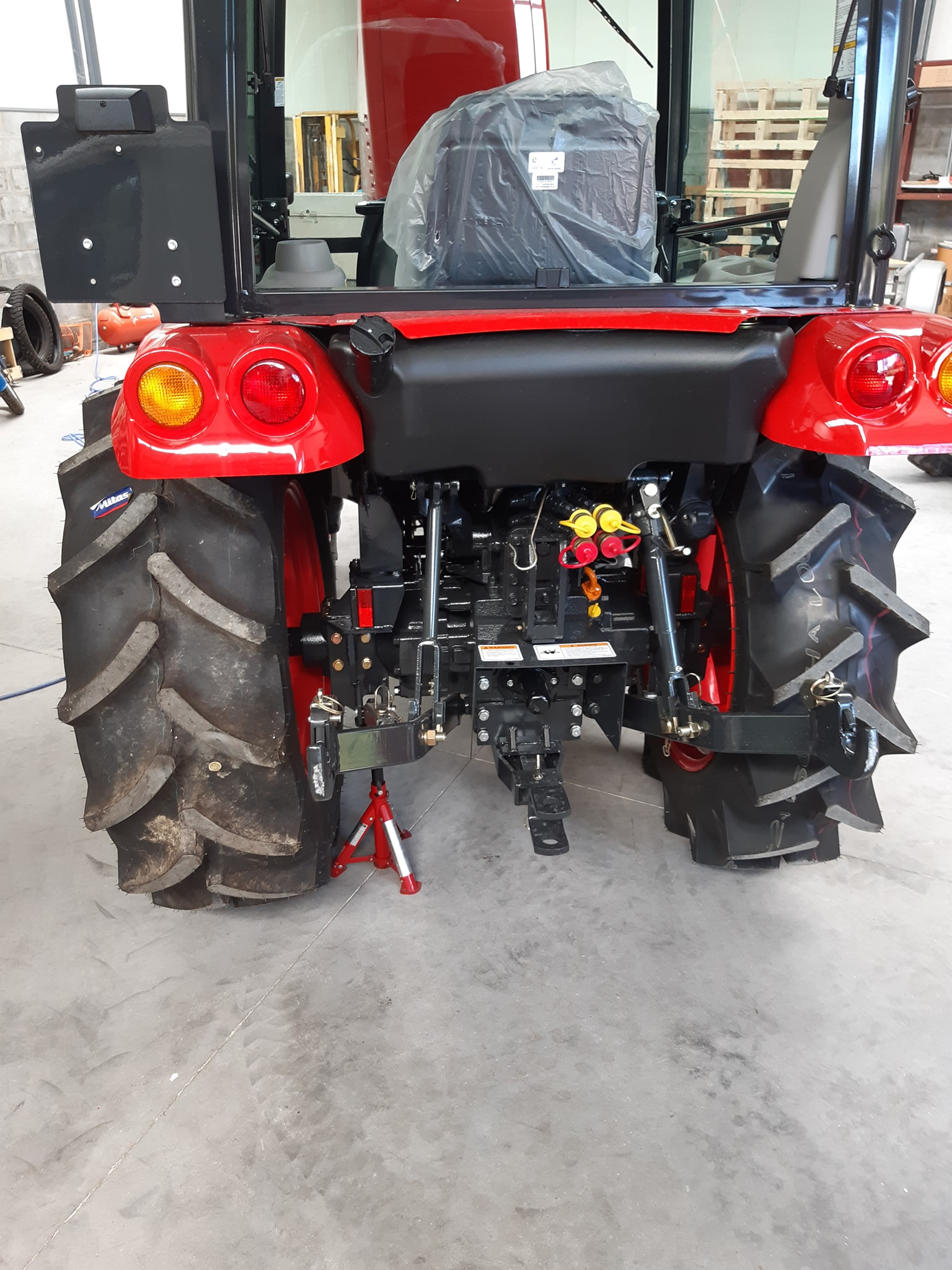

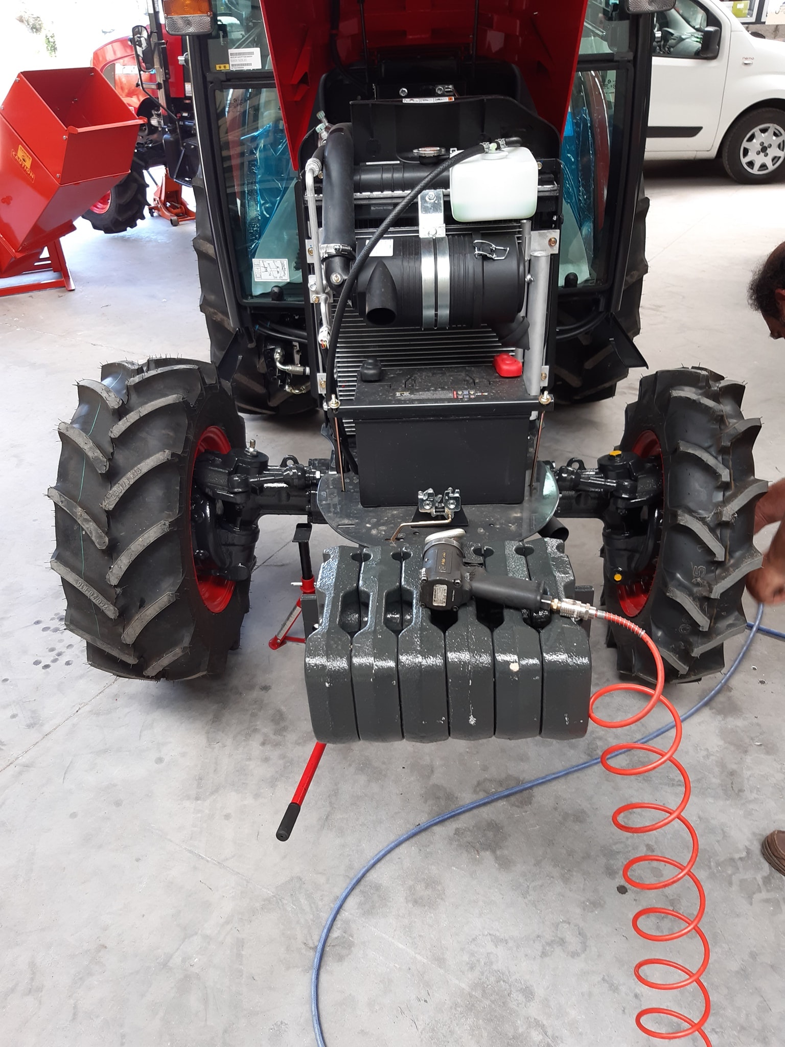

People use R1 Radial tires, here in Europe, to get more traction amongst several other benefits, because they are wider, not because they are taller and skinnier.
Radials on the left, Bias ply on the right.
   / Why is Weight The Only Solution Being Offered To The Problem Of Traction?
#58
View attachment 732191 View attachment 732192
This introduces another perspective into this discussion: Wider versus taller and narrower
Somehow this discussion has turned into rocket science now 👨‍🔬
