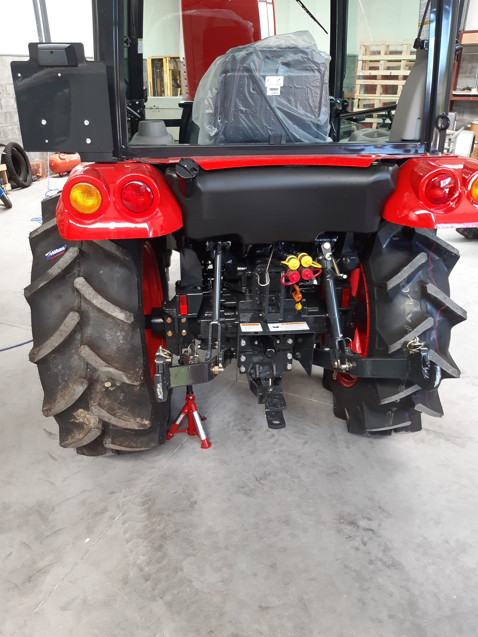

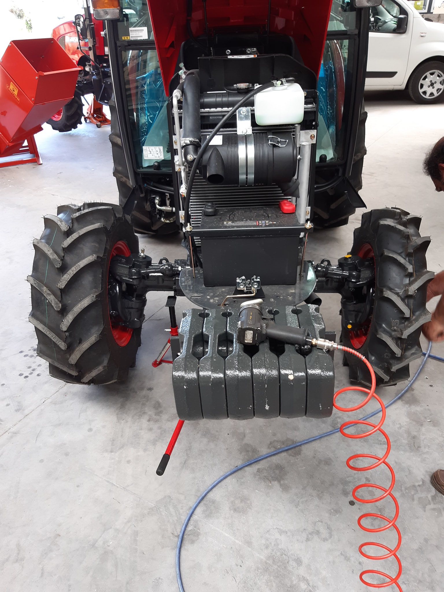

People use R1 Radial tires, here in Europe, to get more traction amongst several other benefits, because they are wider, not because they are taller and skinnier.
Radials on the left, Bias ply on the right.
View attachment 732191 View attachment 732192
I know that you've answered this before but will radials fit on the same rim as bias? If not, it seems like tire construction isn't the only difference.
Somehow this discussion has turned into rocket science now 👨‍🔬
And here I am, asking dumb questions about rim width. :confused:
   / Why is Weight The Only Solution Being Offered To The Problem Of Traction? #80
The radials being wider, will need a wider rim at least for the front, but that's about it. Just like R4's, I believe? Never really dug into those tires much. It's also common to have front adjustable rims with Radials, just like the rears, while with Bias, only the rear rims are adjustable.
