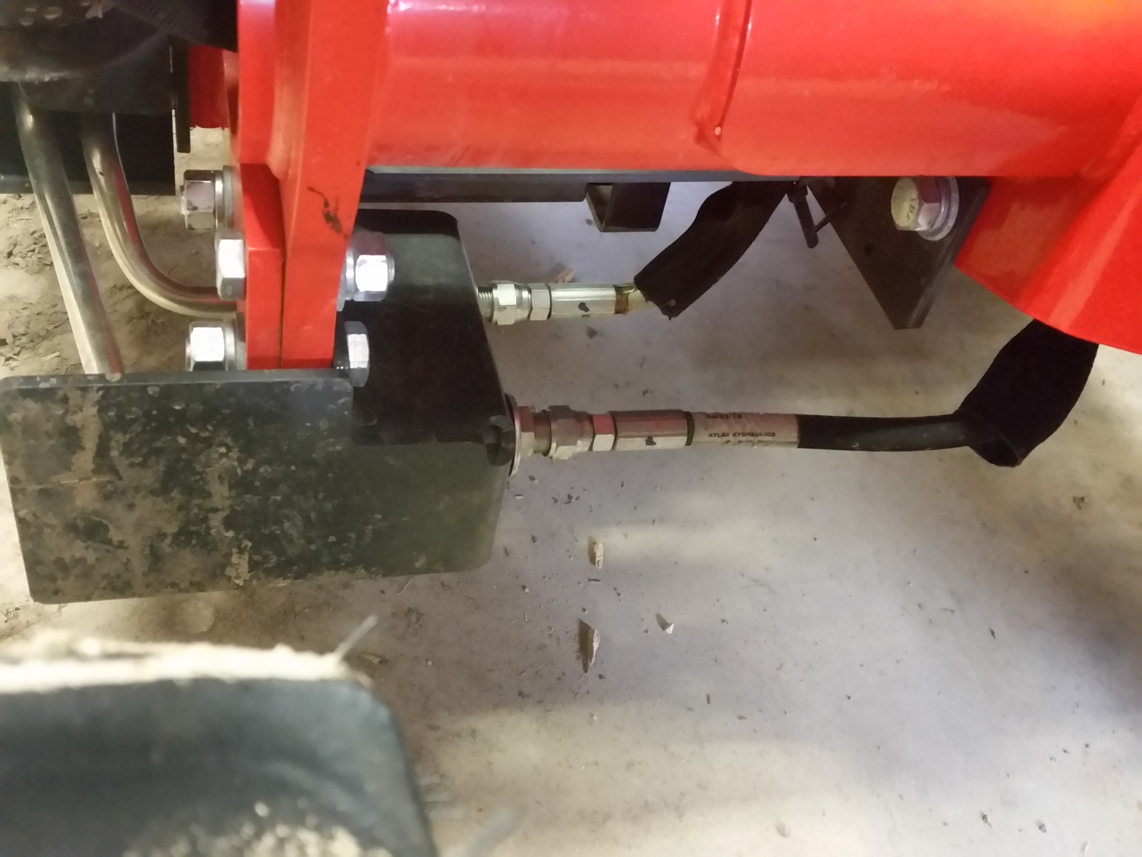

Yes for all those that observed me being overwhelmed - spot on.
Combimed with the fact that even the local professionals I talked to are unhelpful of they themseved don't understand.
At the moment it's hard to determine which port or hose to tap into, so I do nothing.
I don't think throwing $1,400.00 at it will solve the problem either.
Any Kubota guys know where these hoses come from. I was thinking of using a T fitting here wit quick disconnects to the back of the tractor.

Your right. Doing a lot of chin rubbing and laying under the tractor. BUT because I have (5) things using gydraulics 1) loader arms 2) loader bucket 3) rear remote #1 4) Rear Remote #2 5) Grappler plus all the hydrstat lines, rear three point lift tubes.
You see the mess of ins and out I have under this tractor it looks like a plumbers nightmare PLUS it's crowded as heck under there.
Since I'm not 100% sure what to disconnect I'm not going to disconnect anything.
Yes I'm now undertsand the concept of OPEN hydraulics I need to come in 100% ( THEN THE BACKHOE CONTROLS THE IN AND OUT) then I need 100% OUT to the tank. With not valve between the In and backhoe or between the OUT of the backhhoe.
I did call a guy who said he works on tractors to come look at it, but even he didn't seem to get the concept that the valve I have does not allow for fluid to return. Seems only you guys here undertsand and dealers and mechanics don't undertsand.
View attachment 596239View attachment 596239
Are those pictures of the hydraulic lines going to/from your loader? If so, can you post a picture of where the lines go into the valve?
Aaron Z
   / Why no "Power Beyond" for Kubota tractor? #50
I think the parts for kit B22501 are the intake and outflow hoses on the tractor side of the backhoe. parts 7K500-64830 and 7K500-64850 are the two hoses. You'll need the connectors too of course but you don't need the Kubota ones, decent 1/2" ag connectors are like $20 a set. The parts fiche says s/n break so those may not be the right versions for your tractor but a dealer should be able to handle it.. Or Messicks' parts dept.
Kubota BH92 (BKHOE L32 / 35 / 39 / 42 / 44 / 47 / 5 / 52 / 574) Parts Diagrams, look for B22501 under hydraulic system. It even show what the hoses connect to (as isolated parts). One looks like the loader valve.
I don't understand why your dealer can't figure this out.
